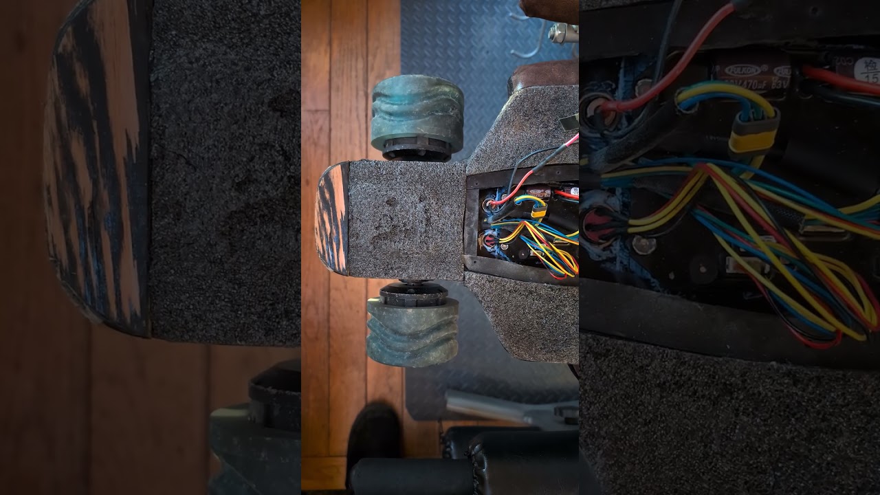

One motor keeps spinning off throttle
Hooked up a new Puaida ESC to an old Sharkwheel/Teamgee hub board and when I release the throttle the left motor keeps spinning under power for a bit. Doesn’t happen all the time but most of the time it does. In the video they stop together in the first pull, then you can see it stays powered for a bit longer in the other two pulls. This didn’t happen with the old Lingyi/Wanhdt ESC.
I noticed one wheel on my puaida esc seems to spin faster with no load on the bench, and then spins longer after releasing throttle.

That’s what I was thinking but haven’t ridden it yet. It really spins a lot on higher speeds, like 2 seconds off throttle in 4th gear so I was worried it might be an issue.
Seems like some QC issues with the brand. I like the remote, the display, and the customization menus, and on the bench it seems much smoother than the old Lingyi.
Do you know if the ESC auto senses the motor pole pairs? The remote says “10” but I have no idea if that’s correct. I guess it probably wouldn’t run correctly if it was wrong.

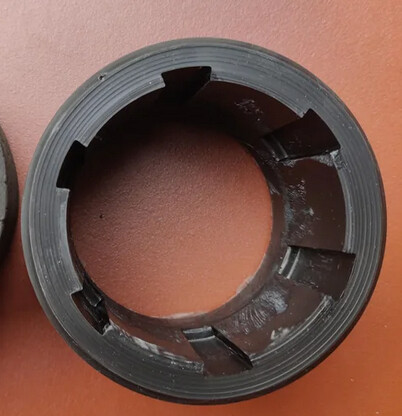

The Puaida 105mm sleeves are cast onto aluminum instead of plastic like the 105mm meepo sleeves, have a more rounded profile and are softer. Mine have worn almost almost flat profile now and which is why I ordered two more sets of their 105mm sleeves. They made a huge difference in ride comfort.

The problem I have is my motors are the 6 bolt and take 6 slot wheels which won’t fit most hub sleeves. Cloudwheels only seems to offer 120mm in the 6 slot style now, and I don’t see anyone else making 6 slot knockoffs.
I was unsure of your motor design, that inner bearing cap looked kind of similar but I couldn’t be sure.
My first hub motors which were 72 and 83mm diameter had non replaceable sleeves, and the motorts themselves still work fine, it is just the sleeves are gone, and I much prefer the 90mm+ diameter, and the fact that I can still buy replacement sleeves.

Watched your video on my desktop rather than my phone and my motors do the same exactthing on the bench. I’d say just ride it and forget they spin up differe4ntly under no load. From what I read a lot of Vescs do the same thing. I failed with Vesc and hub motors and have not tried again.

That slotted motor/sleeve design is a bit of a bummer as it effectively reduces sleeve thickness if a pebble hits on the slot. My 72mm hub motors had super thin sleeves when new, and now heavily worn they are basically not even round anymore, but flatspotted over those slots.
