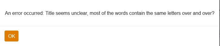

Also, I angered the gods of english. My original title was
ThumpThumpThumpThumpThumpThumpThumpThumpThump
I fail to see how that’s unclear :slight_smile:
