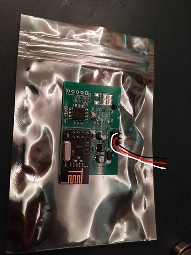

What cables/connectors will I need to get my new benchwheel receiver working with my unity?
Receiver pic for reference:
That looks like UART, so:
You need to either get or make a 7 pin JST-PH plug to the unity. Matching up these wires using the COMM port, use only the wires you need, not all 7 pins need to be filled:
I would try connecting the PWM (ā€œPPMā€) servo connection to right here
Oh fudge, didnā€™t even see those pins. Thatā€™s a much better idea. Wonā€™t be able to use the reverse remote function though.
According to the manual that came with, it doesnā€™t have reverseā€¦?
Iā€™m more concerned with the battery level telemetry.
Did no manual come with the receiver? If you run it in PPM mode does it have a wire for voltage pickup? Otherwise you might have to run it in UART mode for telemetry info
FYI:
The manual that came with didnā€™t really explain the connection method at allā€¦ Iā€™ll check their site but idk.
