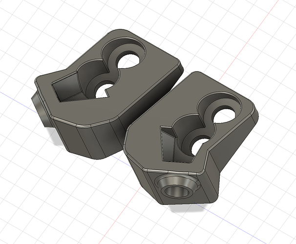

I have these prints pretty well dialed in. I tried my hand at casting them for a fictional prototype, but no success.
Right now I am getting a quote to have them machined from stainless steel from PCBway.
If you have a cnc capabilities, or know of a better way to get a small batch done let me know. I may still tweak a couple things, but im 95% there on the design.

This seems overly complex to machine, a lot of weird angles that would either take extra fixturing on a 3 axis or would necessitate a 4 or 5 axis machine

Seems like overkill, why not aluminum? You could even make something similar at home with a drill press and a chunk of aluminum. Instead of creating a pocket for a nut just leave the material and tap it for threads.
Yeah I can do that and I probably will. I Was hoping to find something easily purchasable for everyone.
Certainly could do that and probably will do something like that.
The initial quote from pcbway was very reasonable. As low as $18 per pair (group buy qty). ($40 for 1 pair) for stainless steel.
After engineering review the real price was an order of magnitude higher. So not feasible.
I’m going to re-work the design to make it more cnc friendly to see if I can get a reasonable price.
But yes, it could be a block of aluminum with 2 holes drilled and a tapped hole.
I wanted to avoid taping aluminum if possible. But it seems like that’s the direction I’m headed in. I can at least design it to have a steel threaded insert.
You are correct. Initial estimate wasn’t bad, but pcbway has an engineer review and the frice went up 10x.
