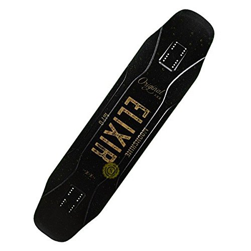

Deck: L 40.9" x W 9.61"
Wheelbase: Between 23.5" and up to 25.75" depending on which holes you mount the trucks.
Moonshine%20Elixir%201

So, my questions at this point are: Do you think this deck will work clearance wise with the Haggy drive system?

The haggy kit seems to get wheelbite with the rayme deck, if you where to stay with that deck, get some urethane wheels.

You may have some wheel bite issues with that deck, its still quite wide where the trucks are to be mounted. I’d run through eboosted/bigben’s enclosures, and pick a deck that goes along with it, they fit like a glove.

It comes with both AT and urethane wheels, I’m just worried about wheel bite with the AT for the most part. Any fix for that? Maybe risers or ?
Yeah I’m using risers (on current setup) and getting 218mm trucks to push the wheels out (for pneumatic setup) but still thinking drop through style is best bet
Nothing will help with wheelbite with the AT wheels, that deck is tricky to play with. Why not grab a jet killshot deck? Even with risers, it’s a long shot, want 4 inches in risers lol

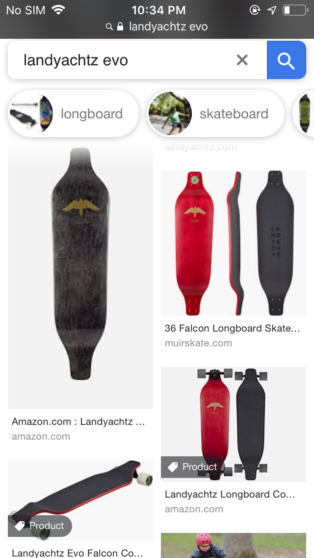

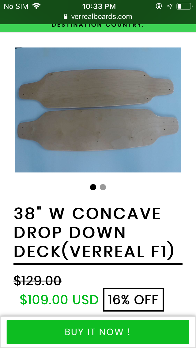

I’ve been using a verreal f1 deck, by far my favorite esk8 deck. Perfect amount of flex, and has some nice angles like the landyachtz evo
