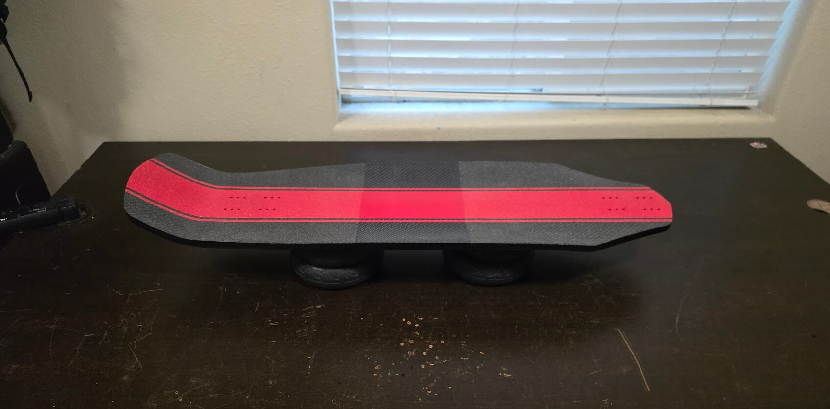

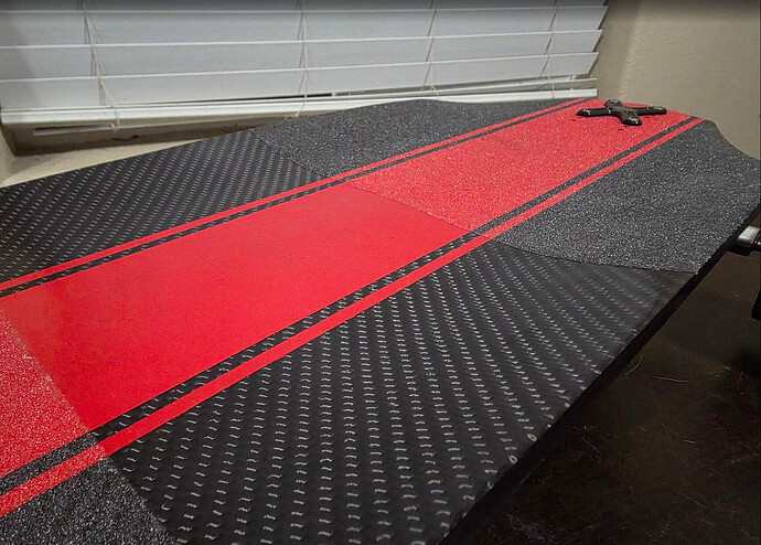

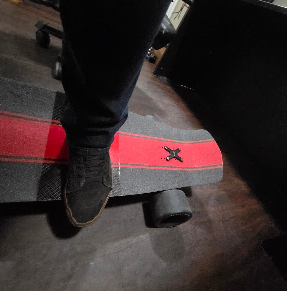

I’ve always had a thing for kicktail decks. Ever since I bought my first “DIY” board, an Enertion Raptor, I’ve just thought they look so damn cool. So when I saw Tomiboi’s Kanabo, I knew I had to have one.

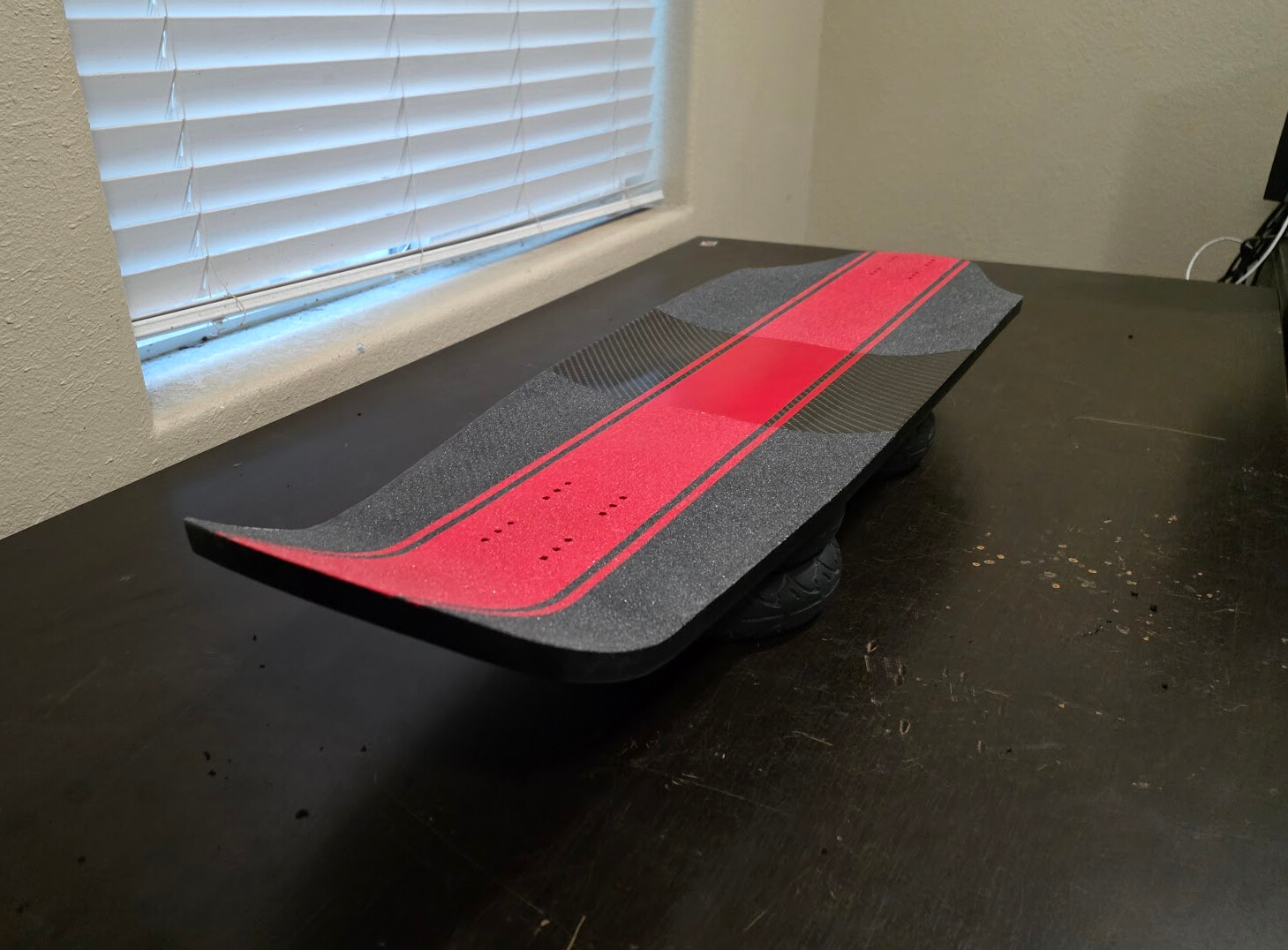

To start, I really have to give a shout-out to @tomiboi — everything he sends me is such insanely good quality, and his customization’s are always top-notch. Check out this close-ups of this deck… it’s just pure art.

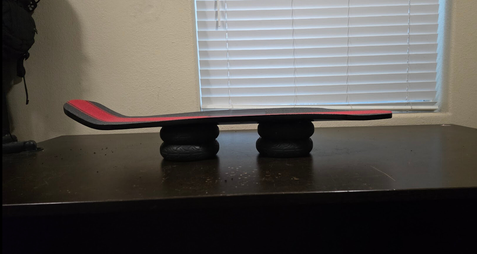

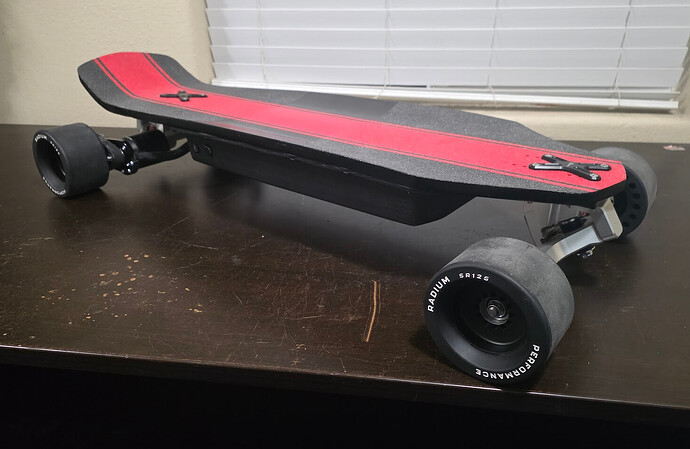

Here are so more shots of the deck, man I love how it turned out.

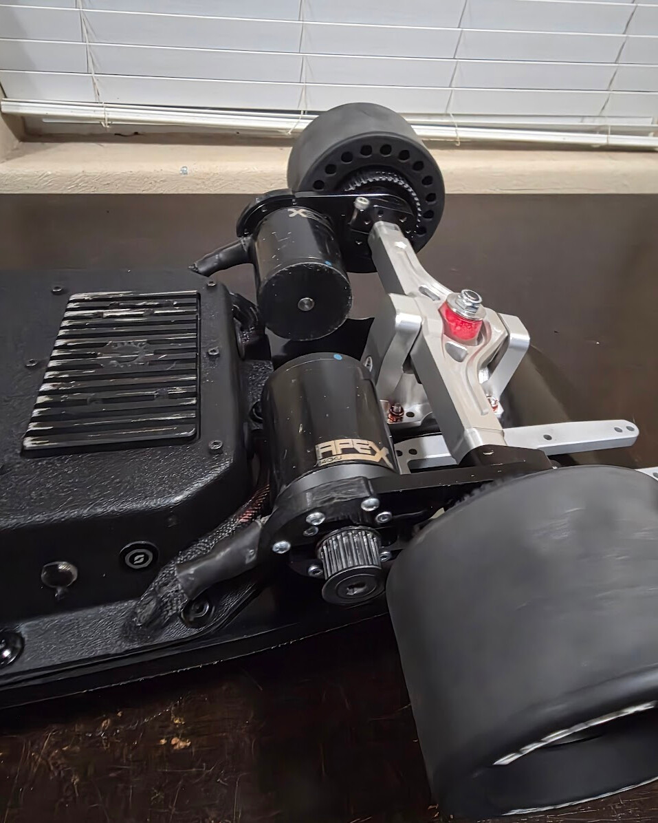

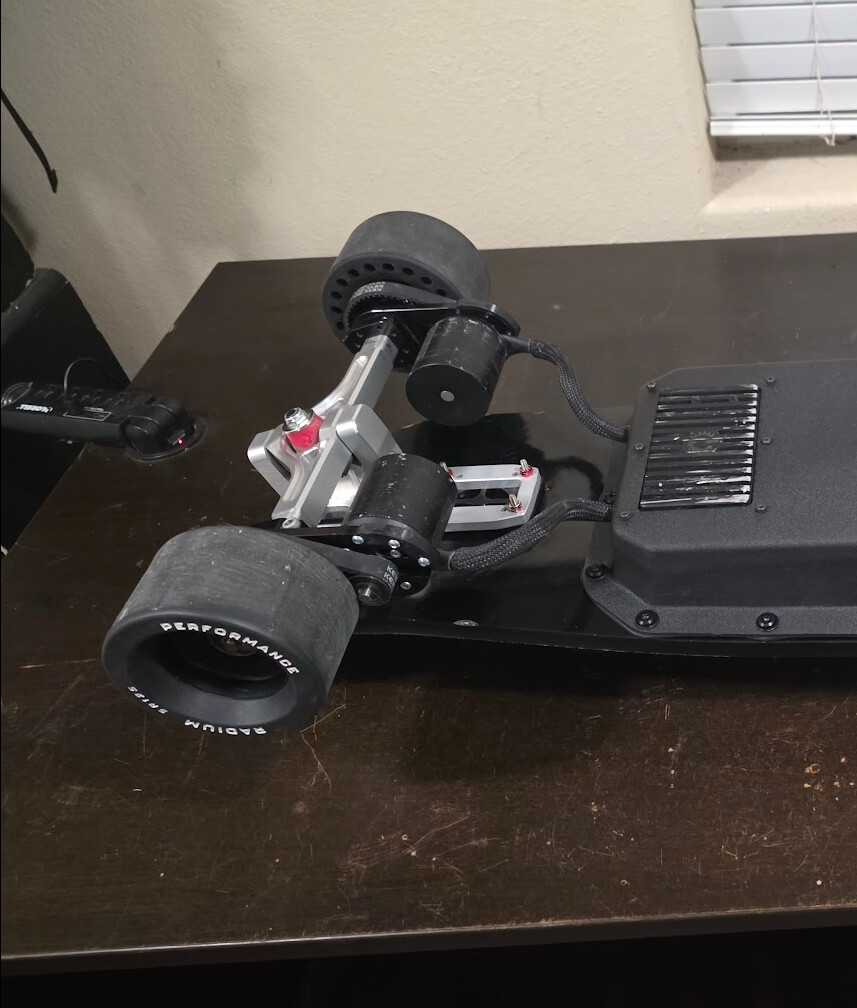

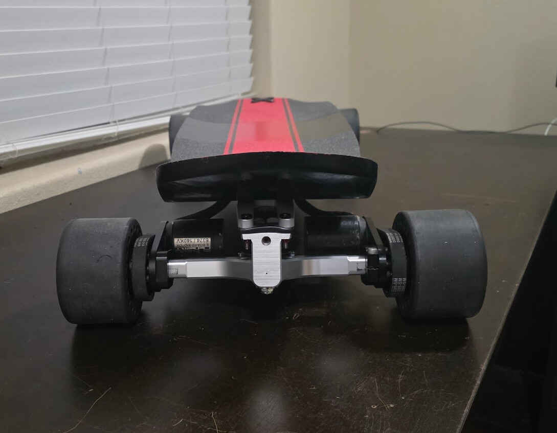

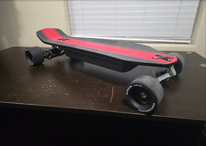

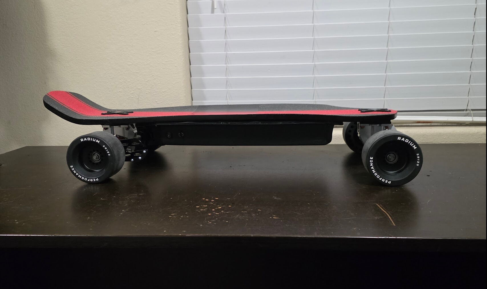

Of course, no good build these days is complete without a set of @Titoxd1000’s Duality trucks. I picked up these 270mm flat deck versions a few months ago and had them running on another board, but they were always meant for this build. Unfortunately, running the motors toward the inside of the deck was going to be a requirement, and with the stock spacing, that just wasn’t going to happen. It’s a shame, too, because I really liked the shorter wheelbase stance.
Luckily, I had already picked up a set of these slick truck extenders from @IDEA . His aluminum parts are so damn nice, I am always stoked to have a reason to add some of his stuff to a build.
Not quite as sporty looking, but I get to utilize the full range of the trucks motion.

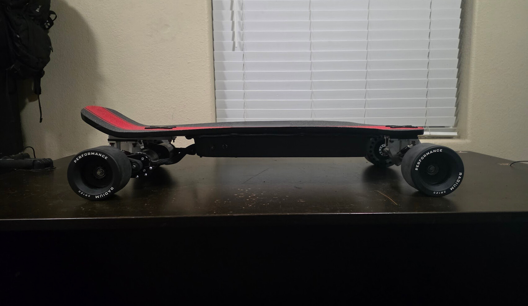

I am excited to finally be able to give these Radium SR125’s a shot as well. Feels like I have been waiting forever to try them. Thanks again, @Tony_Stark!

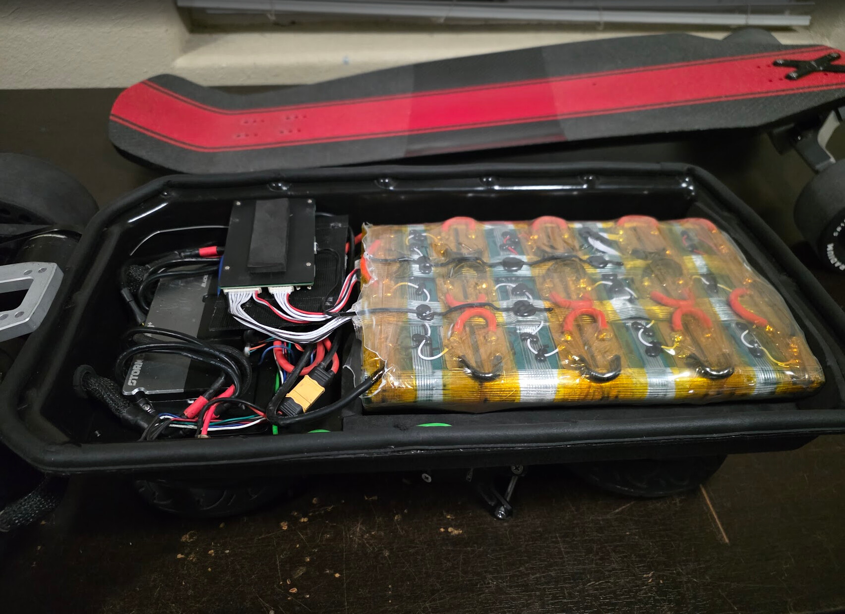

Nothing too special going on in the battery enclosure. I’m running a 12s5p pack that I built a few months ago using EVE 40PL cells, paired with some Flipsky 6374s and a Maytech trigger controller. They’ve been absolutely amazing — way more power than I need, and everything stays cool to the touch, even after the longest rides.

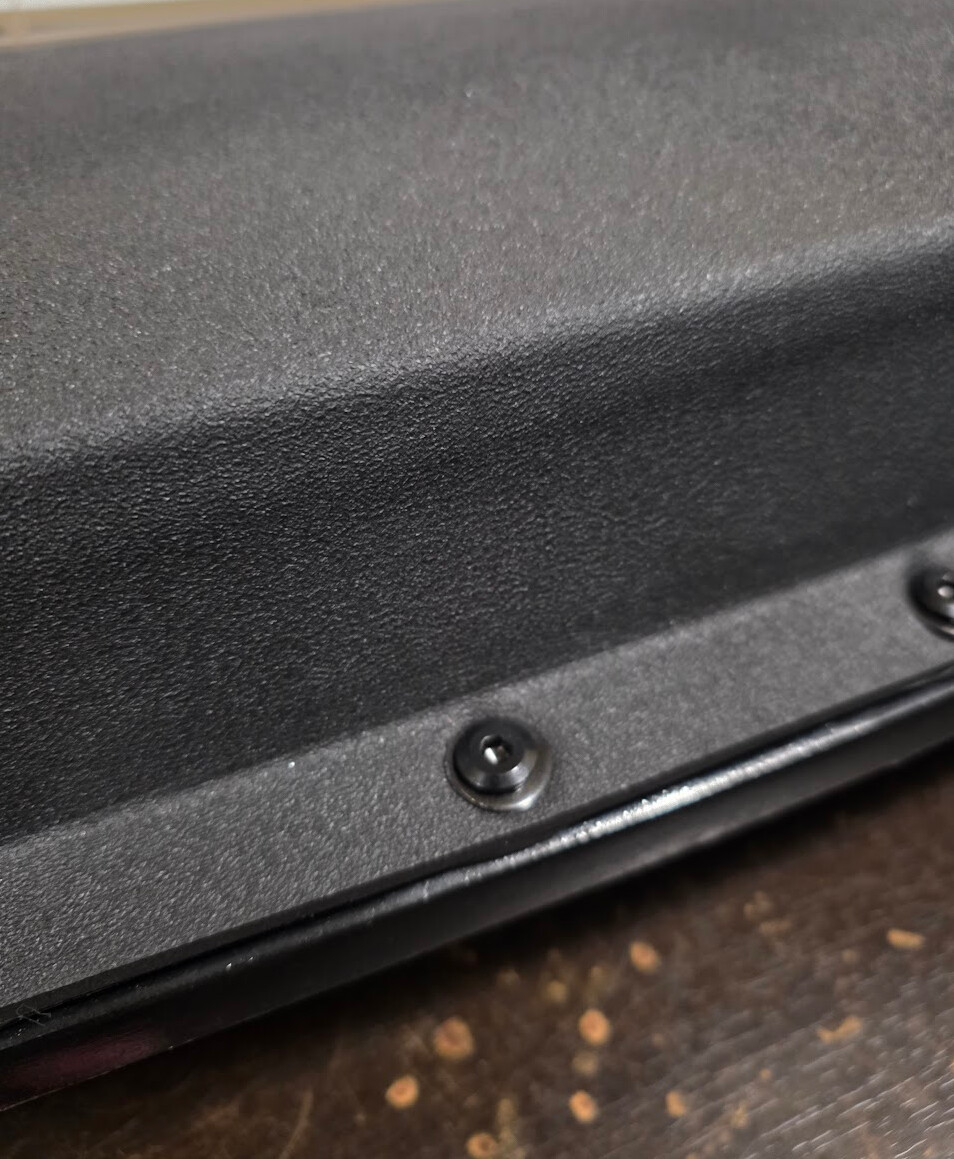

Tomiboi’s new enclosures are nice, too. They have this awesome texture and come with shiny black bolts — I think they look sick.

We got a couple short board builds popping up lately.
That thing looks fun AF!! Clean looking build too. I love a good kicktail. Ride safe.
So tidy and gorgeous. I’d touch your deck with my feet.

Do a kick flip damnit!!!
You know how many times I’ve tried to maneuver this thing with the kicktail? Even just moving it on the floor, it’s like 60 pounds — my ankle just stops :sweat_smile:
I was going to ask the weight?

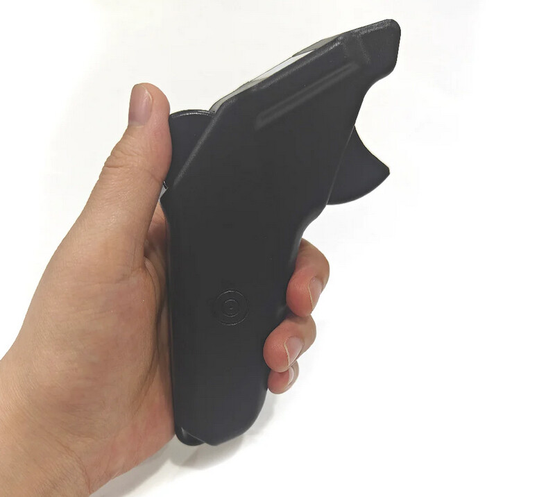

awesome build! which remote are you using?
Hey, thank you! :slight_smile:
I picked up an Evolve Hadean about a year ago and absolutely fell in love with trigger-style remotes. For this build, I’m using a Maytech e-Foil remote, since it was the closest match I could find.
I’ve been rocking this one for years. It is a really ok physically solid remote. Zero issues after many crashes. I have had a bit of signal dropout in RF heavy downtown areas so be aware. 99% of the time has been a non issue. Just seems to be two spots downtown that make it go dumb.
Been using it as my main too - the current V3 one has a bumped up “pro” transmission mode btw, so far I haven’t had any issues with drops.
My only big beef is that it’s inductive charging only since it’s efoil/waterproof centric, but maybe hacking USB charging would be a future project.
@Venom121212 @wpt_board
This honestly makes me feel a lot better about the remote. I appreciate the heads-up on potential signal dropouts in heavy areas, and the V3 version definitely sounds like something I should keep on my radar. Mine seems like it’s starting to lose some battery life, and I’m also not the biggest fan of induction-only charging.
From time to time it feels like the trigger modulation gives me a bit of trouble. I’m not sure if it’s just too much throw or something else, but occasionally I notice a slight delay when releasing the trigger. Have either of you run into that?
I haven’t had that (V3, PPM + UART communication mode) - the trigger feel / responsiveness is really tight which is my favorite part. In number of rides and crashes mine is pretty young still though.
I also fiddle around quite a bit with the curve & ramp up down settings in the PPM Vesc app until it feels right for whatever the motor setup is.
