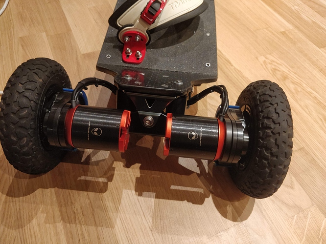

To my surprise that printed pulley are not whats getting worn out but the aluminum motor pulleys :flushed:
Will be ordering gear drive and new motors soon. Will definitely go sensored as I get quite alot of cog as soon as I try to start on soft ground
You could have a look into AS5047 encoder instead of buying new sensored motors if you go gear drive. The etoxx drives have the add on option for the encoder slot. 2x encoders are round about 40€ on mouser I think.
oh sweet! Had no idea really good to know but need new motors as these have a 8mm shaft that I grinded to get the flats for the grub screw so wont work to good with new Etoxx gears i suspekt
Depending on the motor gear teeth count and bore I think etoxx does use grub screw too.
Anyway, it’s just an option to take in account.
Nothing bad in buying new motors :sweat_smile:

Haven’t been riding enough because of kitchen renovation but its all done now :slight_smile: Ordered geardrive, new motors and trampa barrels.

I had the 9.xxmm titanium hangar so had to get a new truck from trampa. But it seems like all the trampa hangars come machined square therefore the drive was really lose and you could wiggle it quite a bit. The screws fixate it good and hopefully that will be enough but the design of the drive should be updated :slight_smile: Also got some new rims while at it!

What is the size of trampas square?
I will see if I can measure it without taking the drive appart when I get home :slight_smile: But @Trampa might know this directly
The CNCed ones are 19.5 x 19.5mm

Hey, I gotta check are all the trucks CNC’d square now? When browsing your site I can’t find anything on it but my invoice actually says INFINITY CNC ATB Hanger - 12mm SOLID axles but I paid the price for a none CNC did the system mess up and I actually got the wrong truck or do you CNC all now? :slight_smile: Looking at the invoice made me super confused lol and I can’t find back to the exact page I ordered as I could choose a CNC baseplate then
I think they are all CNCed now. Old Stock should be sold and new stock is CNCed.
ah I see like I suspected then :slight_smile: Might be a good idea to update the site :joy: Would be a real bummer if you get a CNC truck and your mounts wont fit. Mine are definitely on the edge.
