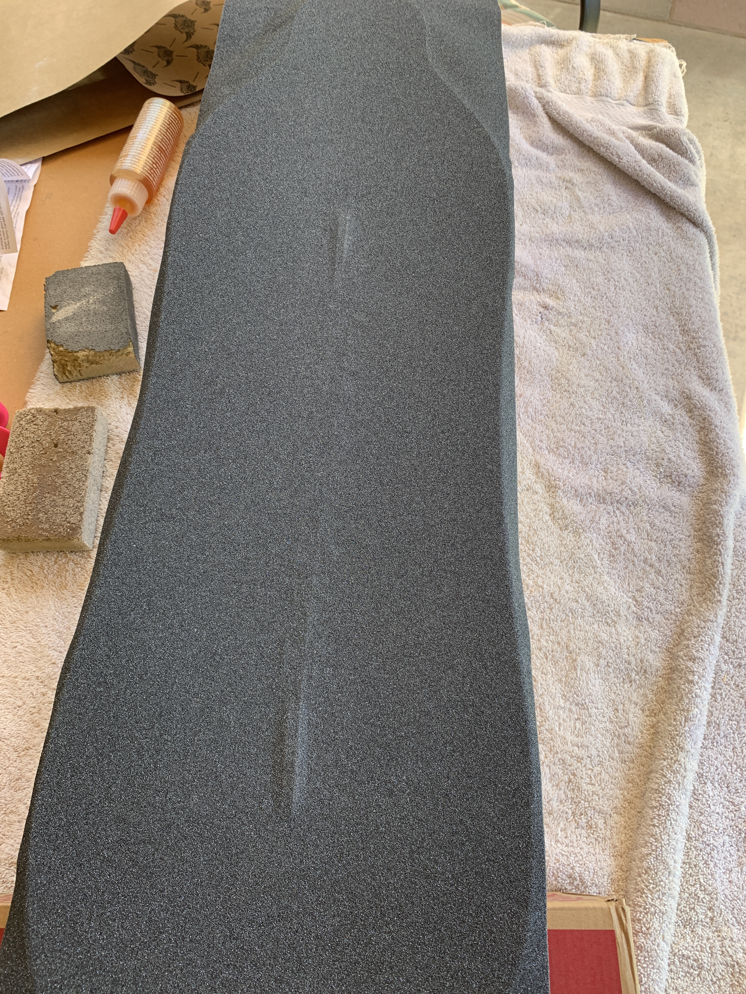

If this doesn’t say noob work then I don’t know what does, but as you can see I had some trouble epoxying the wires down, but at least the grip tape looks good. I’m not exactly happy about the wires showing, but it super fun to ride and that’s all that matter.

Also, this might sound dumb, but adding some foam padding below the grip-tape might be enough to hide those wires :smiley:

Oh ok, I’ll try that, thanks. Dang wish I knew that before lol. I think I’ll just live with the wires showing, and maybe in the future switch out the deck or something. I’ll look into that. Luckily, I haven’t yet. Most the time I’m just cruising at 15mph and I’ve only reached 22mph and I don’t feel any safe going faster than that :joy:

To cover up the routing you did on the deck, I’d just put a plastic film on top, then tape it down, then grip tape.

Okay, I’ll look into that. Think I’ll use it as is now until I need to change the grip tape. Thanks though
