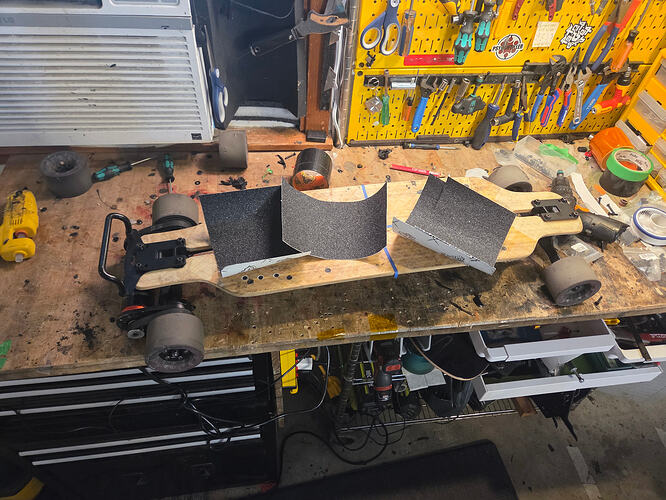

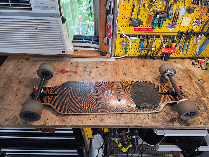

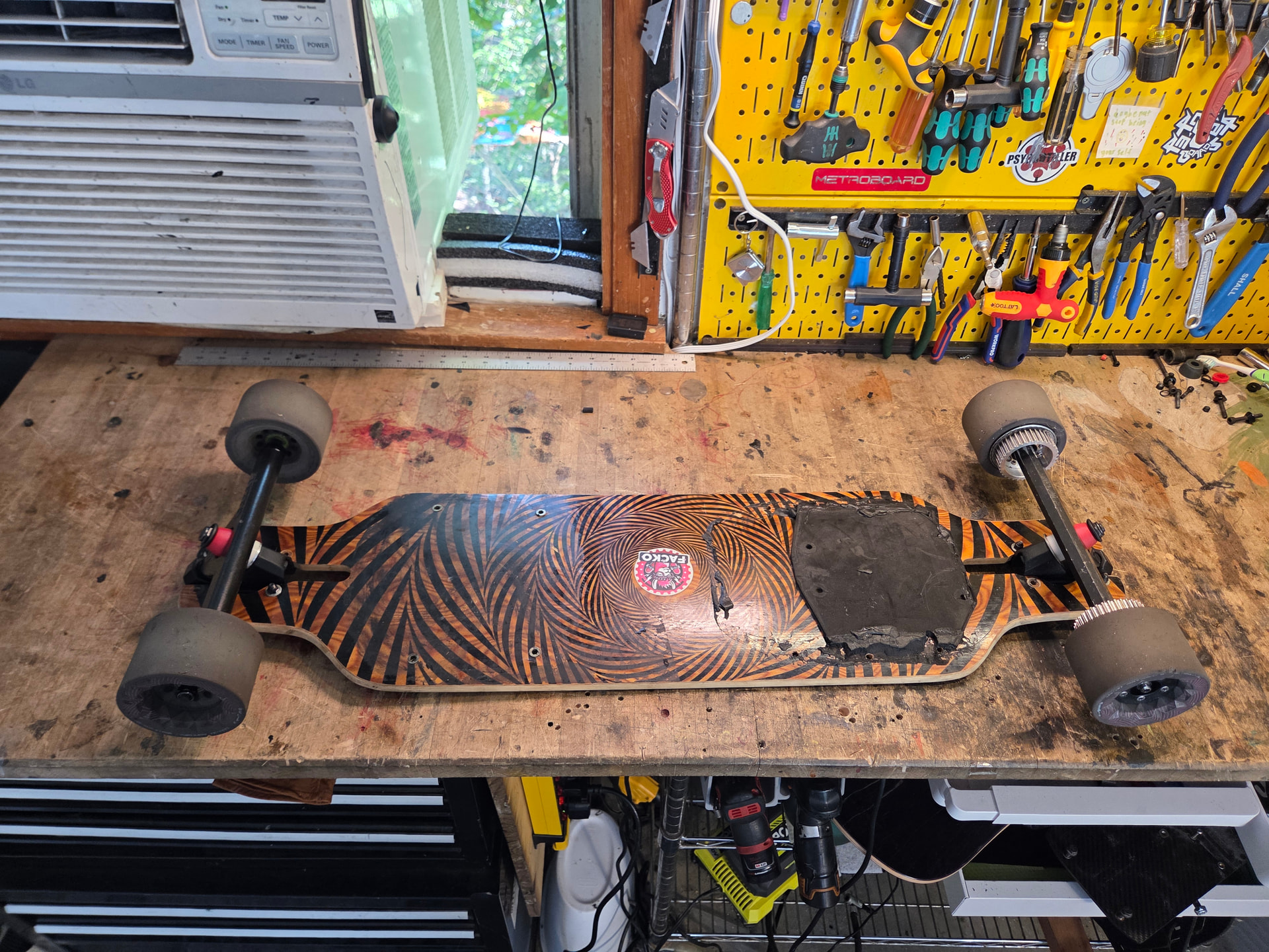

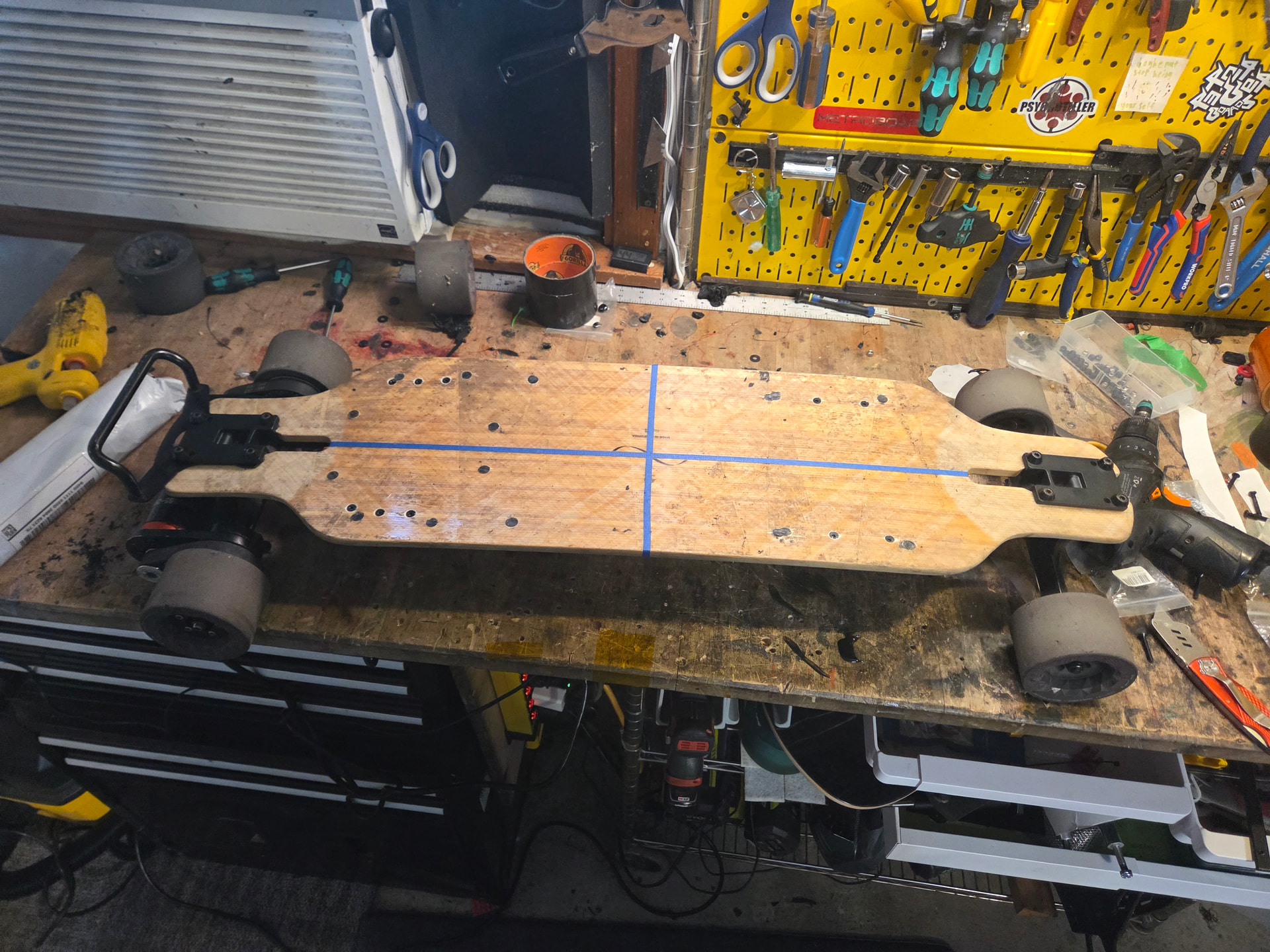

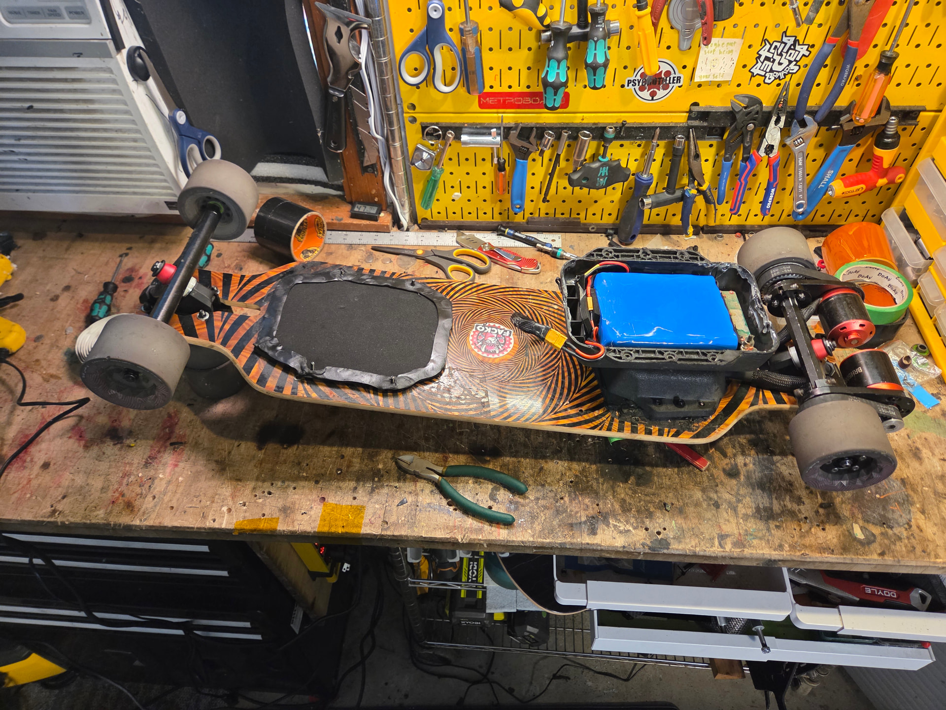

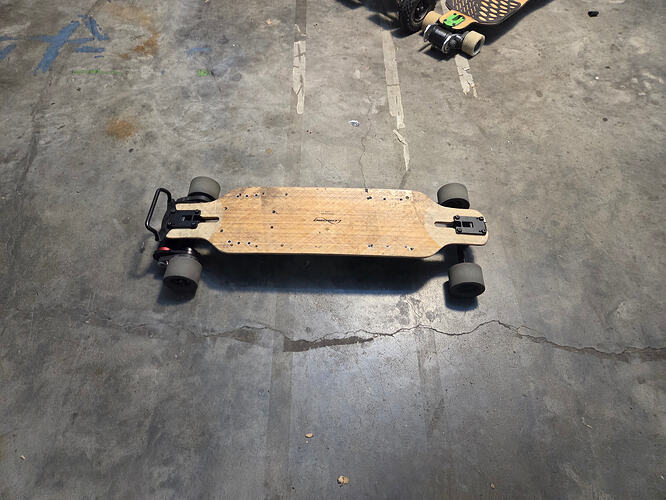

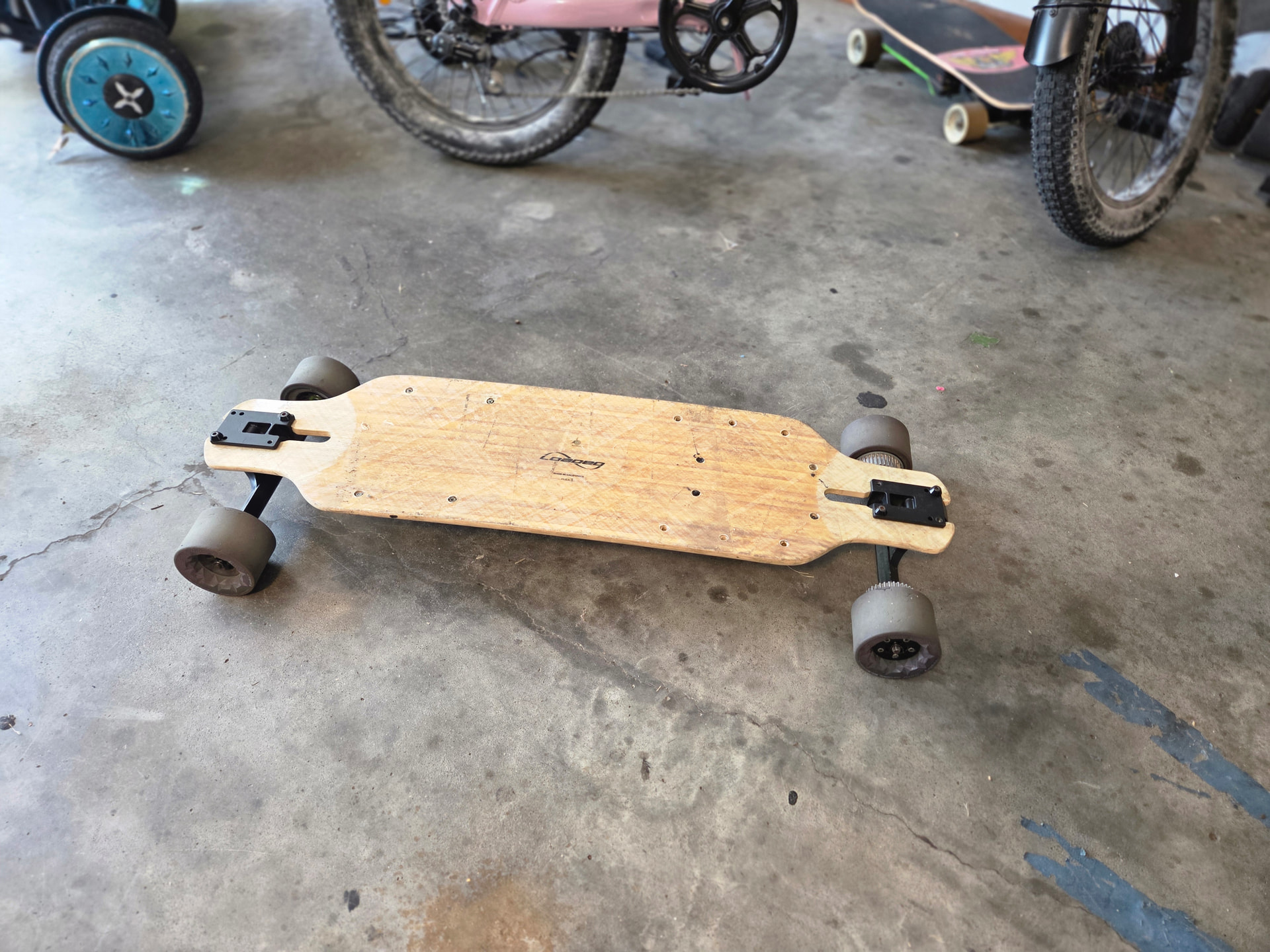

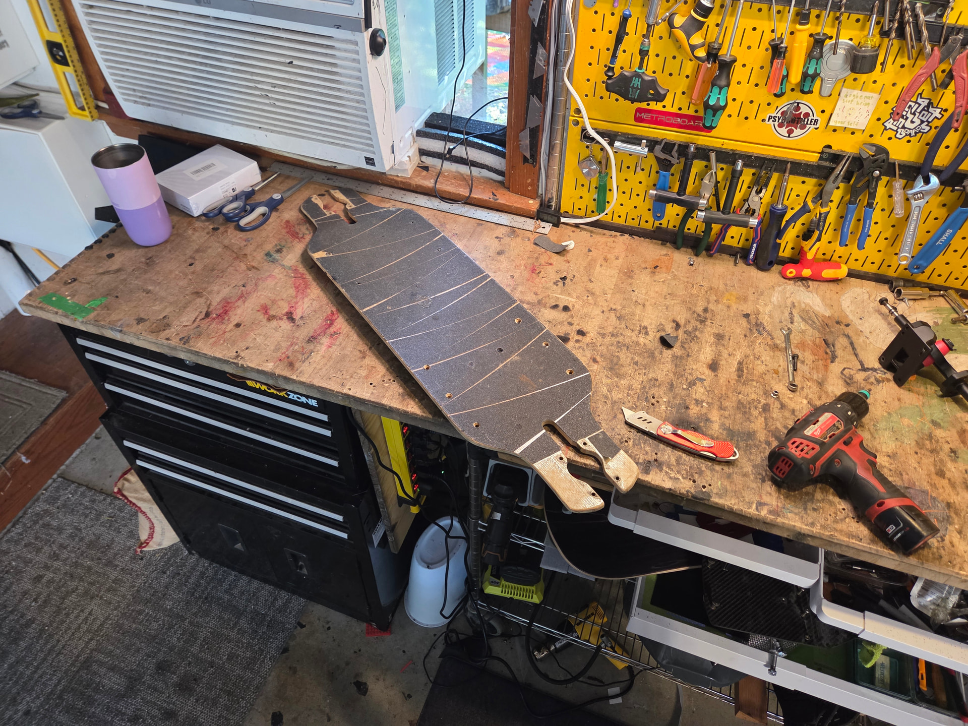

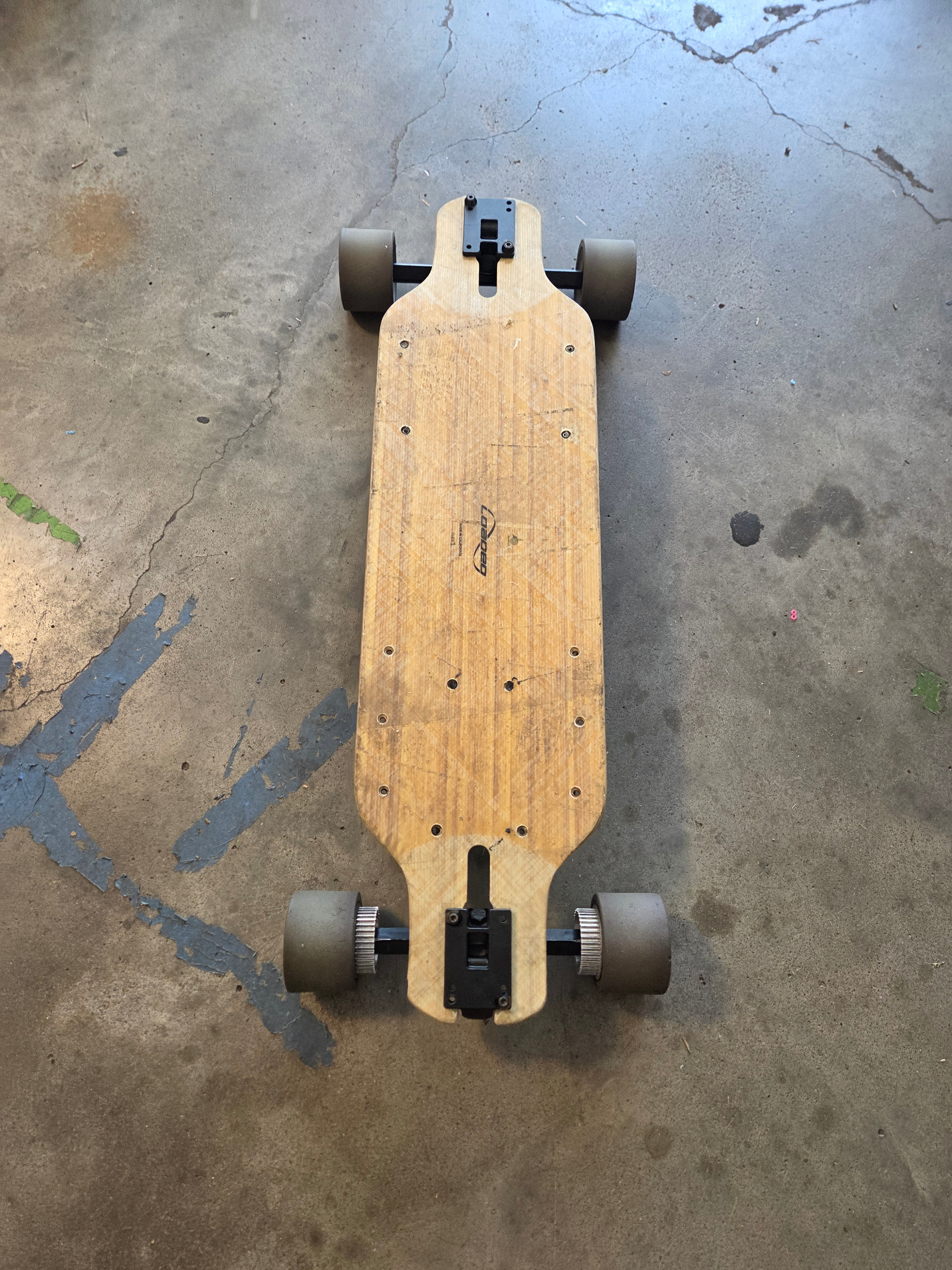

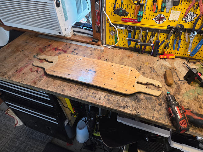

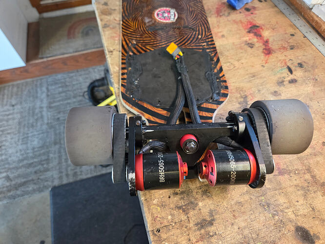

Today I’m building a tiny board for one of Luca’s buddies.
I had all the stuff laying around… except for the VX4 Pro… that I’m stealing from myself for now.
I’m using the little Tan Tien board I had for Luca before the Rayne.

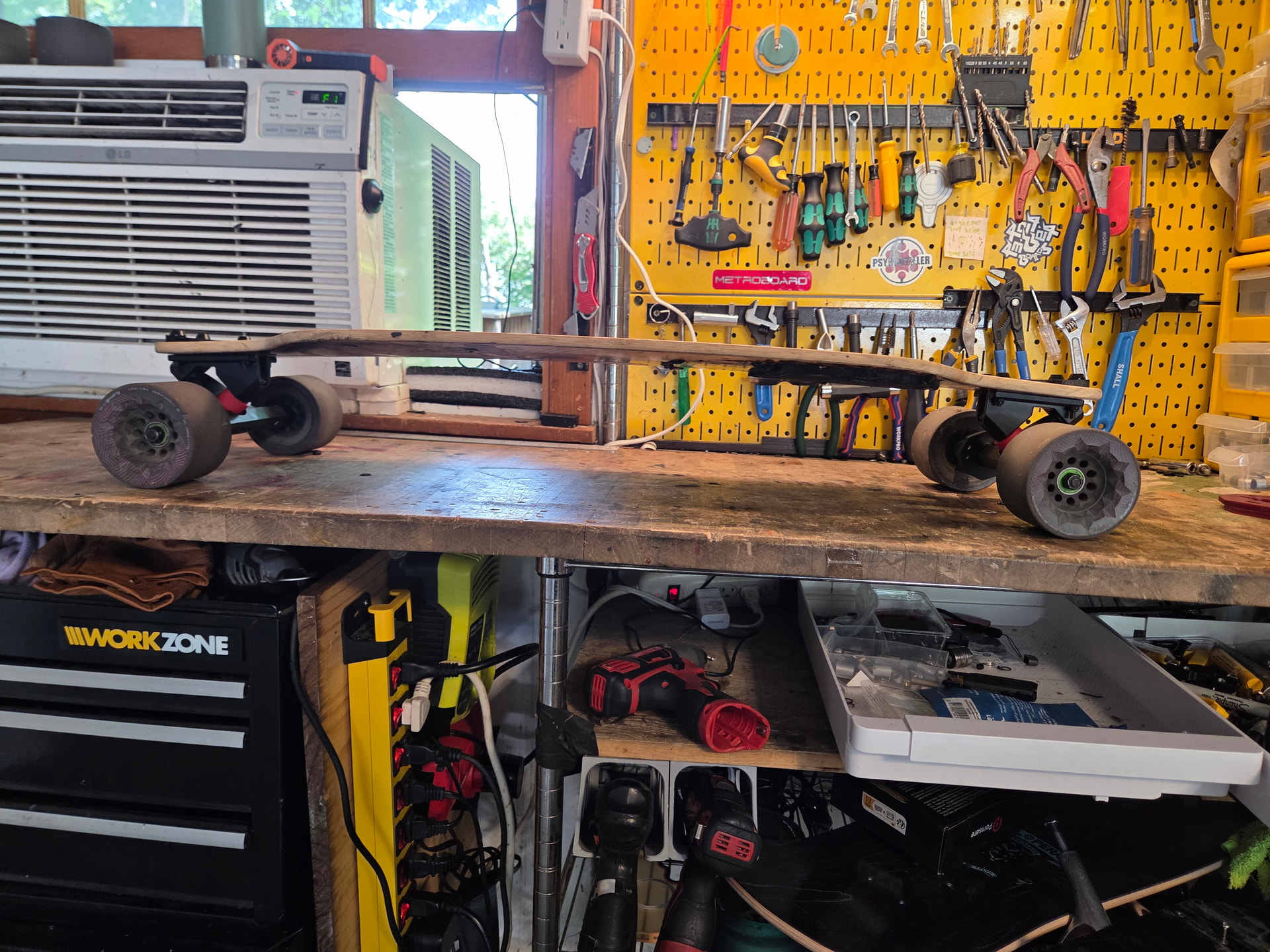

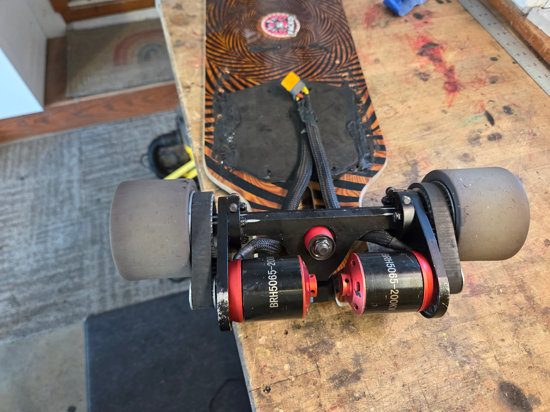

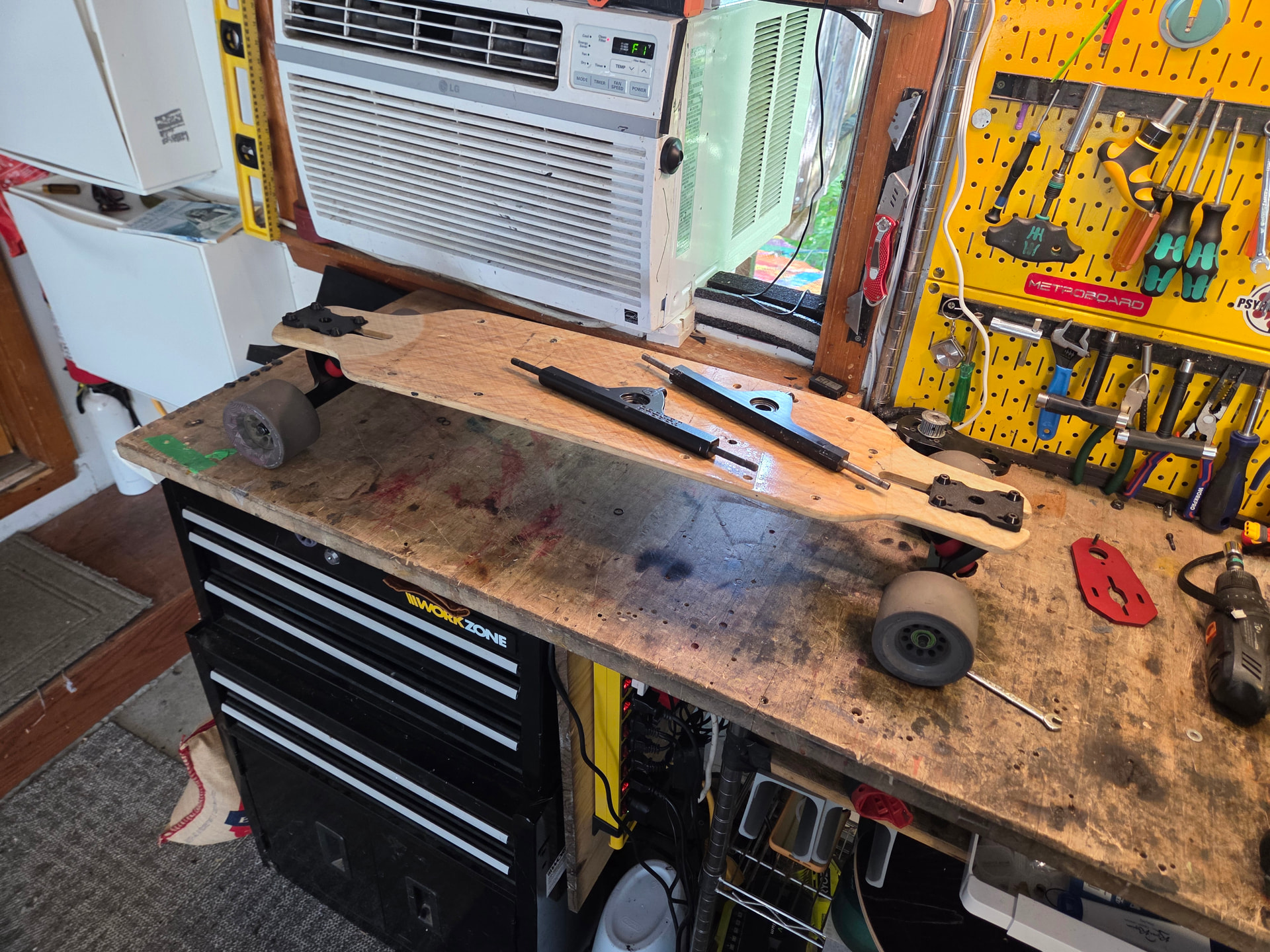

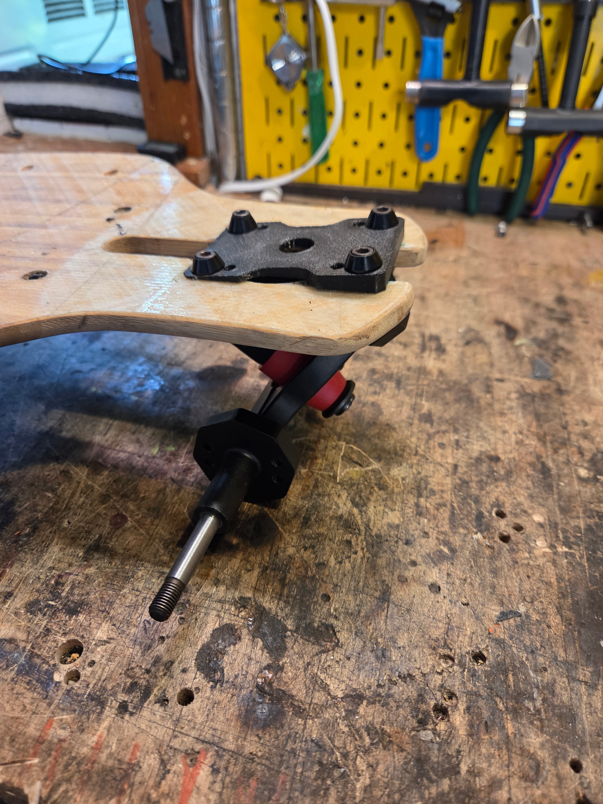

I batted around between bkb 180mm trucks and 220mm…
180 had to be top mounted.. which is not cool. It was too high.

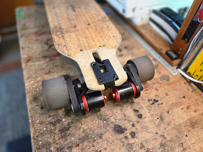

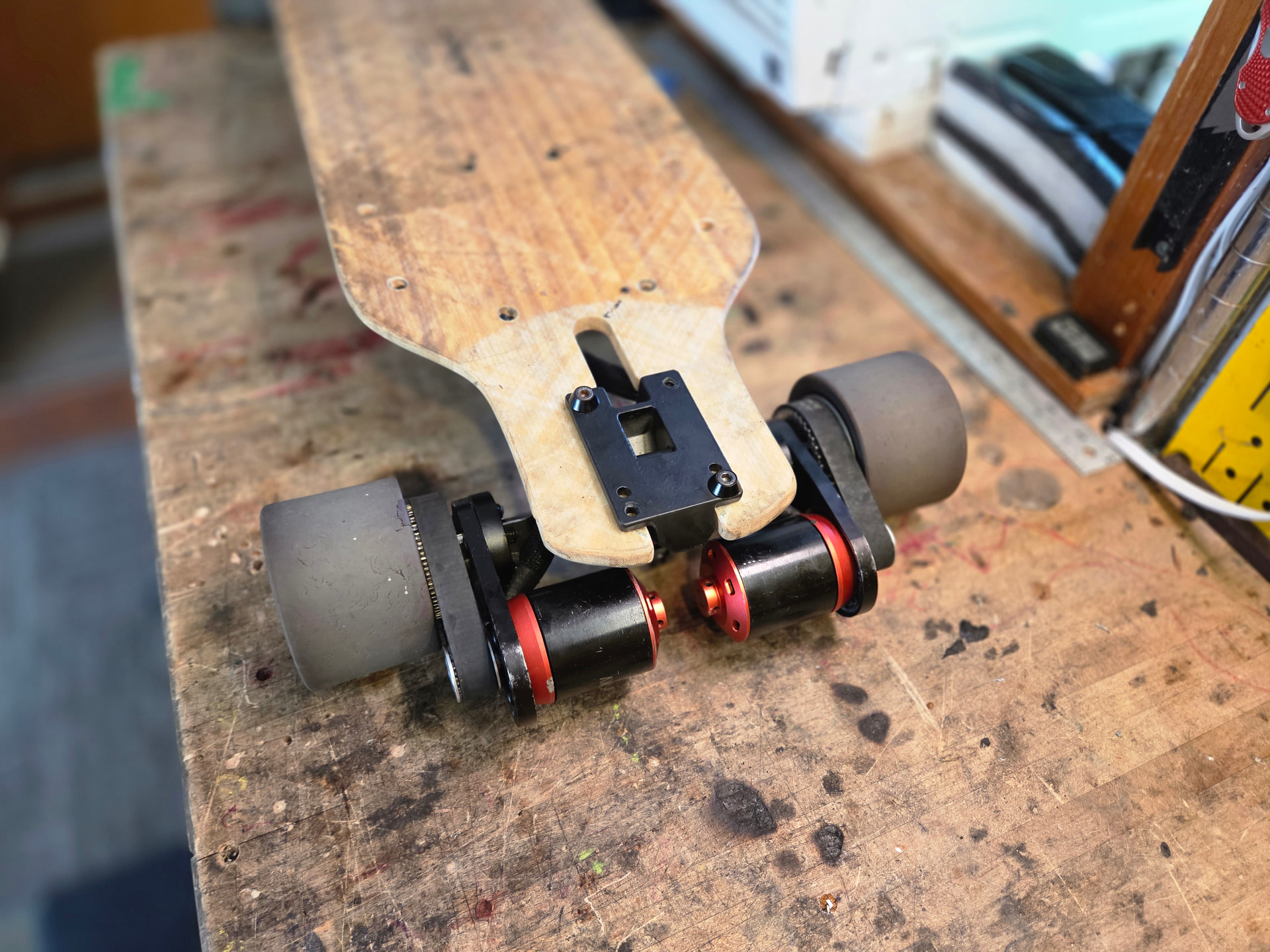

The 220s can go low…

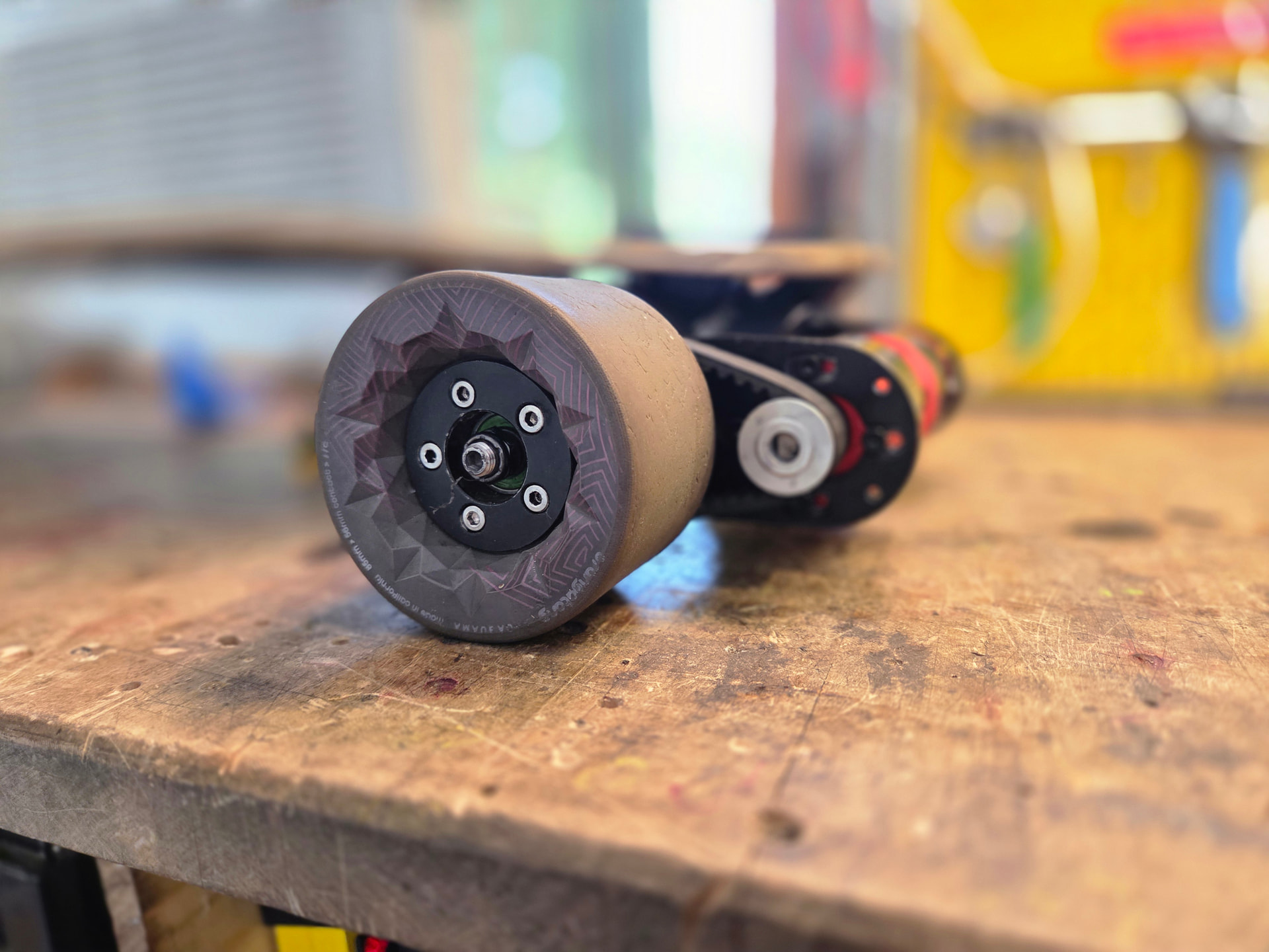

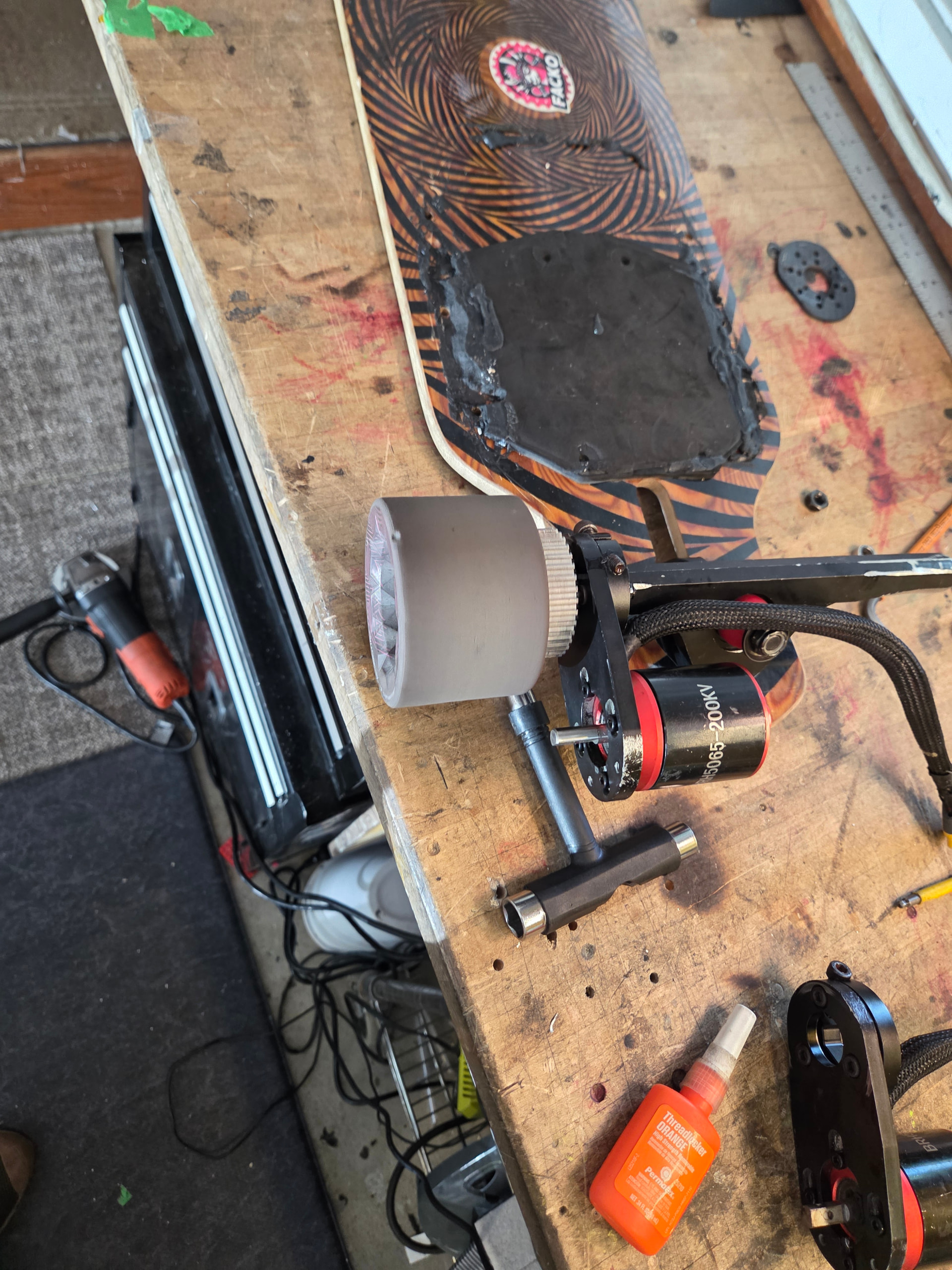

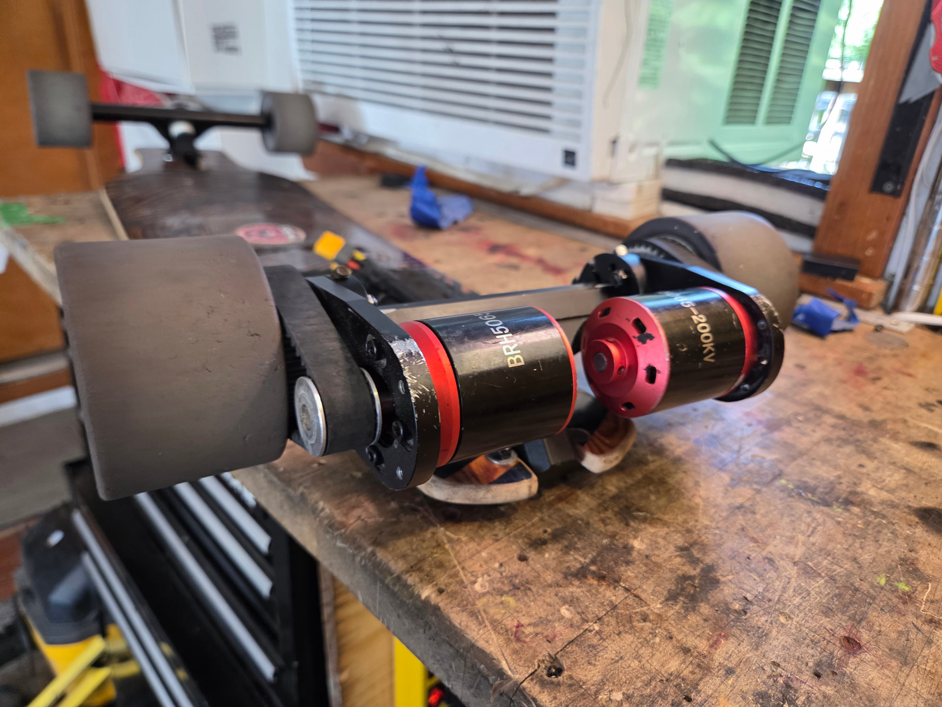

The 220 meant I could use the longer little motors instead of 6354s…
It’s way lighter and kind of a cool look.

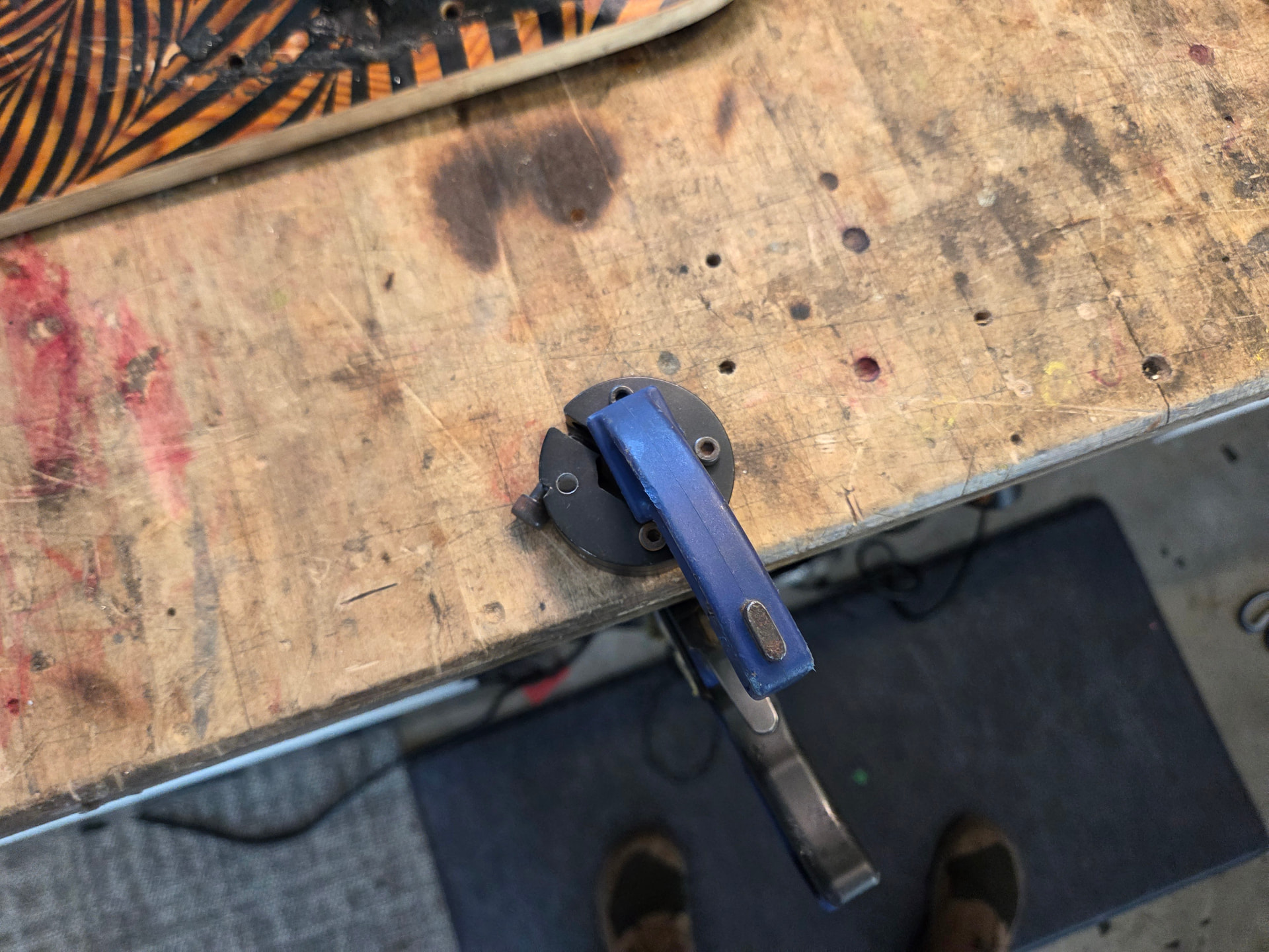

I had to hobble up mounts.
Mega throwback with the bolted wheel pulleys.
these are the really nice later design Dicky Ho ones.

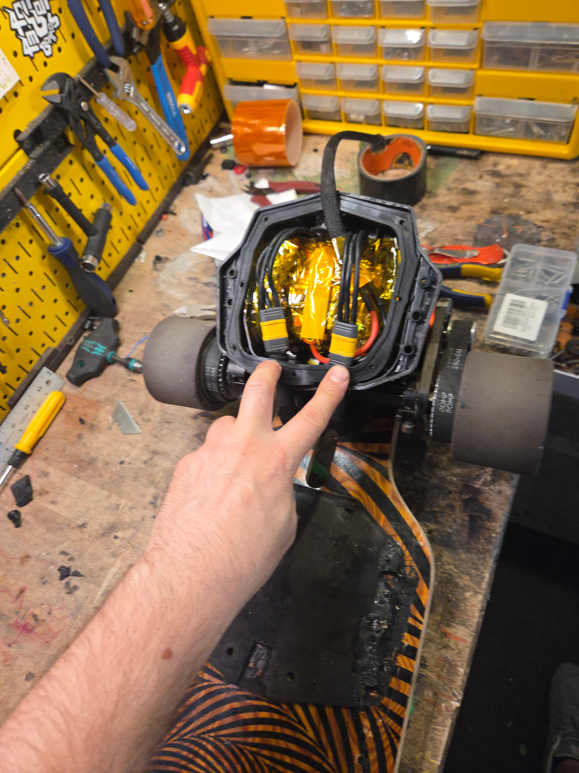

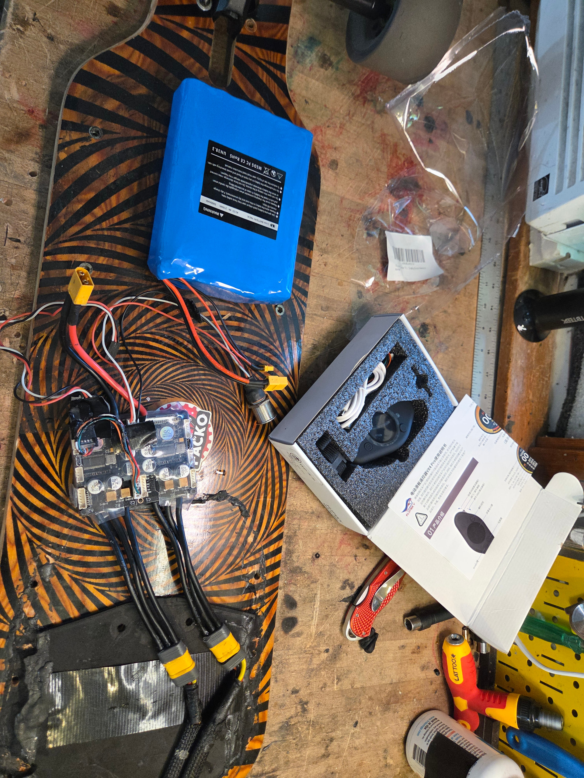

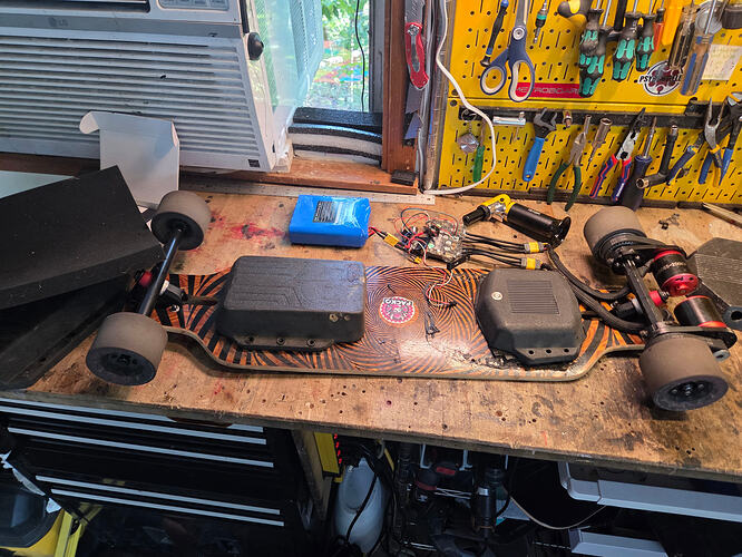

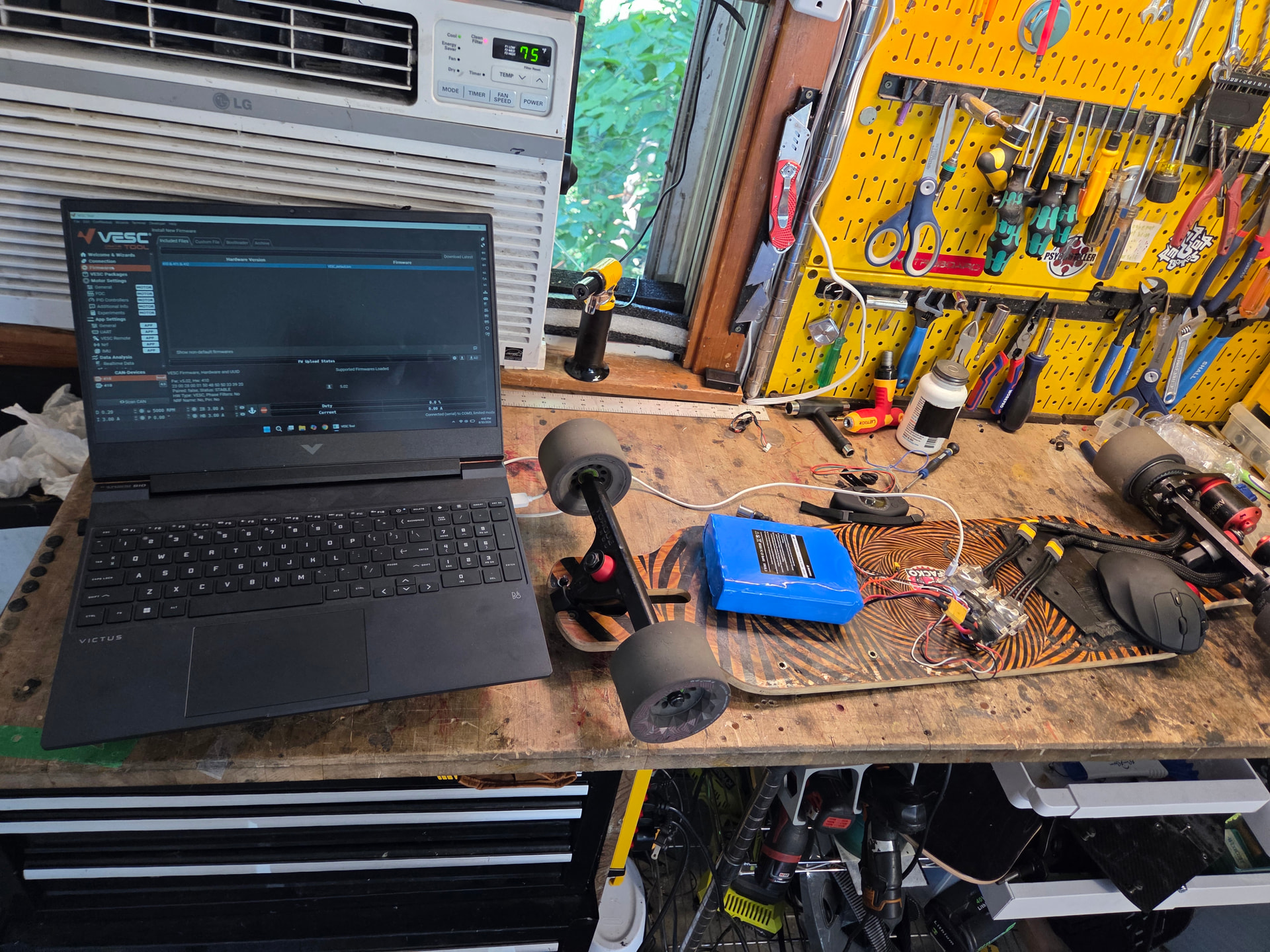

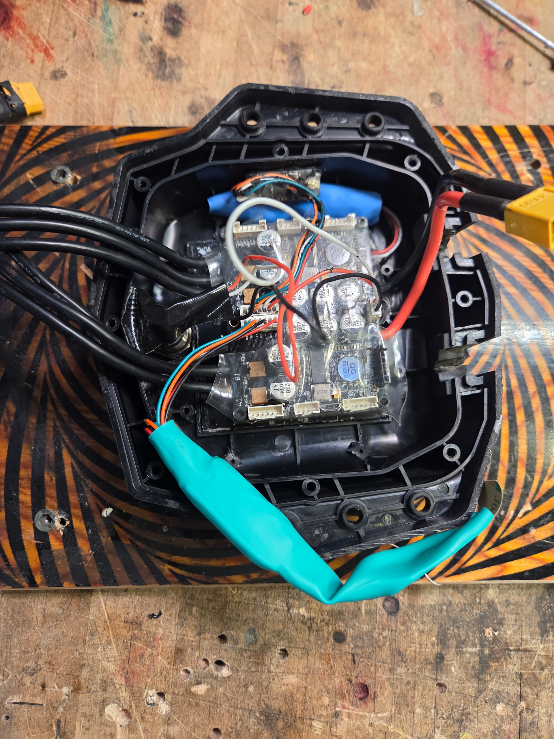

It’s a little 12S battery. And I’m breaking out old Flipsky Dual 4.20 plus ESC…
The VX4 Pro will be a nice touch to keep an eye on the battery and have different speed modes.
I actually broke out the PC to update firmware on these…
Omgigies.
Slowly but surely the little board came together and it turned out so awesome!!!
All the electronics played well together.

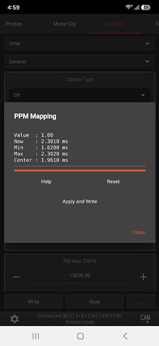

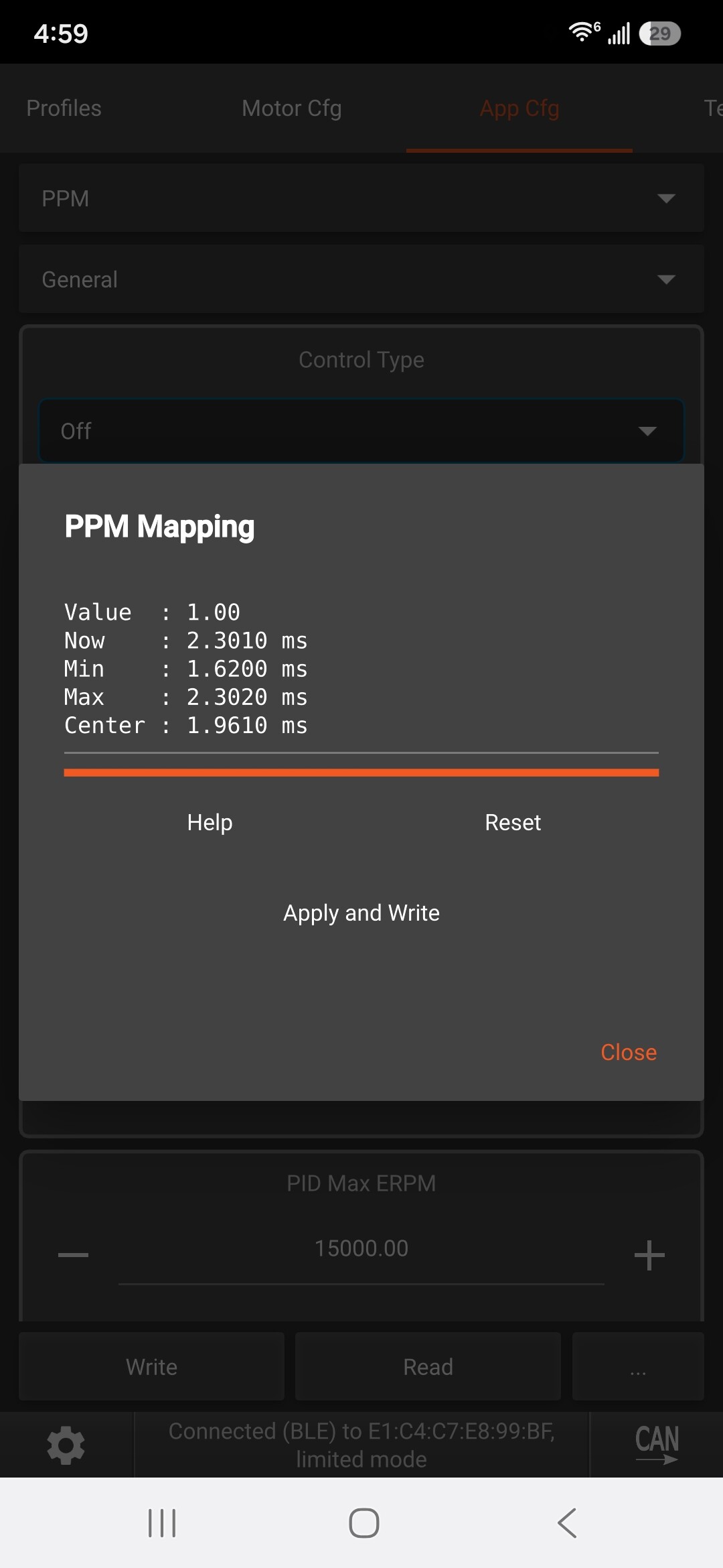

It takes me a couple of extra steps on the VX4 Pro to get it to actually move the throttle… like I have to go into the menu and calibrate the trigger and change the Vesc type… I am unsure of the exact sequence to follow so it’s a little frustrating… but it is working fine now.
I wanted to use the nicer remote to have the battery showing. And to be able to change speed modes… and it’s tiny and easy for a little person to hold…

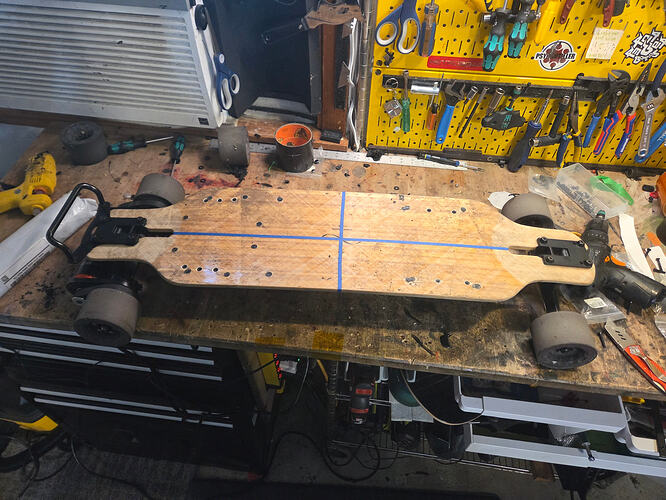

I had not settled on enclosures… and I thought about 3d printing some…

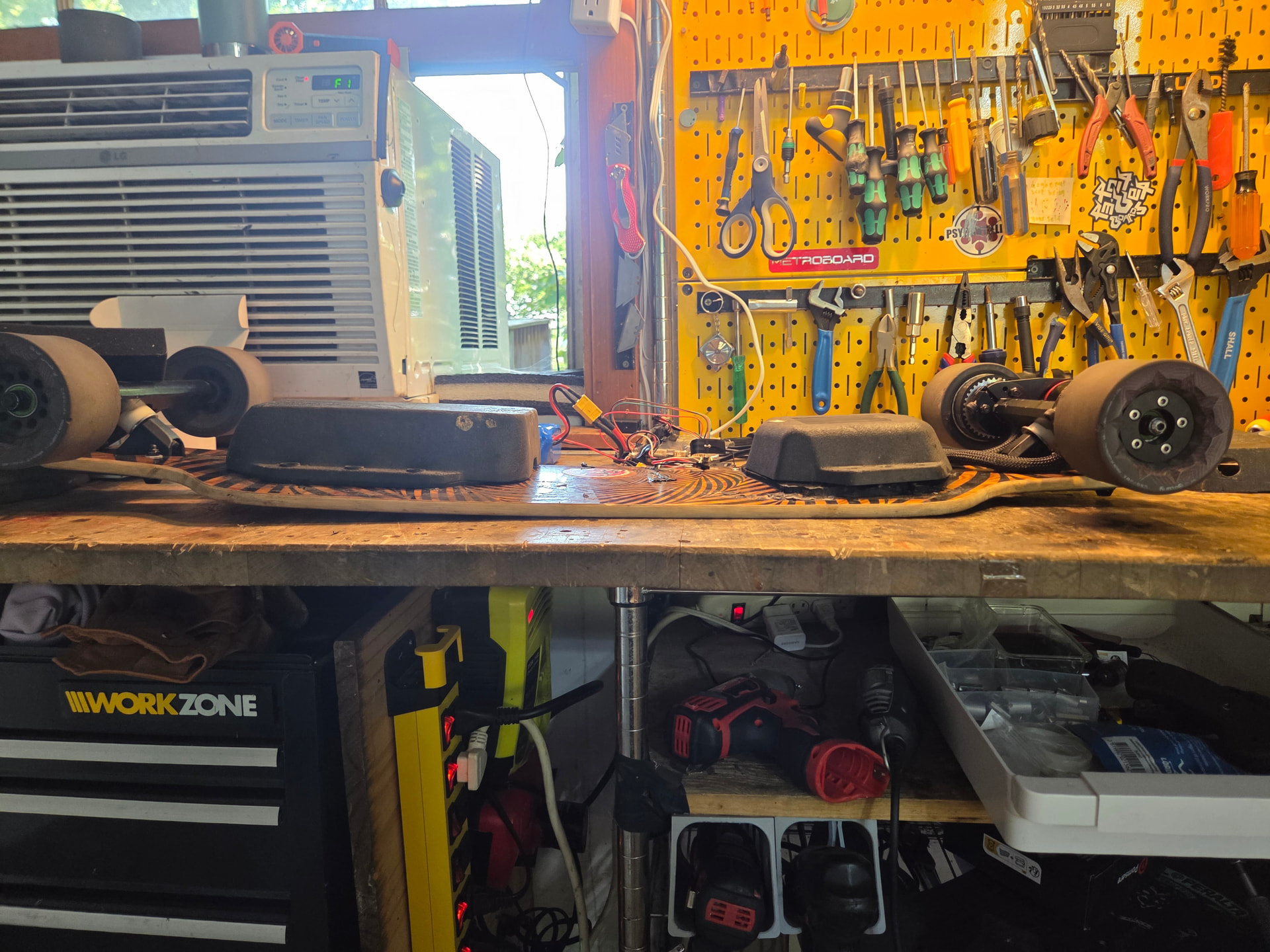

But I decided to be lazy and use stuff I had in the basement. So I am going dual enclosure with a Meepo battery box and a Backfire ESC box…
Once upon a time I had fit a Unity in that enclosure. the Flipsky 4.20 Dual Plus fit ok…kinda crammed. I did not use the bottom plate for the box…
A few holes through the deck and a little butyl here and there and we were good to go!!!

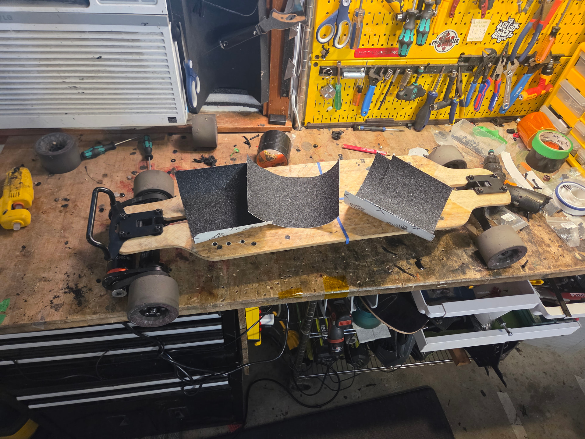

Just needed to clean and grip…which took some doing…
I do this 4 piece thing often because it is just easy.
I am super happy of how it turned out for this little deck!!!
The handle was a last minute addition, but it is so great on here. Really practical for picking it up.
But awesome bonus is that it stands up now.
So good.
I expect to give it to the kid later on today!!!

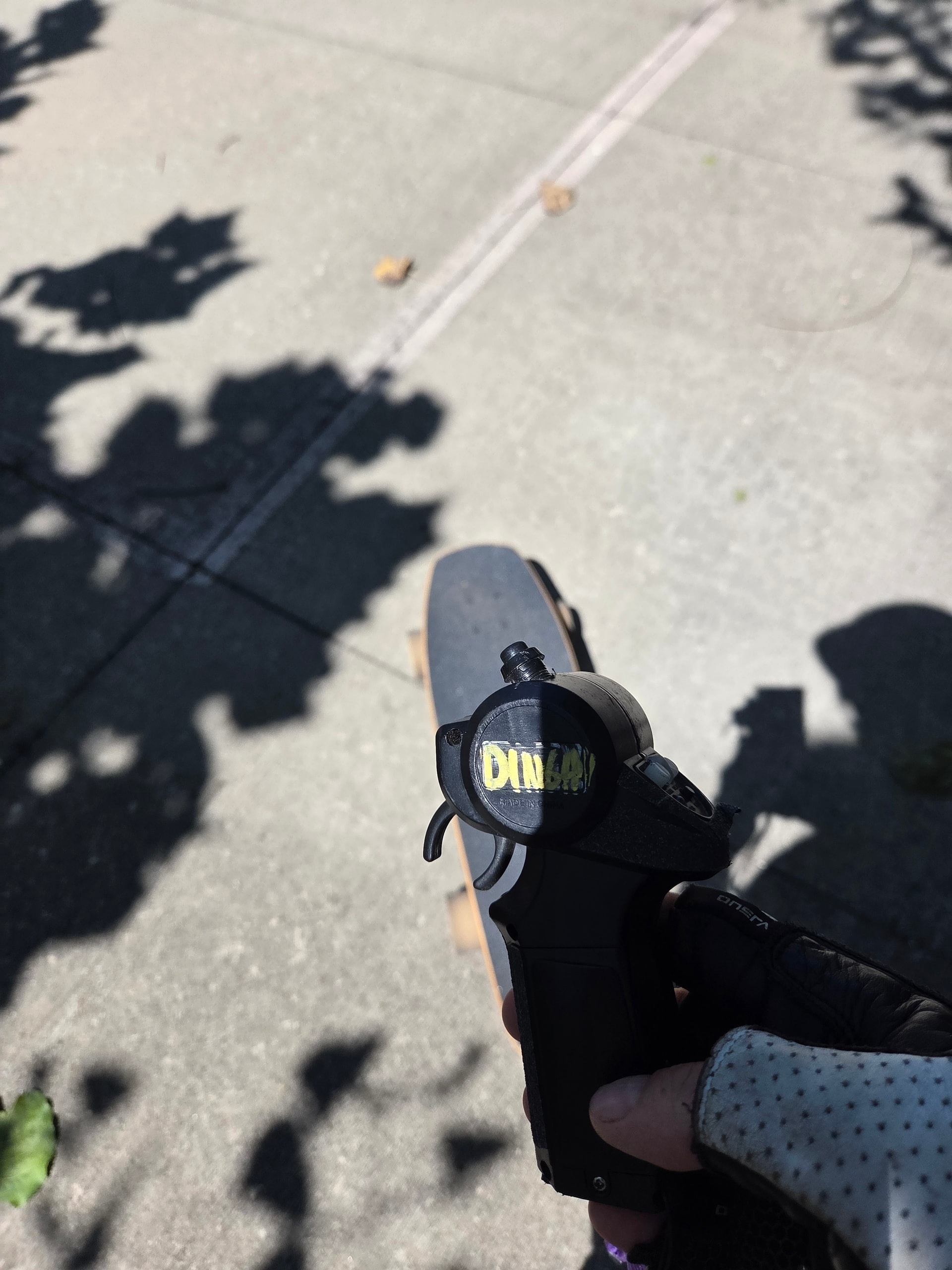

And not too far away from home the remote is spazzing a little bit.
It an old mini remote…
I turned it off and could not turn it back on. I suspect bad batteries.
I had actually thought about bringing extra batteries.
I did not think of trying to use the app as a remote until I was really close to my house..
I did try and it did not work on this set up…
So yeah.
Remote drama… I have a bunch of VX4 Pros on the way …
I am going to have to open so many boards….

But the current deal breaker is the possibility of it making a board ghost is the remote battery dies.
Total deal breaker for me.
I have seen boards ghost 3 times… 2 esk8s and my onewheel.
Nobody got hurt thank goodness… but I could have possibly killed someone…
Todays issue with my crappy mini remote was not a battery… but the shitty switch I put on there to replace super shitty switch it came with… sucks.

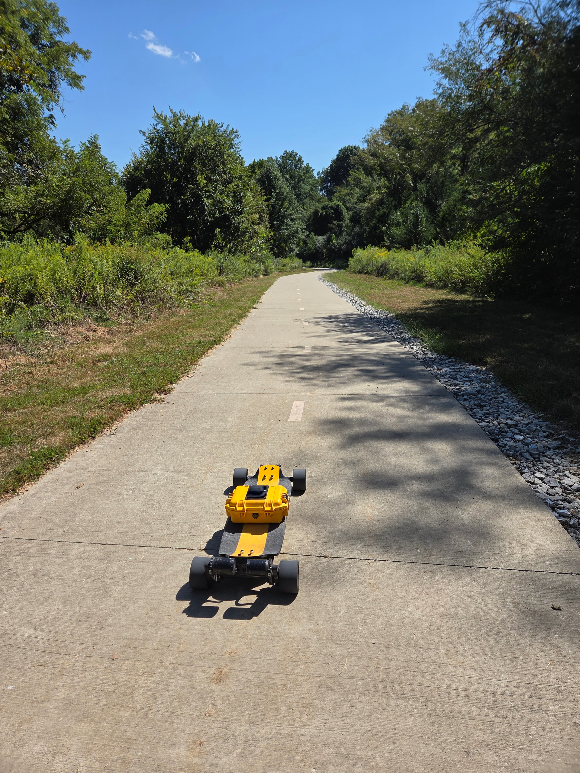

The Benny Mobile is awesome.
The little bro hung out last night and rode it home.
He is pretty tentative still. But I really think having a throttle and brakes makes skateboarding more approachable.
I am still so stoked on how cute it turned out…

I had my first big scary lapse in trigger direction with the VX4 Pro…
I was out on a family ride on the Rad Lac. Rolling down a pretty good hill.
I just wanted to slow down a little… but went the wrong way on the thumb wheel…
Accelerating was scary and I realized what was happening and corrected it….
It was in a situation that was manageable to recover…
And it still sucked…
I wonder how long until the thumb wheel becomes second nature.
Because all the triggers have got to go…

Have you considered just… committing to that? If it’s what your brain wants to do, maybe don’t fight it. Should be simple enough to program in your vesc.
You know.
I actually had that thought for the first time today…
It may work just flipping the vx4 into reverse.
I am not sure if I can achieve it the same way on the loaded kit.. but probably…
