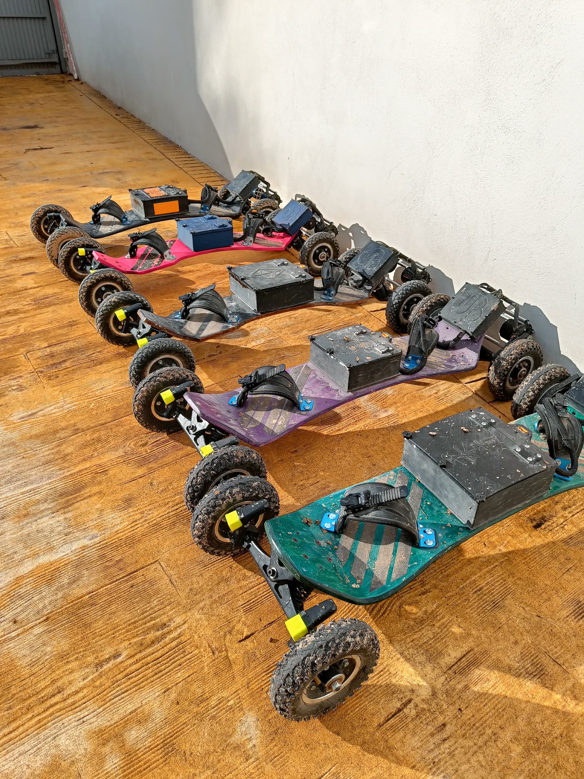

Hello there. This post is part investigation log, part asking for advice, part ranting. I’ve been pressing my own mountainboard decks for a while, having great success with them and our modular mould that you may have seen around here:

Well, some of the boards are showing cracks, specially around the truck mounting holes and inserts

My decks are 9 layers of pure maple from roarokit (2 cross grain). I live in Spain, specifically in a very dry and hot region in the summer (we regularly hit 40°C). My theory is that the outer layers dry very quickly while the inside holds some moisture, causing the cracks along the wood grain
Things I’ve tried
  • Letting the wood acclimate before pressing. Not effective and also I cannot let it dry too much or it would be impossible to get 35° tip angles without breaking the veneers
  • Letting the deck blanks slowly dry in a semi-controlled environment for a few weeks before sanding and painting. Less cracks, but not enough.
  • Filling the cracks with epoxy, sanding and painting again. Works, cracks do not become bigger. A pain in the butt, a lot of work and ruins the finish for the decks I’ve chosen to stain instead of painting.
I’m starting to think my only option is to glass the decks, sealing them completely and reinforcing the outer layers. Maybe I’ll have to remove one veneer to keep the flex. What do you guys think? How would one go about adding the epoxy+fiberglass? (preferably not infusing/vacuum bag, but something simpler)

I would assume that the cracks are a result of the veneers getting wet and then drying out repeatedly.
To avoid it I would suggest as a bare minimum to try and seal the outer faces of the deck with a weather resistant coating, as well as trying to weather proof any holes or penetrations in the deck.
Fibreglass will more than likely stop it from happening as well, but I don’t think it’s 100% necessary if you can seal the deck really well with another method/product.

Thanks for the insights! I though I had sealed up the wood well with several layers of top coat, but it’s clearly not enough. I know there are specific products that seal wood, but I didn’t use any before painting/staining. Also the stains are all water based and very thin, which only compound the issue.
I’m gonna probably try the latter method with my next deck, or even seal the cracks on my current one with tinted epoxy (might yield an interesting result aestetically) and then apply the fiberglass to do a little test. Let’s see how it goes, I was pretty discouraged when this happened even though it’s only a “cosmetic” issue…pressing decks is a metric shitton of work (really don’t have to tell you of all people) and seing it ruined sucks big time.
Is there possibly a bit of double curving going on in your mould? These cracks look like cracks due to the wood being stretched a bit in two directions which is possible when its moist, but when it dries out will crack. this is why its difficult to add concave to a mountainboard deck. its already curved in the X-axis. The reason why the top and bottom layers crack first is due to the moisture leaving first, having it shrink on the top/bottom and cracking as a result in the most stressful areas such as the bolts, inserts and foot well, where the stretching and tension is most.
Try gluing your decks with epoxy, it does not absorb/release water as much as wood glue which should make your deck more resistant to weather changes.
