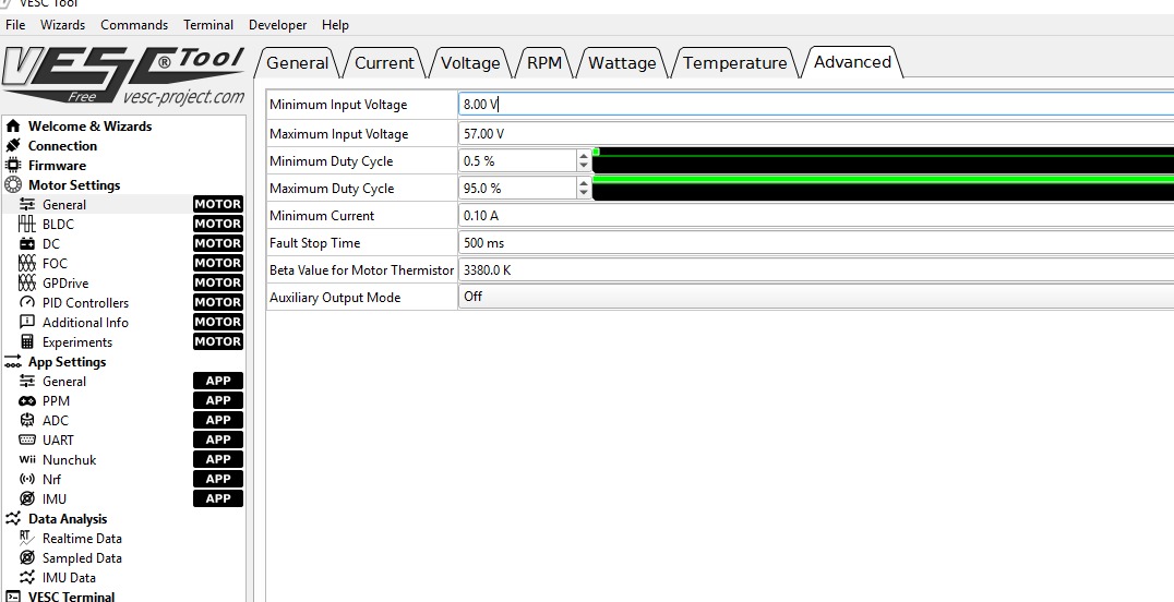

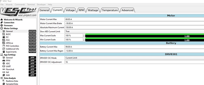

I’m helping a friend upgrade his MTB from those 150A car ESCs to a 12s battery and a flipsky dual 6.6 plus. BLDC works fine and he wanted to switch to sensored FOC. I’ve yet to try FOC myself but okay, I can follow a tutorial (regular vesc-tool 2019).

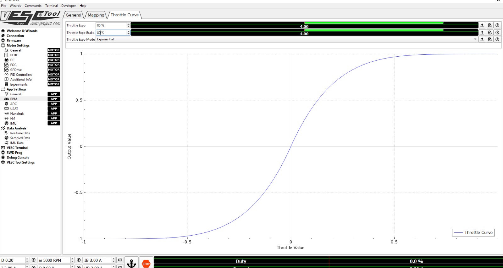

It sort of works but the acceleration isn’t great so we play a bit with the throttle curves, we get a little improvement but not enough for his liking. He basically want to be able to hill-climb. I’m not sure if that"s doable with FOC- go from a dead stop on a hill with good acceleration?
I can’t find the specific clip but I know there’s AT boards on FOC that can do offroad quite well. Yes, I know BLDC is better for that, more power, speed, etc. but he really wants FOC.
I’m pretty sure we’re missing something simple but I can’t think what it is. Any help would be greatly appreciated!

Also, I assume the 10Ah battery is a LiPo and can supply the required current.

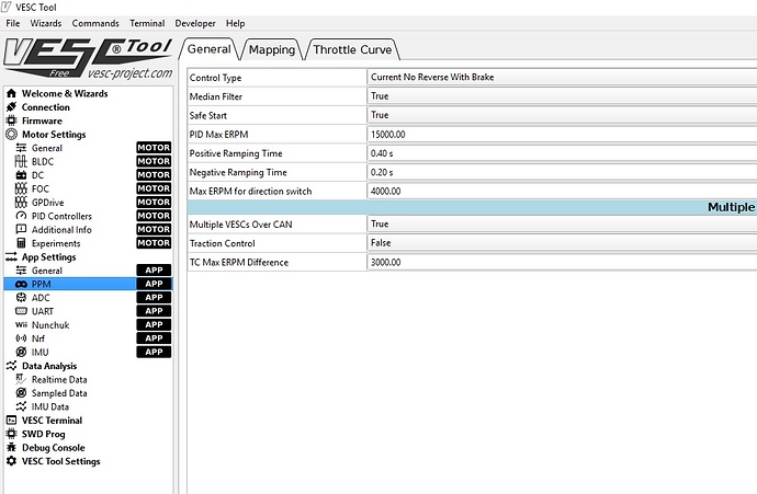

I think positive ramping is to low in reaction, I use .1 for pos and neg. Also agree with @Taz
