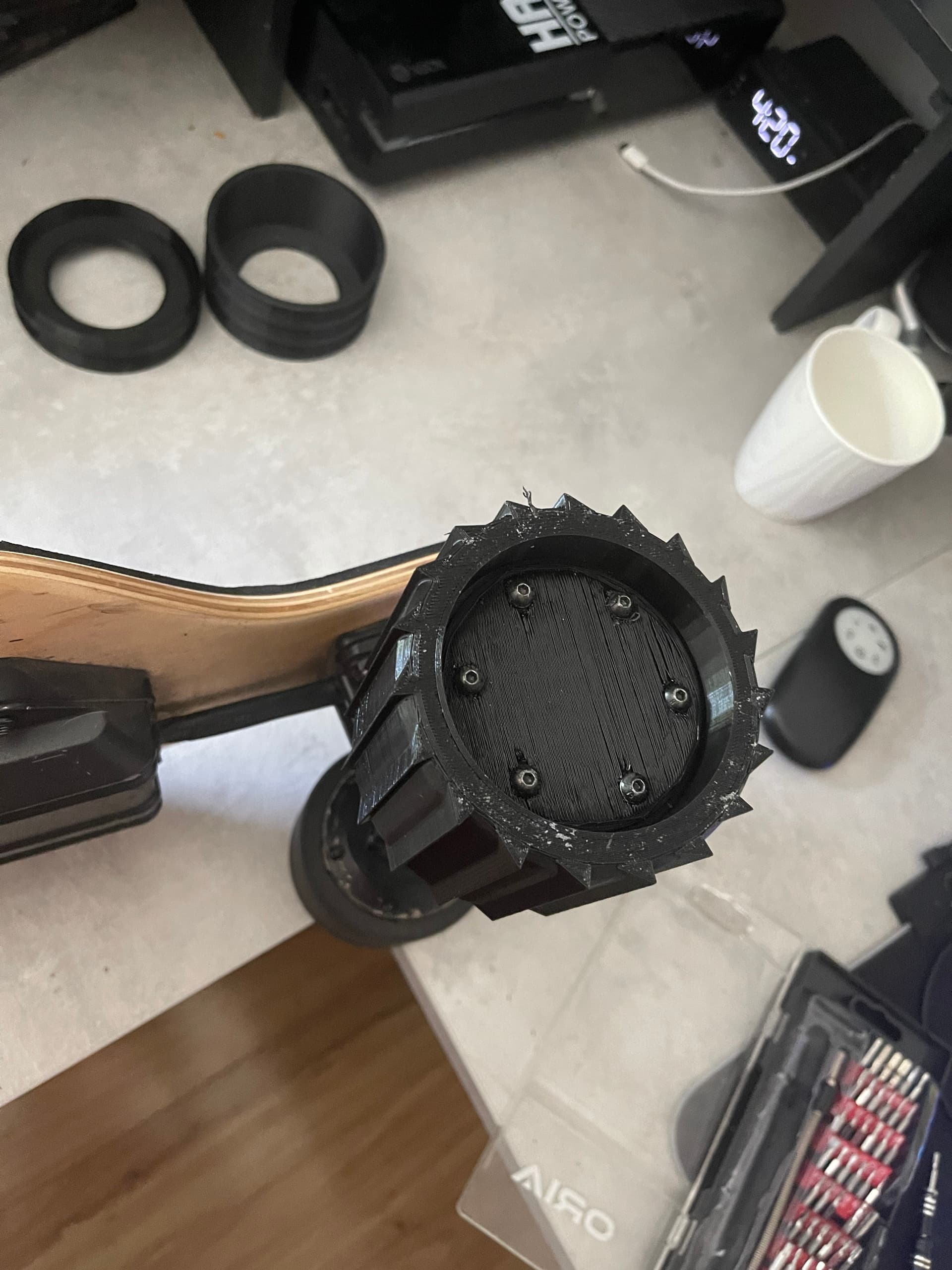

I tried designing a cover for flipsky motors that would completely seal them but lost interest.

Back in the day when i used the relatively open TB motors i printed a 1 layer tpu shell/sheith to stop debris and water from getting inside. They have a nice tight fit and don’t come loose while riding. Temps also weren’t really affected.

I wanted to make it so it attaches at the base of the motor, so the can freely spins inside the cover.
I wanted this gap covered also
easy fix, just make it longer. Mine did already go over the edge, but not fully because of the glue i put on where the wires are.
