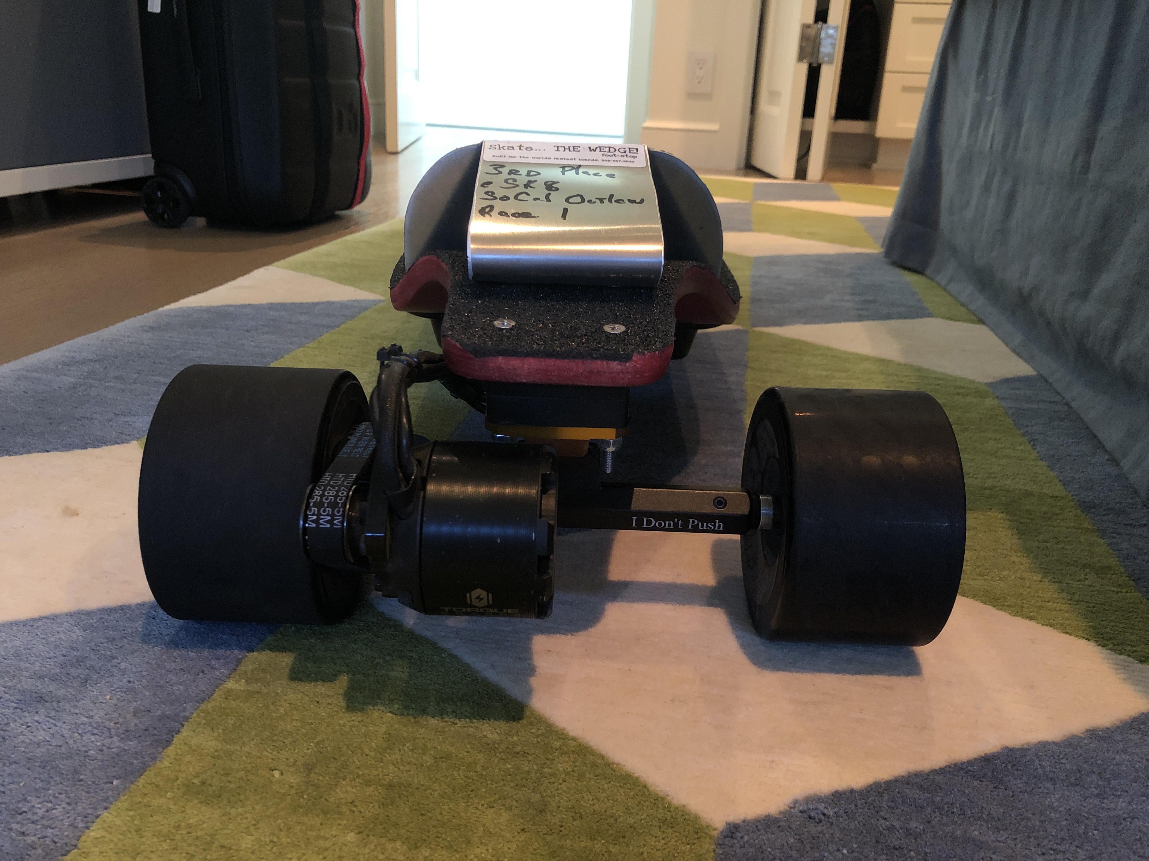

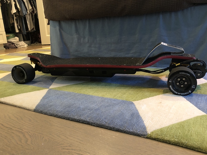

Hey guys! I really want to get the build thread of my latest/only build out bescause it’s going to be dope when it’s finished!
This is my baby now :joy:
So here it goes, this is (add name later @Brenternet).
So a couple of months ago I decided I wanted to rebuild/upgrade my old build.
I was gonna make it an E-MTB but I didn’t think that a TB 12s4p fit on a Trampa :disappointed_relieved:… So I bought some Surfrodz TKP’s, a Landyachtz Evo Falcon 36”, some TB 110’s, and some stuff from PT/Dave (@psychotiller )who has helped me a ton! Last but definitely not least, @deckoz for all the talk/help about evo’s!
You guys are the best and I now have an addiction to this forum and esk8…
Uhm yeah, thanks so much to everyone, here’s a list of who comes to mind… @mmaner for helping make a vinyl (more on that later) @sender for showing me fender washers and the awesome build threads. @yelnats8j for helping me when stuff goes wrong. @Psychotiller for giving me some dope stuff and always being open to my questions. @riptidesports for COMPLETELY tuning my board!!! Lucier for giving me a wedge footstop… More to come later
So onto my setup at the moment
  • SR TKP
  • 12s4p 30Q
  • Single TB 6355 190kv
  • 16:40 on TB 110’s
  • Landyachtz Evo Falcon
  • PT TKP Mounts
  • TB 4.12 Vesc
  • 1in Worth of Risers
  • Vicious Griptape
Top Speed : 35 (that’s the highest I’ve pushed)
Range: Est. at 25 miles of range
Future Plans
  • Jet Killshot 40.5
  • PT Jet Killshot Enclosure
  • 12s7p
  • Hexls
  • Dual 6355 190kv
  • Psychotiller Sixshooters
  • Focbox Unity or Maytech 100A Vesc
  • 1:3 Ratio
  • @sender skinning
Here’s da pics! :smiley:

Looks hot! Why did you decide to reverse mount the motor though? Looks like there’s plenty of room in front.
I kept hitting the bushing seats :disappointed_relieved:
