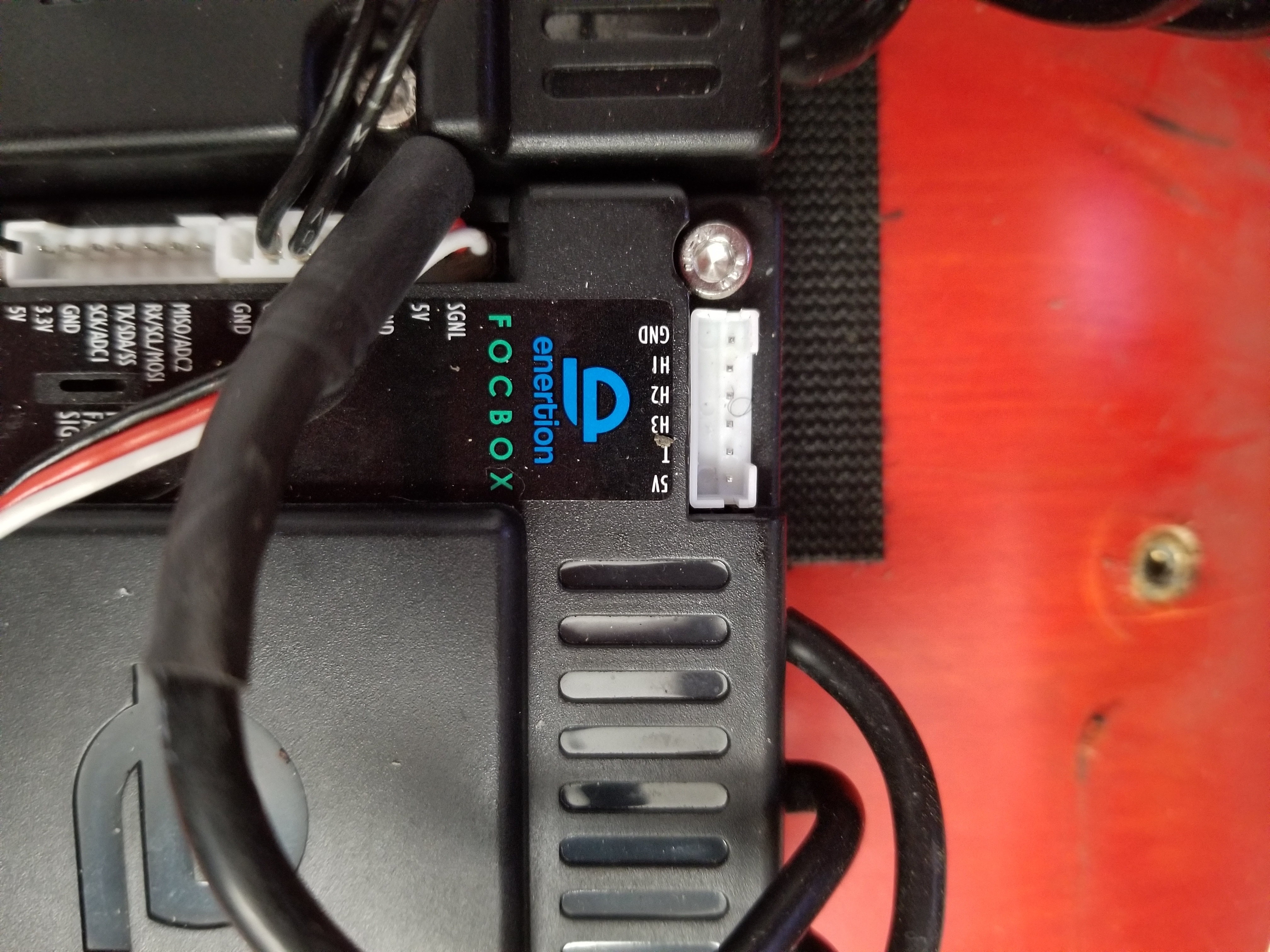

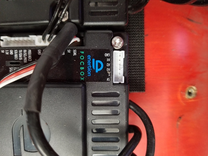

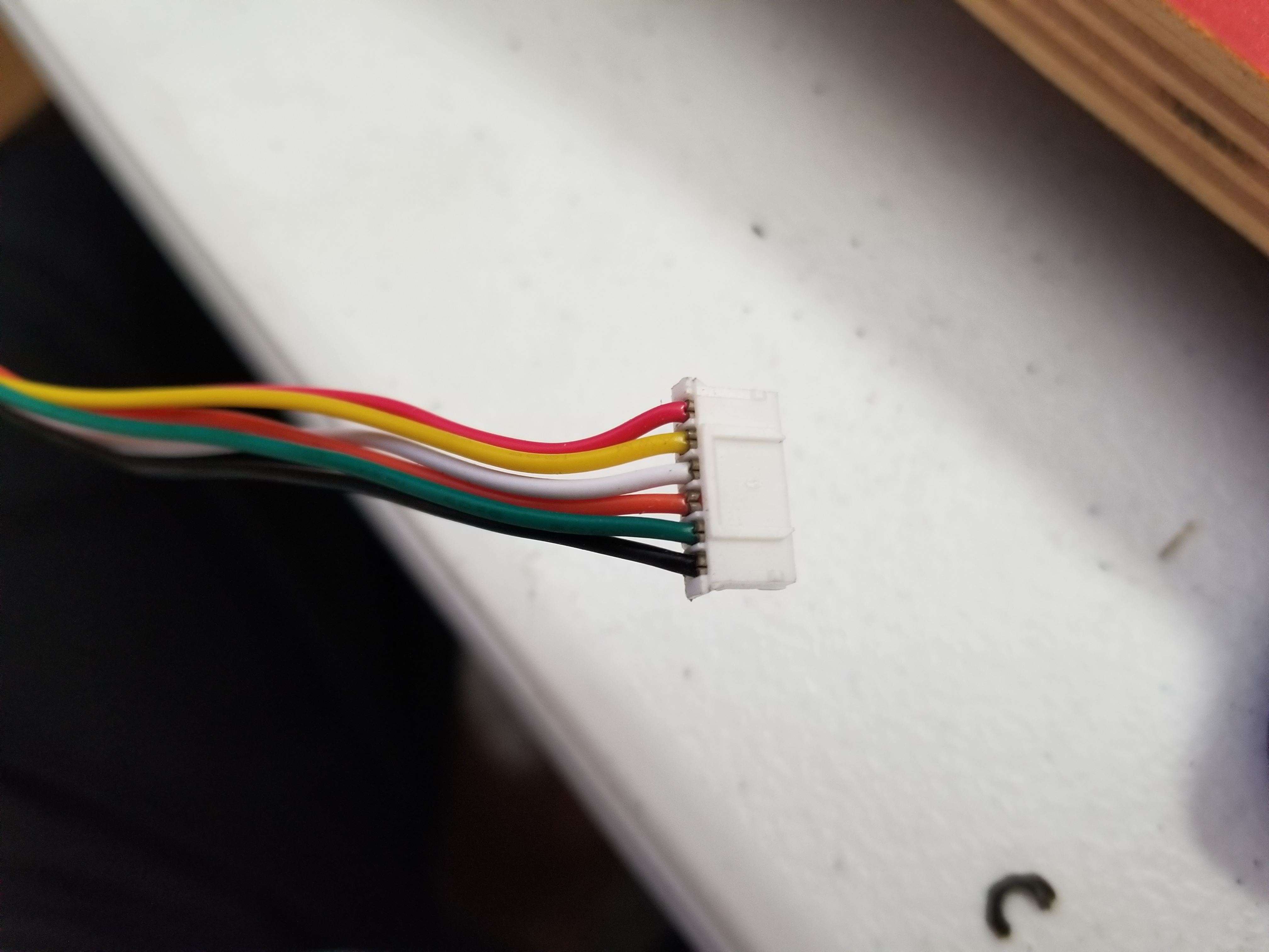

Does anyone know the color code order for plugging into the focbox’s? I am aware the plug goes in one way
My maytech 6880’s sensors are colored different but still have the same layout.
Thanks guys, these sensors must be bad. Never got them to detect from day one. Tried all kinds of combos
If I’m reading this correctly, your sensor pinout is completely reversed
Care to post the right order?
I’m on mobile or else id draw it up. But basically, it seems as though your ground is going to 5v on the focbox and vice versa (and as such,everything in between is reversed)
Does that make any sense?
I’ll try and get something drawn up if not, but I’m no picasso
