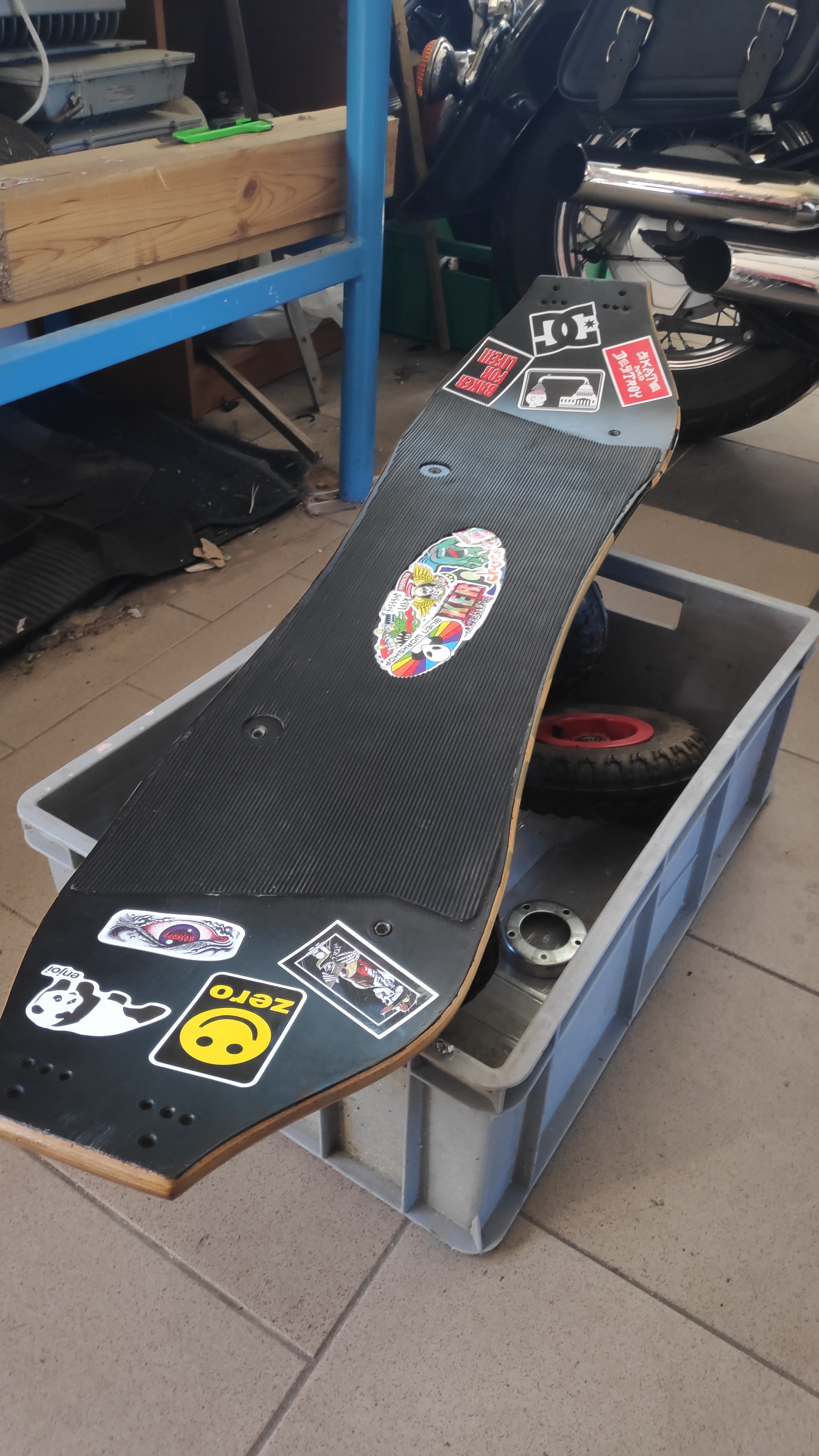

mayoBoard | 1st build | mountainboard Scrub | single 245kV | LiPo 6S | Flipsky | 500$
Hi esk8 :grin::call_me_hand:
My project has finished 2 days ago. I was so exicited and dont have time to write to you about results.
When it started I was total newbie. A lot of study yours old forum and internet let me to:
About specification
:arrow_right: Motor- Turnigy SK3 245kV
:arrow_right: Battery- 3x ZIPPY Compact 6S 3000mah :arrow_right: Controller- FSESC Flipsky 4.12 50A
:arrow_right: Mountainboard- Scrub furnace
:arrow_right: Pulleys-12/60, belt HDT-5M
:arrow_right: Motor mount- Turnigy motor mount
:arrow_right: Switch- Flipsky antispark switch
My problem is ‘Tooth in mesh’. With this pulleys and short motor mount. My score is 4, correct is 6. Pulleys 16/72 and longer motor mount Will do the trick.
Problem with Vesc firmware was solved by Flipsky support sent me VESC tool support my fw
Im suprised, because everybody said ‘6S is too weak for mountainboard’. On flat ground where is no asphalt desk have no problem. Riding on pavement, flat forrest road or gentle hills situation is the same. That was my priority :grin:
Its my first build. Little by little to check if it’s for me. And I can say - ITS FOR ME :love_you_gesture:
Build cost - 500$
Max speed - 30km/h
Range - 12km
I already thinking about upgrades. Battery and more range is second thing after pulleys and motor mount.
I will note about upgrades and change, greetings from Poland and thanks for help :grin:

Cool looking build. I want more pictures of the deck.
