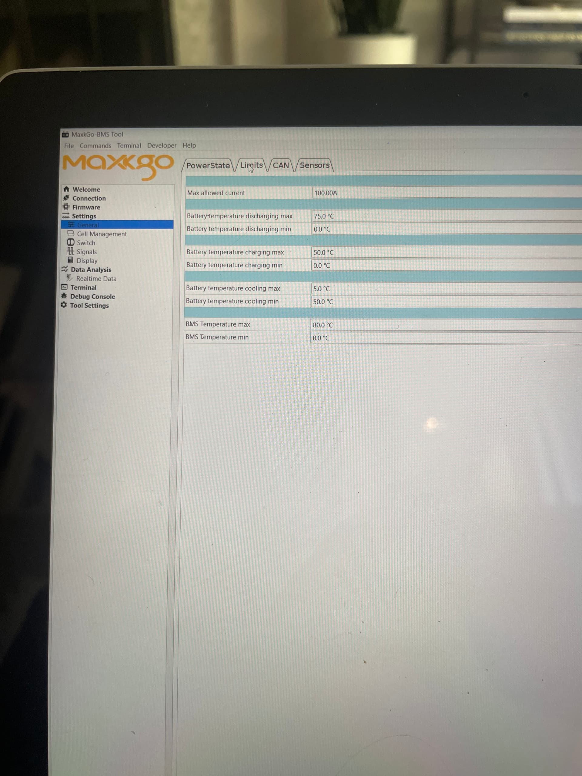

do you have the original maxkgo firmware still? or know where to get it? I’ve been searching and having a lot of issues. I tried upgrading to 5.4 and reset parameters but, no matter what i do i still have a power up failure. I’d like to just go back to stock and restart. Thanks
Here is my current settings. Maybe I’m missing something.
I sadly tried everything I could with this BMS, to hell and back I would describe it, tried Ennoid, MaxKGO and DieBieBMS firmware, I contacted Ennoid and conclusion seems to be that this BMS may be faulty by design as several people have issues getting it into a charge state and it seems to be a fault by design.
