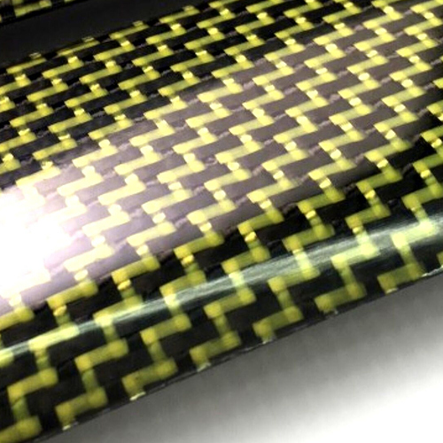

1 x MK1 Kevlar/Carbon Deck with built-in battery enclosure (magnetic lid) (In progress)
The core of the deck will be a closed celstructure foam with 2 Bamboo reïnforcements running of the whole length of the deck (Bamboo 100 x 980 x 3mm)
The skin will be comprised out of 3 layers kevlar/carbon fiber 210gr/m2 Aero quality

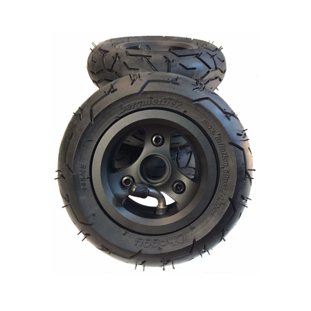

4 x Bergmeister 147mm wheels + 4 x Bergmeister hubs + 8 x NSK 608 Bearings
Thanks to @haggyboard.timo
We were looking for the right wheels and tires for a long time but after carefull deliberation we are happy with our choice of the Bergmeisters.

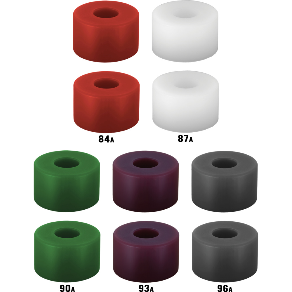

4 x Riptide Krankz (or WFB) bushings with choice of hardness (still need to decide after testing)

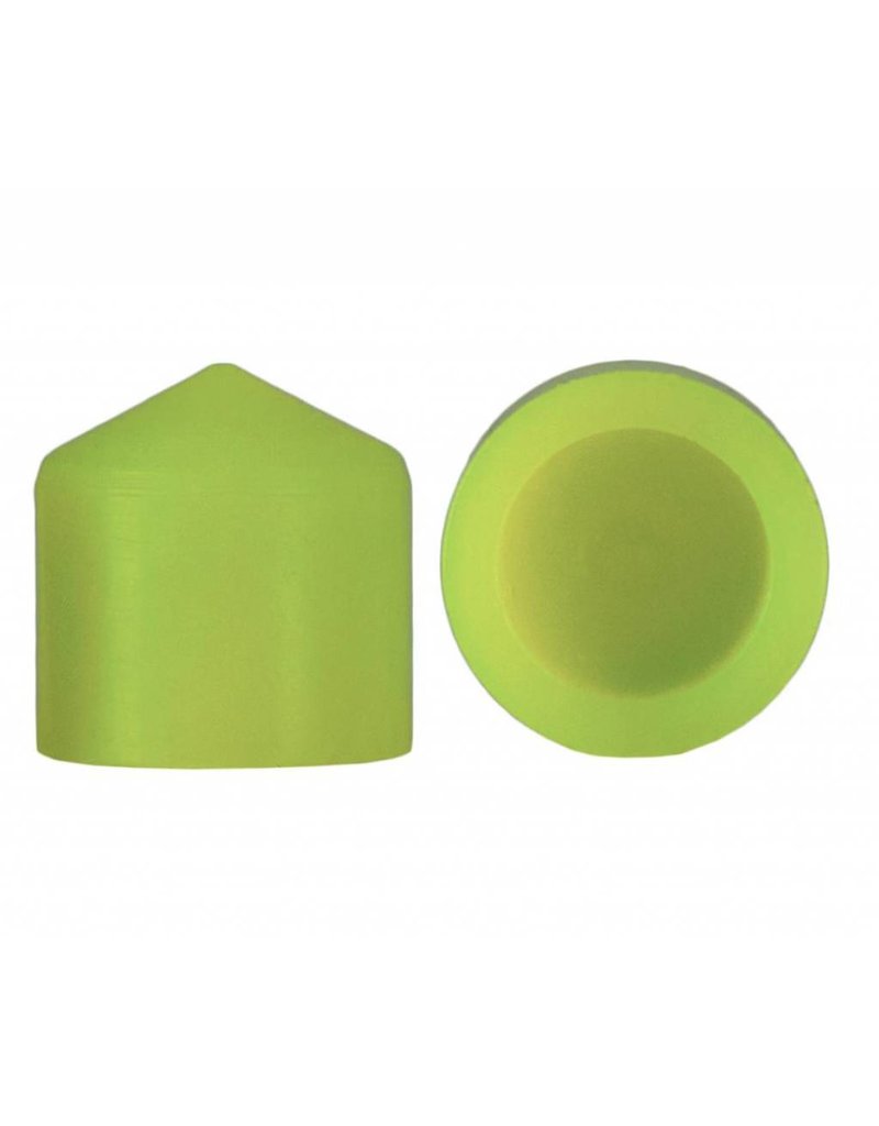

2 x Riptide pivot cups

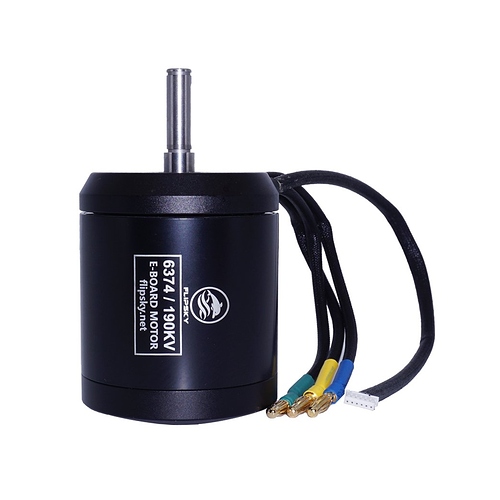

2 x Flipsky sensored 6374 190kv 3250W brushless motors with 8mm shaft

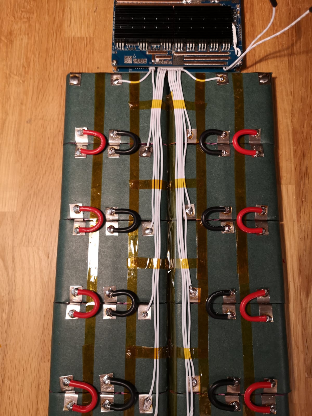

1 x 12S5P Battery with Samsung 30Q cells and integrated BMS 80A (in Progress)

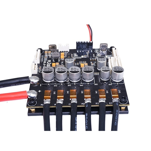

1 x Flipsky Dual FSESC 6.6 Pro Plus 100A single 200A Dual

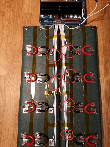

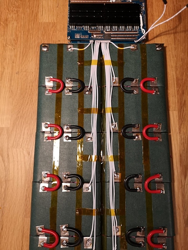

I would be careful here.
Those sharp nickel edges could easily short on those balance wires.
Good observation, will adjust that @Sender

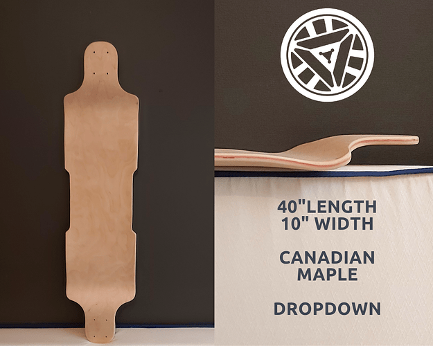

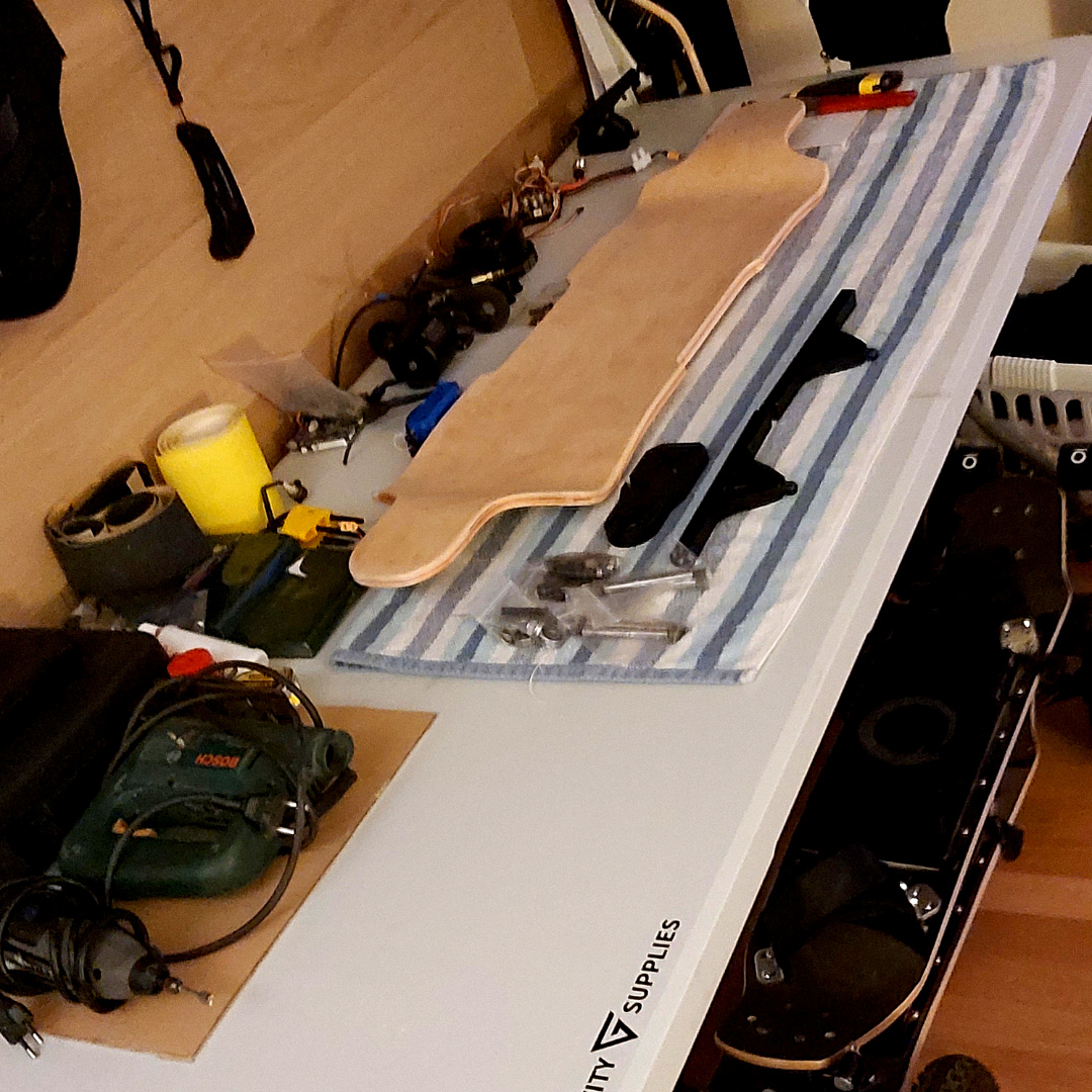

So just to let you guys know we are also working on another deck with dropdown
This deck will be 40" by 10"
when we have the shape 100% how we want it we will start looking into battery enclosures for it.
In the meantime the kevlar deck is also being worked on, we are now looking into the best ways to get the battery installed as safely as possible.
Now just finding an enclosure :stuck_out_tongue:
@BigBen
Heads up. The combination of drop down + kinda short nose/tail usually makes it hard/ impossible to mount motors forward. Nothing wrong with rear mounting but it’s good to know. Oh And it can cause issues with pneumatic tires.
Be sure to test multiple combinations of setups so you know what the deck is capable of.
I like the shape tho.
Yeah valid points, I like this deck shape, looks cool and has the extra foot width.
With all normal wheels I would expect it to be fine
We will also have the kevlar deck which does not have a dropdown design.
Personally I love the dropdown decks, for those who want to mount the motors inward there is the other option.
After these 2 designs another one will come where inward and outward motormounting will be possible.
I am now looking into thermoforming myself so the decks have a readily available enclosure (except for the kevlar one since thats with built-in enclosure)
Hey guys,
So as seen before we are also working on a dropdown design deck 40" by 10"
Now the first deck we made by hand to get the measurements correct and the concave shape how we wanted it.
We are very pleased with how the shape and concave turned out.
I would like to hear if there is interest in starting a group buy since we can get them made per 10.
The deck comes in size 40" by 10" is made out of 10 layers Canadian Maple.
For the GB the decks will be predrilled for old school and new school type trucks.
The decks will be clear Canadian Maple without any varnish or paint so you basically do the finishing how you want.
If we can get a succesful GB going for this batch then for the next batches we will offer them in 2 variants:
- Clear wood, no finish
- Skinned in carbon fiber
Price per deck (clear wood) without shipping: €84.95 “price edited to correct price” (shipping will be calculated based upon buyers country)
We need 10 decks to get this going, but I think with this price that won’t be a problem.
Note: I will let the decks come to me first and then dispatch them to everyone who ordered
(so it may take some time).
Note: For buyers outside of EU keep in mind we ship from Belgium
Only respond if you have interest in this GB, this is not a discussion post, merely a check for feasability.
Make sure that the remote is thoroughly tested for a stable signal if you are having a carbon fiber lid. Carbon Fiber can block the signal
Yes already been working on that.

I think i speak for a few people when I say the deck is interesting but there are a lot of interesting decks, what there isnt a lot of is interesting decks with affordable enclosures made to suit
Thats exactly right and the reason why I am really looking hard for someone to create a fitting enclosure.
