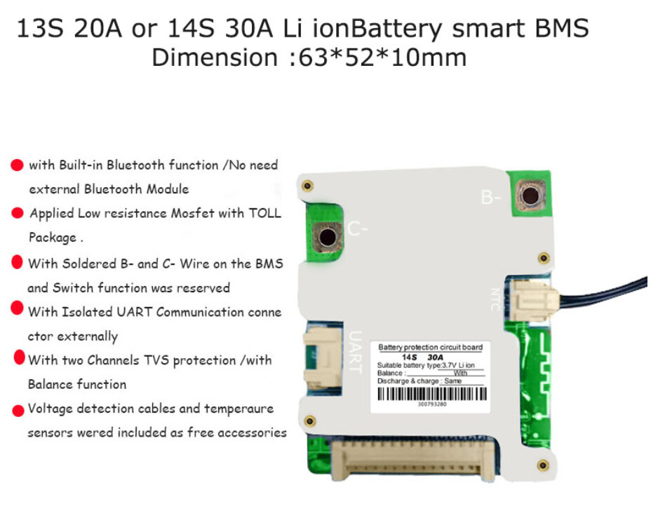

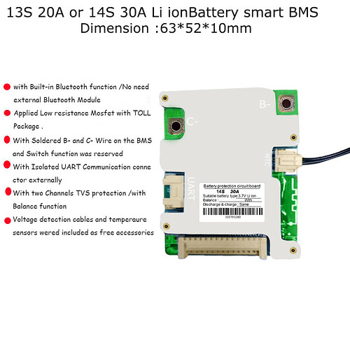

Hey all, I plan to use the BMS below for a 14s pack and was wondering if anyone has used this model with the integrated bluetooth and common port design.
Mostly, I’m worried about the BMS discharging the battery too low. If anyone has experience with this model, please let me know if this is an issue for you.

This BMS draws about 500-600uA during idle. Not too bad.
The Makerx ESC’s are far worse, with DV6s for example drawing over 2100uA when turned off.
