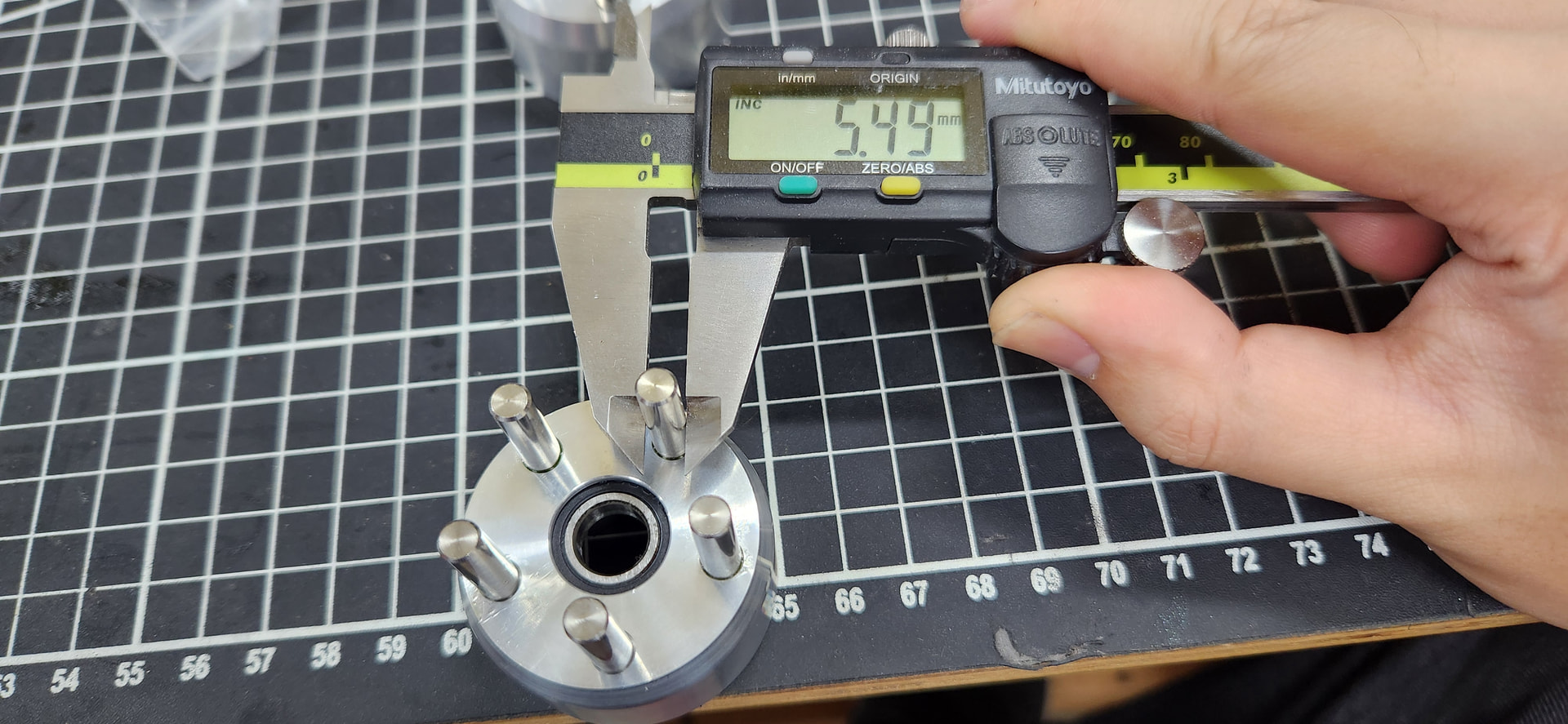

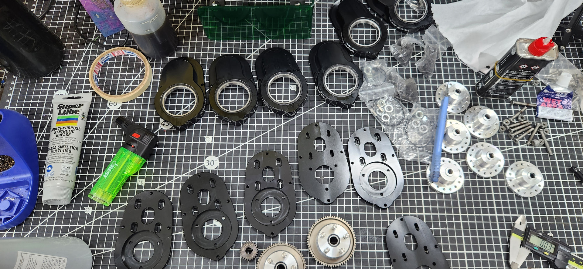

I bought a pair of BN gear drives for a friend who’s upgrading from a belt drive from @nclayton, he was WAY too kind and gave me two pairs of the gearboxes and the adapter clamp. The only thing i can do with my years of knowledge and fuckery of making stuff is to… well try to make it.

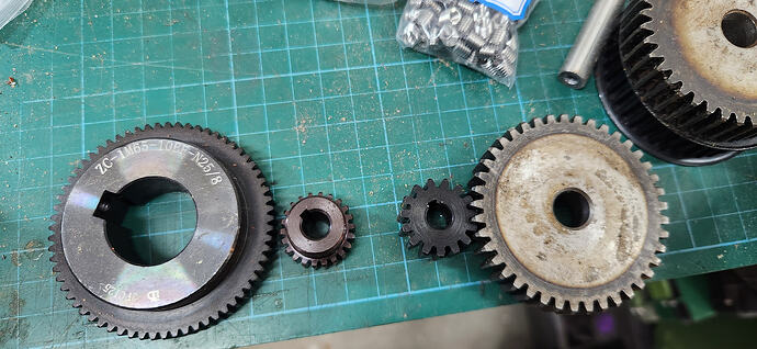

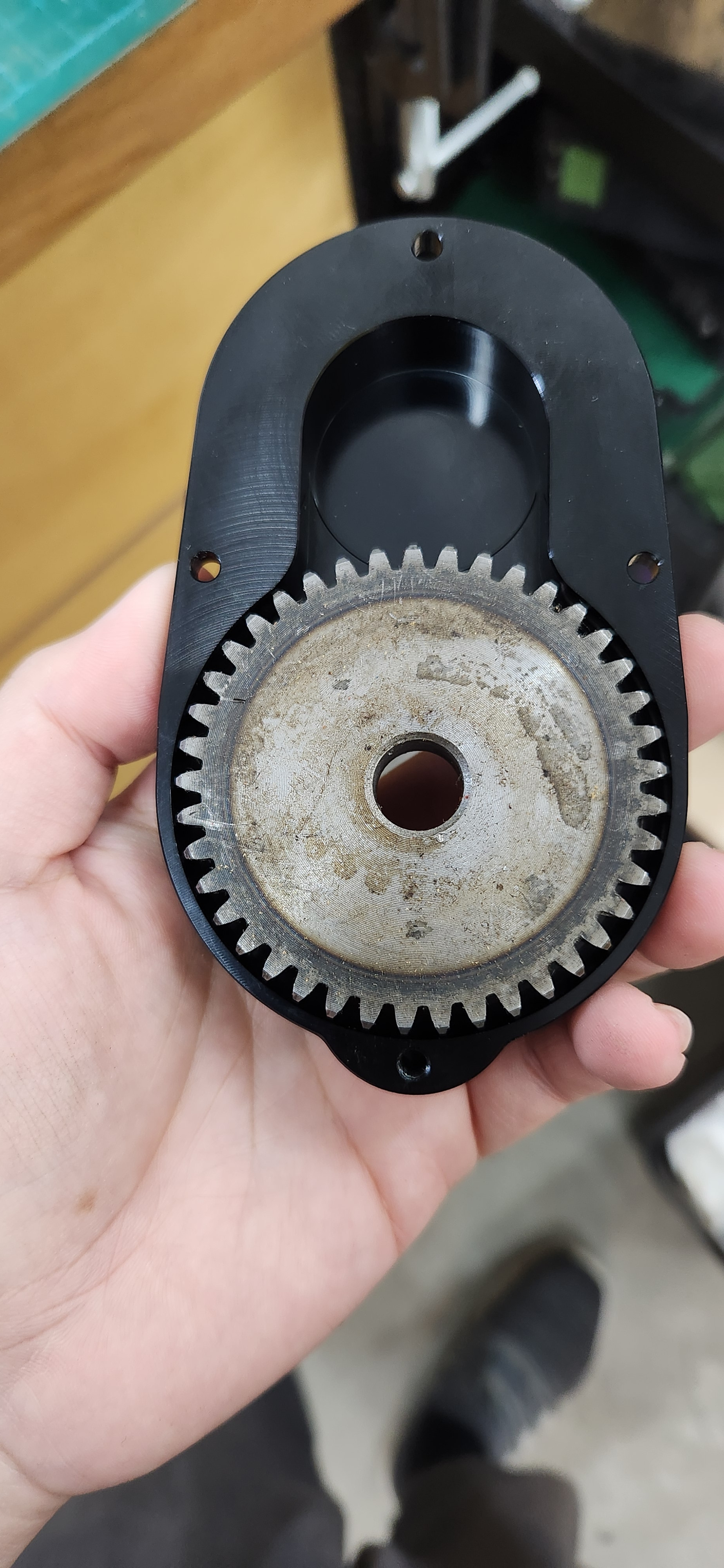

Here’s what I have. The motor mount, the gearbox cover, and the adapter
Here’s what I need. The motor gear, the wheel gear, and the adapter for a wheel, most likely kegel.

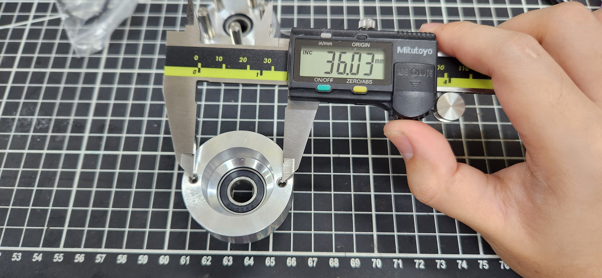

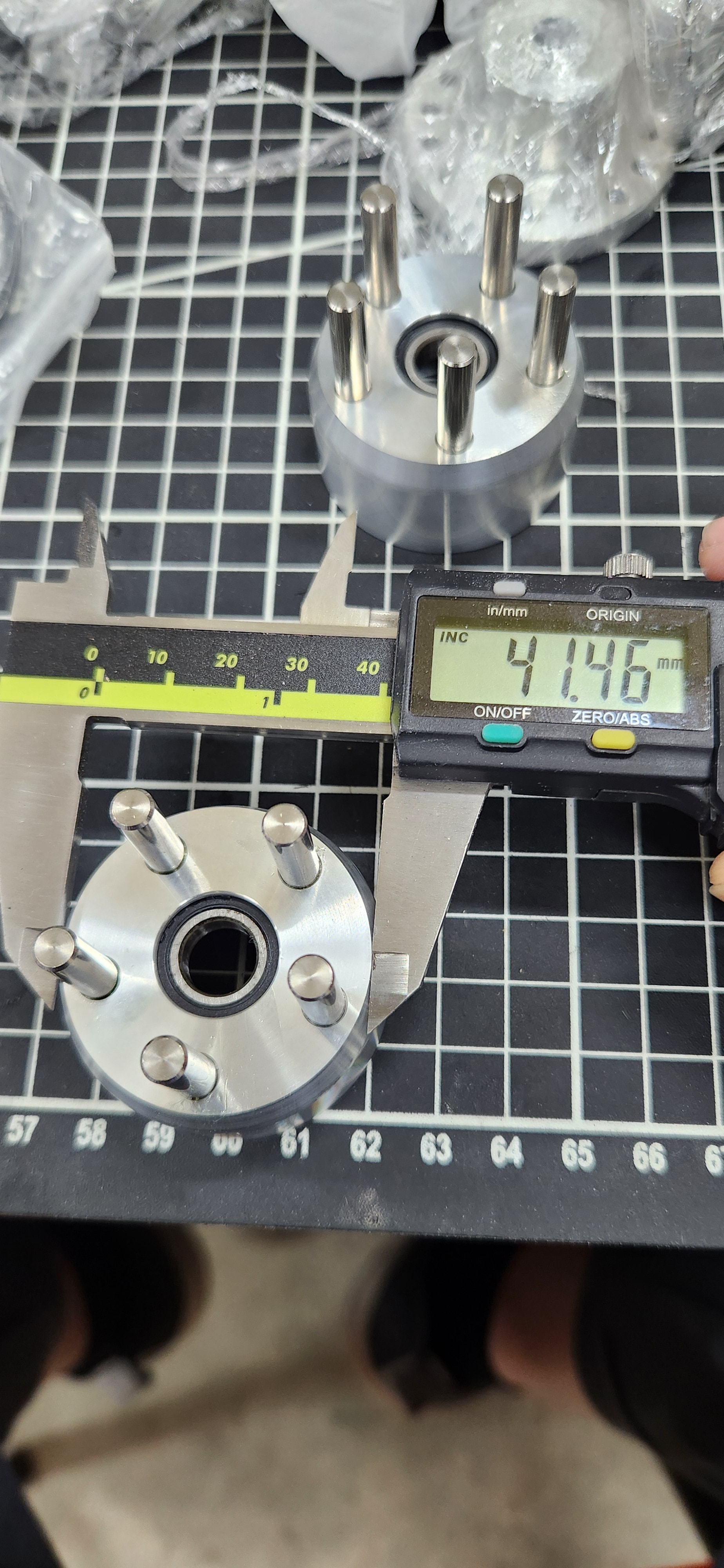

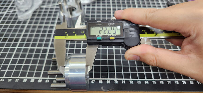

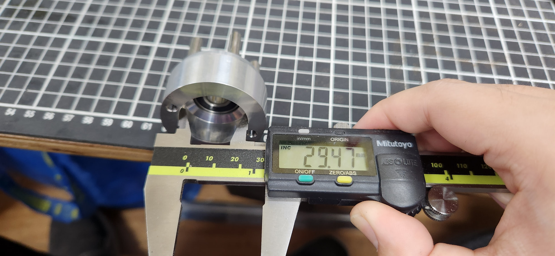

I took measurements of the existing kegel adapter. It’s mostly a round shape with a slot for the 608 bearing to slip into. 5 holes drilled in the kegel pattern, and if i remember right they were pressed in with retaining compound. I would like to change that and maybe make mine with the ends threaded in instead, and use red loctite.
As for the gears, i found some gears on Taobao that are similarly sized, but will need some machining to get them down to dimension. Diameters are about the same, 24mm in OD for the motor gear, and 65mm for the wheel gear. They are 1.5 mod pitch however. I will post more when they are here. First I need to buy a chuck for my rotary table to machine the kegel adapter..

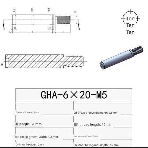

These aren’t as long as the stainless dowels BN used for the kegel pegs, but I used some on a pair of adapters I made and they worked nicely for kegel holes.
https://accu-components.com/us/search?query=SFFH-M4-16-A1%20
16mm long x 5.5mm OD with an M4 threaded end… so a bit more grab than just a dowel with retaining compound. @BenjaminF turned me on to these.

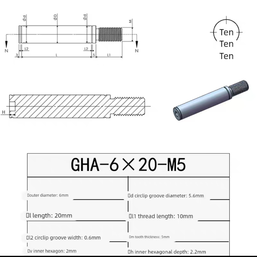

Nice, that gave me some leads and I looked around and found this. The OD is 6mm however, I can turn them down to 5.5mm.

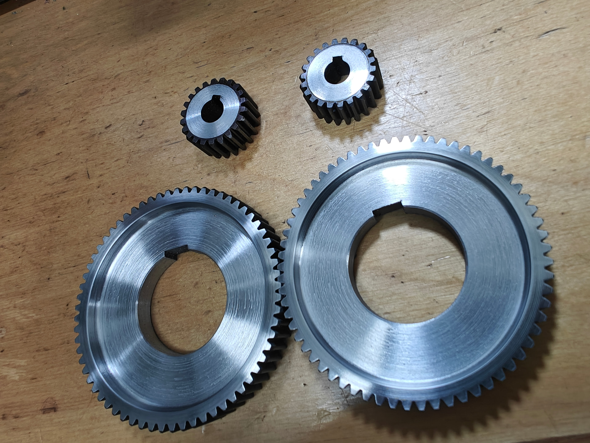

Gears and 50mm round stock is here.
Wow the tooth pitch is huge. Sadly the motor gear has no keyway. Ill check with the shop and see if they can do a keyway if I order again

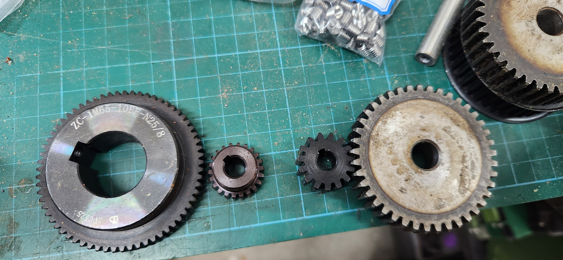

Got hold of the gears. Gonna start machining them down to thickness once im more free.

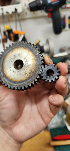

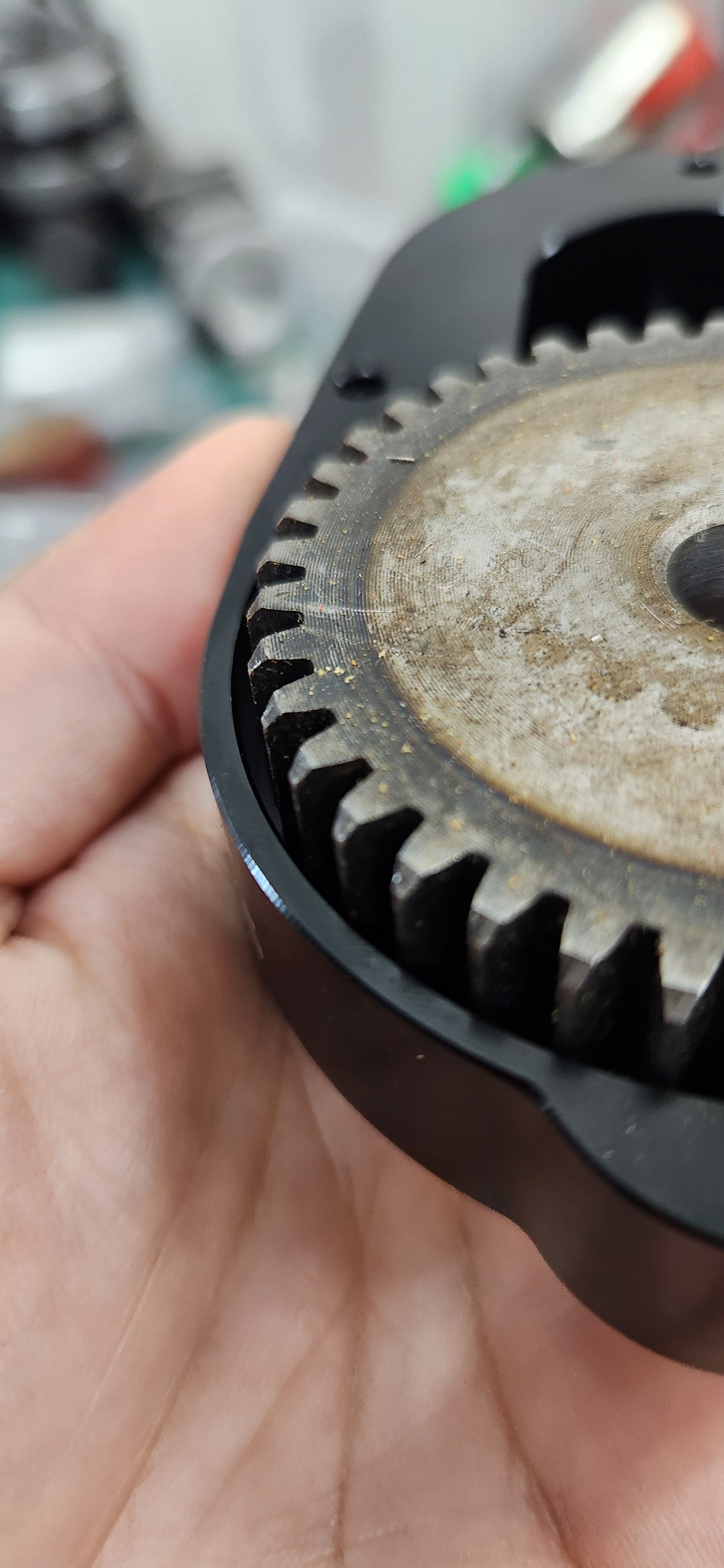

on the left is mod 1 pitch. On the right is mod 1.5 pitch
The mod 1.5 is a bit tight. Almost kissing the walls of the gearbox.
The mod 1 is perfect

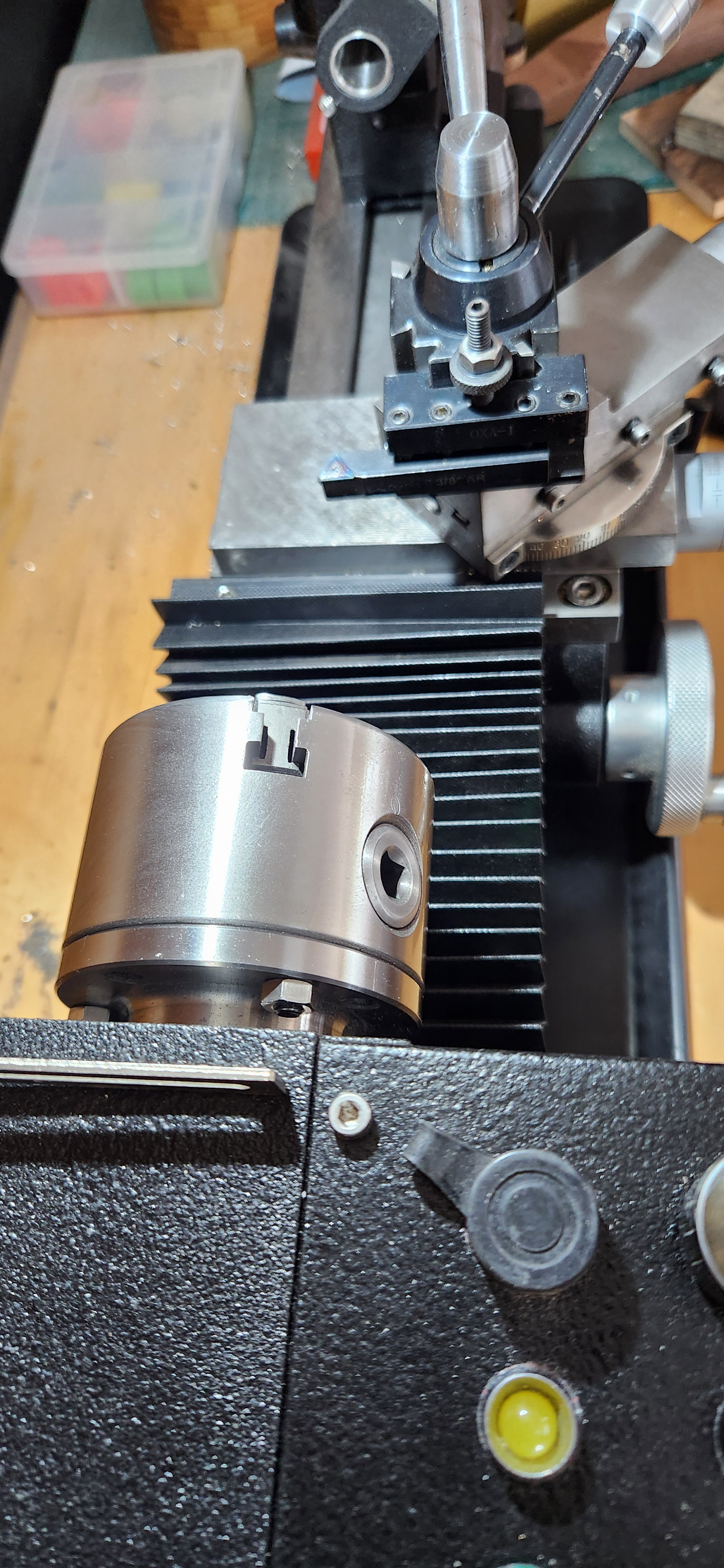

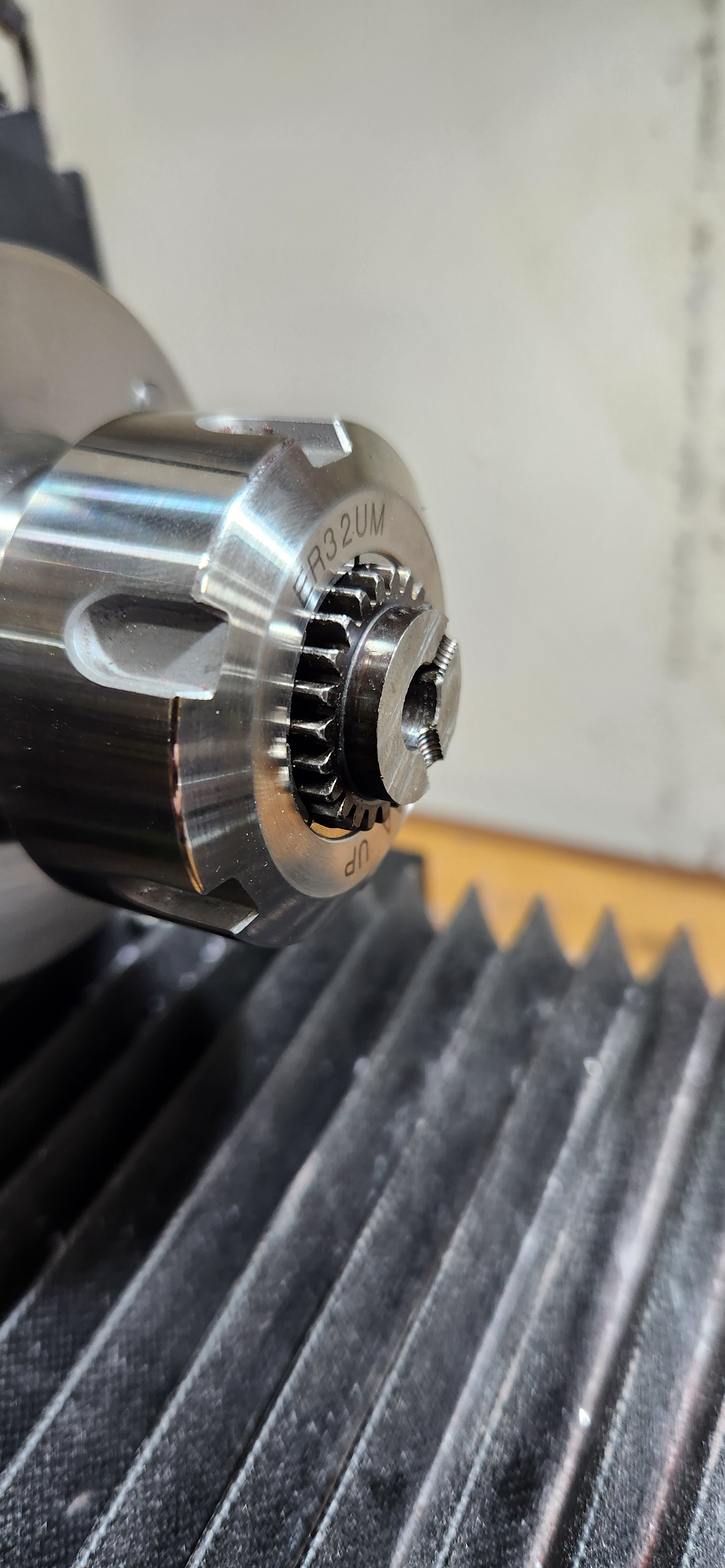

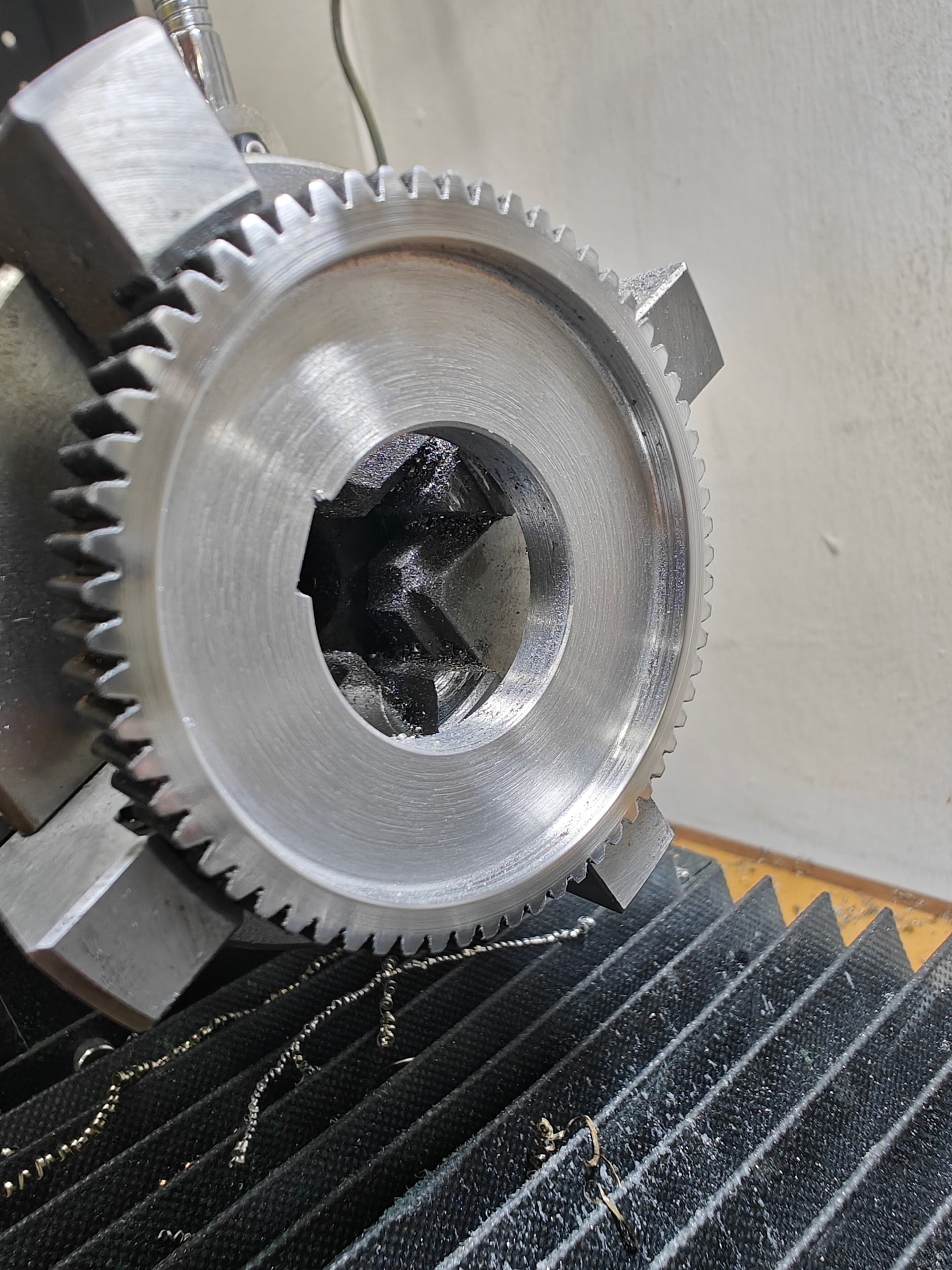

What’s the plan for clamping/locating them in the mill/lathe?
Likely i will use my lathe to do it, I got a 4 jaw independent chuck so I will clamp it on the teeth side but use 2mm copper shims so the teeth do not get marred.

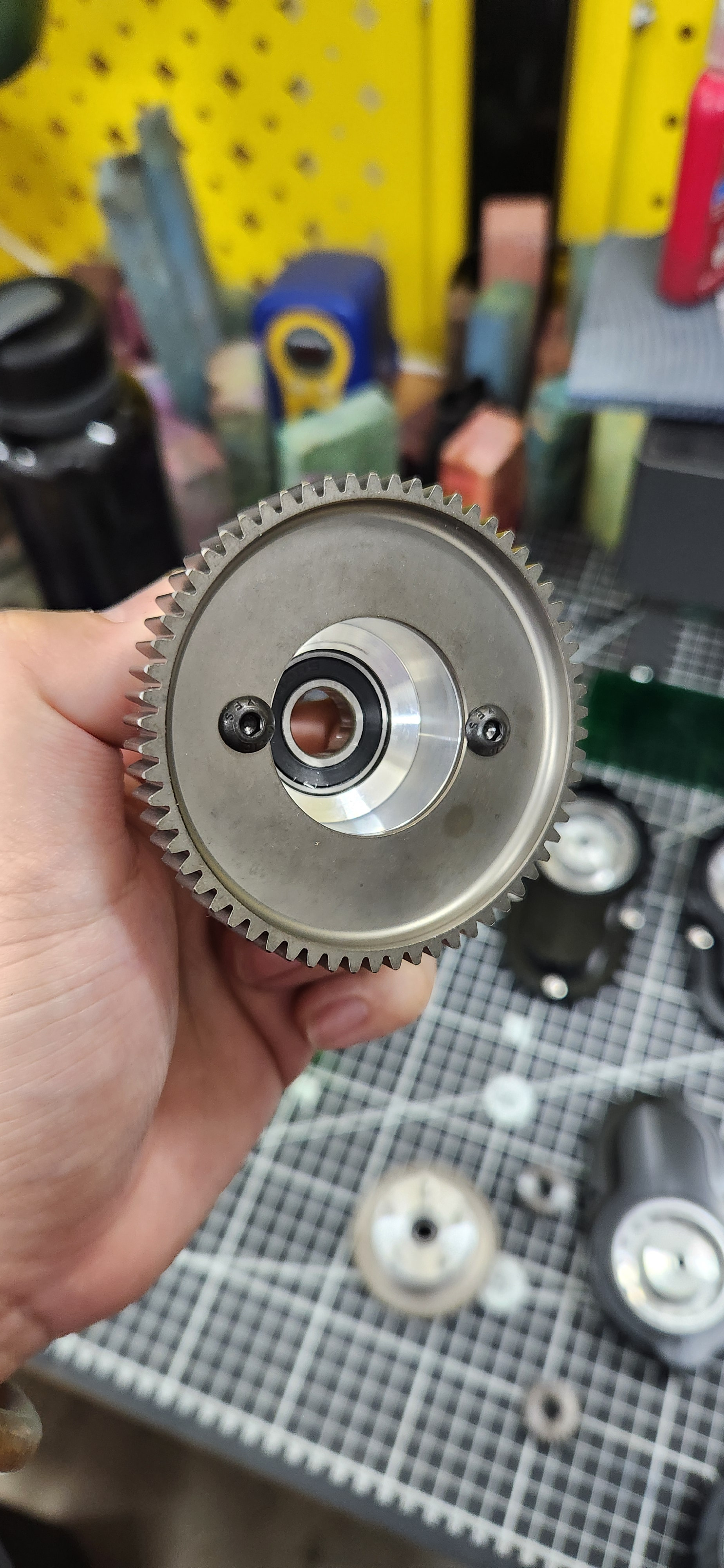

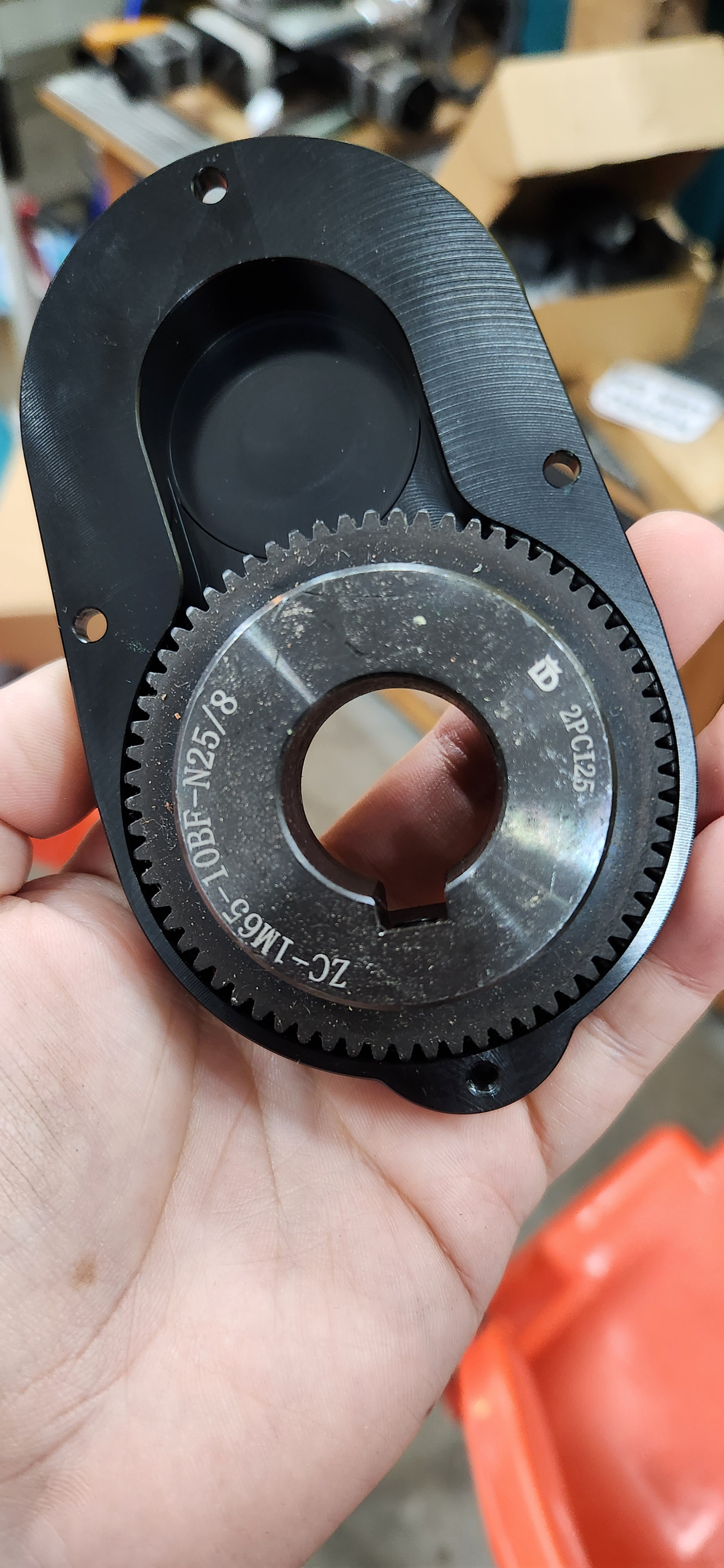

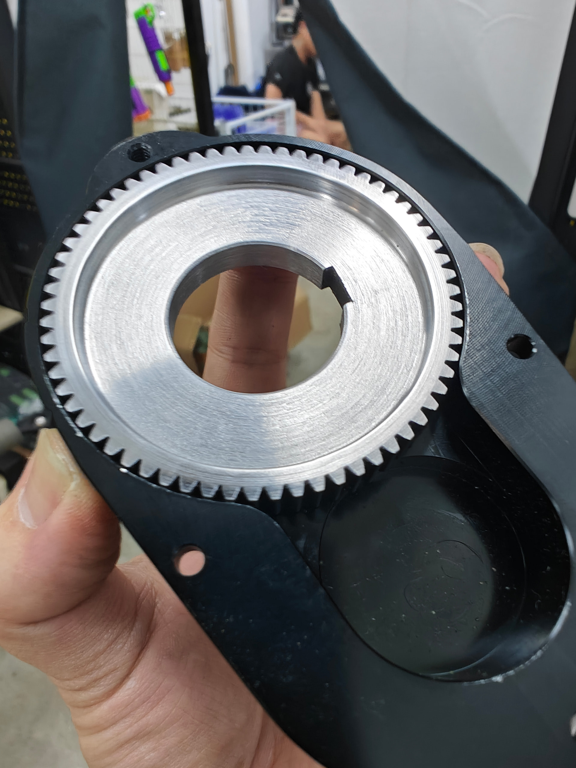

Did some work on the mod 1 teeth gears.
The main body is not hardened, but the teeth area is. I’m unable to cut the teeth down, as it’s near impossible to cut, with my carbide tooling at least.. So I’m having trouble getting it down to thickness. I dont have the original gear with me anymore as it’s on a friend’s board. But if i remember it’s 9mm or so. This gear is 10mm thick.
When placed in the gear box, it’s exactly flush. I hope to be able to get it to work with 10mm. If not I might need to anneal it and soften the teeth area so i can cut it down to 9mm.
Don’t mind the keyway. It’s not critical. The part i bought came with it, i bored the ID to 29.5mm, which is the original’s gear size, and wasn’t able to clear it.
Making the Kegel adapter is likely next, and the harder task.
Can you just use a thick gasket between the gear casing and lid to give you the clearance?
If it’s too hard to cut, perhaps you could thin it with abrasives.
