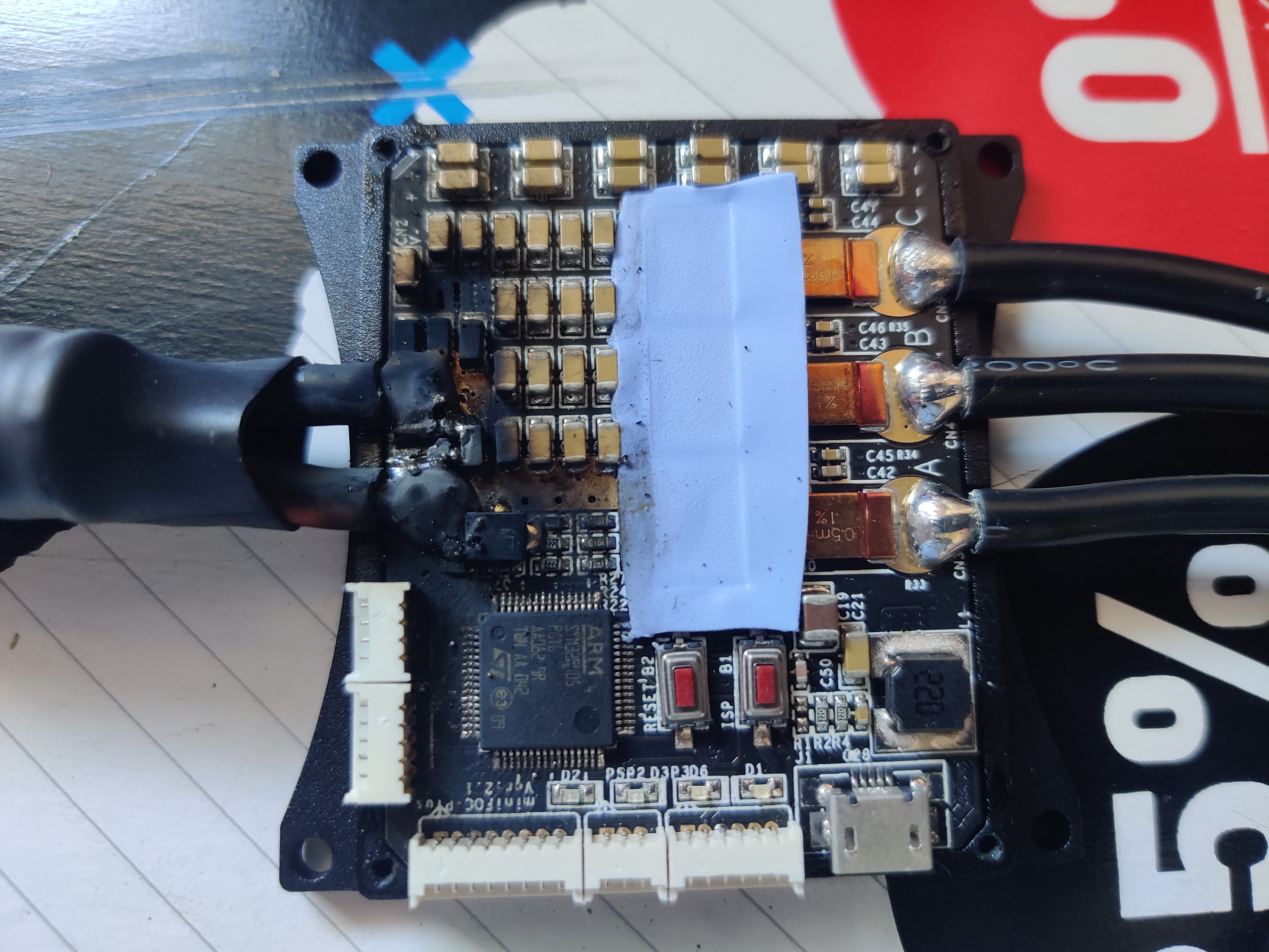

I bought my first VESC a couple of weeks ago and I decided to go for the Maker-X mini foc plus. I was generally impressed with build quality, price and size. However, when I first plugged it in, it let the magic smoke out…
I checked multiple times before plugging the battery in that the polarity was correct and read the voltage with a voltmeter too (I used XT60 connectors everywhere so should be impossible to connect backwards anyways). When I plugged the battery in (2x 5s lipo in series) the connectors sparked and melted the solder on the input wires! I contacted Maker-X website but received no response so I tried to fix it myself. When I opened the aluminium casing I noticed the ā€˜charred’ look was only close to the input side and the 2 closest caps to the input wires litterally blew up.

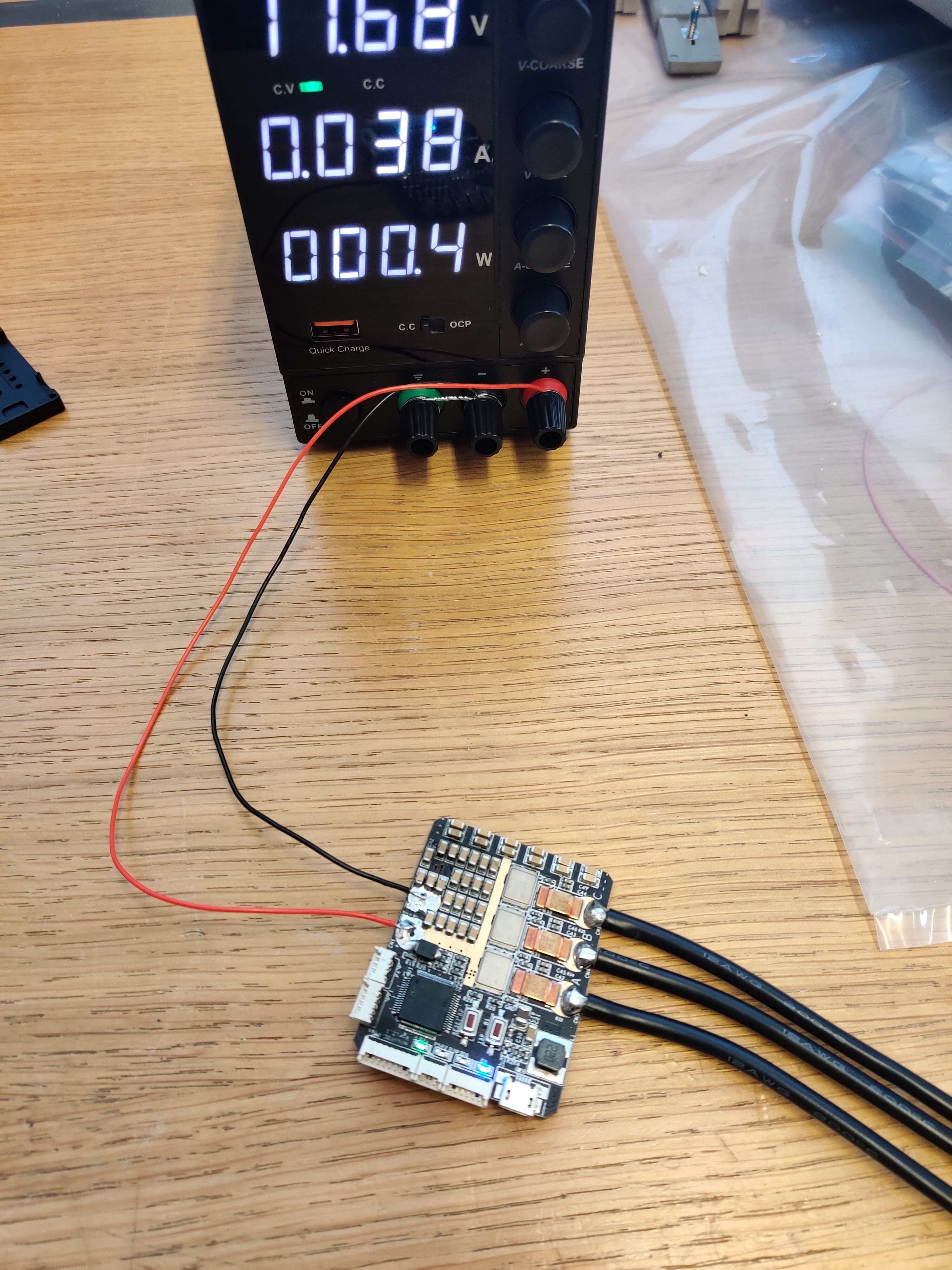

I cleaned off the burned parts with isopropyl alcohol, removed the remains of the two caps and soldered some test wires to see if the thing would even light up. And it did. I am not used to see caps fail SC, but I suspect soldering the input wires so close to them might have introduced stresses in the ceramic and made them fail later when I plugged it in with 42V.
I have now tested it with a motor too (6374 SK8), and I can say I’m quite happy with the product, I just didn’t like the lack of communication with the vendor as soon as I had a problem. I contacted them before regarding other things and although not too quick they still replied, this time I didn’t hear anything from them.
Hi, I had the same thing in mine, I did a smoketest first tho and found that three caps were shorted.
I removed all the caps beause frankly I did not trust them. Replaced them with 100V rated ones.
Makerx response was something like; ā€œbut even 50Vdc caps dont fail until 2.5xrated voltageā€ā€¦
Not a rule I personally would use when designing :man_shrugging:
side note:the electrolytic cap on your wires seem to be implemented after I posted a picture of mine xD

I noticed your posts on the mini foc thread before I even bought the controller. I just wanted to try it quickly at home and didn’t think too much about testing it before connecting it straight to my batteries. I think it’s a very worthwhile mod changing those caps what size did you use? both physical package and uF?
In my workplace we tend to select caps that are rated to at least 2x the voltage they’ll actually see. On the other thread I saw a crazy figure of 22uF for those tiny caps and I don’t think they exist in 50V rating.
Thanks for your help!
Hi,
Normaly I’d advice atleast 25% headroom on ceramics, similiar/bit more on electrolytics
Tantal 3.5x intended voltage
I used w/e I had around, can’t remember. Think some smaller 4.7uF 100V caps and one larger 15uF 100V ceramic which was quite huge.
