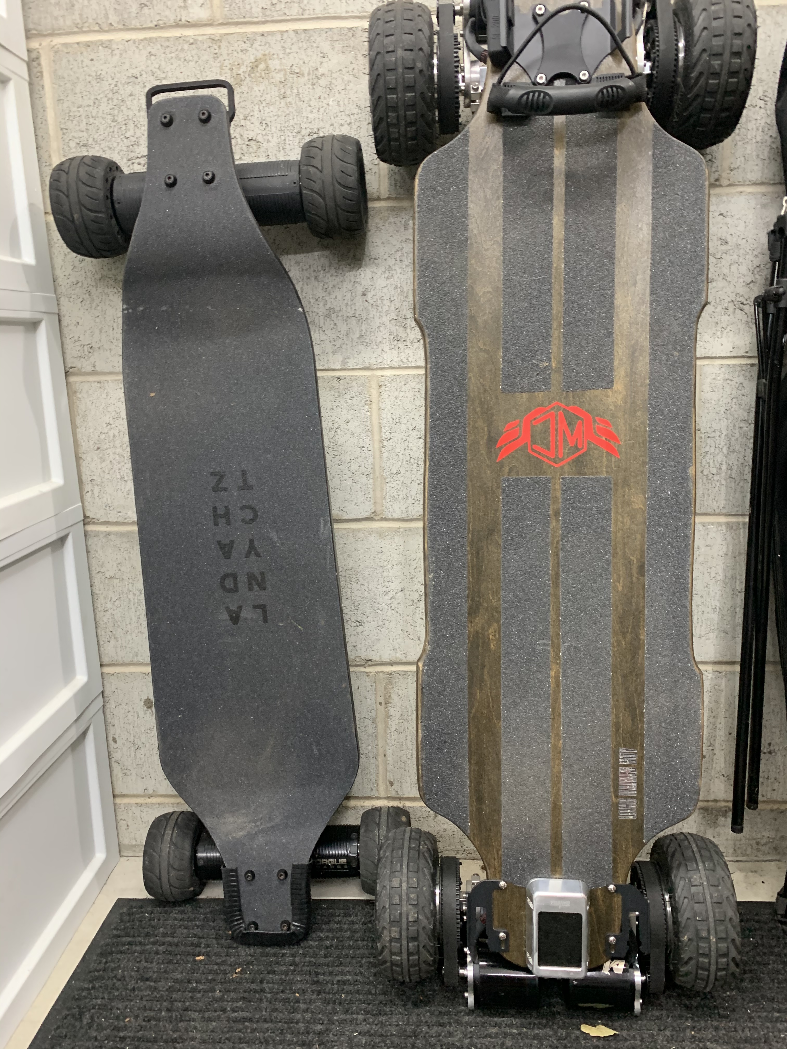

Those wheels are thicc :drooling_face:
That thing looks fun

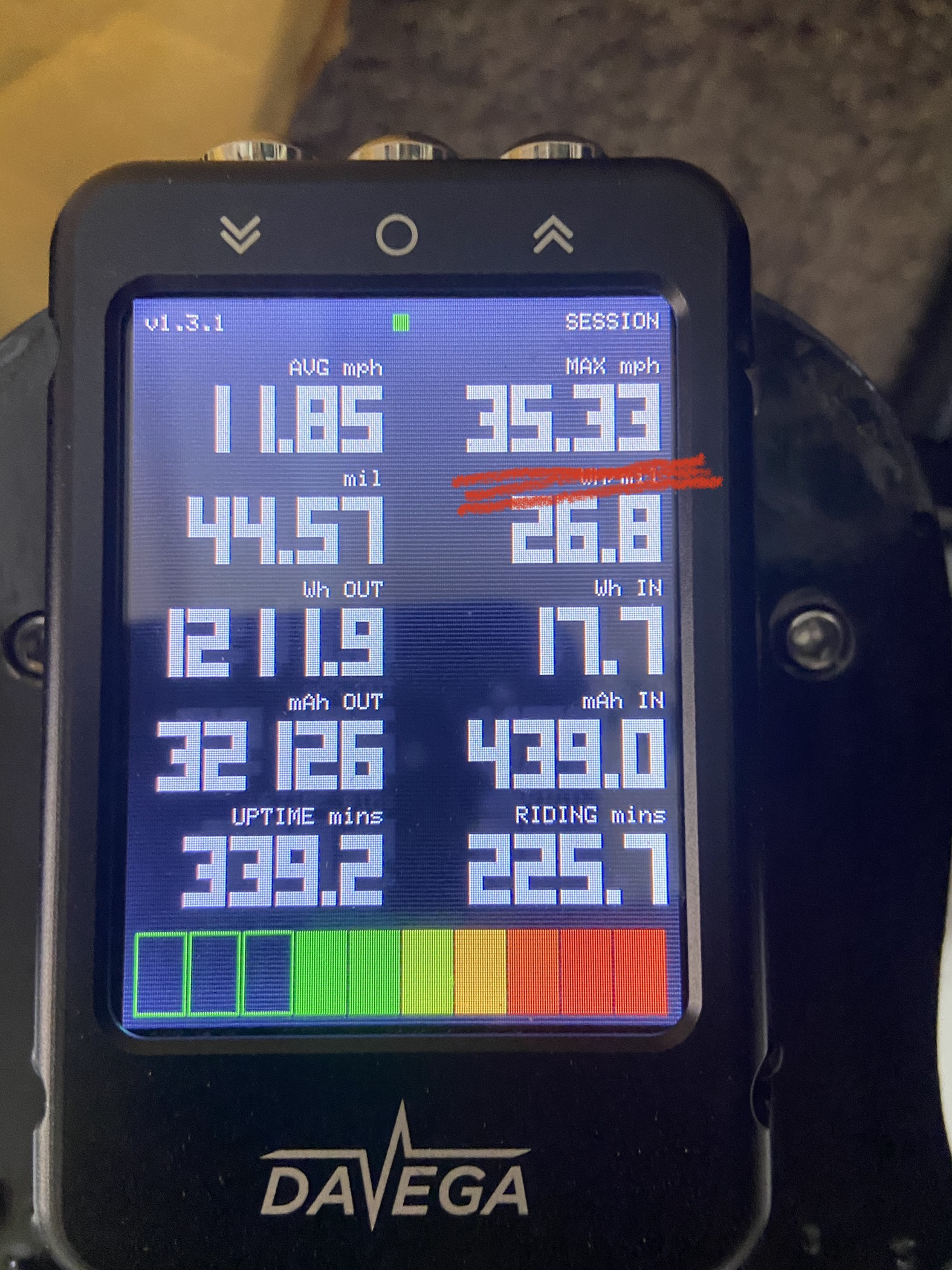

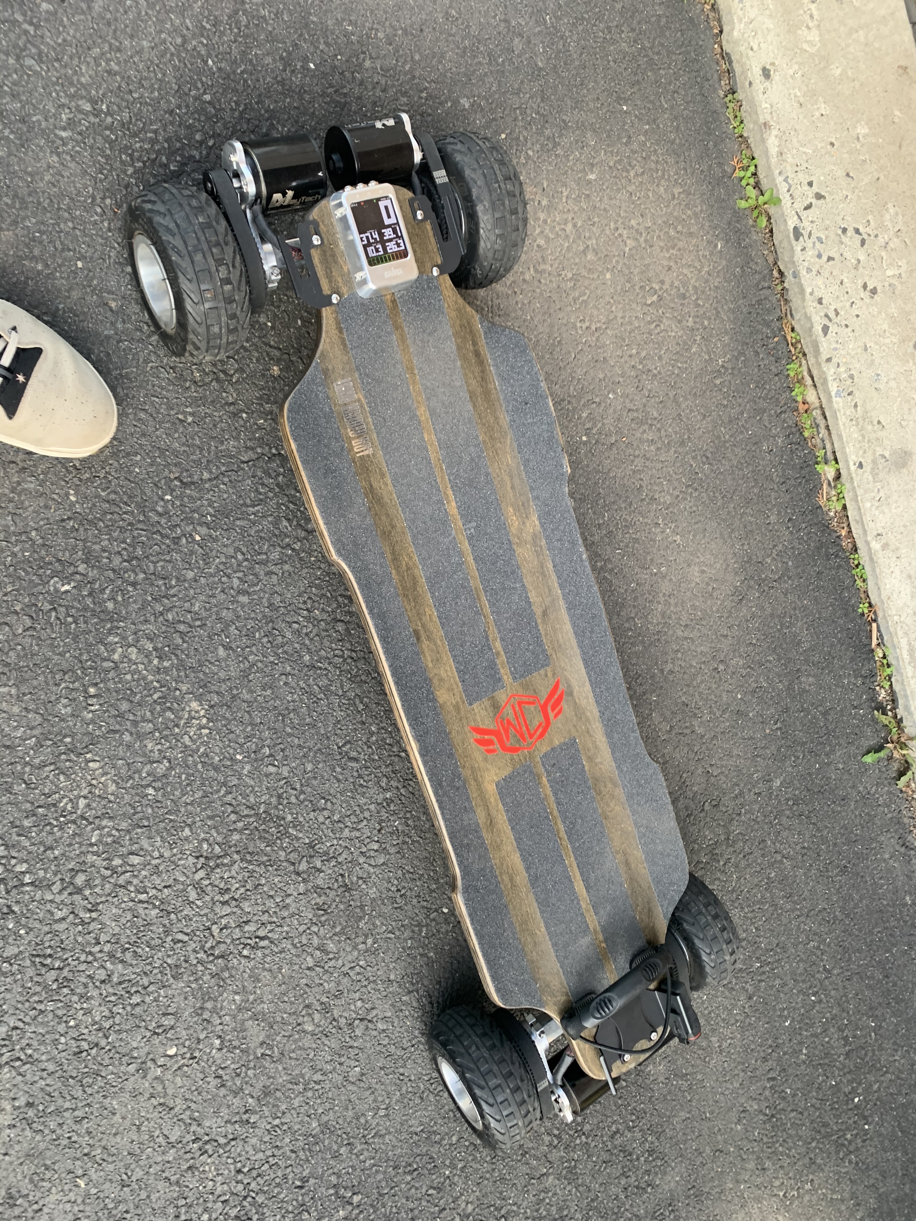

She is fun, just got to get the kinks out with the help of LHB. The other Build I ride right now is the LY EVO 4WD with Direct drive on Ruber ONSRA wheels hit 37 MPH today at 70% throttle
Plan to have @longhairedboy instal another Davega X and perhaps a Hoyt Street Puck for me This guy is something else with details, on some OCD shit.

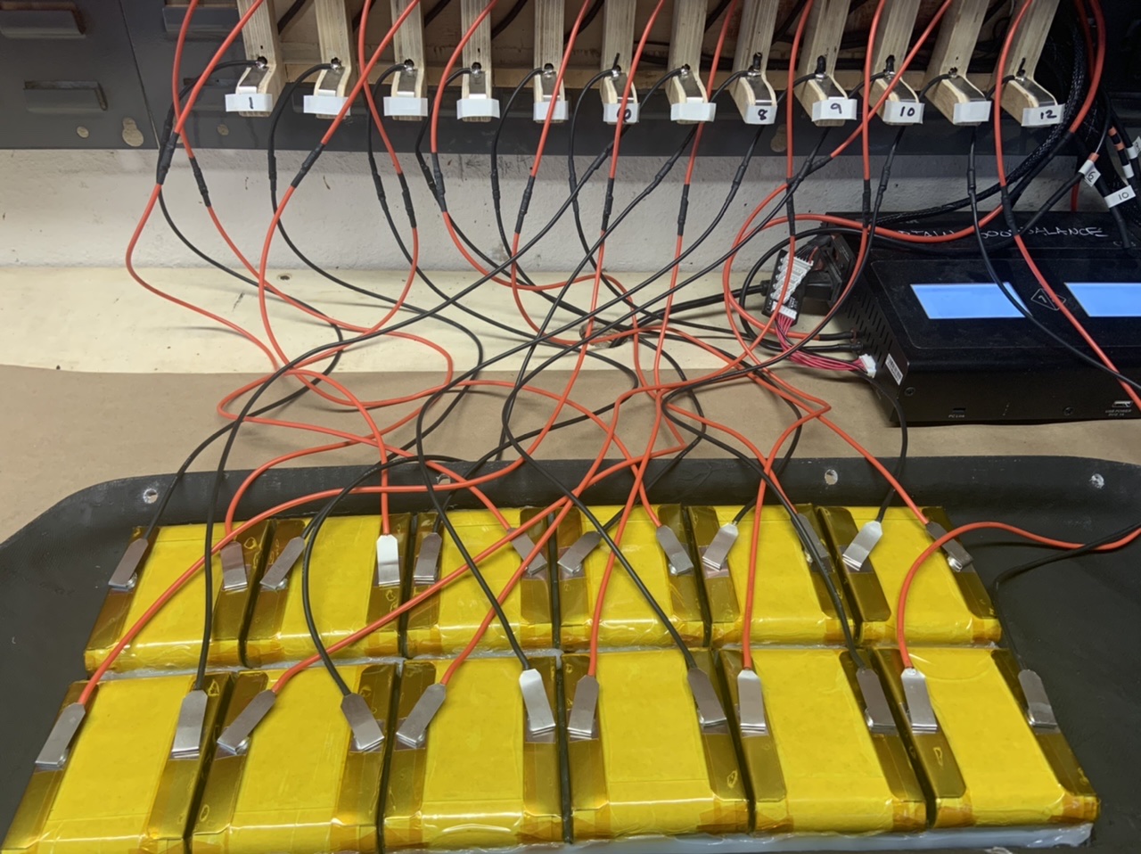

i made magnetic leads for prebalancing my packs.
just FYI these are 10mm x 2mm N50 magnets, and that’s 10 x 0.15 nickel wrapped around them. Strong af begins to describe them.
So Damon. Question. I’m attempting my first battery pack on the junk drawer board. From the looks of it you’re building the p cells and then balancing correct? What voltage are you bringing them to 4.2?
nope. Just making sure they’re all at 3.8v after welding. I do that because cell voltages are supposed to be around 3.7 but you never know how close they are, then you weld them together and they balance internally, which leads to the pgroups over all being kind of all over the place. So i take them all to 3.8 just to get the pack balanced before i finish building it out. I don’t ship the boards fully charged, i ship them at storage level. Its better for the packs.
Yea that’s what I was wondering because mine took a good while to charge
You’re using a 2.5 amp charger (iirc) on a 10S4P 30Q. That’s a few hours.
Yup. It most certainly is. What kind of balance charger is that that you’re balancing the p cells with? Is it made for that or did you Hotwire something?
its an EV-PEAK dual 6S lipo/liion charger. I made a jig that has the capability to let you slip 18650 pgroups directly into it, I then atttached leads that let me charge any sized pgroup or cell, but it didn’t do that without soldering until today. Its effectively charging two 6S packs when you use it to do 12 pgroups. Or 6S and 4S when i do evolves or other 10S packs.
