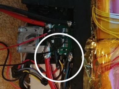

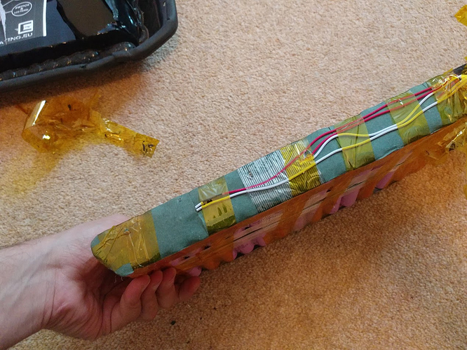

Here’s a photo, if it’s any useful.
I’m clueless but I assumed the battery pack (spot welded as it is, with all wires) could remain intact and just wire a new BMS/switch in the place of the old one.
But if it’s true that the pack would need to be taken apart, then how about I cut the stripes to release the individual cells and ship them like that, which would be safer? Or removing the spot welded strip bits afterwards would be too much of a pain?

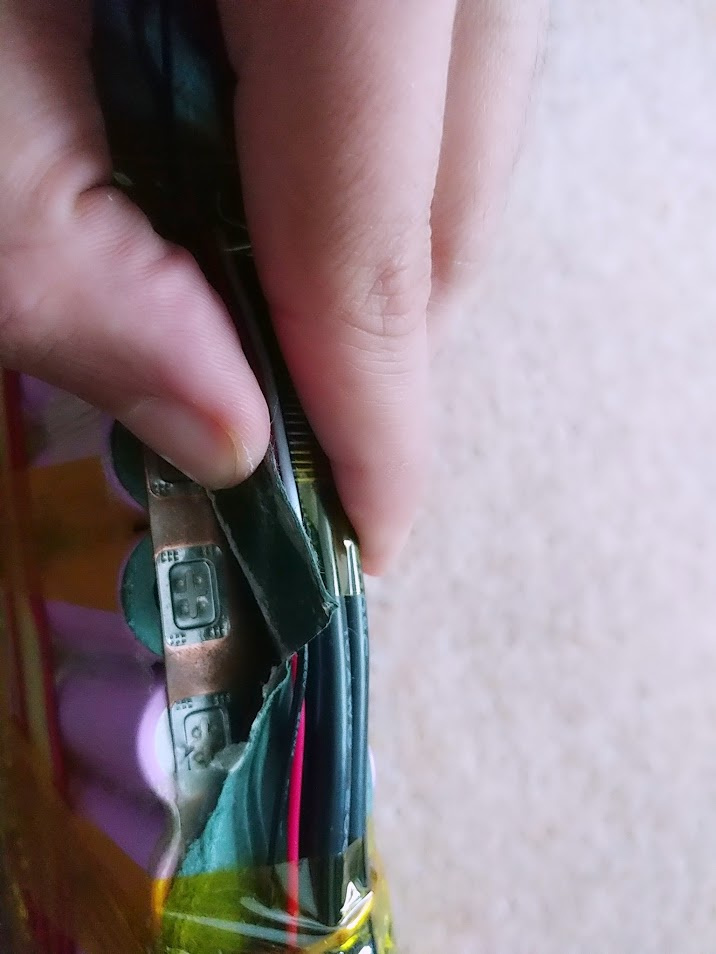

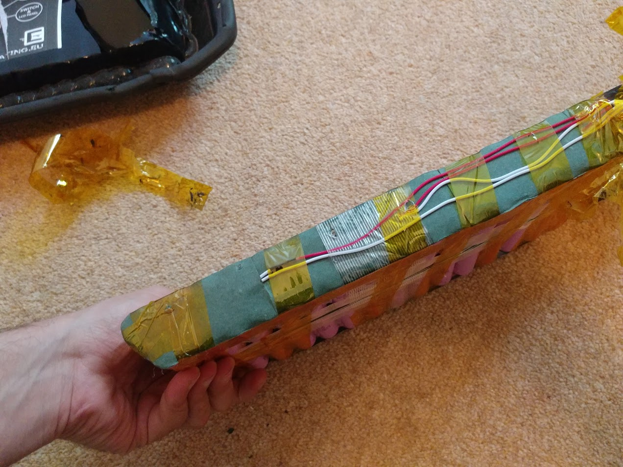

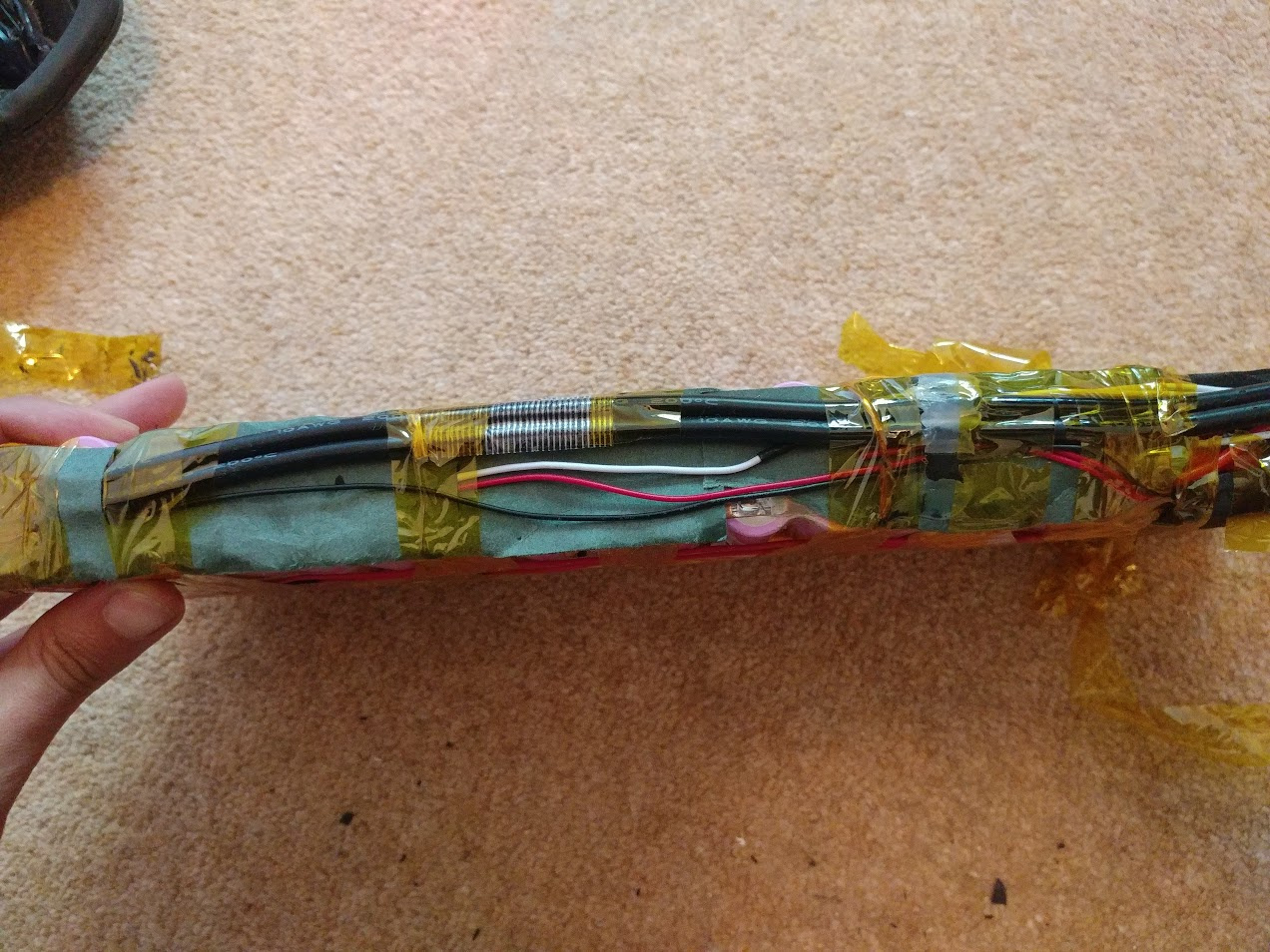

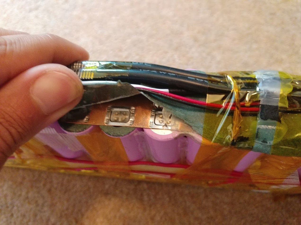

Take some pics of the spot welds mate, lets have a look at it
I already see some gnarly stuff in there
The side strips are covered by something like cardboard and tape -there was only one place I could easily lift it to expose them (not sure if that’s enough)

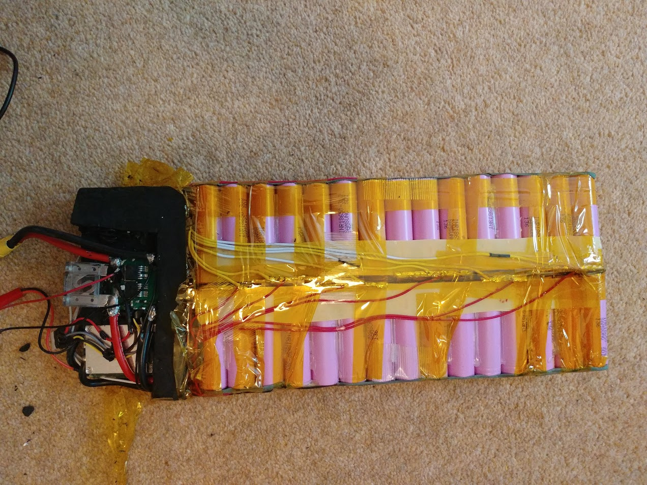

If you think it’s best I can take it completely apart -I think that might be necessary if you want to see more details.
The welding looks alright actually. Antispark usually fail closed so they are always on but, humour me
Put your meter across this black and red wire, measure the voltage
20190907_155902
This is where I measured the 48.5V
Ah ok it’s the Antispark then. Desolder those two wires, one at a time and insulate them so you cant short anything then resolder a new antispark in and you should be good to go
Thank you very much, you are awesome! :smiley:
I am looking around at the various anti-spark switches -FlipSky 2.0 seems common. Hopefully I can wire it properly with the fuse and everything.
No worries mate. They sometimes come like you see there with the fuse across the positive side and the negative side is switched on and off. In reality you can put the fuse anywhere, put it after the Antispark on the positive side and you will be ok
