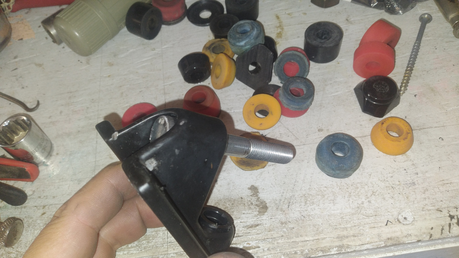

Kingpin broke suddenly while riding, change your pins every 1000klm.
If I remember correctly 10/9 has more fatigue resistance. Here is another idea, how about using a slightly larger diameter kingpin?
2 of my My 3/8” kingpins measure 9.18 and 9.34 mm thick.
The 12.9 M10 bolts I got today are coming in at 9.86mm
Dont Trip has made LDP trucks with 1/2" kingpins, as LDP makes 3/8" kingpins fail from fatigue way too often. Especially since they run spherical bearings. I don’t recall seeing even just a single one of those 1/2" ones failing. I think its called Poppy XL.
For my swingarms I want to use M12 kingpin as the failure mode of a kingpin would be pretty much guaranteed crash, and I really don’t want to find that out firsthand.
Only issue with upsized kingpins is lack of bushing availability for them. Drilling out the bushings with a hand drill sucks. Even a drill press is hard to find repeatability with. A lathe is the only way I can get them repeatedly concentric, and most people don’t have access to a lathe. I’m considering buying a small lathe primarily for this, at least if I can figure out where to put it in my small shop/ room

10 new Taiwanese made, 70mm long M10-1.25 grade 10.9 hex head bolts arrived yesterday.
I don’t know how long this link will last for U.S. based members, so I will include the product description too so one can copy and paste and easily search.
.M10-1.25 x 70mm Grade 10.9 Hex Cap Screw Bolts Metric Zinc Hardened FINE THREAD.
They measure 9.86mm on the shank/ unthreaded portion.
I pulled out an old RKP baseplate that I think is Paris, or a clone there of. It came with a set of Puaida hub motors and trucks.
Its splined 3/8 kingpin had become wobbly as F, and was retired in the bottom of my box of skate parts.
The unknown grade 3/8” splined wobbly AF kingpin tapped out with the lightest of blows from a lightweight hammer.
It measures 9.51mm on the shank.
I had to grind down the M10’s 17mm hex head to fit inside the baseplate. I went slow as to not overheat, and the water quench never sizzled, so it would seem the hardness and temper is preserved.
The threads would not fit into the receptacle from the bottom, but they would from the top, so I hand threaded it from the top until it got stuck, and then used a 17mm wrench to screw it all the way through. This did not require much force at all.
Then backed it out and was able to thread it in from the bottom till the shank bottomed out on the baseplate receptacle.
I then pulled it into the baseplate using its own threads and some spacers under a new M10-1.25 flange base locknut. This was very cathartic, and seemingly the only thing I did today which went right without fighting.
The bolt was pulled into the baseplate, not requiring too much force on 15mm socket, nor too little. It seated perfectly, and even if it were not prevented from spinning by the ground down sides of hex head, the Nut on top would be unlikely to to so when compressing bushings. It’s tight, but not so tight that the aluminum baseplate could have cracked.
The Flange base M10 -1.25 lockNuts I got are tall and burly.
I did not notice in the product description that they also had some Scotch grip 204 thread locker applied threads. This was the source of much cursing as I has handthreaded a nut on the bolt upto the nylon for grinding, and when I went to remove it was absolutely not going anywhere. Vice grips on ground bolt head and a regular ratchet had no chance. I had to use 1/4 inch impact driver to get it off.
The flanged base of this M10 nut is the same diameter as a tall cone bushing. Since I always flip my roadside cup washers upside down for that extra lean, and because the nut is so thick, and I keep my trucks so loose, I just skipped the cup washer entirely, as I was not able to engage the nylock portion of the nut with the cup washer unless I tightened the trucks far more than I like.
I had removed the Scotch grip 204 thread locker from the M10-1.25 nuts interior threads as that was some serious stuff.
This 3/8 to M10 kingpin swap was easy enough, that I will be swapping all my Kingpins to M10-1.25 Grade 10.9. No Splines to weaken the bolt, no more Wobbly kingpin , and some extra bolt diameter for extra strength and fatigue resistance is win x 3 in my opinion.

This is the baseplate on my high mileage Daily driver with its new M10 kingpin.
Its former 3/8” splined kingpin was still nice and tight, and difficult to remove. I was heating the baseplate to 185F and holding a quickly melting ice cube on the kingpin, and with baseplate screwed down, Was just about to consider a heavier hammer or swinging harder, when it moved.
The Unknown grade splined kingpin in this baseplate measured 9.36mm on the shank, the unthreaded portion above the splines.
A new M10-1.25 would not thread in from the top or bottom easily, but I got it started, and it then started cutting its own threads from the bottom. The M10 with the ground head fought being pulled past the hard stop of the threaded shank, by the M10 nut and spacer, So I unthreaded it and tried the 400 grit on a 9mm dowel thing, 2 more times, without success.
I then used a new M10 bolt that still had the full 17mm hex, threaded it in until it stopped, and then kept turning it, and the threads pulled the shank into the base about 5 or 6mm and then it stripped. I unthreaded it, vaccummed and cleaned the interior with a Qtip and rubbing alcohol of all the powdered aluminum, and then hand threaded in tthe ground head kingpin until it stopped and then used vicegrips to twist it further, and it too pulled its unthreaded shank into the baseplate deeper.
I then was able to use the M10 nut and spacers to pull the Kingpin in. I rotated tge ground head to it would not bind, and then used ratchet to pull kingpin in to full depth.
It was not quite as tight of a fit as yesterday’s kingpin swap in the same design Baseplate. It took less pressure on the rachet to pull it in, but the Kingpin is tight. Certainly No wobble, and I doubt that loosening the m10 lock nut could twist the kingpin in the baseplate.
I did the same thing as yesterday, using a taller red cone washer that has the same diameter as the flange on my M10 Nylock locknuts, cleaned of their red threadlocker, and skipped the flipped cup washer. So the narrow part of conewasher is directly on the Flanged underside of the locknut.
A test roll with a newer less worn Pivot cup revealed all was well, and The new tall cone bushing is allowing me the extra lean I desire.
It feels good to have a slightly thicker, non splined, and New, non fatigued M10 grade 10.9 Kingpin locked in place, No JBweld or Loctite required.
I did overgrind the 17mm hex head, but it cannot spin.
I have two more of this same baseplate that I will swap M10 grade 10.9 kingpins into, even though they are not wobbly. Several other baseplates will also get the same treatment even if they are not in immediate use.
Sliding the bushings down over the slightly thicker kingpin certainly takes more effort than they do over the standard 3/8”, but I would not say it is difficult. I did have to very slightly ream out the boardside cup washer that rests on the baseplate.
