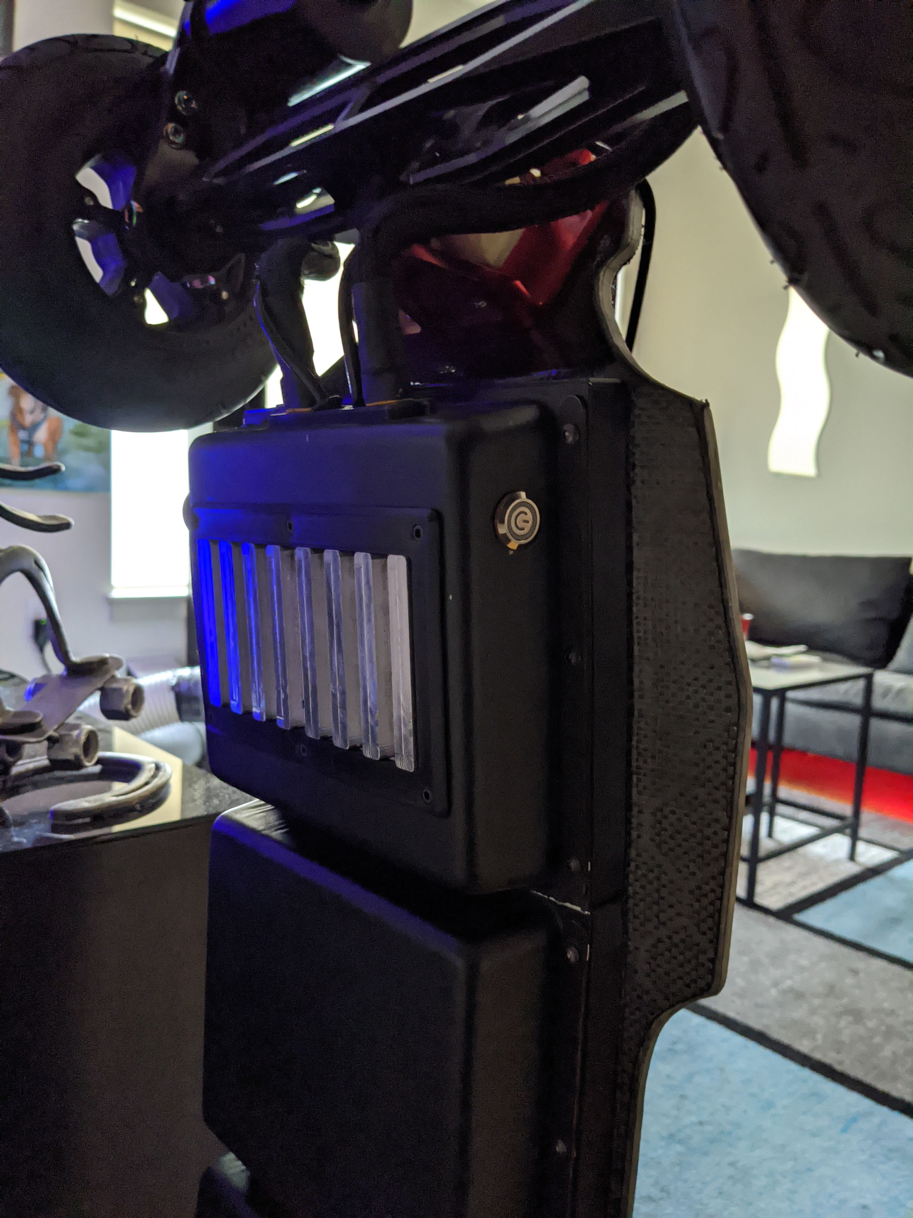

I just wanna keep my build running cool.
I’m a big guy and my hills are real.

I would need to know more about the ESC’s design/layout but the biggest ROI would probably be what you’re doing IMO. But the fins need to be outside the enclosure and a TIM must be used. Either a good non-silicone paste or good epoxy in a very, VERY thin layer.
Optimal can mean different things, but if we are optimizing for performance (instead of price, size, or weight) then material choice, thickness (doesn’t have to be the same across the plate), surface finish and plate flatness (planarity), fin design, ESC mounting method, and other things can be tweaked.

Thanks dude. Appreciate it. No need though. Not in a hurry. Got this monstrosity to holding me over. Works awesome. Doesn’t look awesome. Haha
