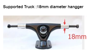

I think this would work. No guarantee it fits any better. can you link the one you have now?
https://diyelectricskateboard.com/collections/drive-wheel-pulleys/products/40t-15mm-abec-drive-wheel-pulley
You’d say 40T over the 36T? I have a 6374 single motor setup 12s4p battery
Preference. Did you do the calculator? Personally I gear for 30 mph and optimize torque. being able to tackle hills is nice.

And just to have a final answer, the torqueboard gear set will most likely fit?
Did you scroll down haha?
Those were my original trucks
yeah but it sais right on that page that the pulley will only work on 18mm diameter trucks.
Until the motor straight up ripped the mount mount out and event welding the mount to the truck didn’t work

The best way to be sure is to measure. Find someone with the TB pulley (dig through posts, and then directly PM them) People here will happily help.
Then measure the diameter of your trucks and compare.
I cannot give you assurances. THats the fun part of diy, is figuring it out :wink:
