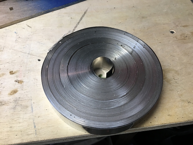

ive got plenty of that no soldering bullshit thank you.
this roll of horse shit was the last straw
You have any idea as to why that is? It’s Super weird.
I have a suspicion that its not nickel at all and is stainless steel.
It doesn’t rust, just makes huge salt crystals grow in your test glass. It throws sparks like mad when you grind it. It welds amazingly well. It does not solder AT ALL. It turns a gorgeous blue when you take a torch to it, not a slightly different shade of grey like good nickel I also have does.
That’s why I loved the stuff I got… Until I tried soldering to it😂
also, another dead giveaway… it throws sparks like mad when you weld it and takes like half the power to weld.
Yeah It definitely took less power to weld but not quite half.
The stuff I got actually dident throw sparks.
oh wow so you might actually have a slightly different flavor of what I’m now calling Horse Shit Nickel™ ,now with fewer sparks.
On my CD150DPM, this shit throws sparks like the shit you see in car factories.
