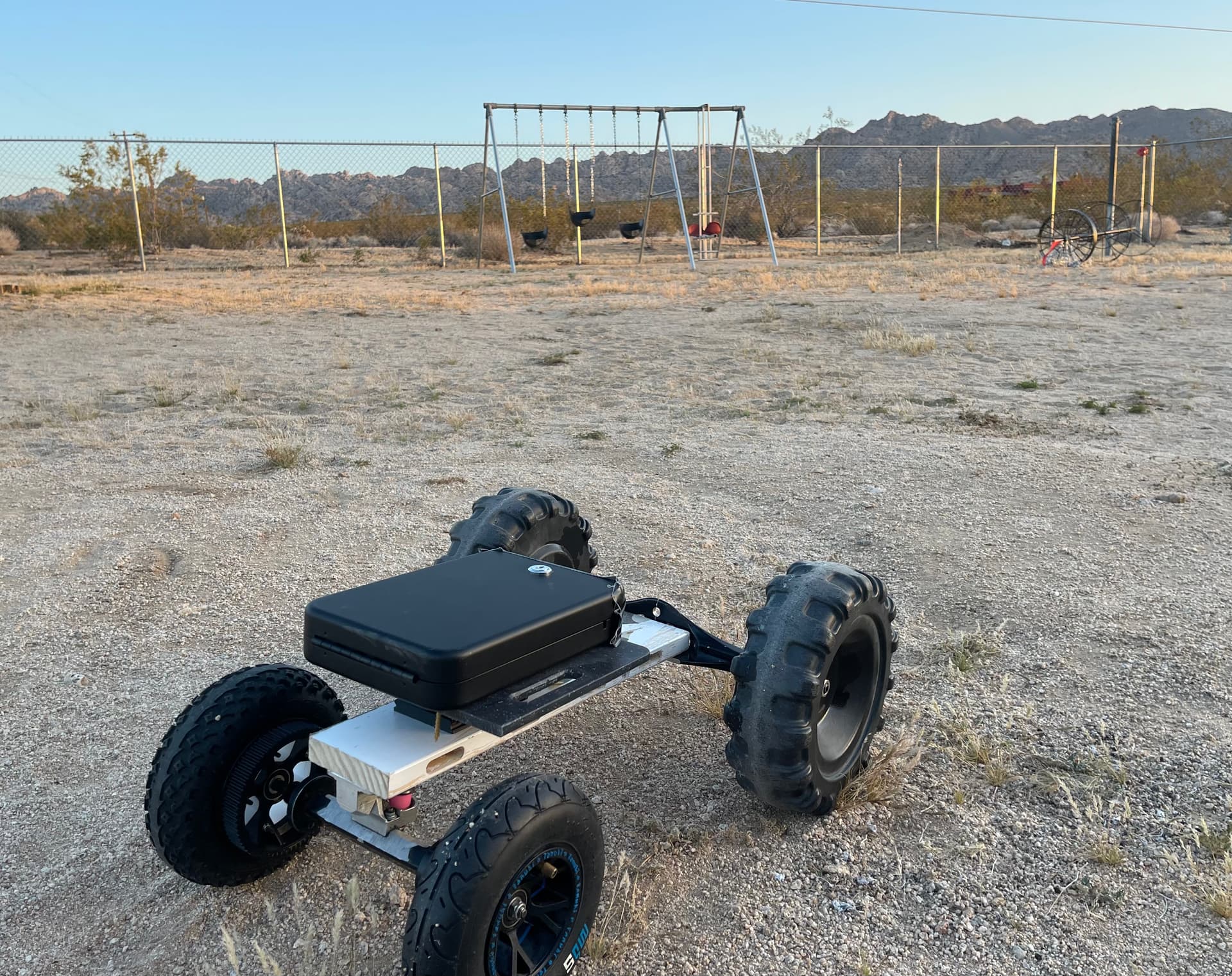

I’m testing my 3d printed picatinny rail mount for mounting big things on boards. Well, bigger than a flash light anyway. Idk about batteries.
Here’s a thing I did.
Printables design
Here’s a polycarbonate print:
I printed two, George ate one and ruined the rail interface.
Mounting the mock-up esc enclosure on a very ‘special’ test sled. Bonus, I’ll test petg and abs printed hubs from @Tanuki. In reality, I’ve already skated nylon cf versions of these hubs and they are fine if printed well.
For ESC’s, I’ve installed a crescent wrench I found on the road and old pliers I permanently borrowed from someone. The point here is, the total ESC enclosure unit weighs in at a hair over 6 lbs, 2.75 kg.
@glyphiks besides throwing it off the roof at the end, I plan on putting a lead on it and dragging it all over the place. George is going to help. Got any suggestions? I might load the board with a 30lbs brake caliper.

Testing was derailed by a lost husky that wandered up to the fence.
Ok, dog break over. His name was Otis. His owner walked by with a flash light and I flagged him down.
The test sled weighs close to a booster board. (25-30ish lbs).
I ran around in big circles letting the wheels catch in the sand. It flipped a few times.
I ran up and down small stairs. I pulled it over ledges.
After 20mins, I was winded and decided to move to the next phase of testing.
I threw it off the roof. I did expect this impact to break it. I didn’t mean for it to hit the brick wall.
Close ups of failure pattern:
@glyphiks not layer line failure, that shattered. I should note the print settings. 0.6 nozzle, 6 walls, 3 base, 5 top, gyroid 30%.
Could be denser, but warping is a concern. This PC profile was manually tuned for Temp, extrusion multiplier, and pressure advance (earlier that night).
It was printed at half normal x1c PC speed. Filament was bone dry (hygrometer at 10% relative humidity sitting in sealed bin with 1kg alumina desiccant, not the silica dioxide stuff)
The dumb front truck setup broke near the end of the donut laps. I cut that truck up awhile back. It was solid enough for me to stand on and kick push on before it broke during pulled laps.
Last bit of data, the cheap lcd hygrometers do not inspire confidence. I have a much better wireless humidity sensor I keep in the AMS of the X1C. My AMS sits on top of the printer.
The printer room has the windows screwed shut, the AC vent closed, and the door shut.
The sensor data from inside the AMS during printing. (I also use alumina desiccant in the AMS. It can absorb more moisture than the silica blue beads)
And finally, my conclusion.
This ‘testing’ has plenty of holes. It was substantial really only to me. I felt how hard it hit ledges, and I’m not about to pull out the accelerometer and raspberry pi off my klippered cr10 (which I did finally get input shaping working) and put it on the test sled.
The enclosure weight was 6 lbs. if your ESC enclosure weighs that much, WTF are you putting in it?
I wouldn’t trust someone else’s 3d printed claims of durability unless I could touch and use the part myself.
I am reassured by the following:
-AT boards have inherent dampening which improves printed parts resistance to shear forces
-the part did not break on layer lines, it shattered. I bet a good nylon like taulman would do better.
-this was not a high infill part, it was a draft.
-it survived the donut laps and stairs which is how I might actually ride. The roof fall is not how I ride.
This experiment satisfied my expectations for printed feasibility.
