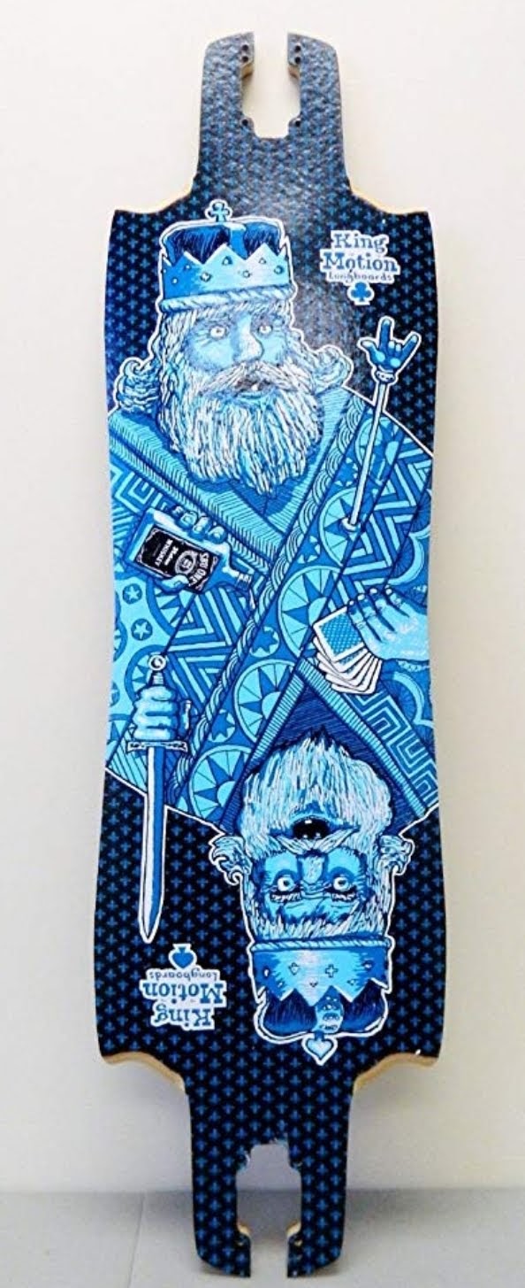

Trying to make a board like this mine looks really high, the board in the pic here it looks the trucks are mounted in the deck differently how is this done? There is a differet mounting bracket that sits on the top

You need a deck with a cutout like the hummie or evolve style decks have.
Then you just assemble it so that the baseplate sits on the top of your deck instead of touching the bottom.
This style is called “drop through”

The top bracket is just the truck baseplate
No a router won’t delaminate the ply, one moment
That bracket is the top of the truck. It is normally on the bottom of the board.
Yes I see now Thanks
Go for it man, you have the right tool for the job!
There is no bracket, the baseplate of the truck is mounted, from the top, through a cutout in the deck. These kind of decks are referred to as a “drop-through” decks. That specific deck is a Sector 9 Bintang.
