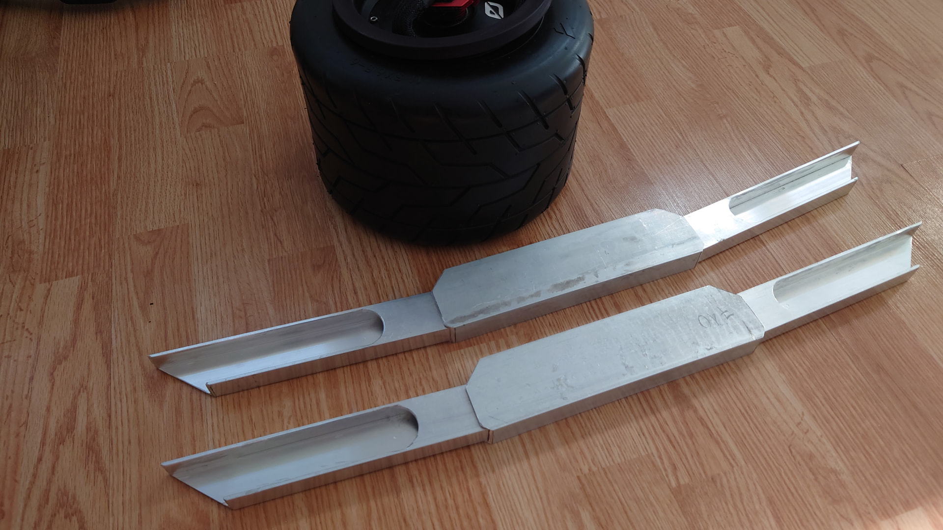

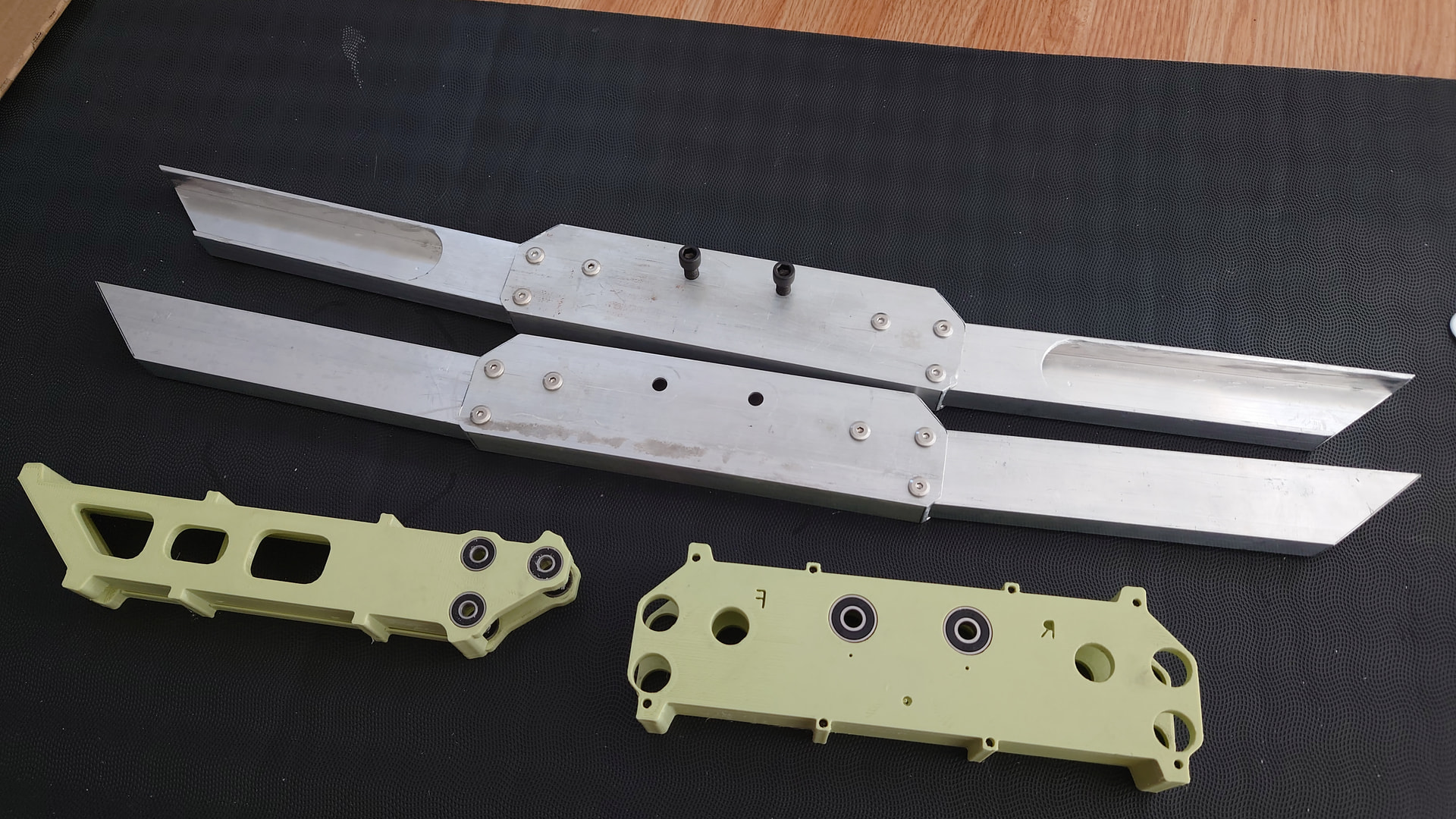

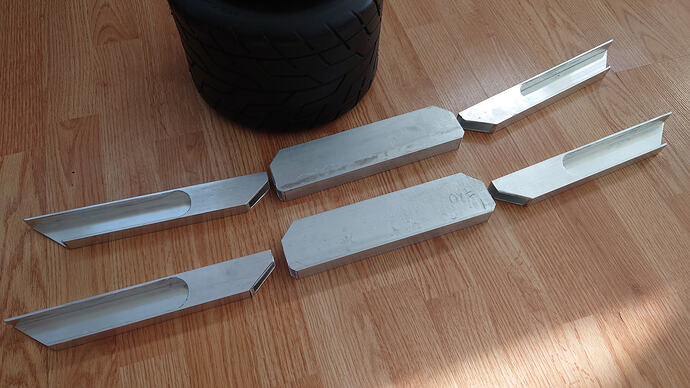

Hardware Store Special onewheel build.

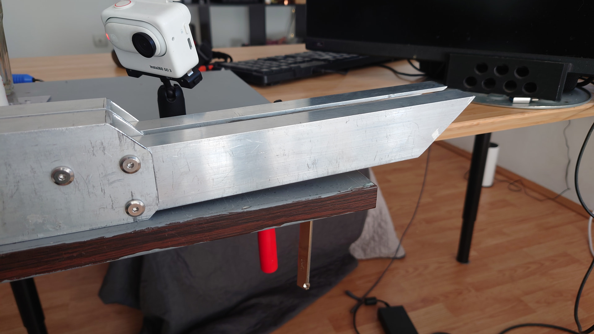

Finished grinding the rails.
Waiting for furniture screws now.

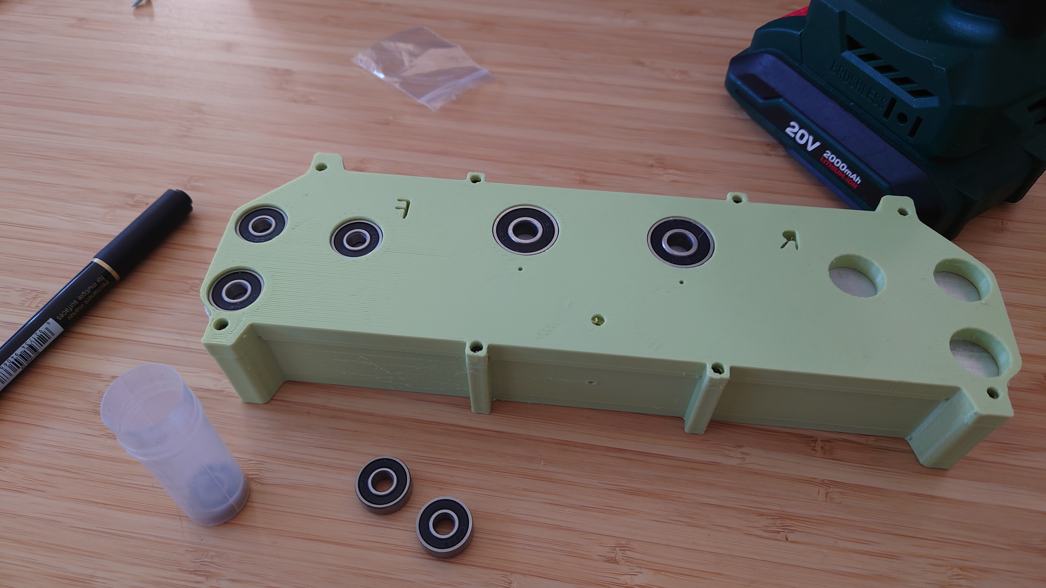

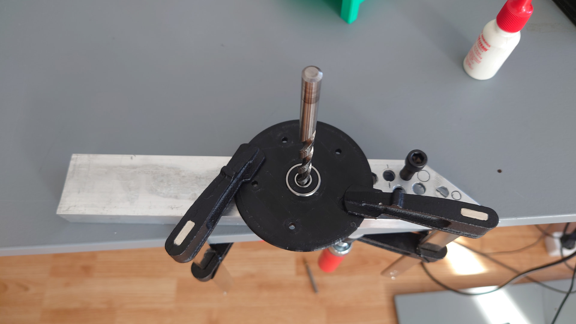

Furniture screws arrived and I was gonna do some drilling today. But after couple of test I’ve learned that free-hand drilling a perfectly round hole bigger than 5mm with a cheap drill is next to impossible.
I got great results with a bearing as a guide:
I have both 8mm and 6mm bearings. Now I have to design some new jigs that fit the bearings.
Quite happy with the precision:

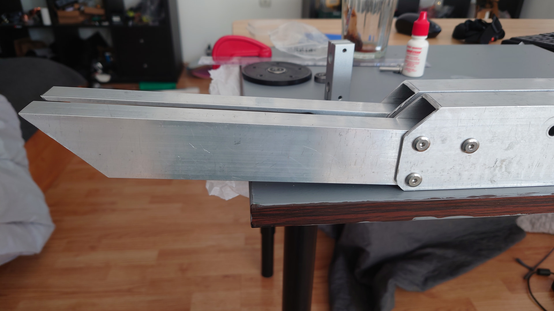

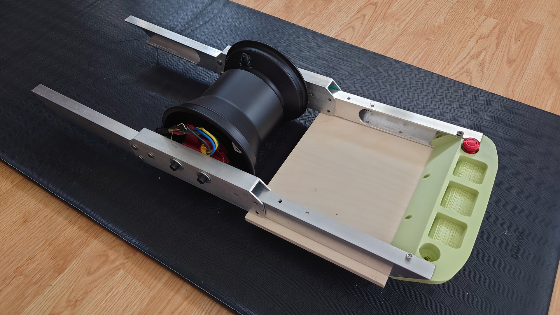

HSS update :smiling_face_with_sunglasses:
Fitted the central spacers.

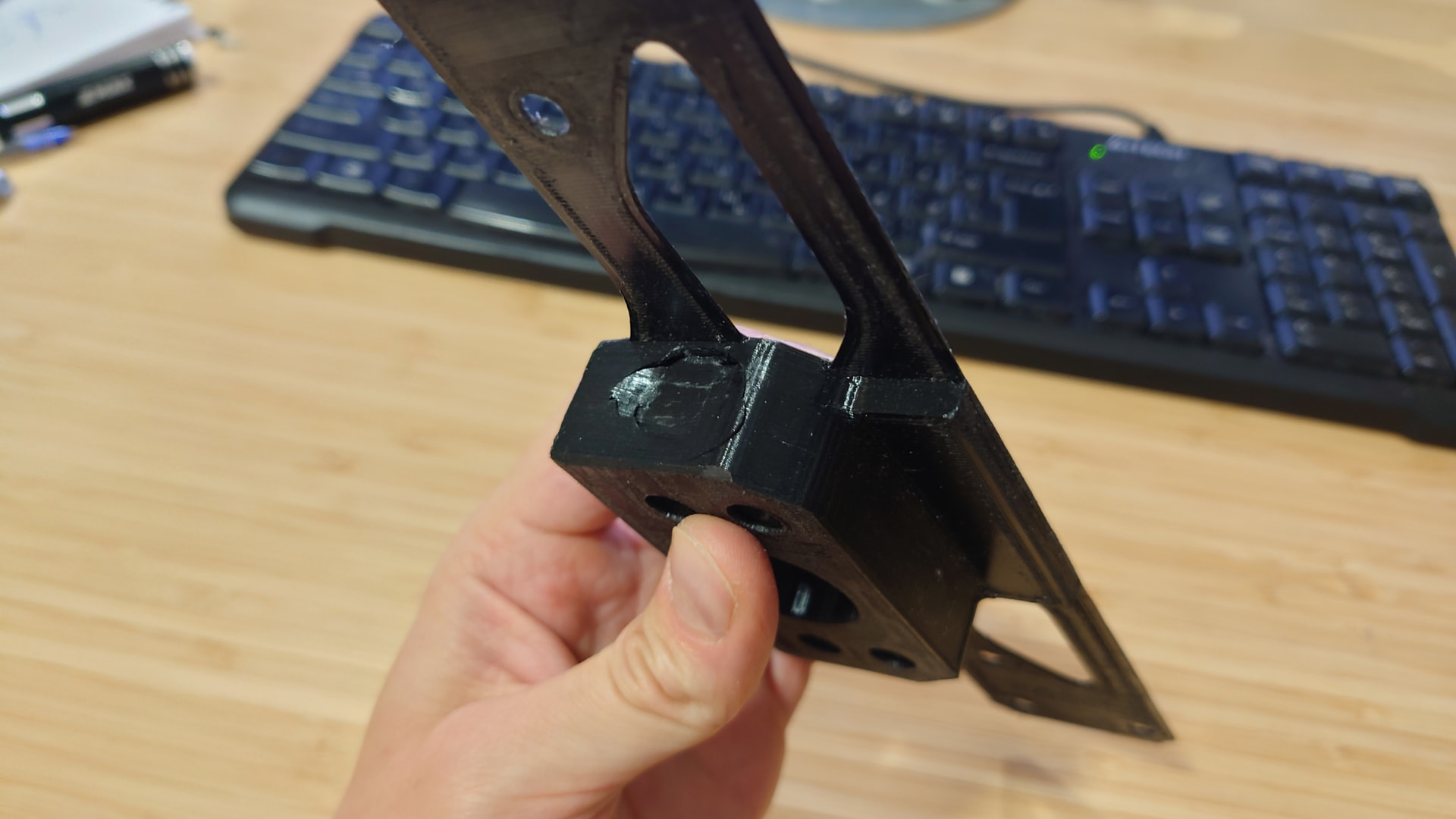

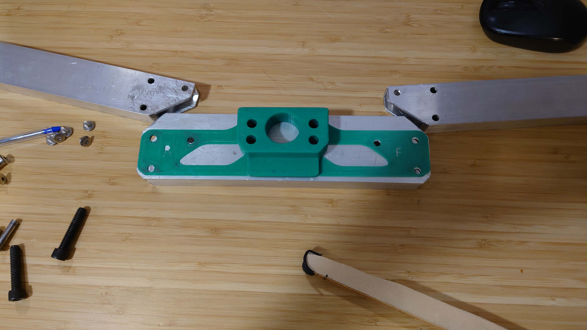

Seems like a simple part, but it took many tests and a lot sanding and hammering:
I had to reinforce it to withstand percussive installation process:

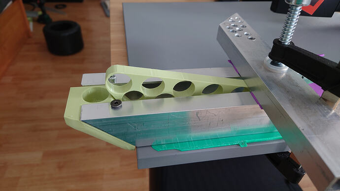

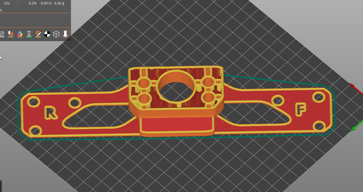

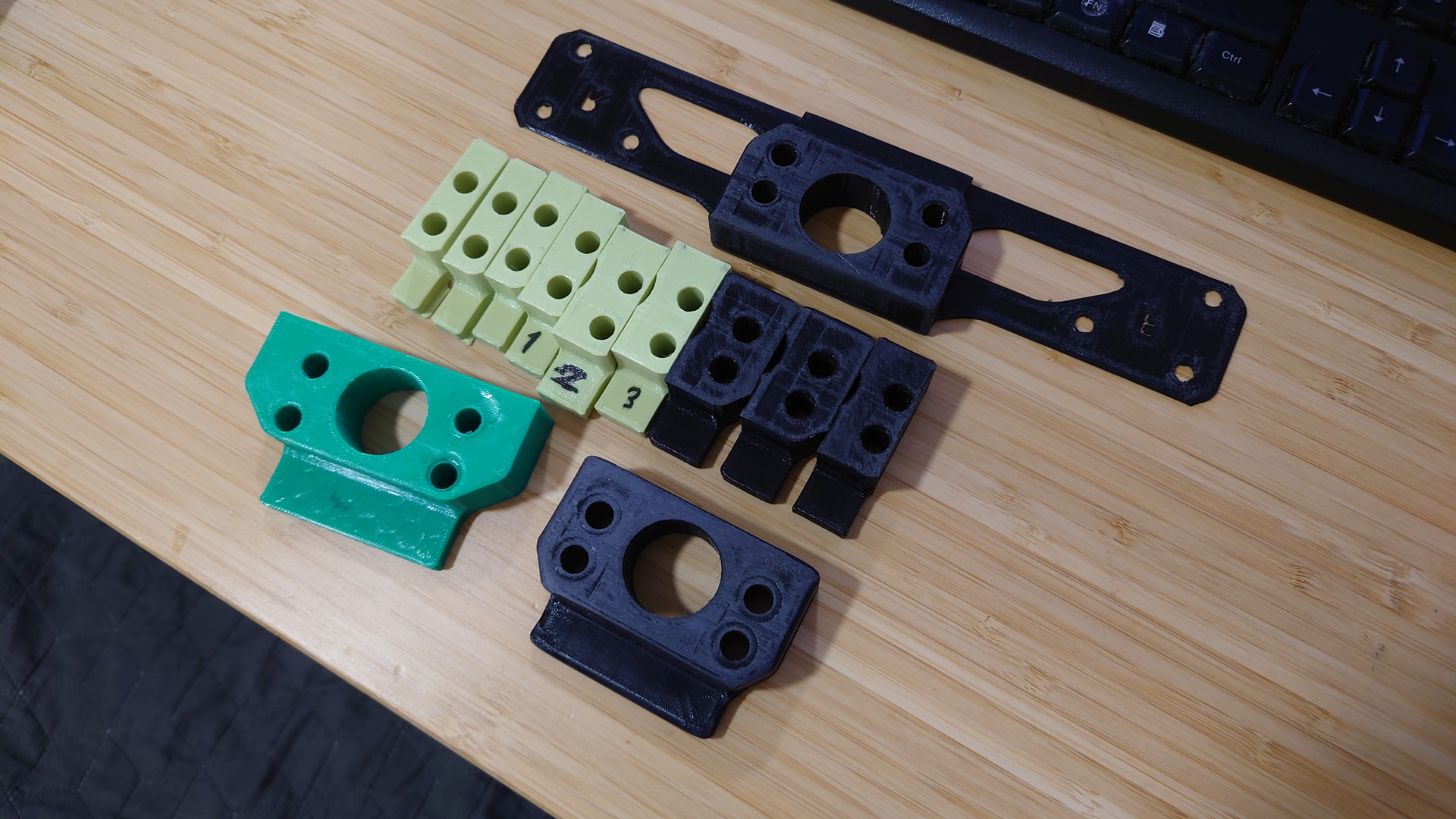

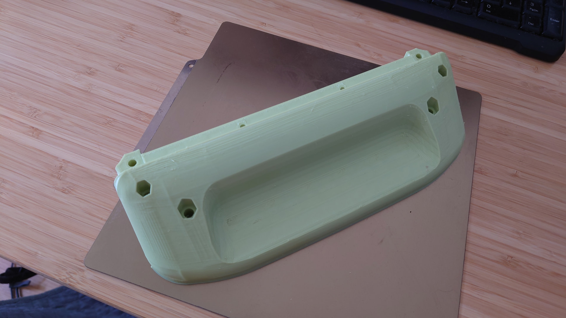

Trying to figure out the removable battery fitment:

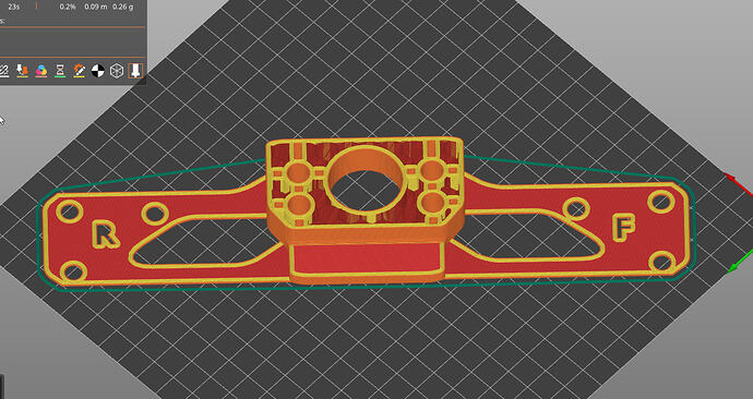

Test bumper print:
