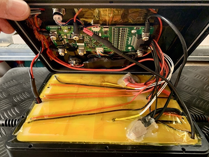

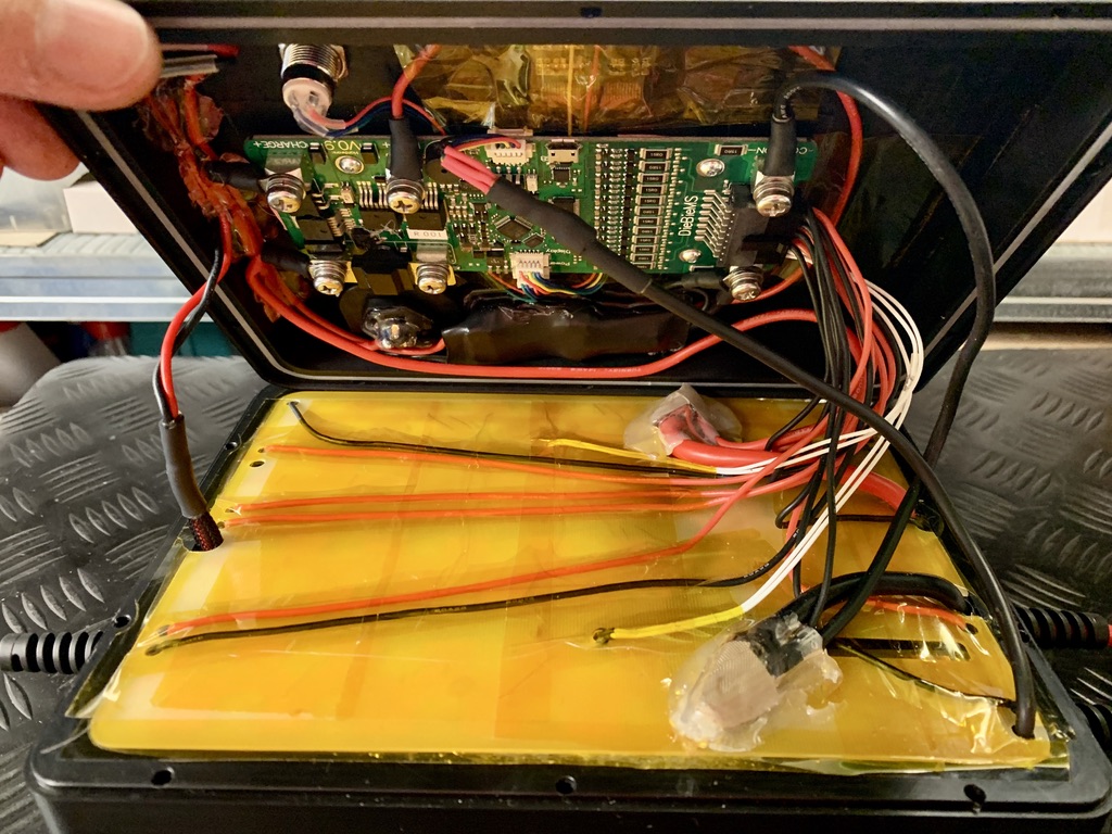

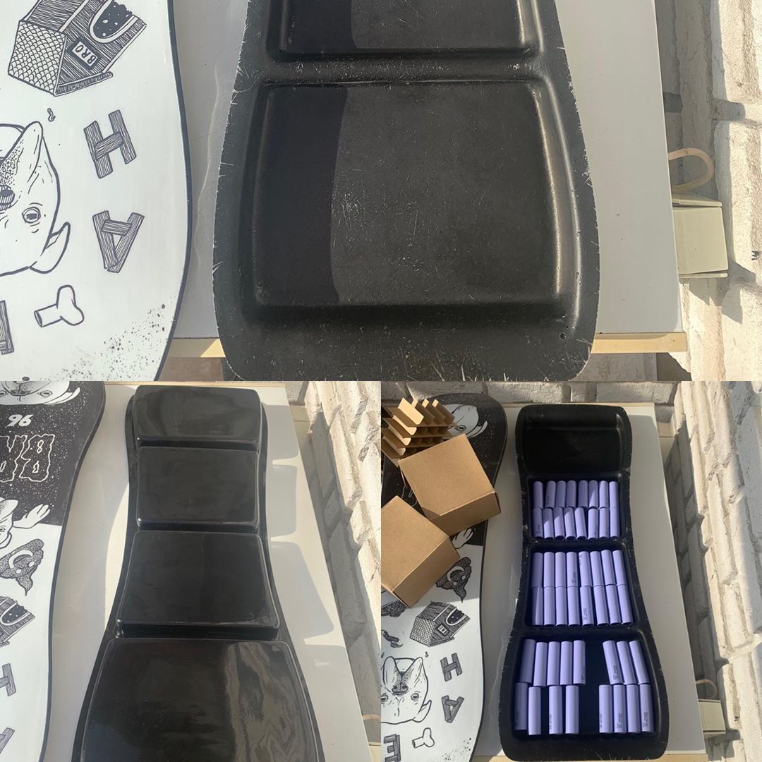

What’s the dimensions on that enclosure?
Length 230mm width 170mm height 120mm :grinning:
Construction looks really good!
Like @ducktaperules I’m also interested in the all up weight of the enclosure, plus battery pack and electronics. Basically the whole unit as mounted to the middle of the deck.
Lastly, is that a 5V or 12V output poking out the front?
Front cable output is 12V… :grinning:
Even better. Do want this setup so badly rn. Good work!

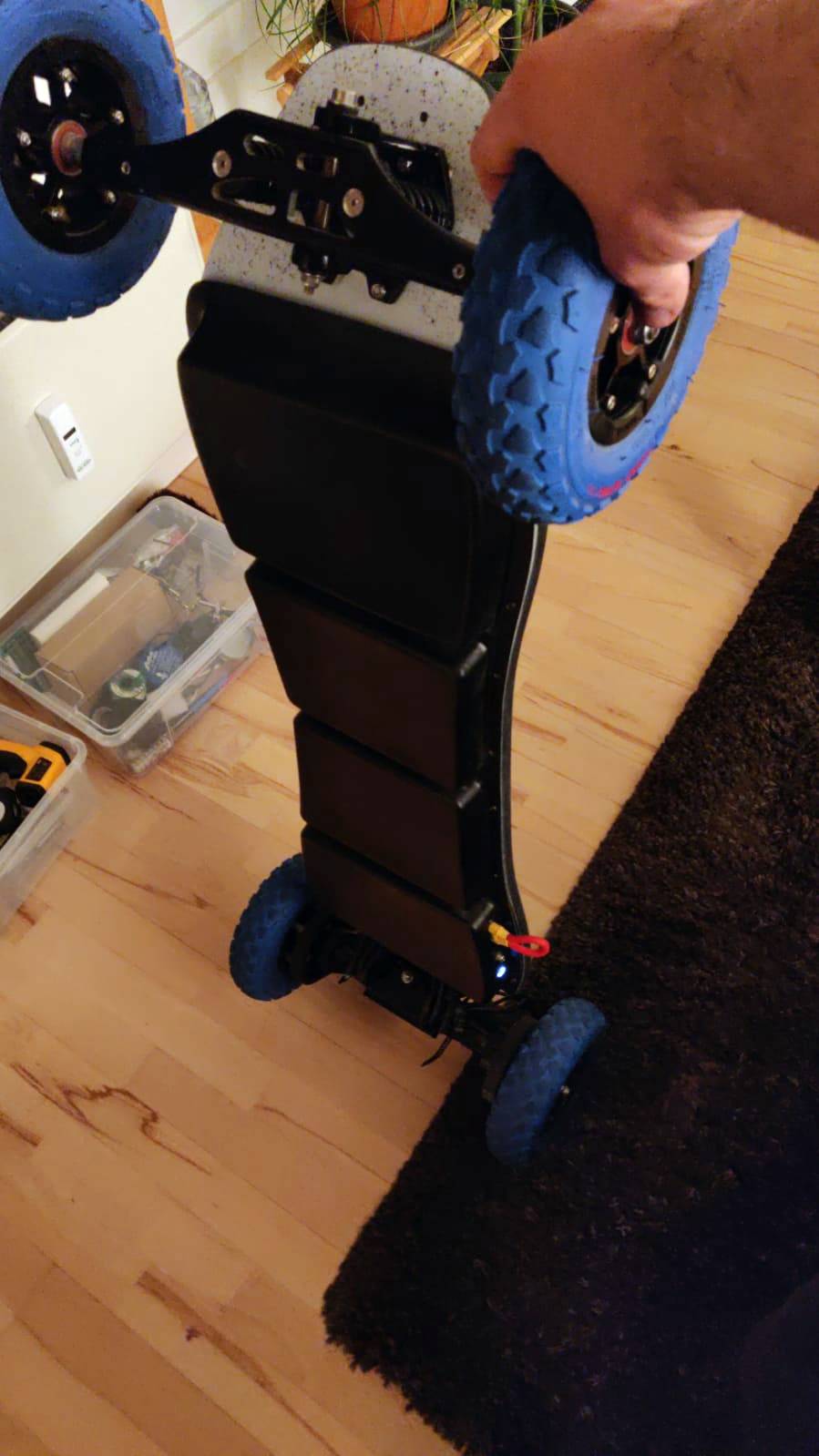

What brand are those Silver Trucks ??
thanks.
Prototypes from E-Toxx for testing, not available yet…

The enclosure from @BigBen is very nice!
I am testing it for 2 weeks now, and its pretty solid… plenty of space too!
Just put a gasket between the deck and the enclosure, dust can be a big problem as i saw.

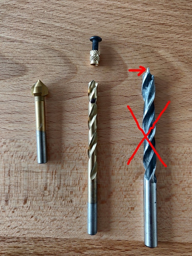

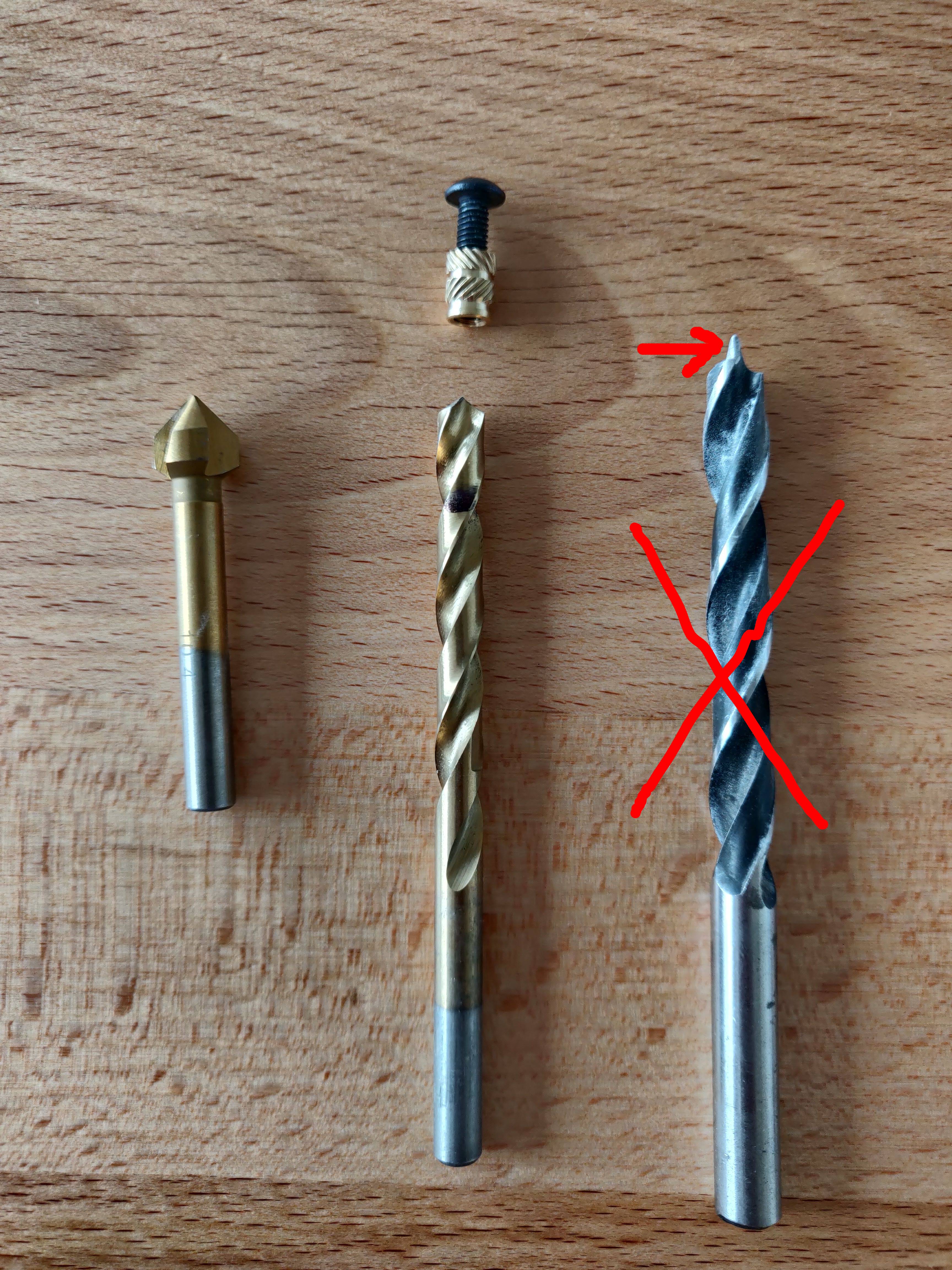

For anyone who wants to know how I inserted the threaded inserts without drilling completely through the deck.
I used a metal drill because I did not want to drill completely through the deck. This is (because of the tip) hardly possible with a wood drill, although this would be the better choice for the material.
it is a good idea to use a countersink to remove the remains of the upper layer, so that the thread insert fits well into the hole. otherwise it can jam. This is what you want to avoid with the epoxy on it.

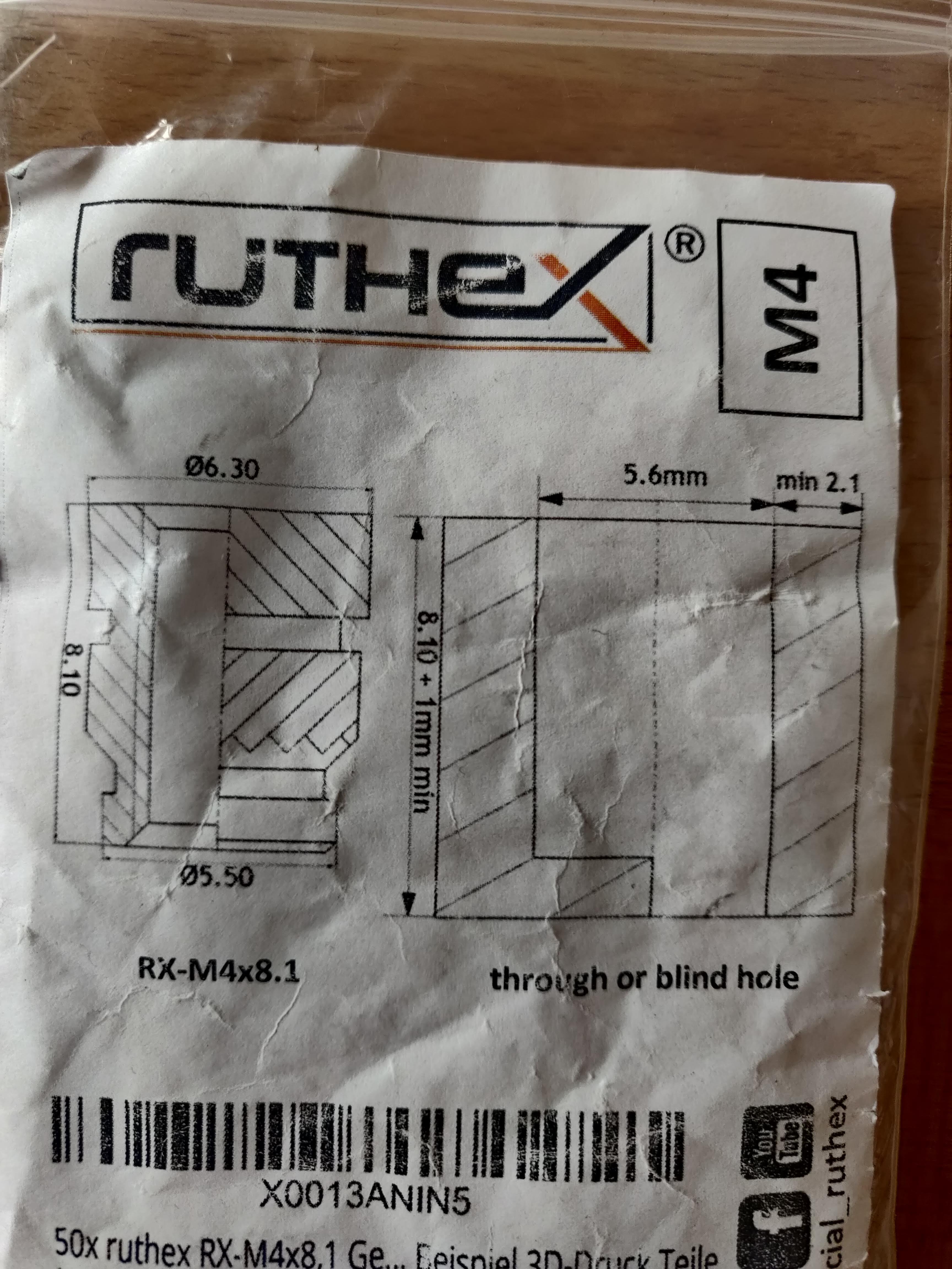

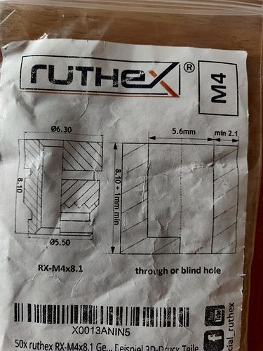

As you can see on the package the outer diameter is 6,3mm. I used a 6mm drill here, so the insert fits well and the epoxy fixes the whole thing.

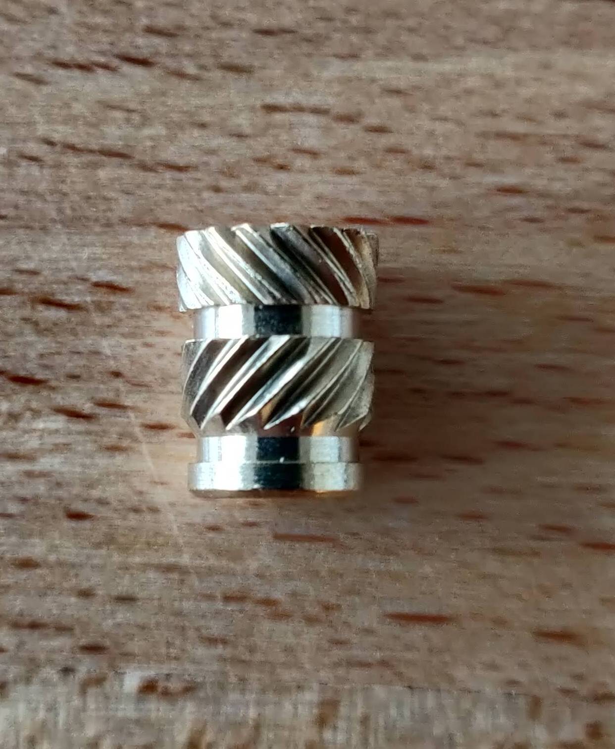

I used brass for the thread insert. These are actually intended for 3D prints, but stainless steel was not available at short notice.
I glued them in with some epoxy and let them harden for about 8 hours.
This worked very well.
in order not to damage the inserts during insertion, a long screw (at least halfway through, so that the thread is not damaged) should be screwed into the insert and possibly lightly hammered in.

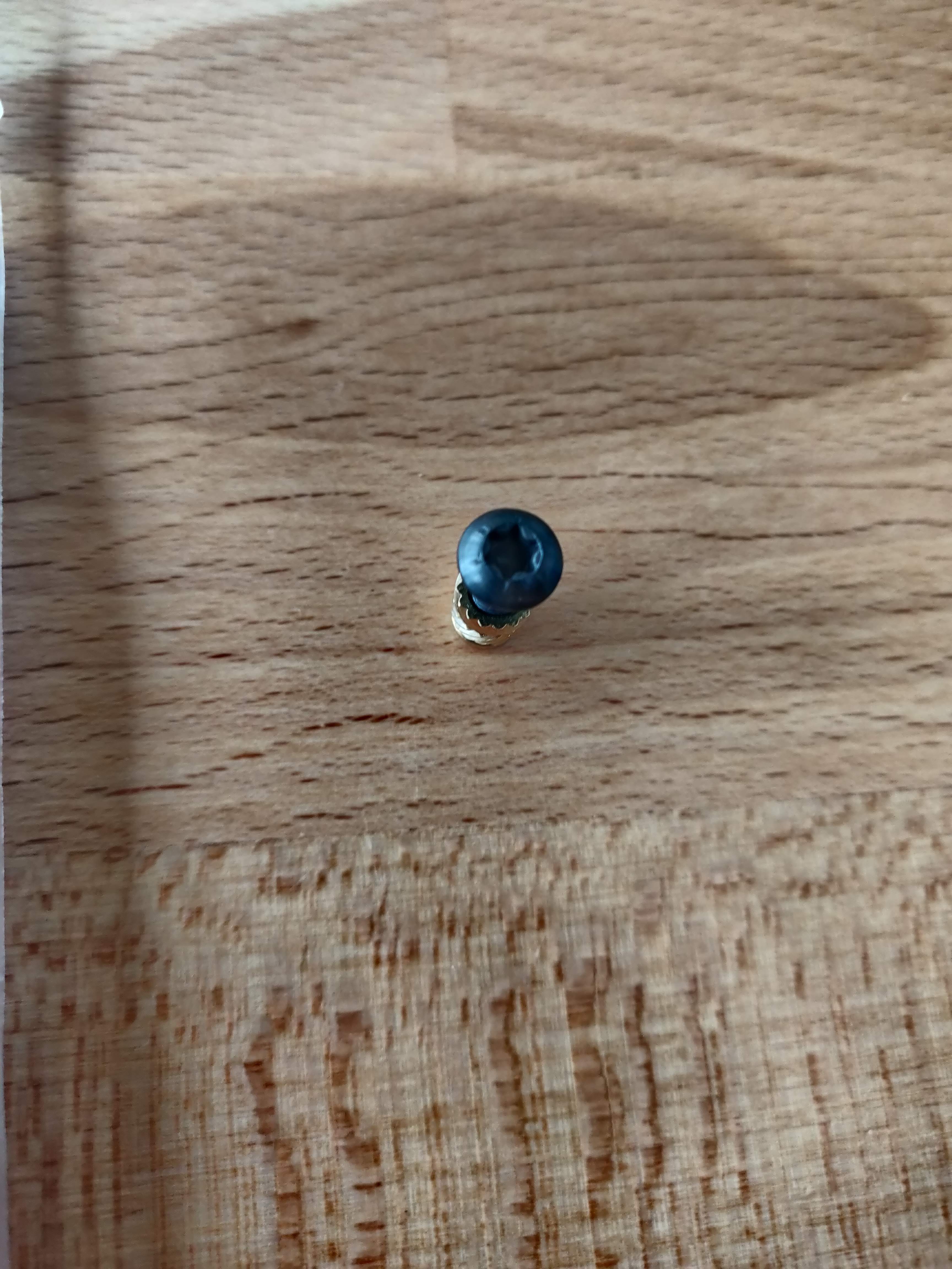

One last Thing: Please do not use hexagonal screws anymore. The screw heads break very quickly and Torx is used everywhere in the industry for good reason! You can screw them in and out very often without damaging the head.

Very intelligent! Flipped Hanger give extra ground clearance too! #justsayin for the others
