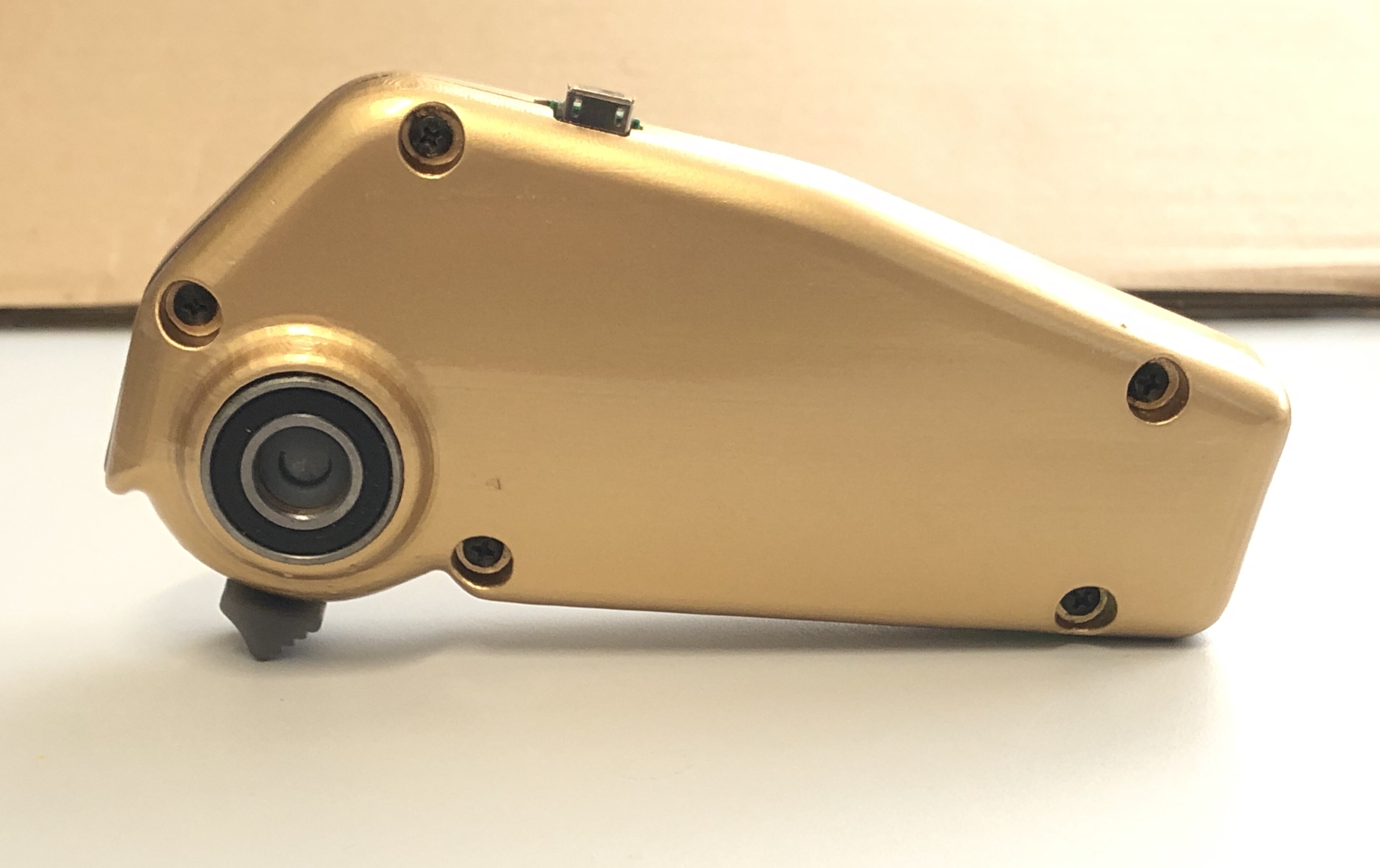

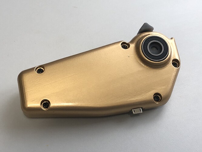

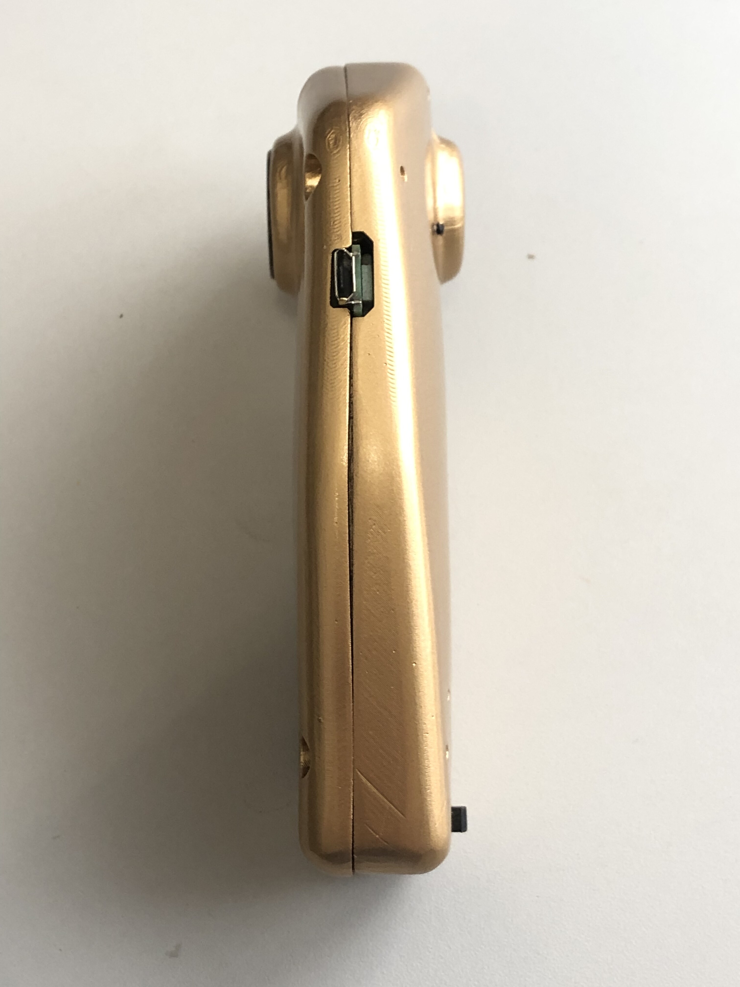

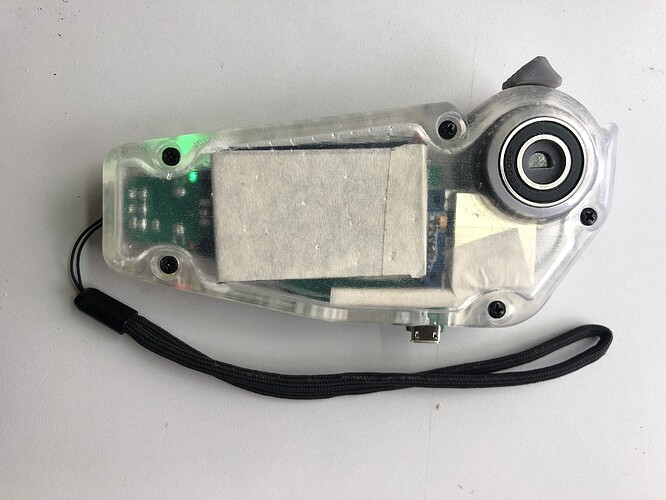

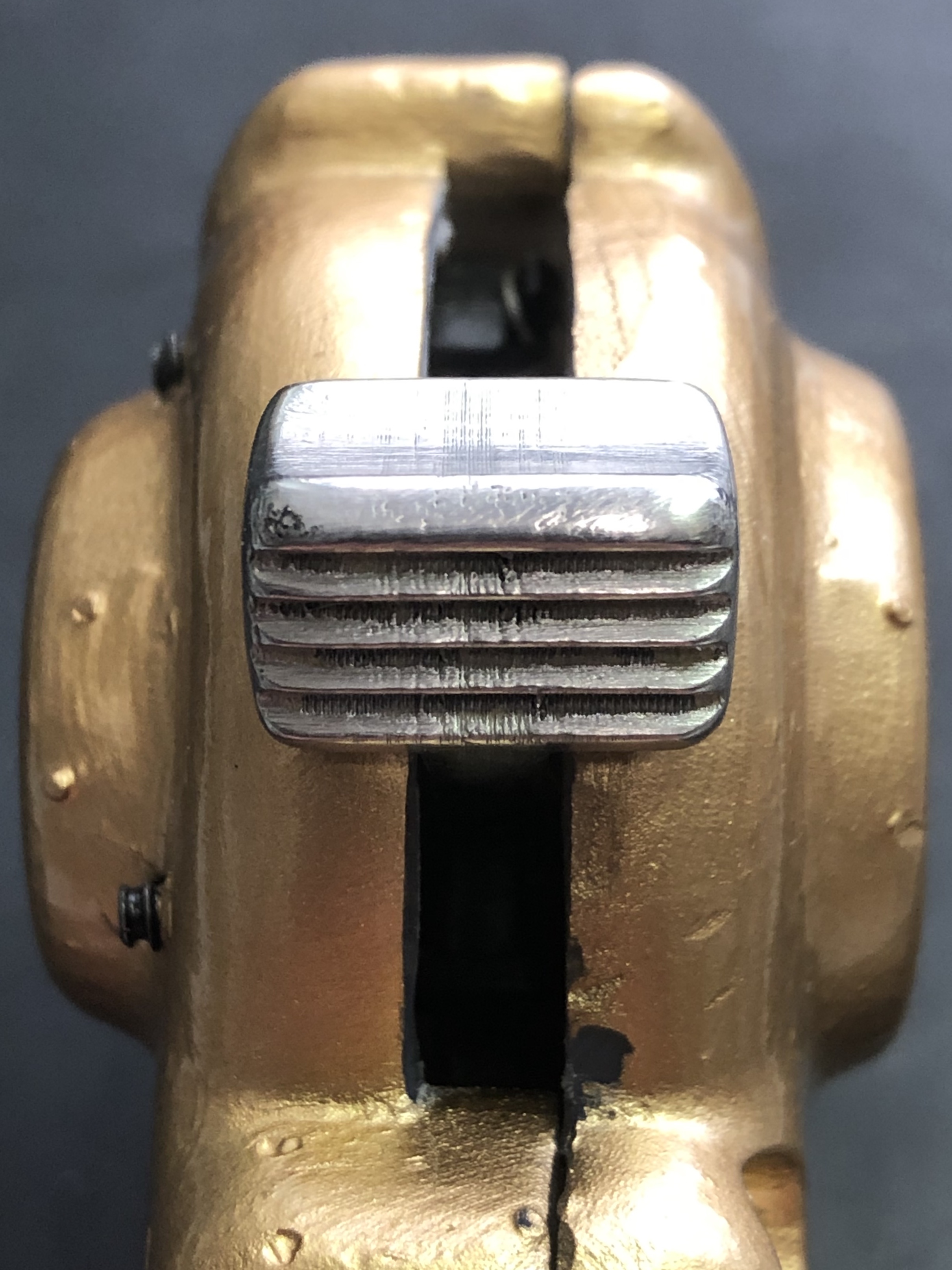

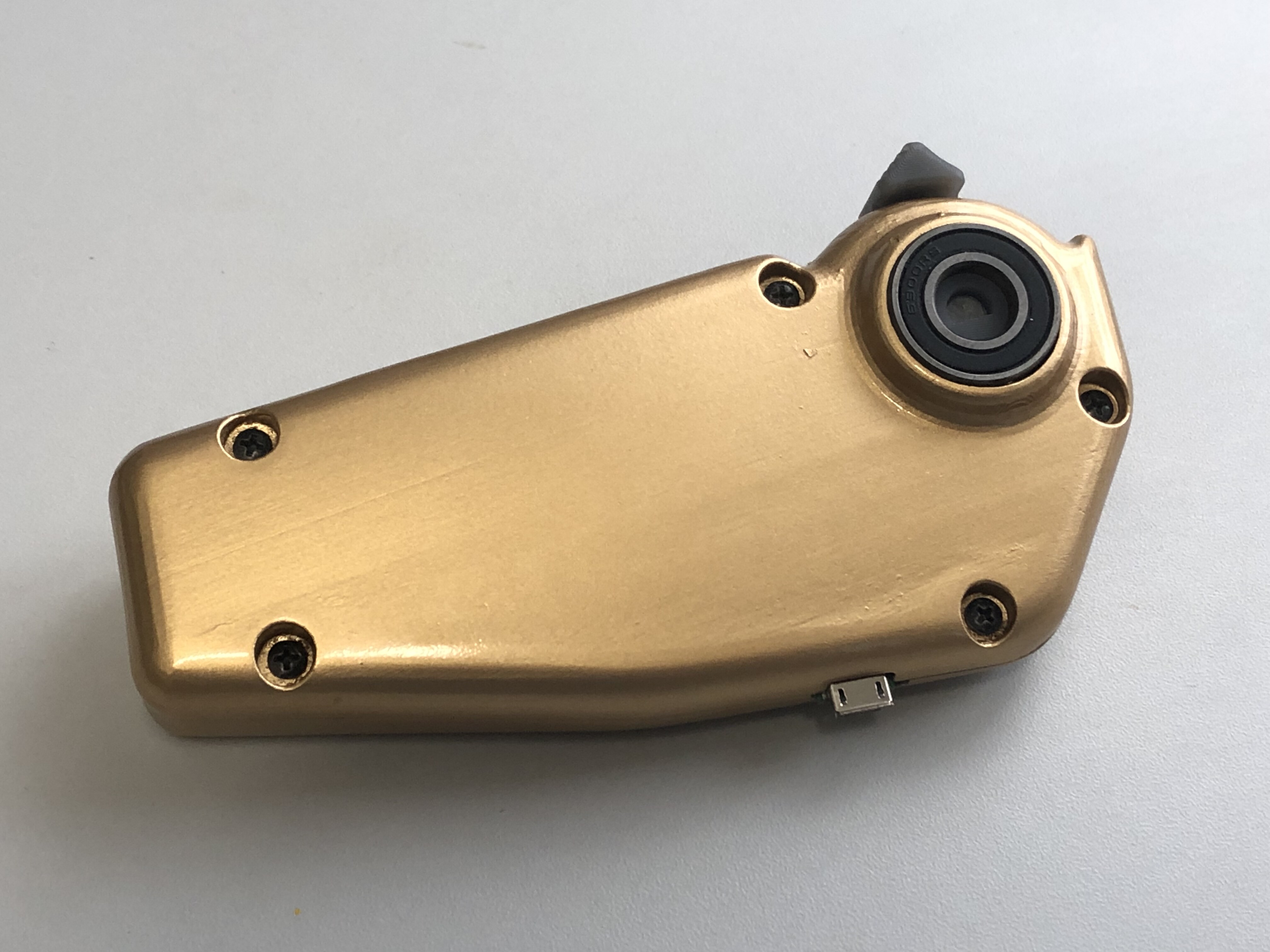

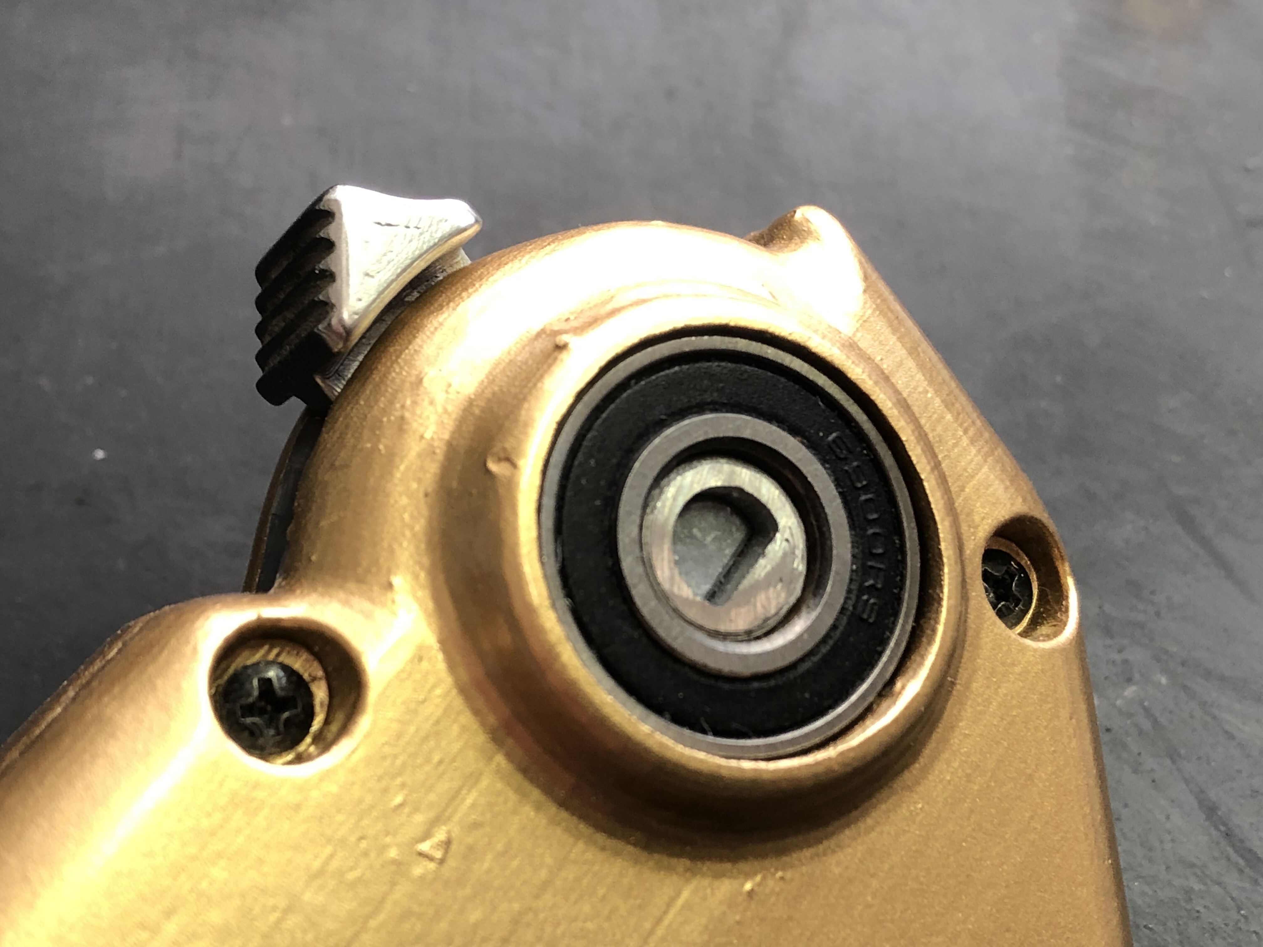

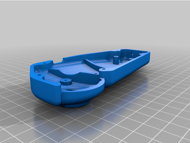

Yeah I do, I designed it couple years ago but never made it public. I just put on thingieverse now.

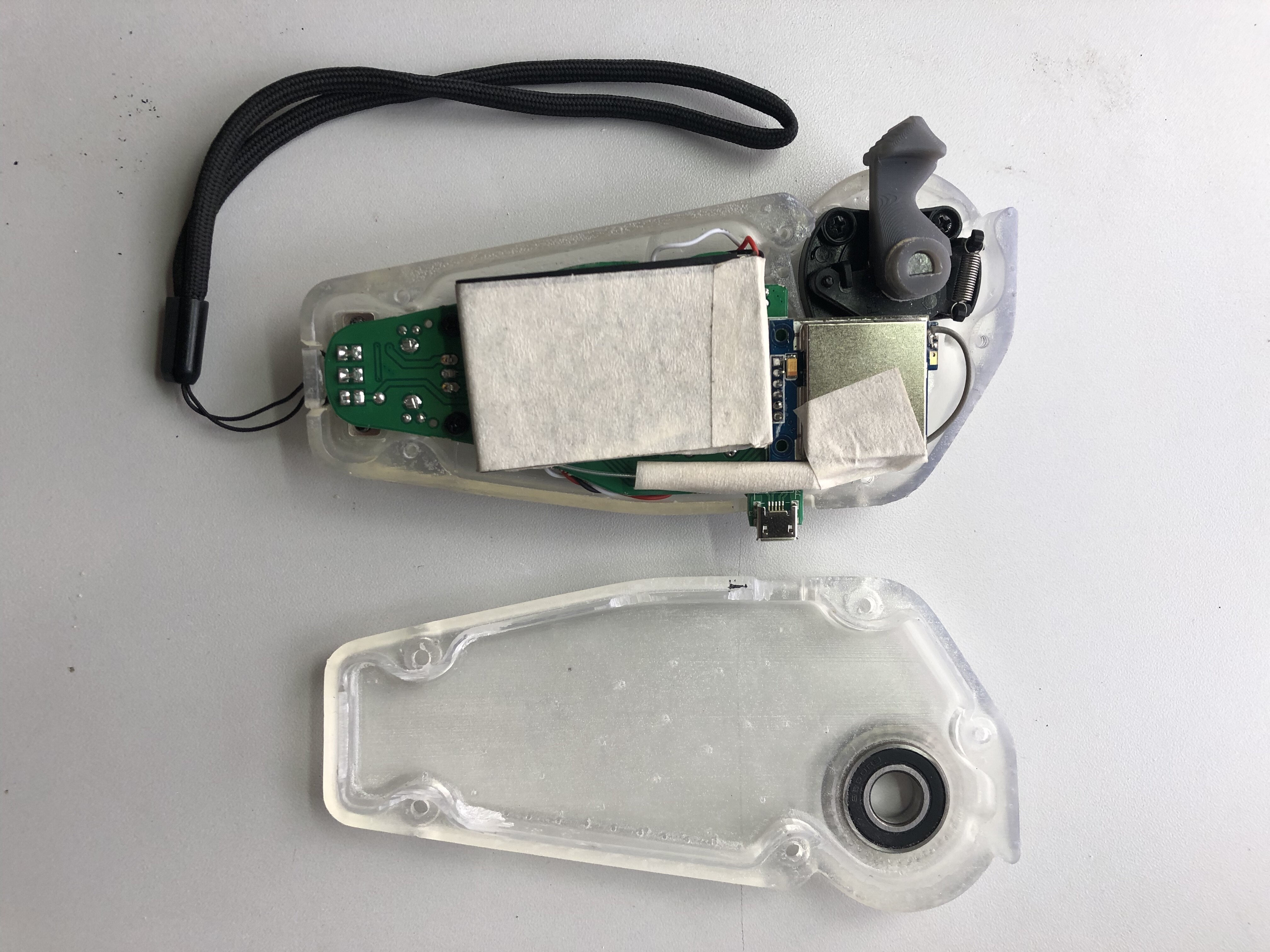

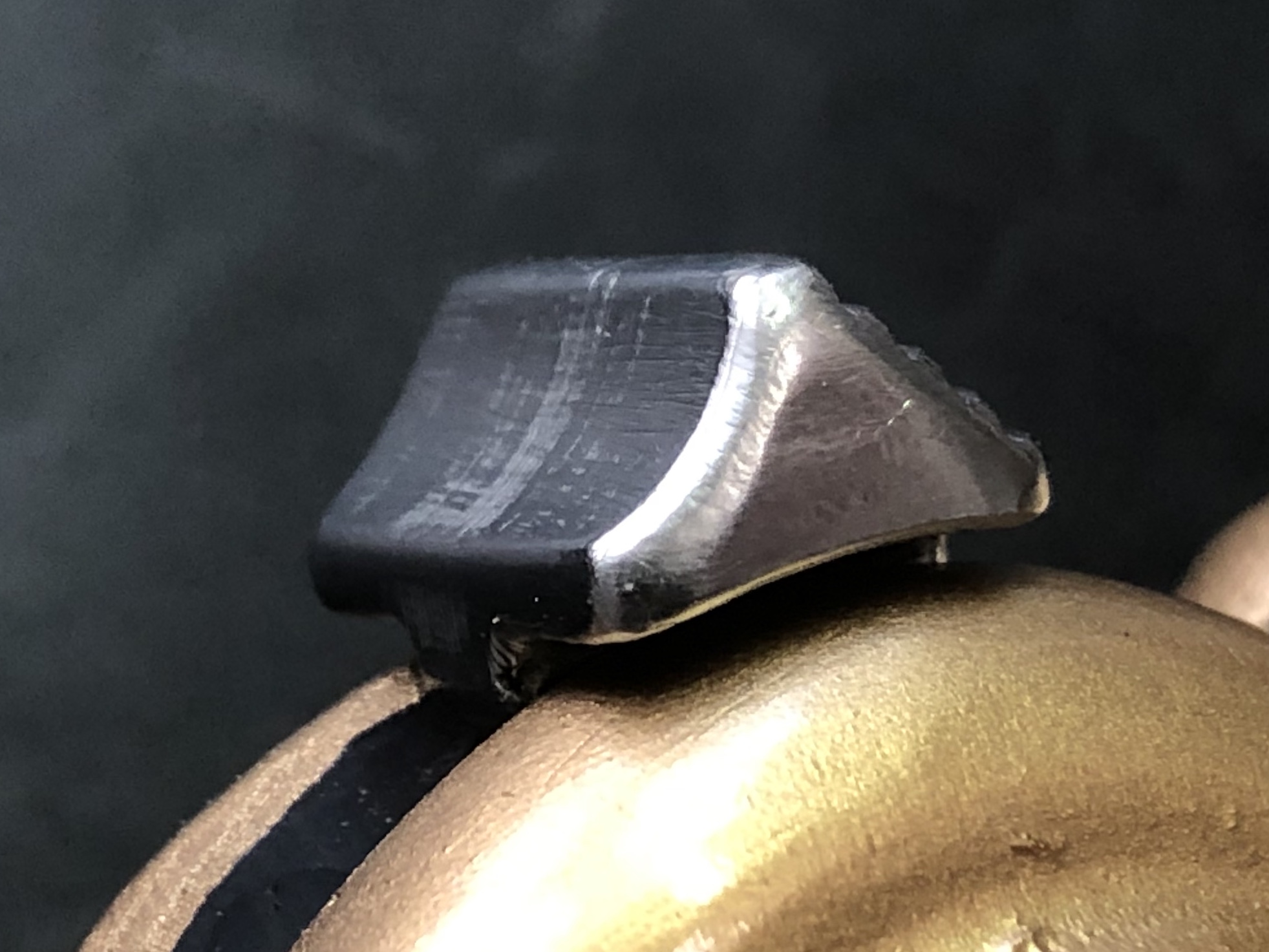

It was designed to be printed on resin printer so it may be a bit challenging to print on FDM, flat surfaces are limited. Also it has two options for the thumb stick with different size bearings, I prefer to use 6900, which has 10mm ID, this gives a bit more wall thickness to the bearing seat.
The design was inspired by the buffalo remote but I wanted it to be slimmer and more ergonomic.

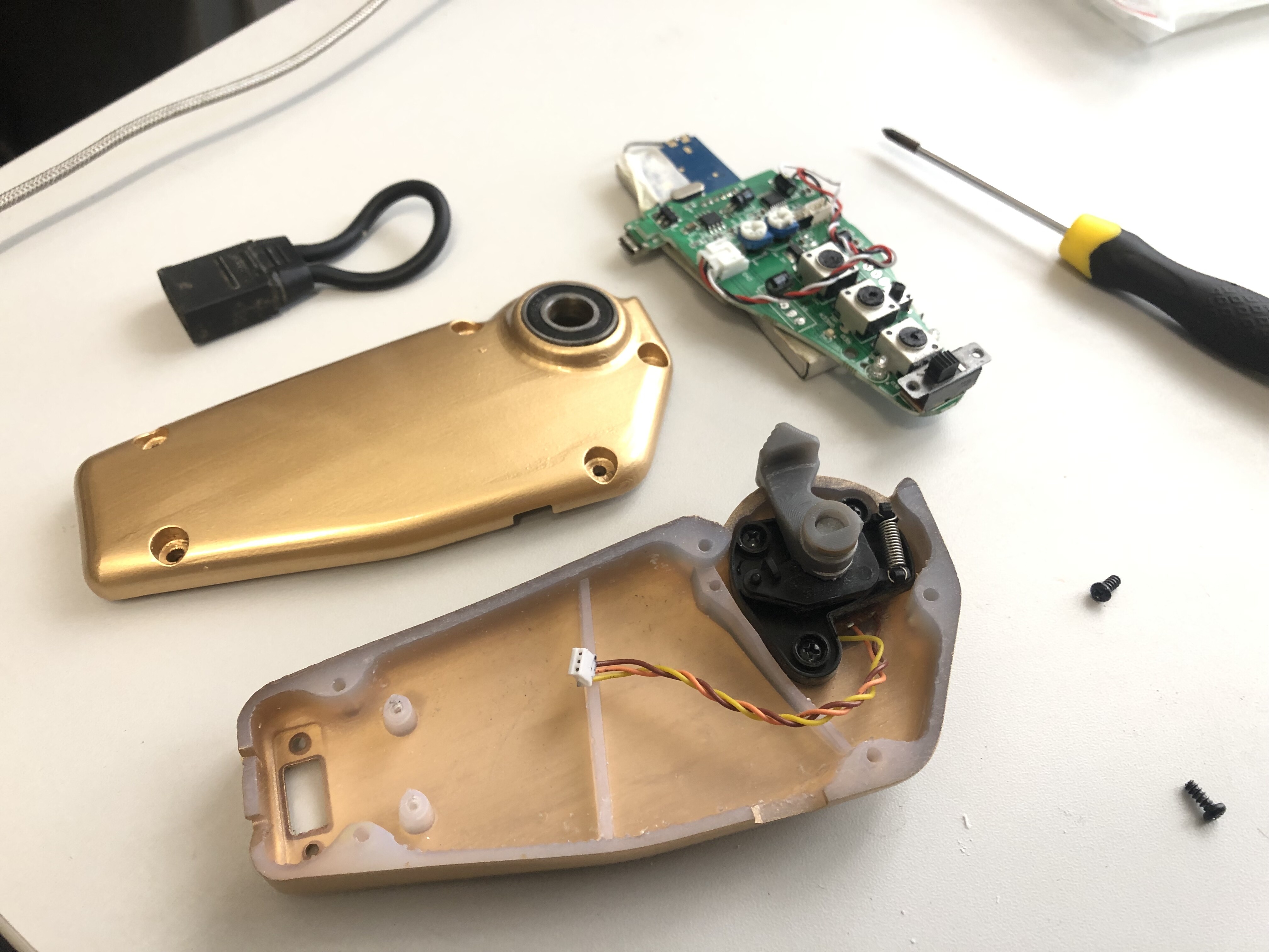

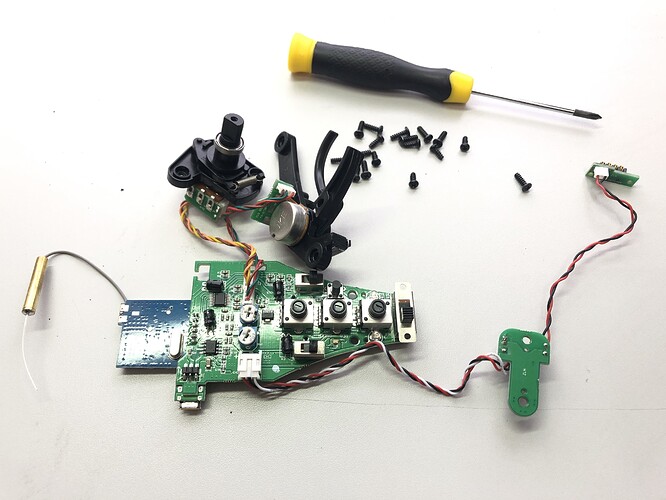

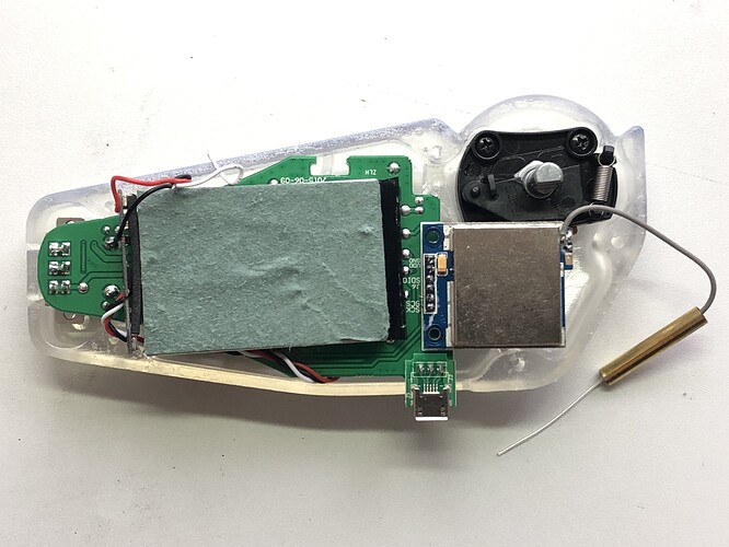

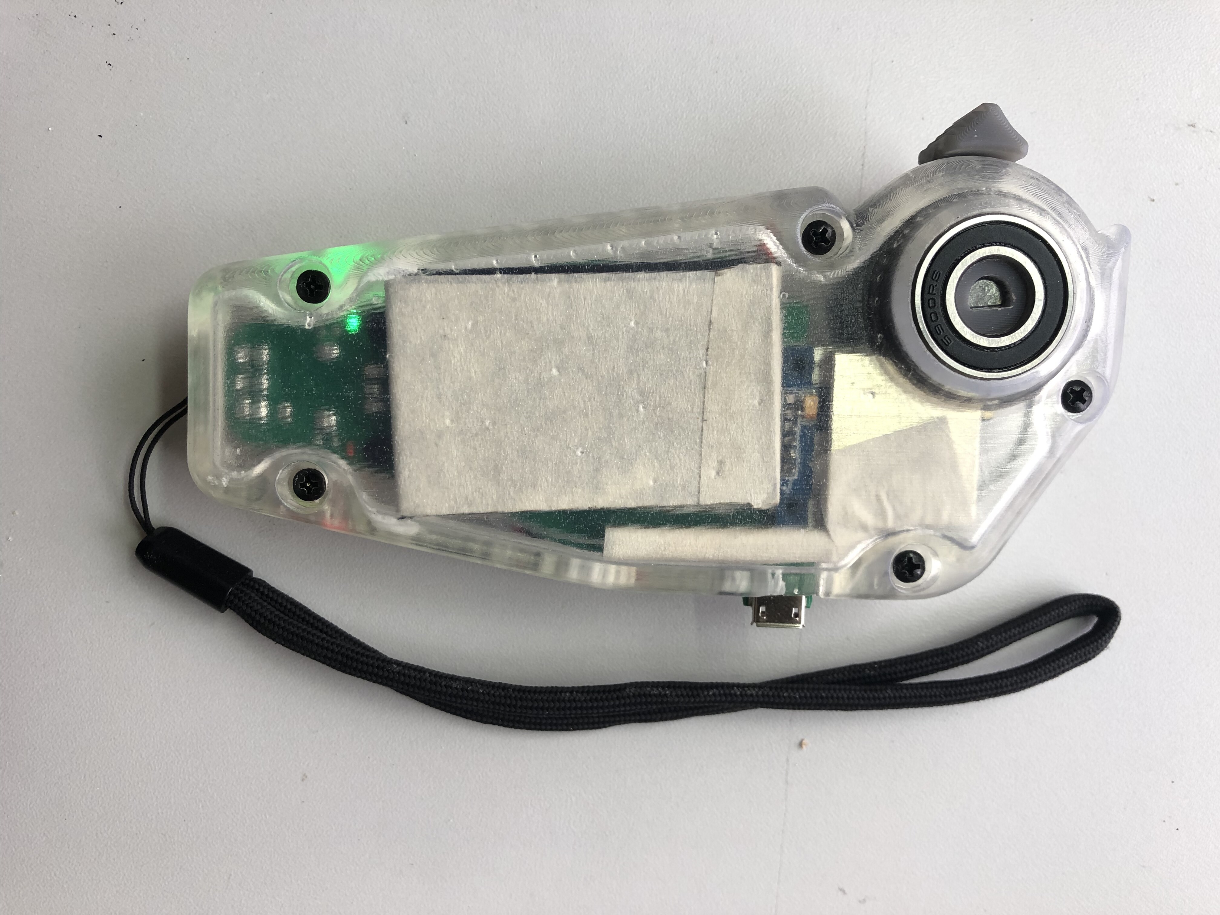

I have been trying to dig up some photos of the mod. Some other things to mention is you can use screws from the GT2B for the mod. The power switch though requires some really small screws.

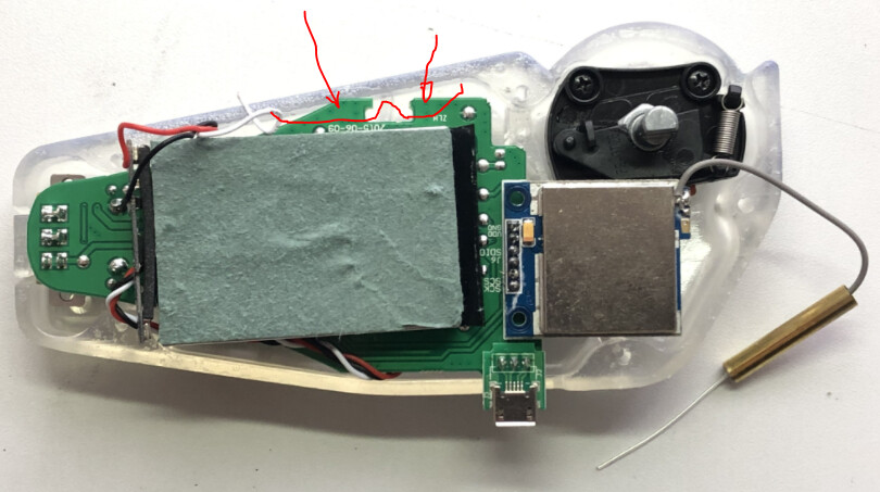

Also the pcb may require a small amount of trimming shown with red line below.
