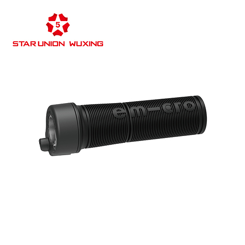

i got a vesc6 and want to hook up a hand-twist throttle that uses regen. Ive found a two-direction throttle manufacturer and they’re asking what details and plugs it will need but i dont know.
here’s the throttle:

So the product page has no information on what the output signals are or even a wiring diagram. I would definitely need more info from the manufacturer on some basic electrical details for this thing.
It simply could house two separate hall effect based analog outputs. If so, then this would just kinda be like 2 twist throttles in one and would use 2 ADC channels. However, I can’t confirm anything unless more details are provided.
Another possibility is that the neutral position of the throttle outputs a reference voltage somewhere in between ground and Vcc. Twisting up causes the output voltage to rise and twisting down causes it the drop or vise versa. Then the VESC would have to be configured to handle this.
The other way to find out is to simply order a sample then analyze the outputs with a multimeter or oscilloscope. An analog signal with vary directly with how much you’re twisting it. PPM will appear as a kind of pulse waveform and you’ll need an oscilloscope to look at it.
I know I’m not a wizzard (just a lowly necromancer) but I have an ADC throttle working with a FSESC and I set it up for regen.
or… it could be one single hall sensor/pot and the spring action is set to return to the middle of the throw.
in this case. you would set it up the same way I set the scooter up. ADC throttle, current with brake, set the center (or “coast”) somewhere in the middle and it will brake when the throttle is in the resting position. In this case, you’ll need to roll the throttle a little to release the brake and start kicking along. more throttle engages the motor. roll back to that point to start braking, full brake when throttle is released completely.

Easiest would be what shaman described where it’s at a halfway voltage and twisting it either way pulls it to either rail. For convenience, it would helpful if it can run off 3.3V and the output is buffered.

I send 3.3 to hall sensor in my throttles, and most work.

If you want plug-in compatibly with the VESC then you’ll want the the connector to be JST PH 2.0 7-pin male with the gnd, Vcc, and output wires of the throttle in the correct position to line up with female connector of the controller. The output should line up with one of the ADC inputs, Vcc to 3.3V, and gnd to gnd. Double check with the controller you have in mind for the proper connector and pinout.
Make sure you send in a cropped image of the ADC connection on the esc with the pins clearly marked and the correct jst pitch and size written. They’ll be using that image for reference rather than going through your discussion with them.
They’ll refer themselves to it even if the discussion changes direction.

I bet just the mechanism is “custom”. The throttle signal probably works the same as every other ebike throttle. This is China we’re talking about. Almost certainly just set with the spring return in the middle of the throw, just like our esk8 throttles.
The trick will be to plug it in to the right pins on the esc and proper setup in the VescTool. Like kevingrahel says, use 3.3v, some throttles have issues with 5v. The wires are probably Pos, Neg, Signal. Pos goes to 3.3v, neg goes to neg pin, signal goes to ADC pin. Instead of pulse with modulation, the signal is a variable voltage that indicates throttle position.
This is all sounding like its a hall effect twist throttle with an analog output. The VESC input wizard can deal with that easy. Just make sure it’s hooked up correctly.

Three wires into one JST PH 2.0mm 7pin connector. Order doesnt really matter because the PH connectors are really easy to re-arrange the pins.
