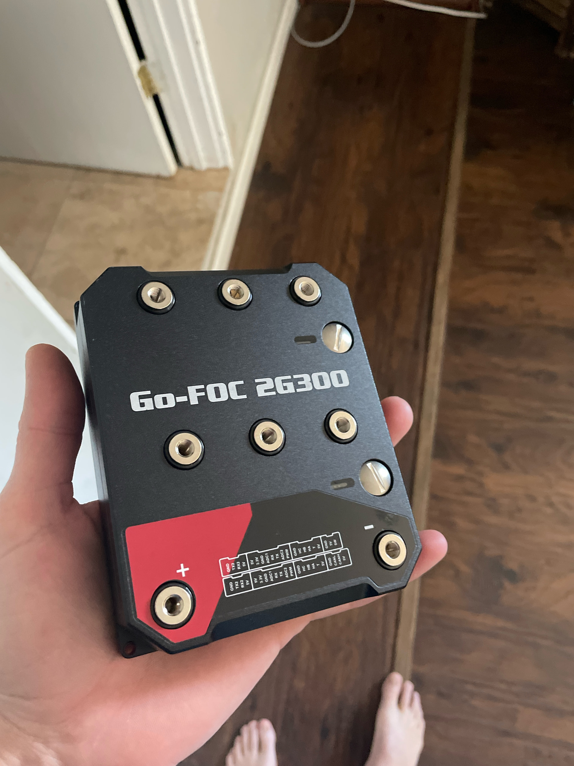

So this controller isn’t for the ESK8? Or to install it on an ESK8 you have to buy two, one for each motor!?
It’s originally designed for one motor, but people start picking 2 for esk8 and run them through CAN bus. But now Makerx has a version call 2G300 which is basically 2 G300 officially put together in a housing and they also wire them with JST ports so they can be used universal like other VESC controllers. The original G300 used a different port so you’d have to splice them to a JST extension and it was a PITA I reckon.
Ive had the displeasure of working with a couple of these controllers on esk8s over the weekend and i’d hold off on buying some for now…
What issues have you been experiencing?
Intermittent hall sensor issues where it wouldn’t see them, and one dud in a batch of four
Dang that’s no good. My new 2G300 everything worked the way it’s supposed to, on the bench so far.
Which motors were having sensor issues?
Same. It’s a shame there seems to be issues with some. I love mine.
X2 mines been set and forget too.
