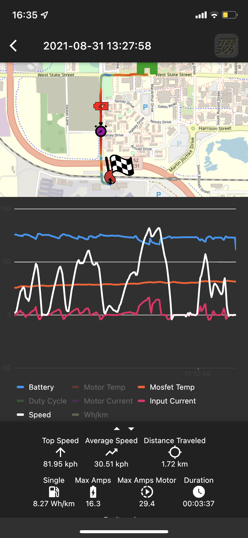

I need one of those graph making thingy in my board so I would know how much more I can push the amps.
