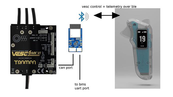

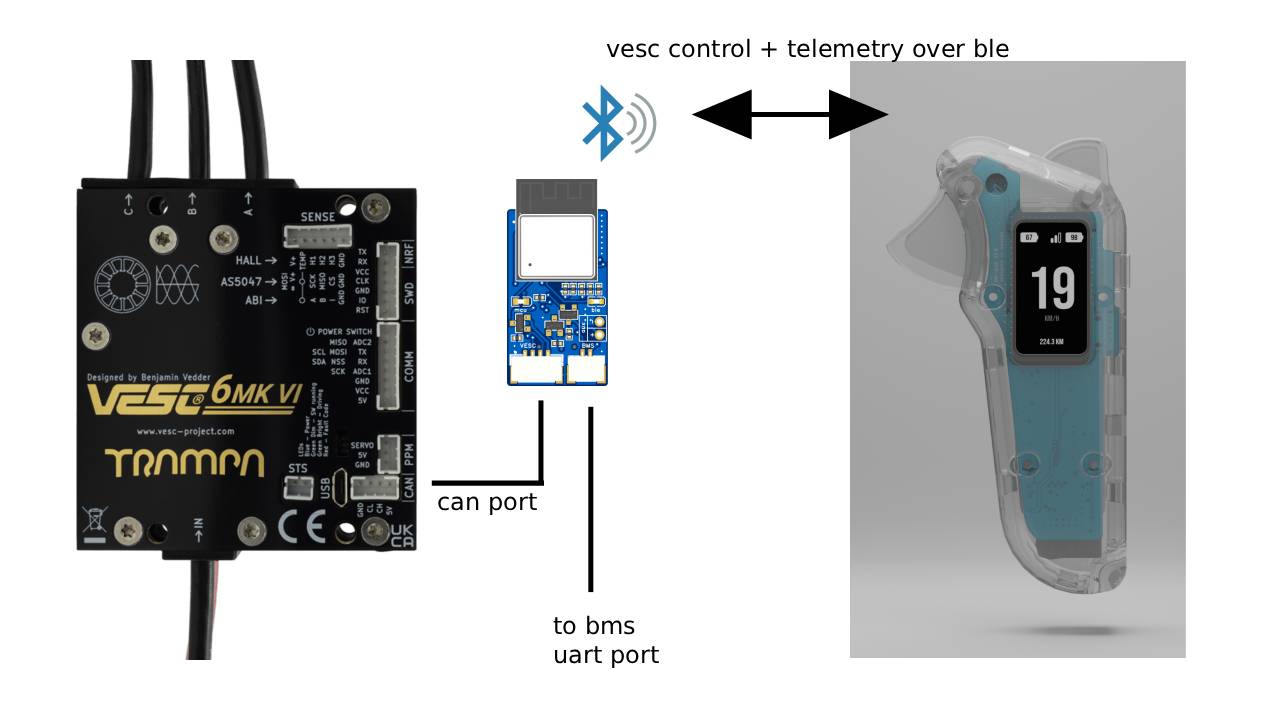

made this image to show how the connection works, maybe it would be easier to understand how it works.

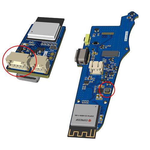

Right now I’m stuck because one of the receiver connectors has been out of stock for a long time, and suppliers can’t even provide an RFQ due to the supply crunch. The same thing is happening with the buck/boost inductor on the remote.
I could switch to different parts, but that would mean a new PCB batch, new stencils, reordering components, new mating cables… and I’ve already invested a lot into the current version. I need a few days to think through :frowning:
Because of this, I won’t be shipping on the original schedule. The first units that were already purchased will likely take a few more weeks to deliver.

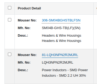

Got a part number? Maybe we can help find? :person_shrugging:
that’s the beauty of this forum, I was so worried about other stuff and was locked in with chinese supplier, just ordered from Mouser since they have it in stock, it was super expensive and it’ll mess with the bom cost but i need to deliver these remotes…

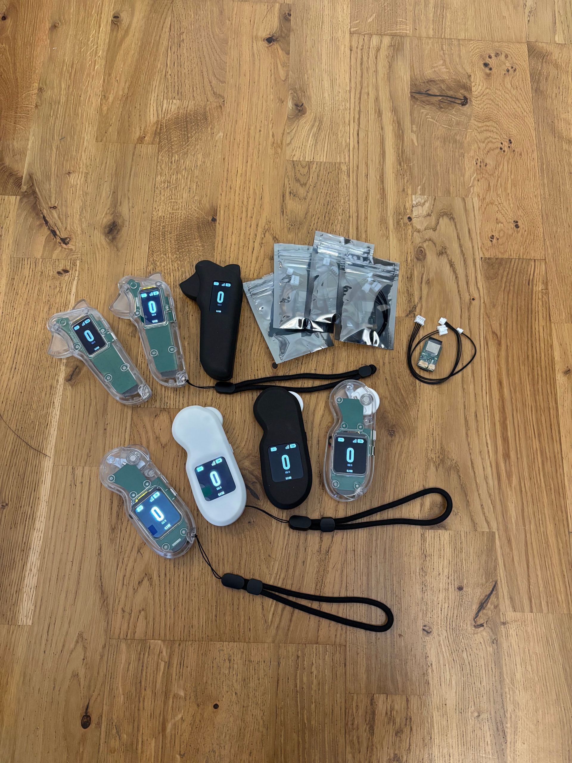

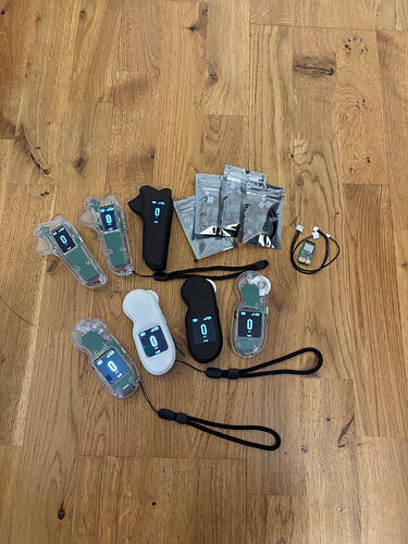

Quick update: sholder is better, hand assembled some pcbs, everything is good and tested, fixed a minor mechanical issue and ordered the first final batch, will start shipping the early orders in 3 weeks from now.
Would like to express my gratitude torwards everyone who supported the project by ordering the remotes. Hope that this can become a good platform for the community and we can have a slightly better remote than the hoyt puck

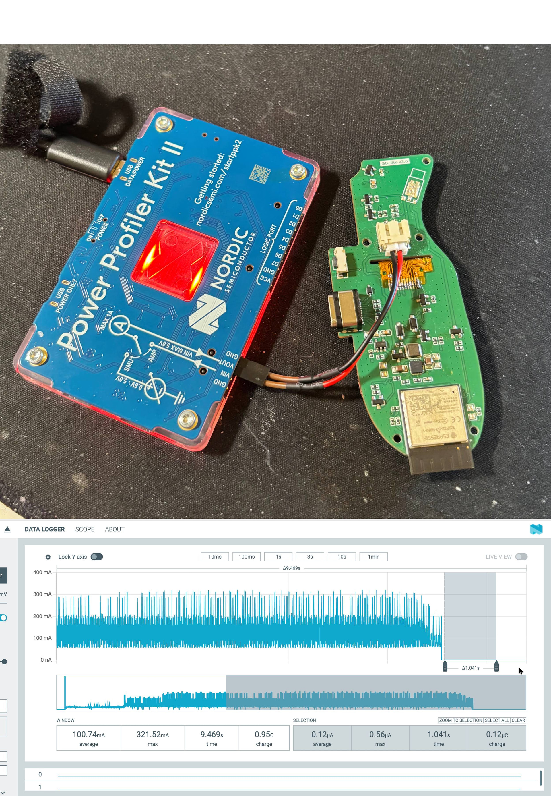

before shipping, checking the power consumption, pretty happy that it draws 0.12uA while on sleep.
Flipsky vx4 draws 30uA for reference
