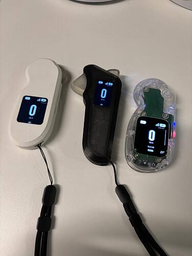

How do you make those optically clear shell parts? SLA printing, I’m assuming. But usually that doesn’t result in optically clear parts without post processing. What’s your process? Those parts look like the could be injection molds, which I’m certain they’re not.
I request transparent sla printing services from jlc3dp:
they are usually 3x more expensive than common sla, but they are worth it

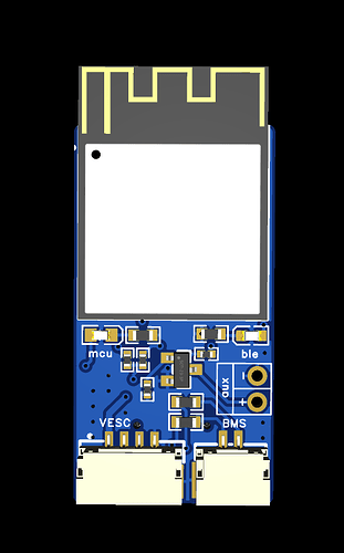

Have been working on the receiver, It will have usb C for flashing, will talk to vesc over CAN and a 5V auxiliary signal output (so you can turn on lights and etc…)

they will be both compatible, the only difference would be the connection interface between the receiver and the VESC, but for remote-receiver the only change would be the trigger for turning the aux output on and off, then the old receiver wouldn’t do anything

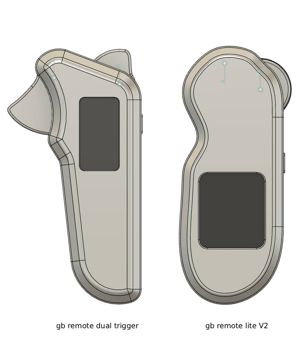

I have also splitted the repo into 4 main components
1 - for the remote and its variations (lite and dual throttle) - remote
2 - for the receiver (we’ll have different branches to match the variants) - receiver
3 - the remote config tool - config
4 - the remote flashing tool - flashing

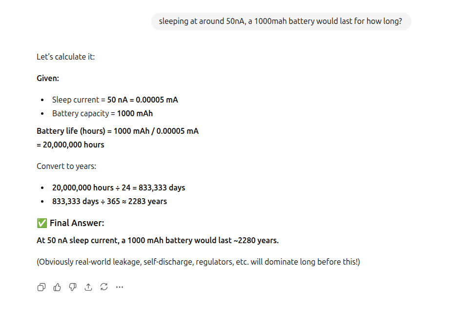

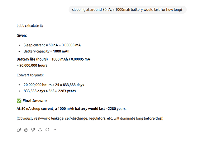

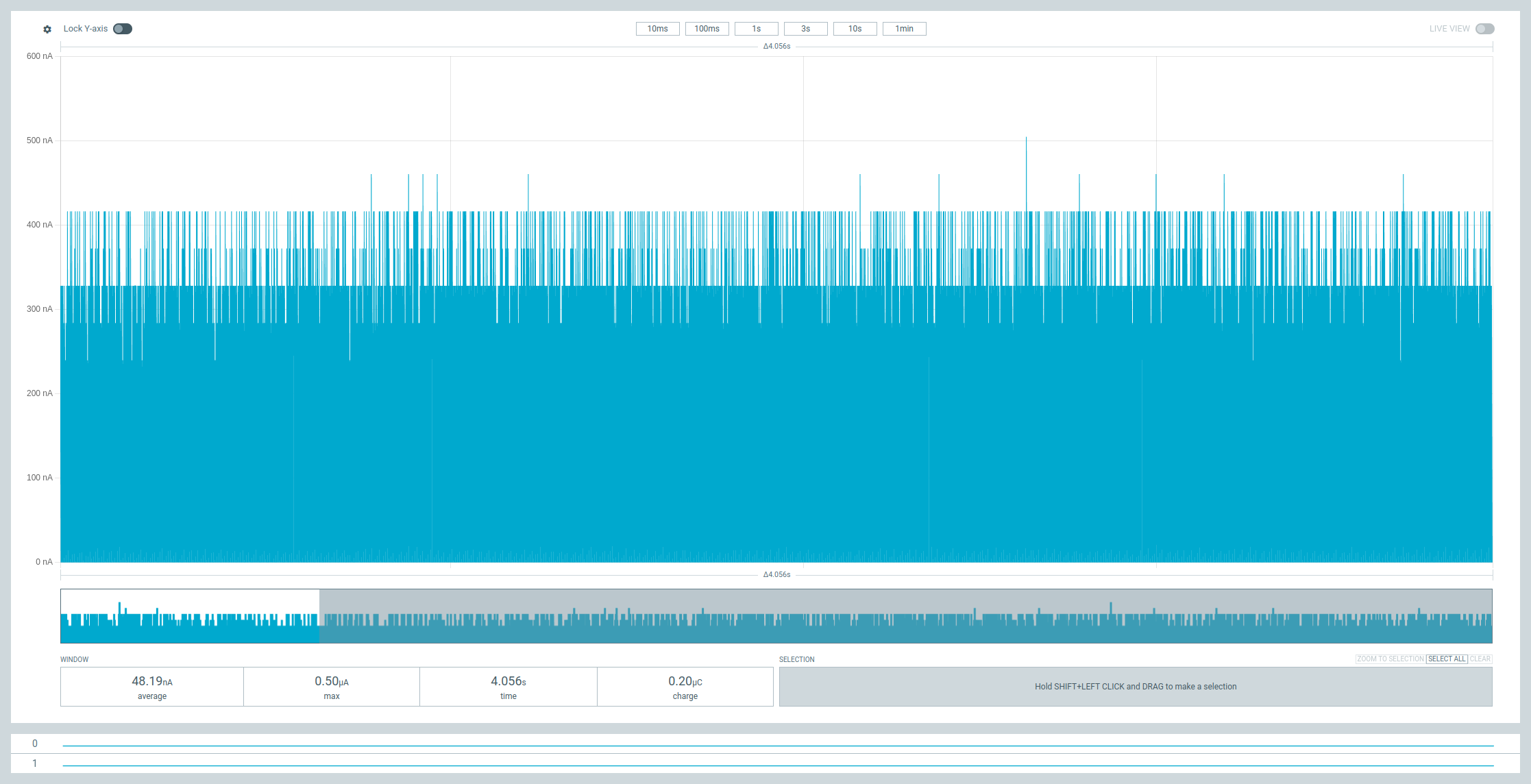

Finnaly got where I wanted, still testing a few things but power consumption around 50nA when sleeping, that means it would take almost forever to drain a fully charged battery.
i’ve been working so hard on the project, both remotes are almost ready for production, have some minor mechanical changes to do (also investigating how to waterproof them for the next release)
