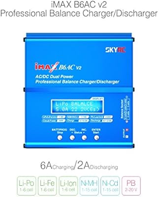

Accidentally ordered 3 batteries instead of four 🤦🤦welp. Now for a charger.
I think I’m just gonna get this battery
charger.
Is this a mistake or will it work for me?
That should work fine, it is a popular charger. Having the ability to put it easily in storage charge is also very helpful. I have a crappy hobby charger with no screen and it almost always overcharges to 4.25V or something along those lines
