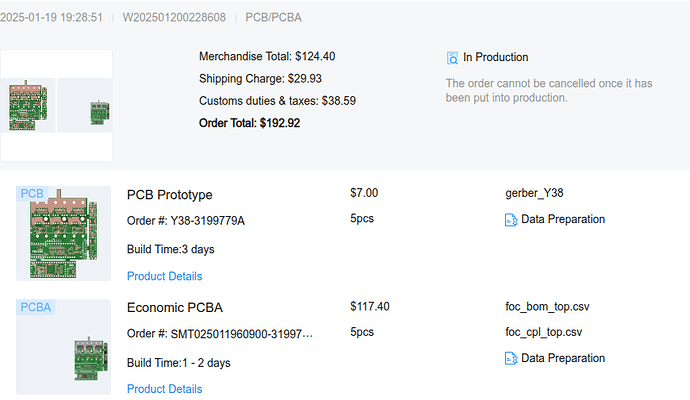

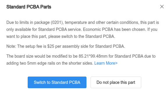

So I was just about to other a batch of new boards, when this message regarding BMI323 popped up…
Grrrrrrrr…
I used 3 whole days on this part… I don’t see why this part is any different than BMI160. Same footprint, same anything…

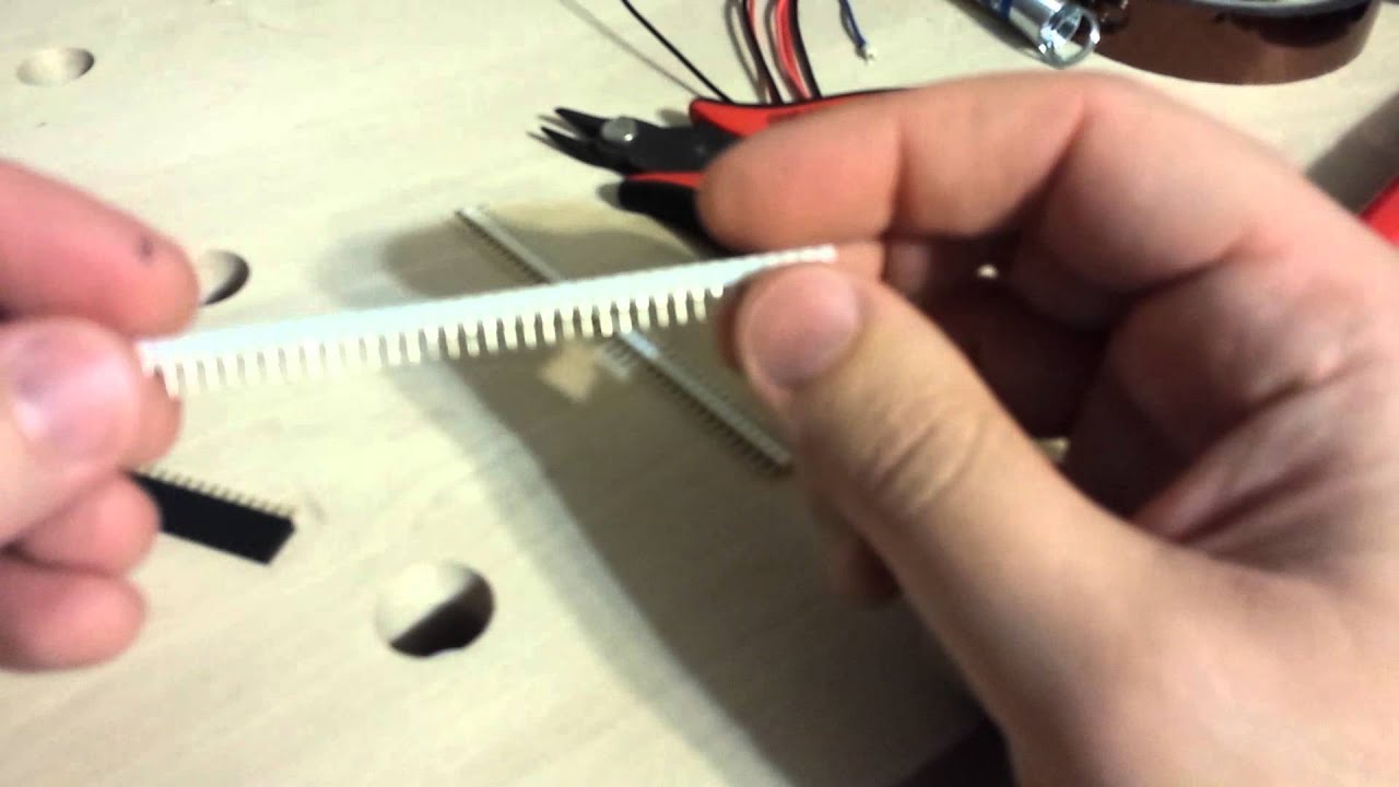

I would highly recommend that you use the Swiss Machine Headers which you can get on this ALI-link. If you use normal pin-headers, there are some external connections to the board that will be difficult, and JST difficulties, etc…
However by using Machine Headers, you don’t need JST connectors, because the machine headers are themselves connectors (see the last image of the board that I have posted). You only need JST for CAN and HALL.
You don’t need to add 12 Mosfets - 6 will be fine (there are pictures of this).
Forget about the mica insulation, etc. It’s only “additional” (which is also mentioned in the assembly instructions).
No, to the 5V of the LED source. I know it’s strange as the output signal is 3.3V.
This video on YouTube explains how Machine Headers can be used as connectors. They are awesome:

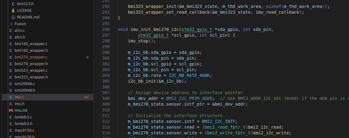

So I decided to code yet another IMU interface for VESC. Luckily, the BMI270 API is much like the BMI323 API, so I don’t feel quite as much as an idiot wasting my time on stupid stuff.
However, I will not use the SPI interface, but stick to I2C, which I know will work.

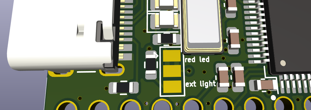

As a last minute change, I added an option for using PB6 for external light. You can choose to use PB6 for “red LED” (fault led) or External Light. Default is RED LED.
Bonus Info: Ext Light has a 2k pull-up resistor to +5V, as specified by sat-be

I think the pullup to 5V is a hack instead of a 5V level shifter, as the LEDs work with 5V logic level.

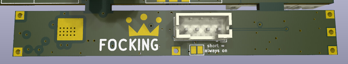

Crossing my fingers that the Momentary Switch will work without flaws. It did so in simulations. Also it should be able to turn itself off on a timeout.

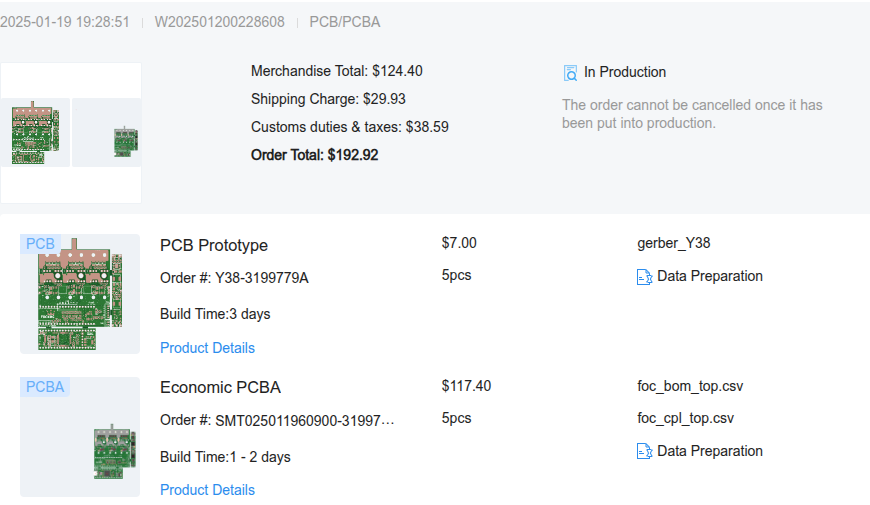

how did you get it through with the 3 designs?
Thanks Jens!!!
It went through the first time…
Don’t start arguing with them, just send it in again, and it seems the the person on the next shift doesn’t care.

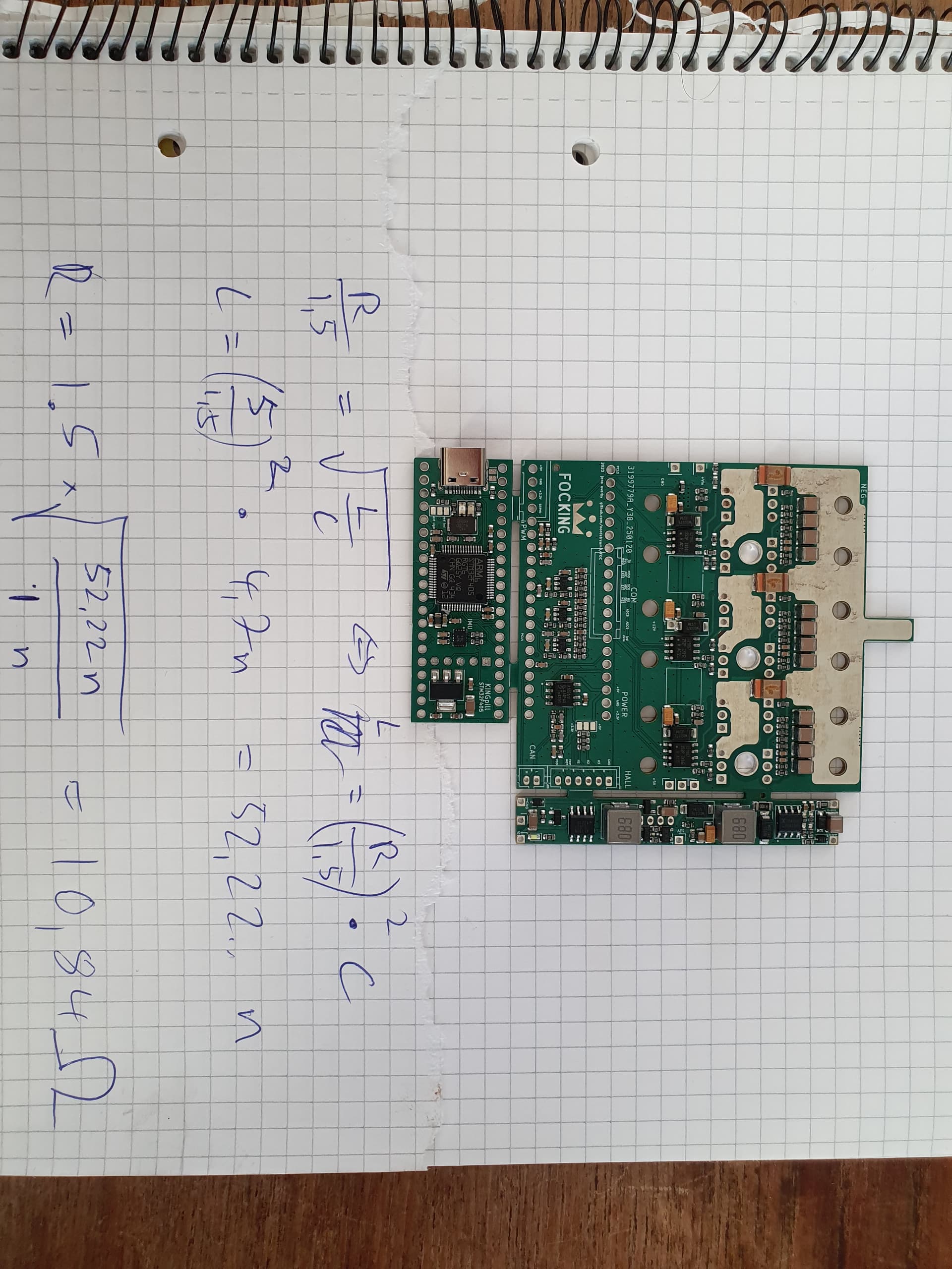

I have assembled one of these boards by hand, and I’ve noticed that the 4.7nF snubber capacitors are only 50v rated. Is it a mistake, or am I missing something?
Good observation, and thanks. I don’t think you’re missing anything… I have to say that the board has been tested for 84V, and I’m also running it at 84V myself.
For reference: The MP2 board uses same type of mosfet as FOC_KING, but does it without any snubbers needed. So either I fix the issue, which is a little tricky, or I completely remove the snubbers.
To fix the problem with snubbers:
JLCPCB only has 1 type of capacitor in their “basic” components list that might fit. But the value is only 1nF.
JLCPCB Part # C9196
Package 1206
Description: 2kV 1nF X7R ±10% 1206 Multilayer Ceramic Capacitors
Formulae used for calculation
It seems that there is no optimum capacitor value, it’s more like the capacitor should be in a range. Assuming that 1nF is in this range, I calculate the resistor to be around 10.84 ohms (±) in order to keep the damping effect as close to what it is now.
New boards with new IMU270 just arrived today… See if I can test a snubber update with some manual soldering.
Currently the resistor is 5 ohms.
