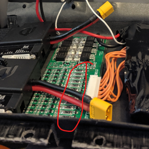

this is for sure not ok, but you should be able to fix it:
just organize the balance leads - preferably so they’re laying next to each other and not all over the place that in the pic.
also, this bit gets HOT. i think it’s ok as it is here, but make sure nothing melty touches the resistors:

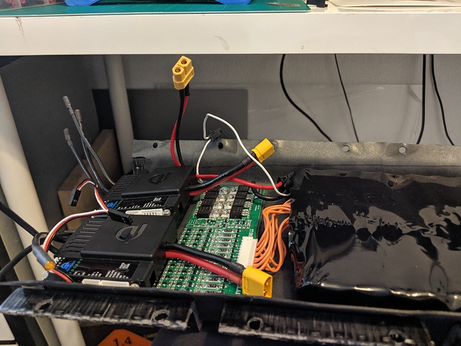

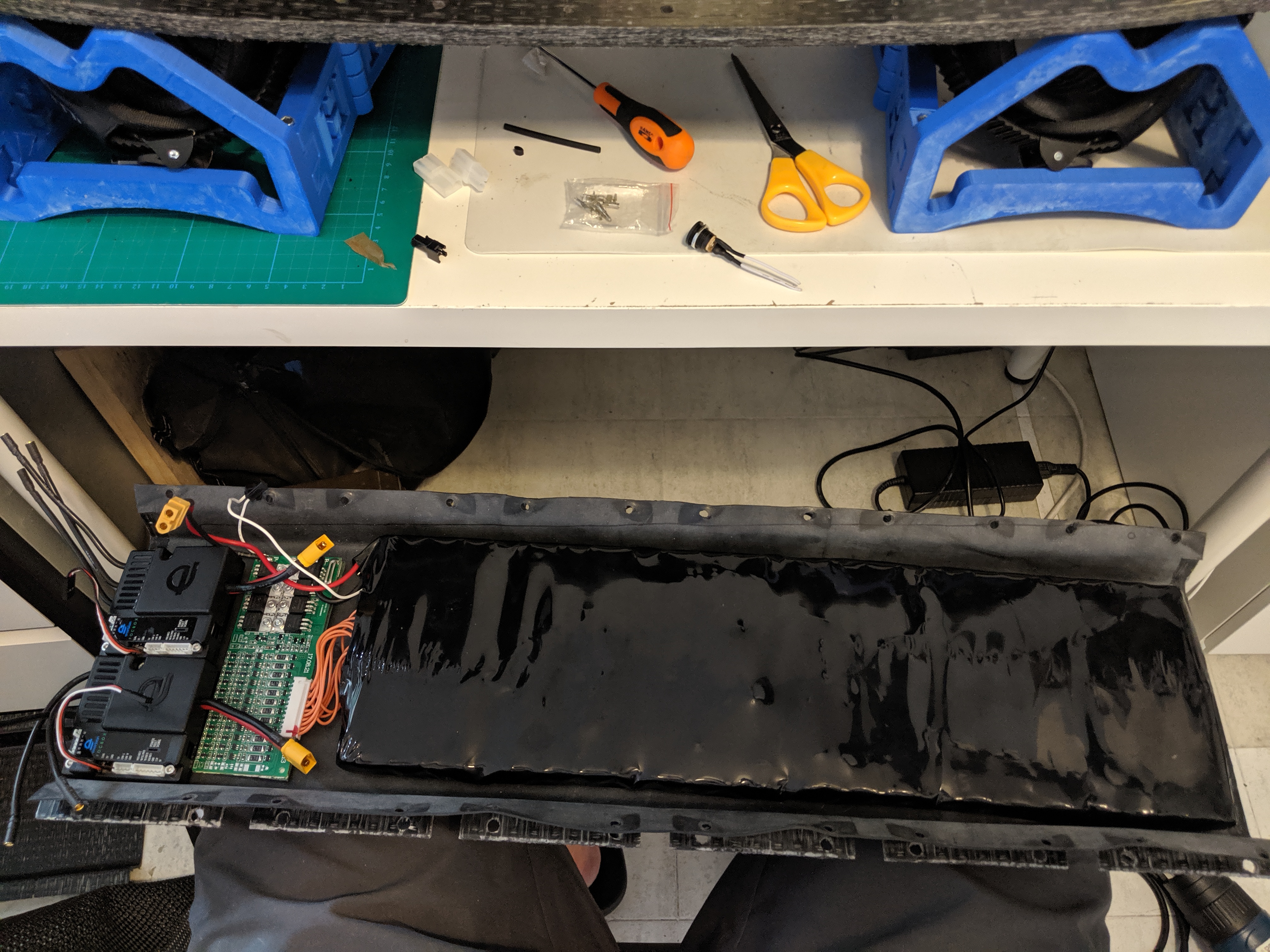

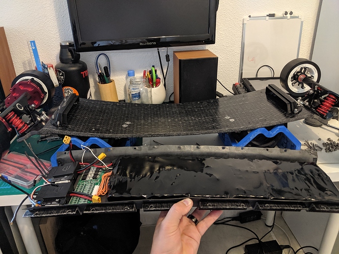

here’s some more photos if it helps
and it flex in this direction
cool, well may just be re-doing the balance leads with silicon wire now and have 2x DieBieMS’s so might as well…damn it. This was supose to be a quick build before the kid is born.

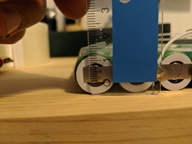

Took layers of tape off.
Beefs:
-Cells are Sony VTC5.

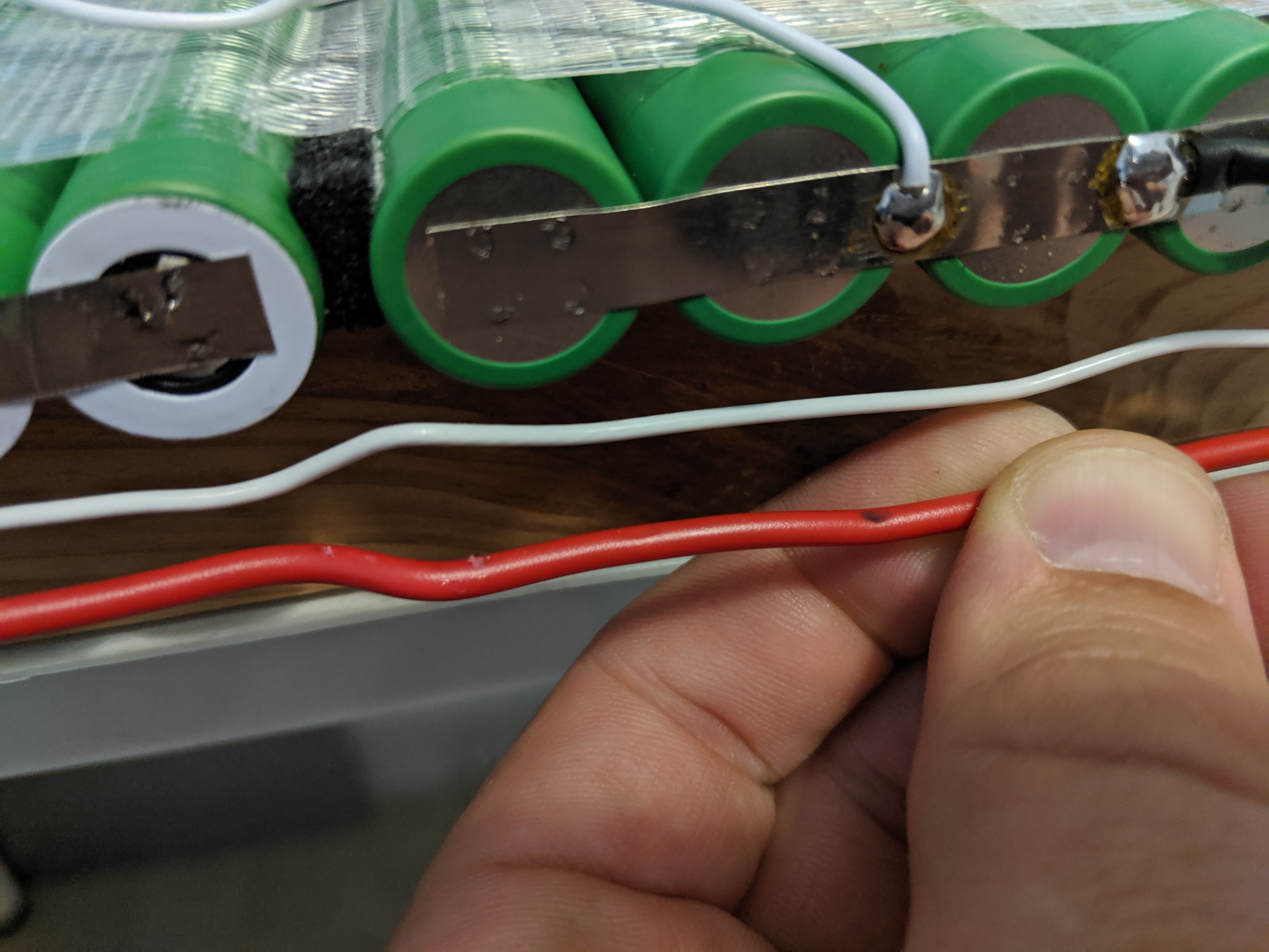

-All the wire including main leads are not silicon.
  • All the main leads, without any use of the battery- light test flexing while mocking up, are showing signs of wear - flat spots where there is rubbing - evident by black marks.
    -Single strip of 7mm nickel with non-flexible, non silicon wire making the series bridges (remember kid this is the “Flex pack” )
