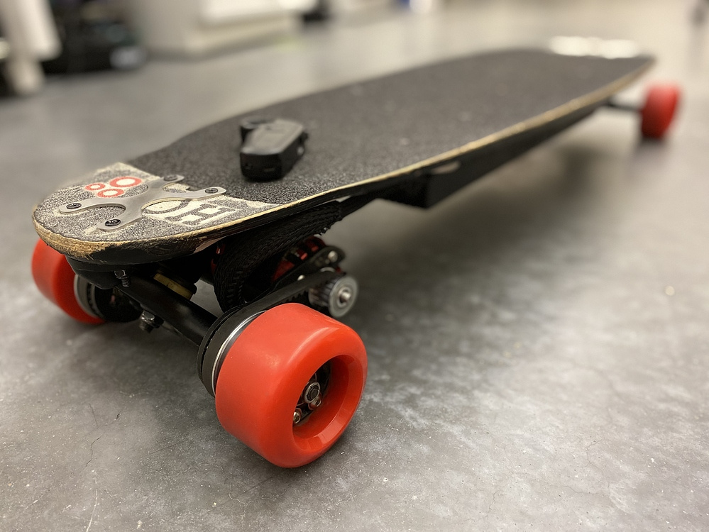

This is not your typical buy new parts and make a shiny spaceship build thread. This is the trash that begs to be trashed again build thread. I call this board “Schrödinger’s Phoenix”. The goal is to learn how to build something that actually moves me and not to worry about it breaking. I hope this may inspire others that it is possible to build a deck on a budget and to just try small, fail small.
That being said, here’s what’s going into it (see image, there is really not much to say about it).
I am thankful for any critique!
Especially if I might be doing something that might be a safety hazard.

This is what I ended up building:
Final cost breakdown (neglecting shipping costs and tools- real cost is 50-100% more)
  • beaten up used Chinese kit - trucks, mounts, motors, pulleys, ESC, remote and some crappy new wheels ($50 local pickup)

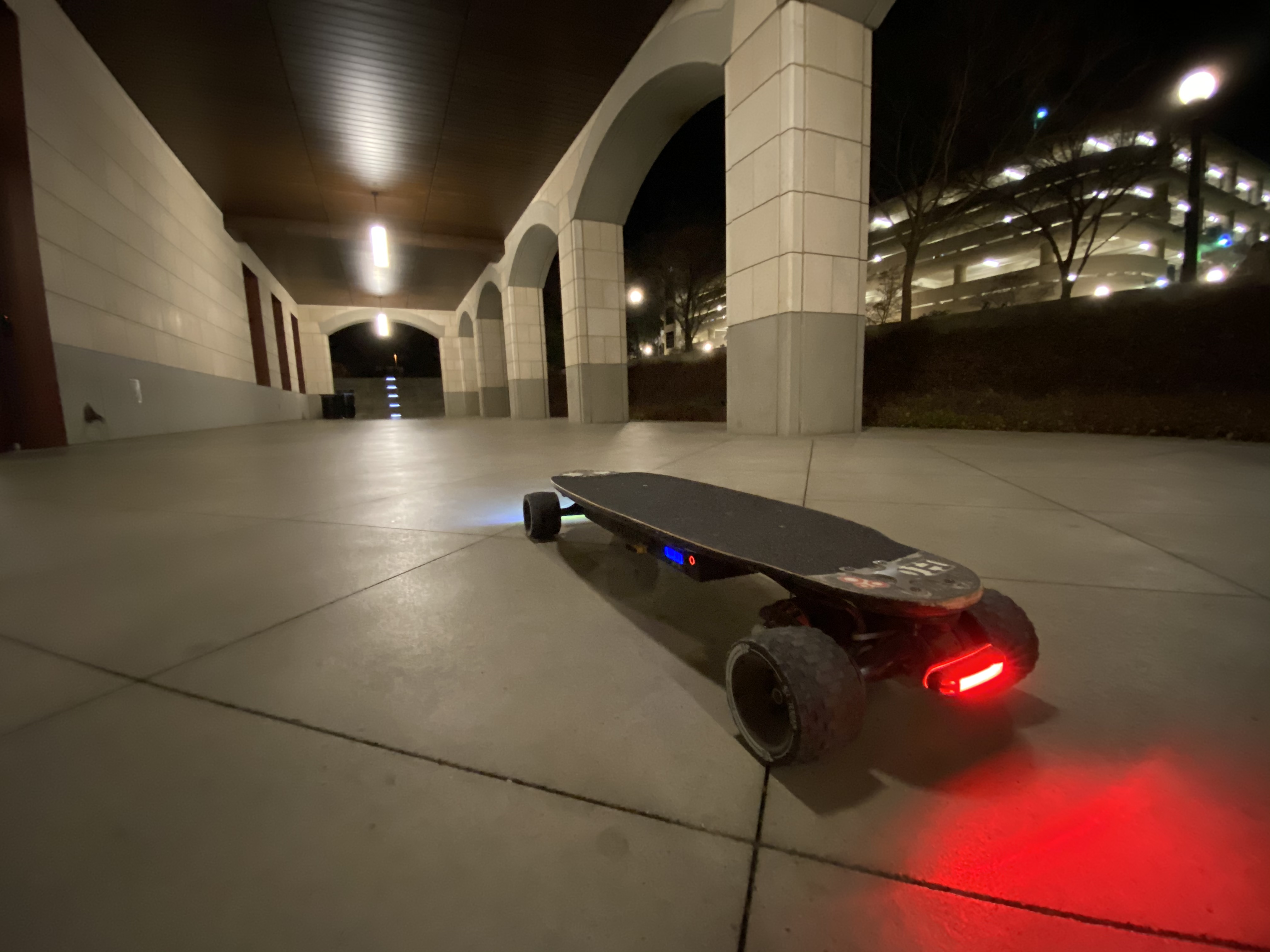

Update 2: Bigger wheels
New top speed: 35 mph

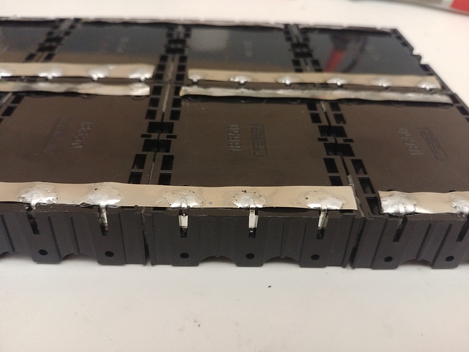

Be carful with 18650 holders they are only rated at a few amps not the 45amp you pack will put out. Reinforced the the terminals with copper wire, rod or thick 10mm desoldering wick. If you dont plastic will melt.
Thanks for the warning about the cell holders. These are made with some really solid leads though. The ESC will limit the current anyways to either 18A ~ 30A. It’s also a temporary solution until I can borrow a spot welder.

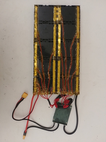

Decided to ditch the enclosure and just build my own so I could arrange the cell holders nicer.

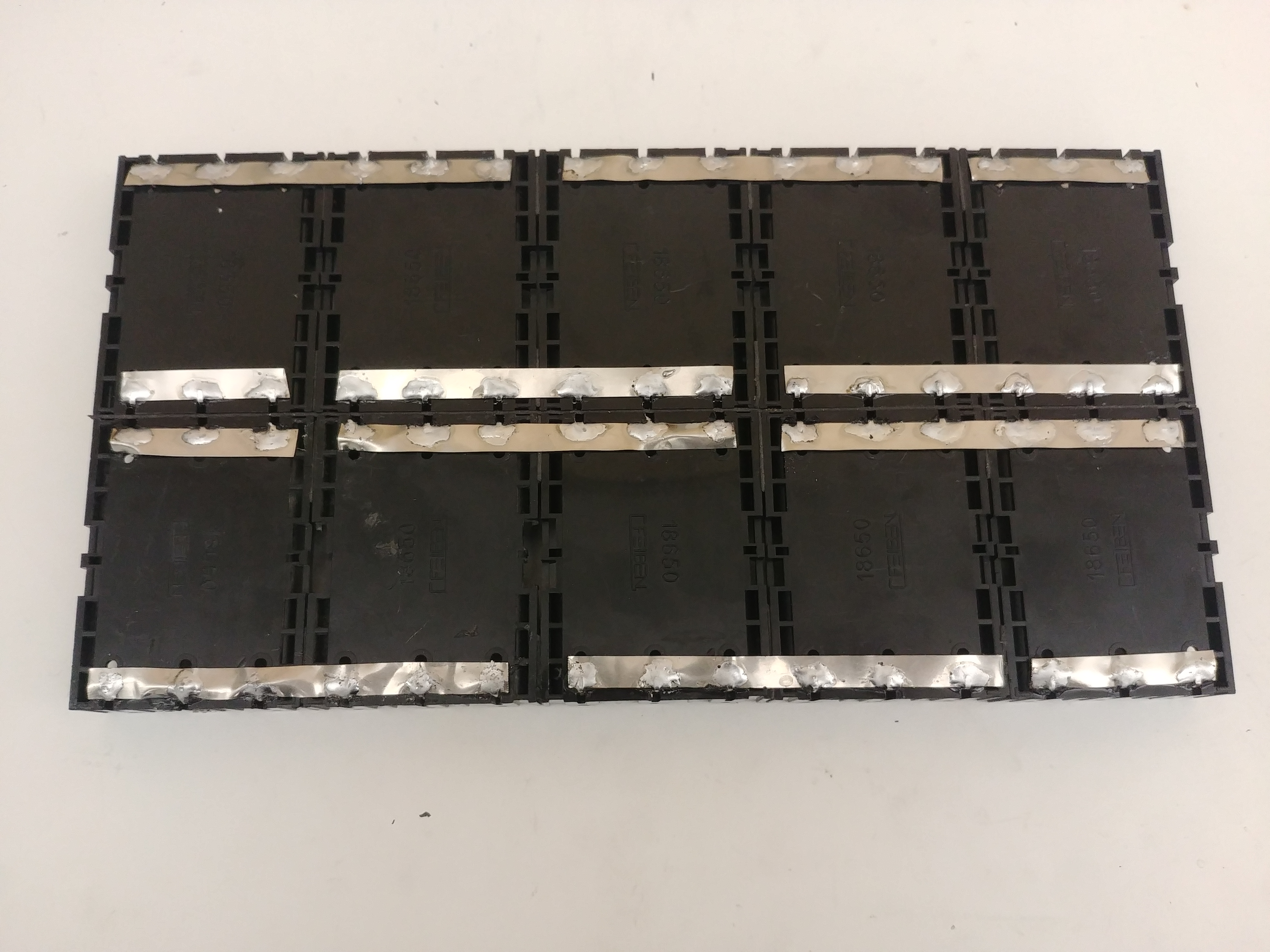

Soldered most connections for a 10s3p pack.
The tabs on the buttom does not offer enough to support your amp draw! They are way to small.
Here is a better way of doing it
I agree, NESE is the way to go. But I got these holders already (for making 12v packs for lights, no longer needed). So I might as well use them. Also, I will be using cells that cost me just short of $2/piece (thanks @BigZwatt) - NESE premade costs even more than the cells. Even if I could 3D print it for free, the hardware would still be more than $1/cell pre-shipping.
But in the future, for nice packs with nice batteries, I am looking forward to use NESE :slight_smile:
It definitely is the weak point. The tabs are really thick though - about double or triple that of nickel strip. Think of it as cell level fusing :joy:.
Joke aside, I would not do it like this again.
However, I feel confident enough that it will support 5-10A.
One issue I am facing: I did not get those nice round discs for the outer side of bolts connecting wheel to pulley. The screws are too long like this. Either I just cut them shorter and call it a day or I buy some or CNC some. Do people have issues without the round outer discs?
I think they will be fine. Because the per cell current draw is not much if you restricted the current draw. To 30A or so.
No problem homie :call_me_hand:
The first time i used 18650 i used same holders during a long ride i lost power and one of the battery clips had melted the plastic and poped out. I had done over 100km already so may have been a faulty cell. I had copper braid running throught the battery clips and soldered. The soldering also weaked the plastic. After that faulure I boulht a chinese spot welder big mistake, but I wont go into it now.
Thanks for sharing! How many amps were you pulling per battery holder?

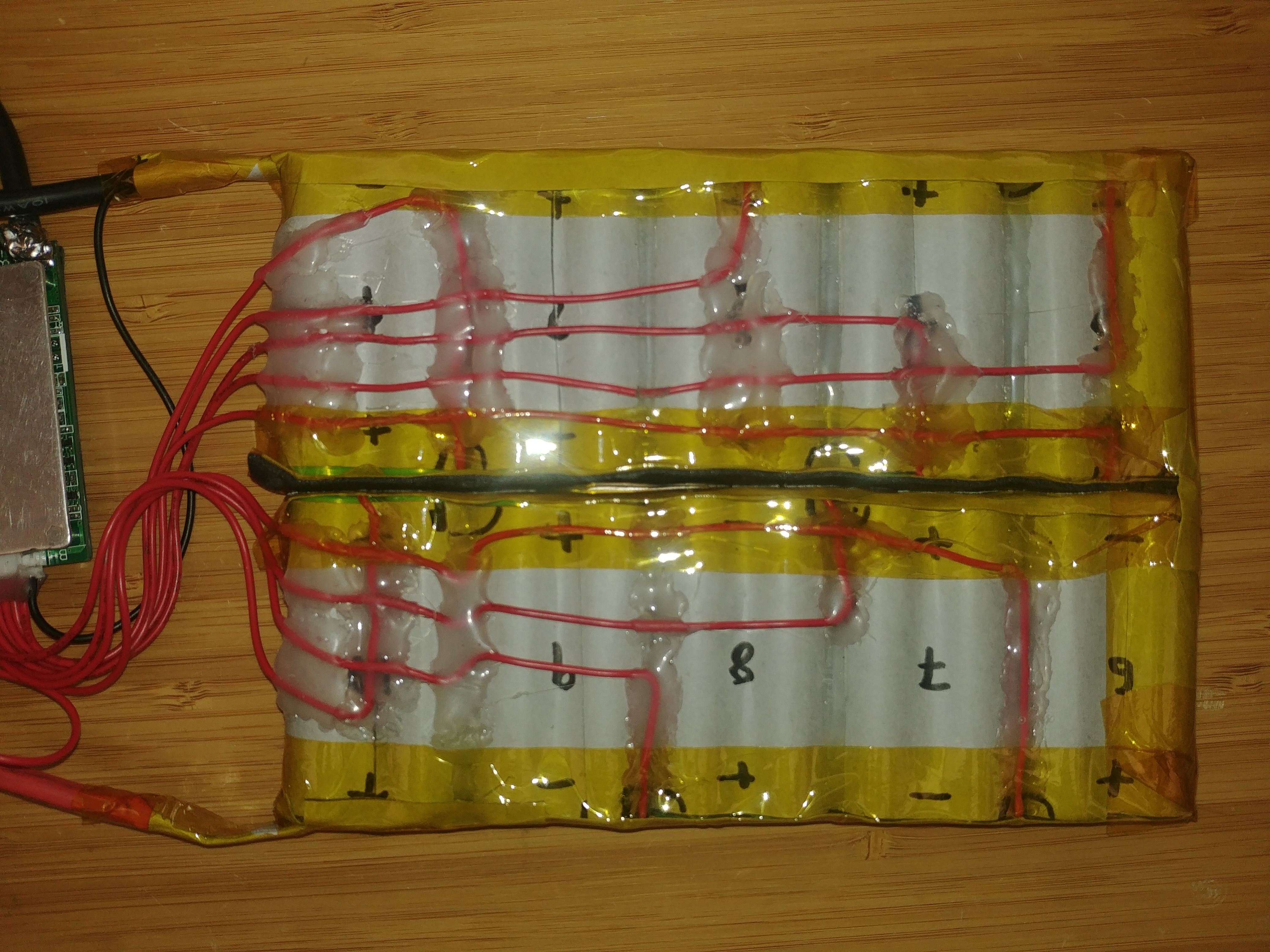

Some small progress: Battery wiring complete

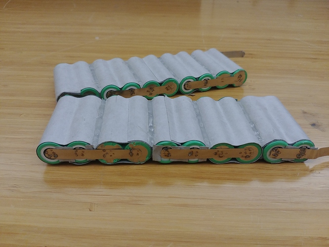

Got to borrow a cheap spotwelder and decided to scratch the cellholder approach. Boy, the spotwelder is hard to use, had a lot to learn, and still do. I see this as an exercise, rather than a masterpiece.
I appreciate feedback on how I can improve my battery build for the next time!
So, here are the spotwelded cells (10s2p) (I added some fishpaper later under the positive terminals where I forgot to add it):

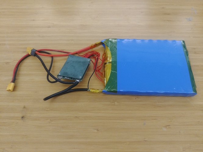

And here, putting it together with fishpaper, hotglue, Kaptan and double sided adhesive tape:
And a final touch of heatshrink (could have been more generous, though):
You probably won’t die but those welds are a bit harsh, rings help a lot and you’ve removed some shrink in your frenzy haha.
4/10, it’ll work.
