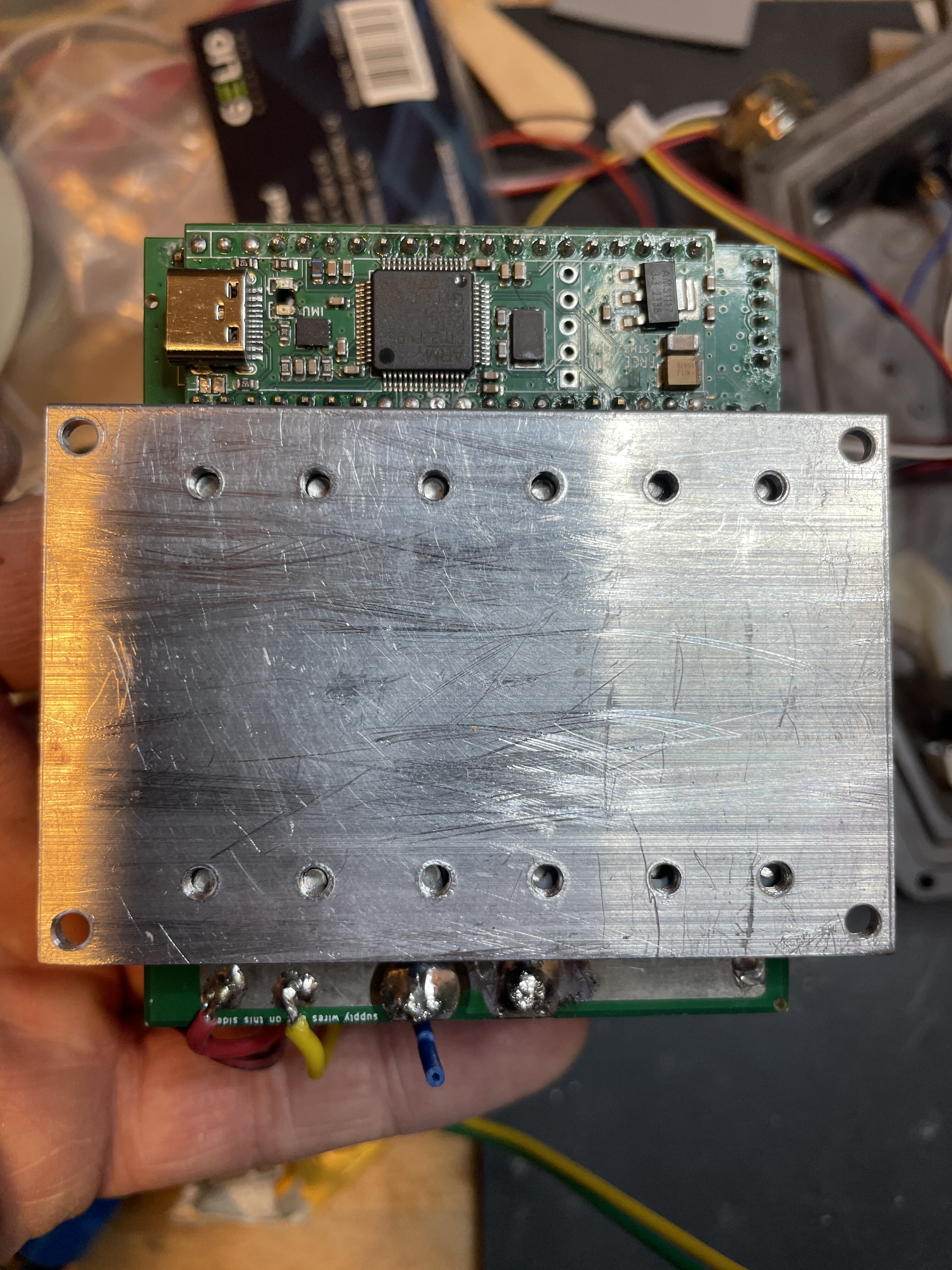

Works quite well in my Onewheel but to really torture it hard I would have to install it in my efoil, what I do not intend to do at the moment.
In the onewheel normal motor current is only 40A max 60 and some short spikes to 120A.
It stays quite cool, I added a 3mm aluminium plate as a heat sink to the FETs. The alu plate is screwed to the front box from cast aluminium, 0.5mm heat transfer pad between.

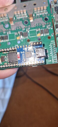

@jens_overby So i was experimenting with some pin headers. I think if we could reorder some PILL output there should be no need for an expensionboard cause you could just connect the esp32-c3 directly on the PILL.
You’re right. There is something with +5V and +3.3V that needs to switch position. That’s where I left it also… But what about CAN - you still need wires to external CAN-extension, or ?
Thanks Daniel for showing some pictures. Did you use “mica” sheets for electrical insulation, or?

yes at the moment you would need an external can wire
