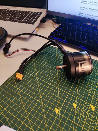

Mine has the exact same print on it but I can’t see kv rating written anywhere, any advice how to find out kv?
attach it to an ESC, run motor detection, then on the right-hand sidebar of vesc tool enable real time data and keyboard control. Open the real time data tab, press an arrow key on your keyboard to spin the motor up, and take a screenshot of the ERPM, voltage input, and duty cycle. Then you can calculate KV as RPM / V where RPM = ERPM / 7 and V = voltage input * duty cycle the motor was spinning at :slight_smile:

Are you confident on your end that is 150kv? I don’t seem to be able to find any information about these types of motors being anything other than 170/190/220
150kv definitely existed in this size. When I bought this one from a forum member it was allegedly 170kv, but when I did the math from vesc data it appears to be closer to 150kv actually :confused:

Result is 162 for mine,
Do you remember your figure?
151 I believe. Close enough to be considered equal imo
Was that foc or bldc mode?
FOC, but I would be surprised if that made a difference
