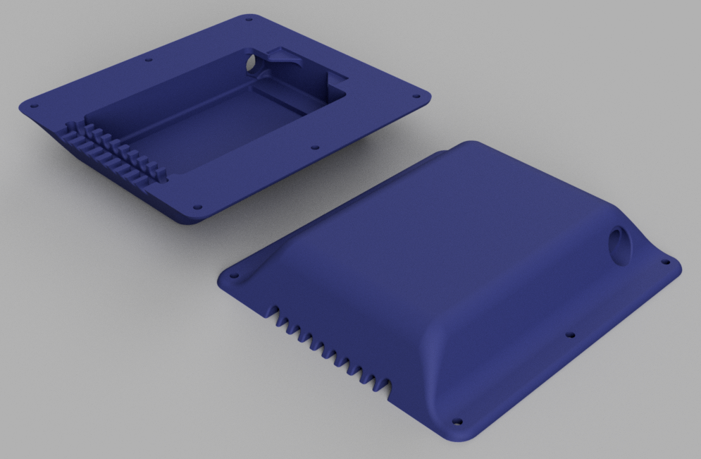

First job was to design an enclose for the ES Dual ESC. I included spaces for the switch, remote antenna and cable entry. Fusion model is avalable here for printing or modifying.
This was then 3d printed on my Ender 3.

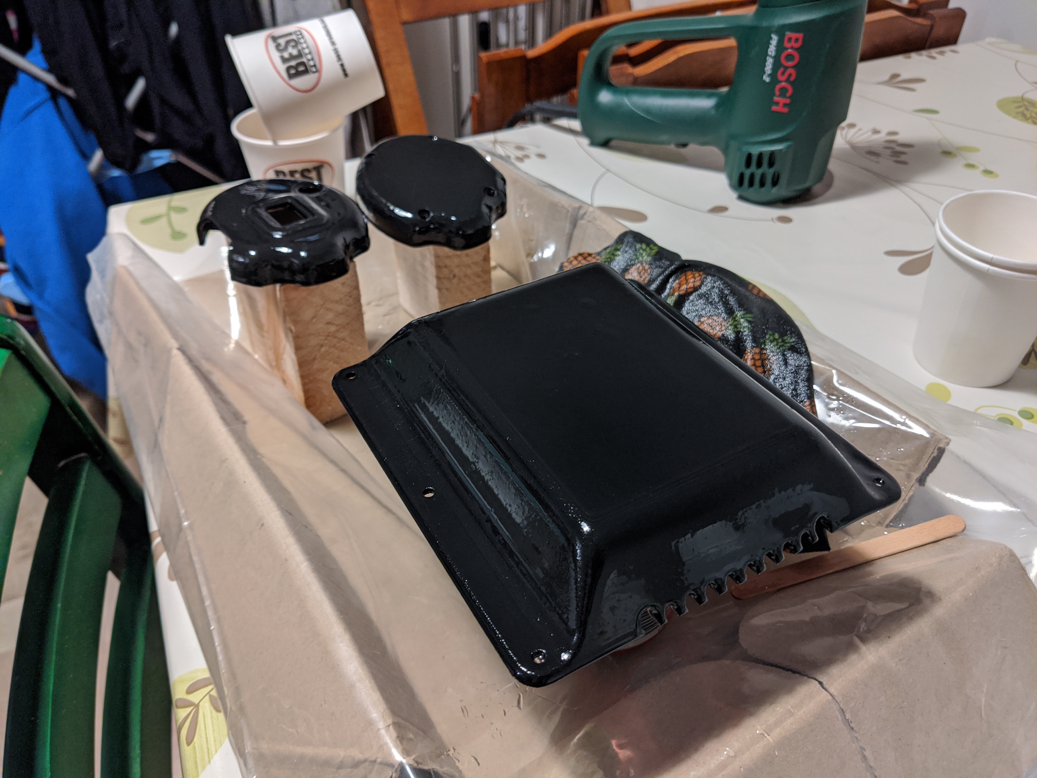

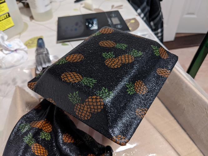

At this point i could call it done but i wanted to use this build to test out “skinning” 3d printed parts. This involves coating the part in epoxy resin to seal it, then covering it in fabric and finally sealing this in more layers of epoxy. This should add more strength to the printed part as well as increasing water and impact resistance.
So after removing electronics and painitng on the first layer of epoxy
A heat gun is used to pop any small bubbles on the surface. This is then left for 3 hours to partially harden to a tacky surface. material is then laid over the surface. More epoxy resin is painted on so that it soaks into the material. The brush is used to push the material into the contours of the part. honestly it took a few attempts to get this right. Edges are then tucked under.
This is then left for 24 hours to achieve a full cure. You could add a few more layers of epoxy resin to get to a smooth finish but i liked the matt effect so decided to stop here.
Once dry i went at it with a dremel to clear out the cable holes, cut off excess material and clear the hole for the power button
