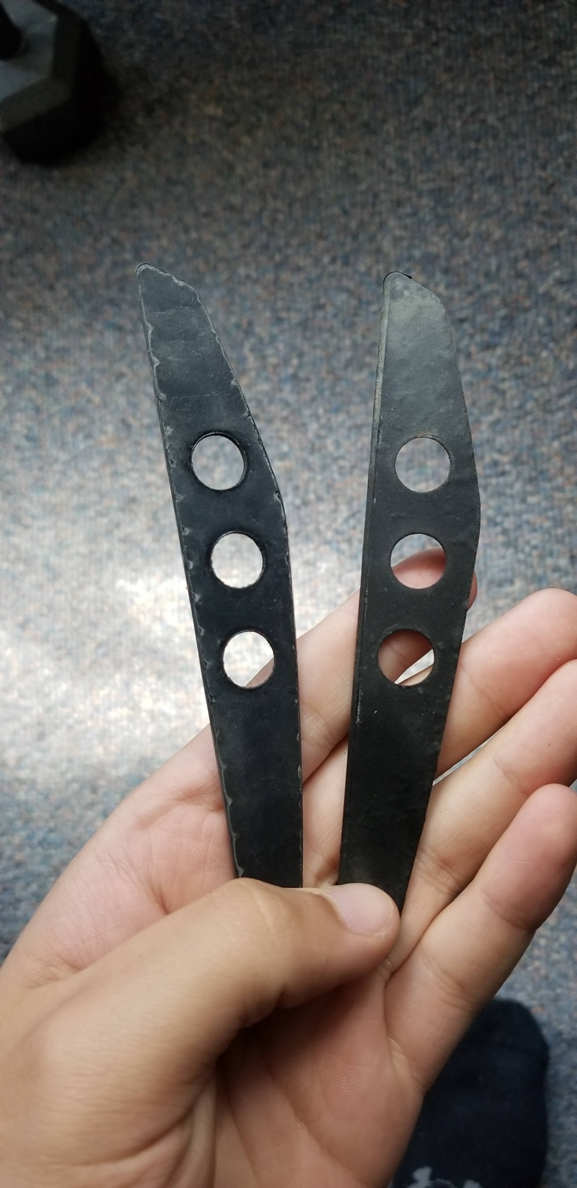

I’m planning on using the leftover boosted enclosure piece thingies. These:
They’re almost the perfect length but the width is off, so a little sanding and they should fit right on the edge
I have both plastic and metal, but I can’t use both as it would be too thick.
Anyone have input on which to use?
I would send the other set to you @anubis but you’re across the pond :thinking:
I think plastic would be better unless you round off the edges on the metal, you probably wouldn’t want to have a dull blade/edge of metal bar pressed up against it. I am hoping to use my uni’s CNC to cut some up though
Good point, the plastic is also slightly thinner.

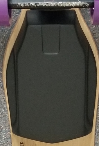

The reason I posted this was because my eskatingeu enclosure cracked in 2 places and I had to JBWeld it together, and I noticed the water seal is very poor with such a bad distribution of pressure, even with many screws. eboostin enclosures are super quality, with those braces I bet you get excellent life out of them :slight_smile:
