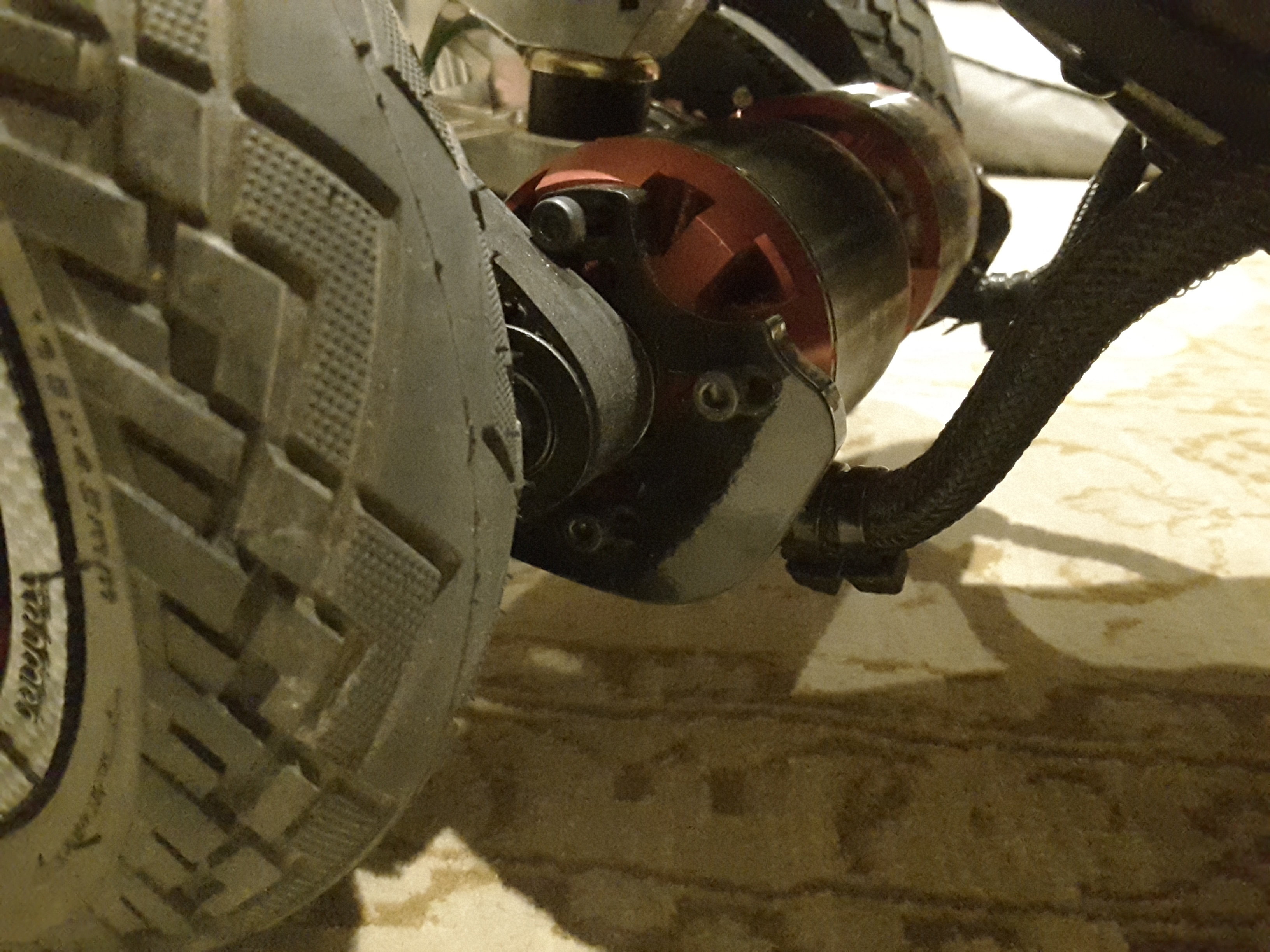

May need to rework the motor mounts. Between the 62t/14t pulleys and ~70mm from pulley centre to centre it only gives me a few teeth of contact on the motor pulley meaning i get a belt slip when applying brakes.
The wheel pulley fouls on 1 of the 4 motor screws and the belt runs along the head of another screw ( maybe a pan head bolt will that one)
I have looked at the boardnamic mount with a idler and 90mm centres for the pulleys but after reading more i think the idler may hit the wheel pulley.
Any suggestions to fix this??
Go up to 16t on the motor pulley, 14 is too small imo
I went 14t because of the hills around my area and i dont need the top speed since im new to riding, also the motors are already adjusted right back on the 14t so 16t could require longer belts
Yeah you should still have plenty of torque with 16/62 I mean heck I run 20/60 on 6inch with plenty of torque. And belts are pretty cheap. That would be my opinion on how to fix the slippage
I’d take the advice of @Kellag and if the board doesn’t have enough torque I’d look in to possibly trading your motors or selling them to get a lower kv to maintain the torque you seek. 14t on the motor is tiny and will likely be frustrating to use in your configuration.
Looks like 6365 to me
They are called 6365 and marked as that but where i got them from they are called 6369. They are longer then 65mm
May have found a solution to 2 of the issues from above.
If i change the top bolt to a longer one and bolt on 3 bearings ID:4mm OD:13mm w:5mm the belt wont rub on the bolt head and it will act as a ideler hopfully stopping the belt slip and the belt has enough length to do so i think.
