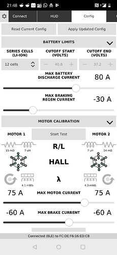

I’m setting my board up, 12s4p 2x TB 6374 with unity. Setup is a breeze but when I press the throttle 1 motor doesnt spin well and I can’t figure out why. Please help me troubleshoot These are my unity settings

Have you tried without the sensors?
Not yet. I’ll try that now
That did it! Thank you! Motors run fine now. Pity though, was hoping i could run them sensorless for smoother take off.
You can try one with sensors (hybrid) and the one that’s not working can just be set to sensorless if you can’t get the sensors to work.
