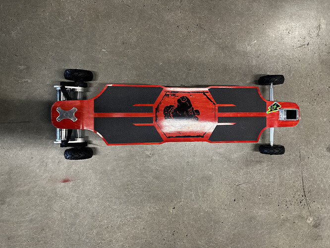

This is one of my clients’ boards from NYC. They dropped off the Defiant for work at my workshop, @HyperEsk8Repairs. I’ve worked on this board quite a bit, mainly focusing on the now dead and gone :skull: Street Gear Drive. You’ll see where I’m going with this.

So pretty much, the gear drives didn’t hold up on NYC streets and didn’t survive here. I fixed his gear drives three times before he finally gave up and was about to sell the board for pennies. But I said, ‘Let me change it to :sparkles::sparkles: BELTS :sparkles::sparkles:’—yes, belts! :joy::joy: The first time, the wave washer under the motor C-clip somehow blew. The second time, the motor shaft was being pulled out of the base of the can. The third and final time, the clamp that holds the drives into the trucks kept coming loose, causing the drivetrain to rattle and shake. So, you can imagine why my client was fed up; he was really tired of the issues, mainly with the drives!
So how did I convert it to belts? Well, it was actually pretty simple. I reached out to @IDEA to get some brackets made since he offers BN motor mounts for the specific BN truck profile. YOINK! Let me get a set! As a matter of fact, another friend had issues with the Defiant drives on his DIY as well, so YOINK AGAIN! Another set of mounts for another board. Before IDEA shipped it out, that other board will be a story for another day. Stay tuned!
Finding pulleys for 10mm motor shafts can be a pain, but luckily I was able to get them from Flipsky—16T pulleys. I also managed to get 45T pulleys from Onsra. Great!
Belts Came Out to 5M-15-290 Belts luckily had a set of those in stock already!

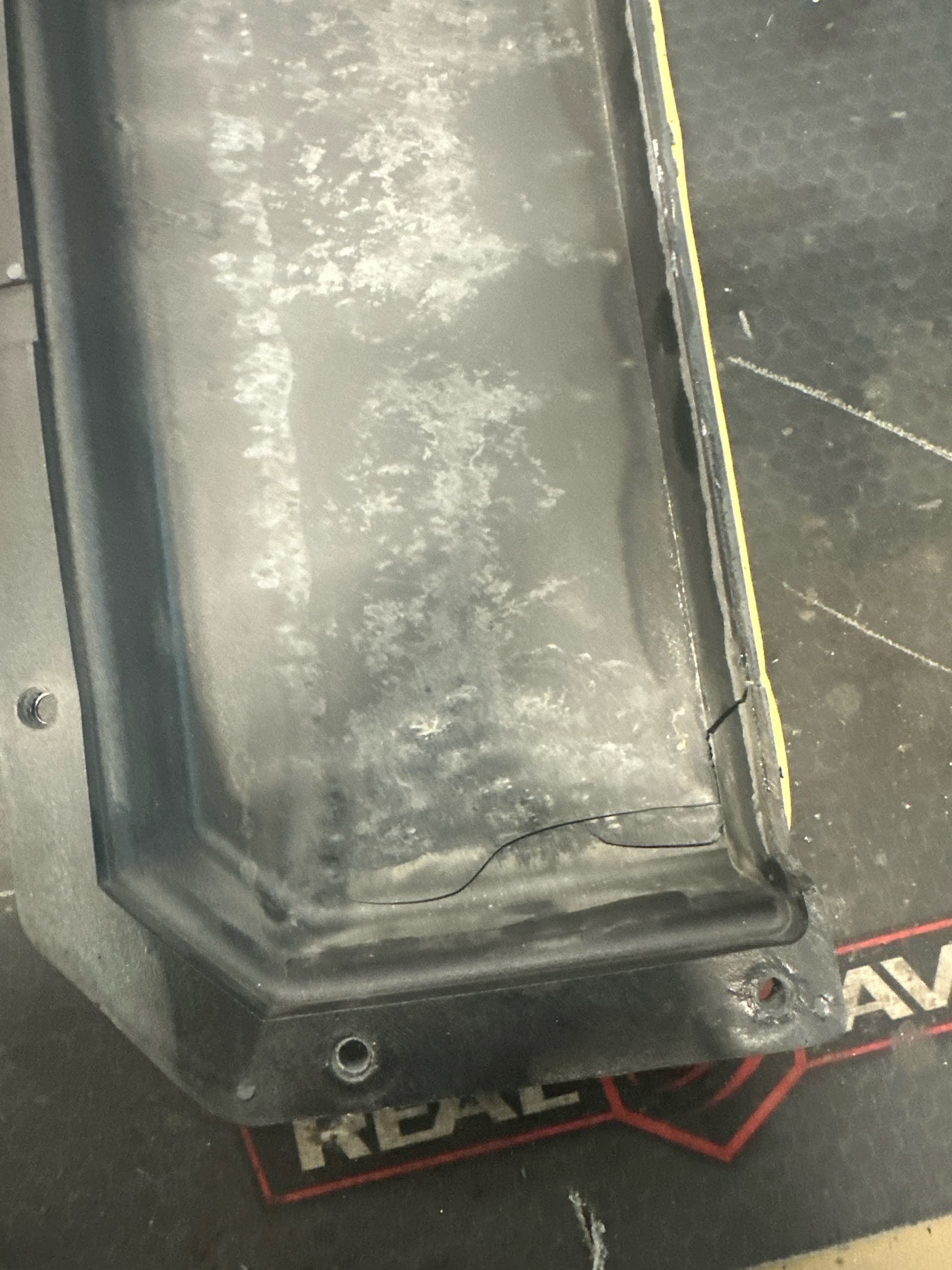

What The F*** happened to the Enclosure😂
Welp! Long story short, it broke. I and many others were under the impression that the enclosure was made of urethane or a similar material, which we thought would be soft, resistant, and comparable in strength, rigidity, and flex to the Hoyt Tabor enclosure. However, I was mistaken. My client mentioned that he remembered coming off a few curbs where it might have hit. One day, he noticed it was cracked after coming in from a ride. This customer has been coming to me for a while with pretty much all his e-skate collection, so I told him I would take care of the issue.
So, what did I do? I started an extensive process of layering resin on the enclosure with black resin pigment. I began the process of patching the enclosure; it’s the best way I would describe it. However, this repair is more of a temporary solution rather than a long-term fix, because the enclosure is already compromised and will likely have issues in the future.
so sanded the enclosure a bit to give the resin something to stick to and hold onto!
Poured on some resin with pre mixed black pigment and well​:sparkles: :sparkles:VOILA :sparkles: :sparkles:
24 HOURS LATER :alarm_clock:
We have a dry resin Layer #1 on the enclosure nice and glossy sanded it a bit after first layer dried up and put a second coat and 3rd coat after that 3 coats of resin and it came out well in the end!
To provide extra reinforcement, I created a fiberglass tape inner cover of sorts. This cover serves as an additional layer inside the enclosure, designed to protect against future damage and prevent water or dirt from getting in.
As per stock set up I put silicone around the edges to hold the pack down onto the enclosure but don’t worry I did put some VHB underneath to hold it swell onto the enclosure!

Now after the mod it’s 16:45 ratio and now it’s great it has amazing take off and acceleration once it gets to 10-15mph it has like a second wind of sorts it picks up some more

My enclosure has a small crack in it right where one of the enclosure screws tighten. Looks like it left the factory with that crack. It should be easy to fix/seal.

I think this is what happens to an enclosure when you don’t use a heat sink. The board did not come like this. The only I can think of is the heat from the ESC warped the enclosure. I am not a very hard rider and limit my speed to about 25mph. No crazy take offs.
Yup that is indeed true and what happened to my customer aswell and I keep noticing it on defiant boards I think the heat of the esc and the bms warps the enclosure and since the enclosure is already soft it stays in that shape creating a belly look to the enclosure.
