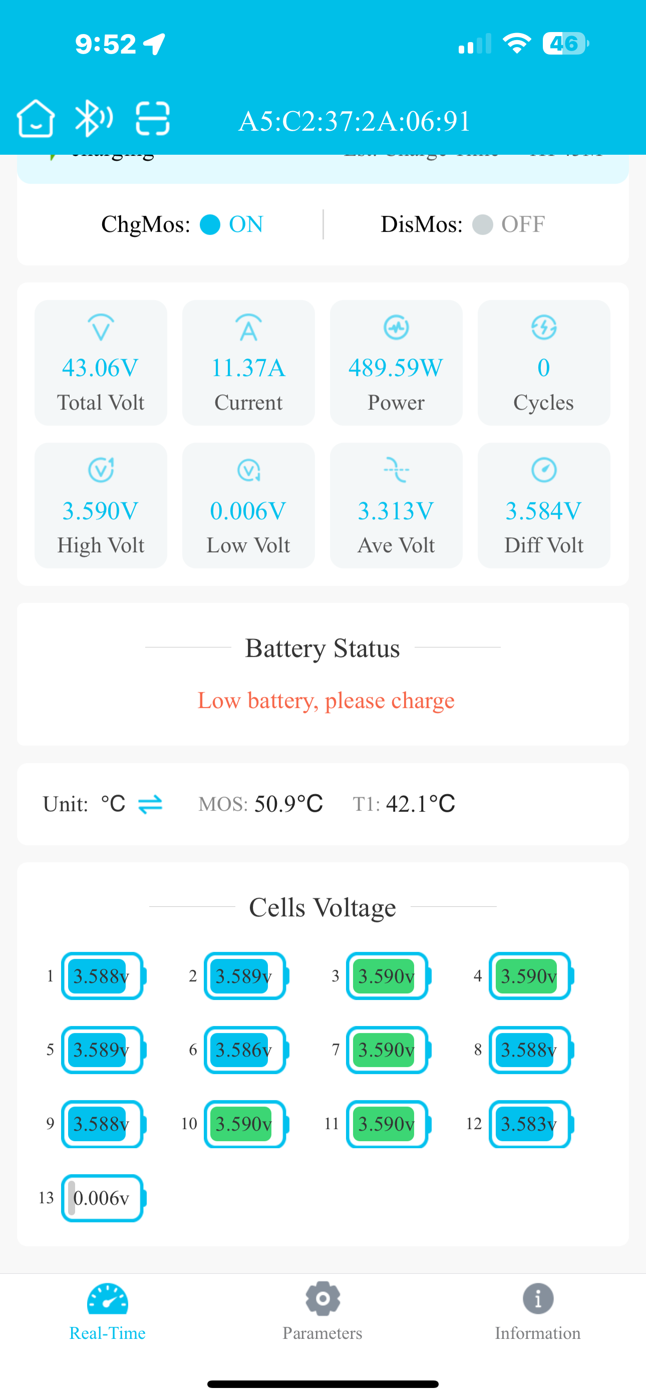

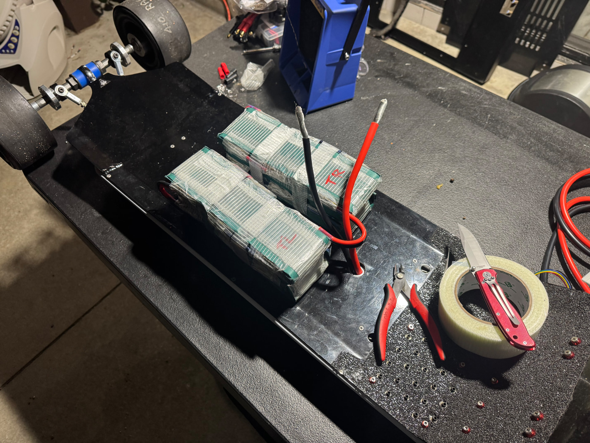

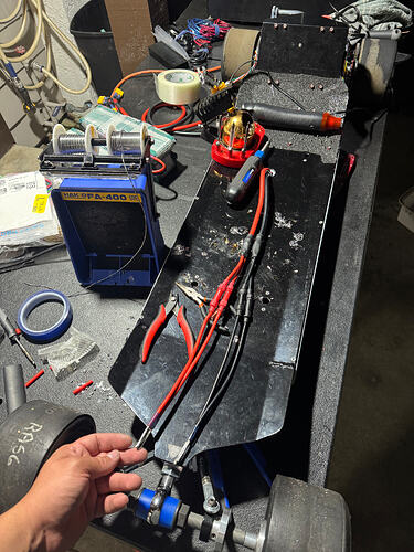

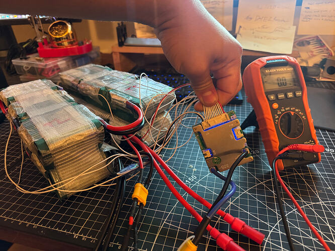

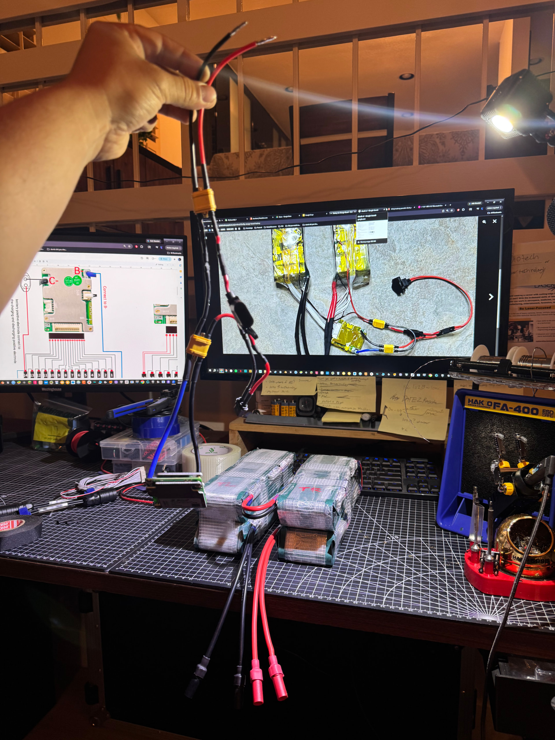

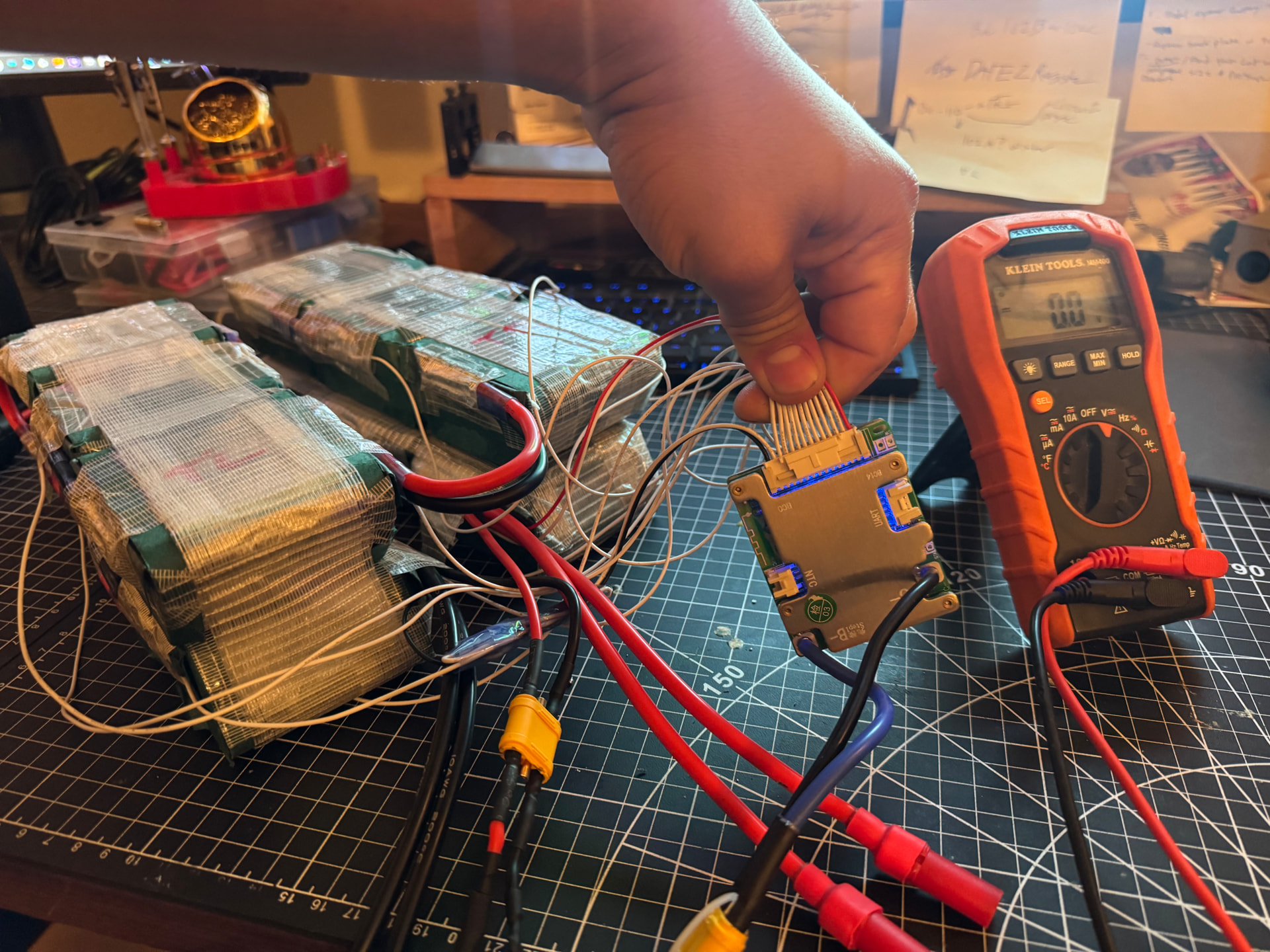

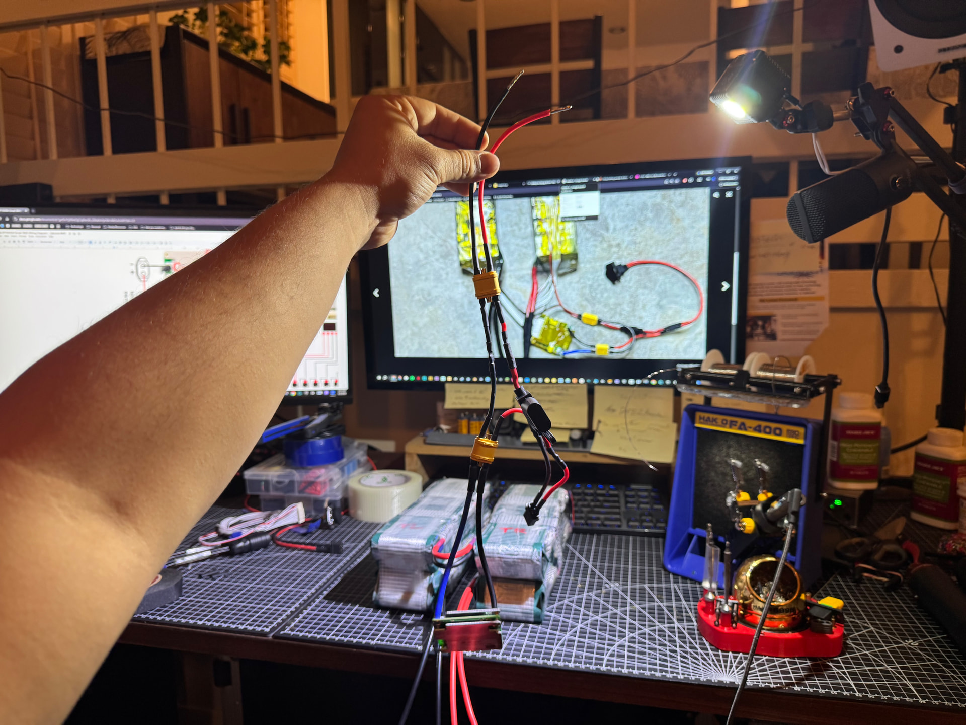

Shit I didn’t take a picture but I soldered those open ended leads to the battery.
BMS FORSURE TMR :grinning_cat_with_smiling_eyes:
So so so so close

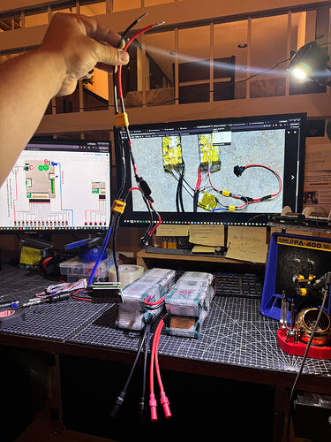

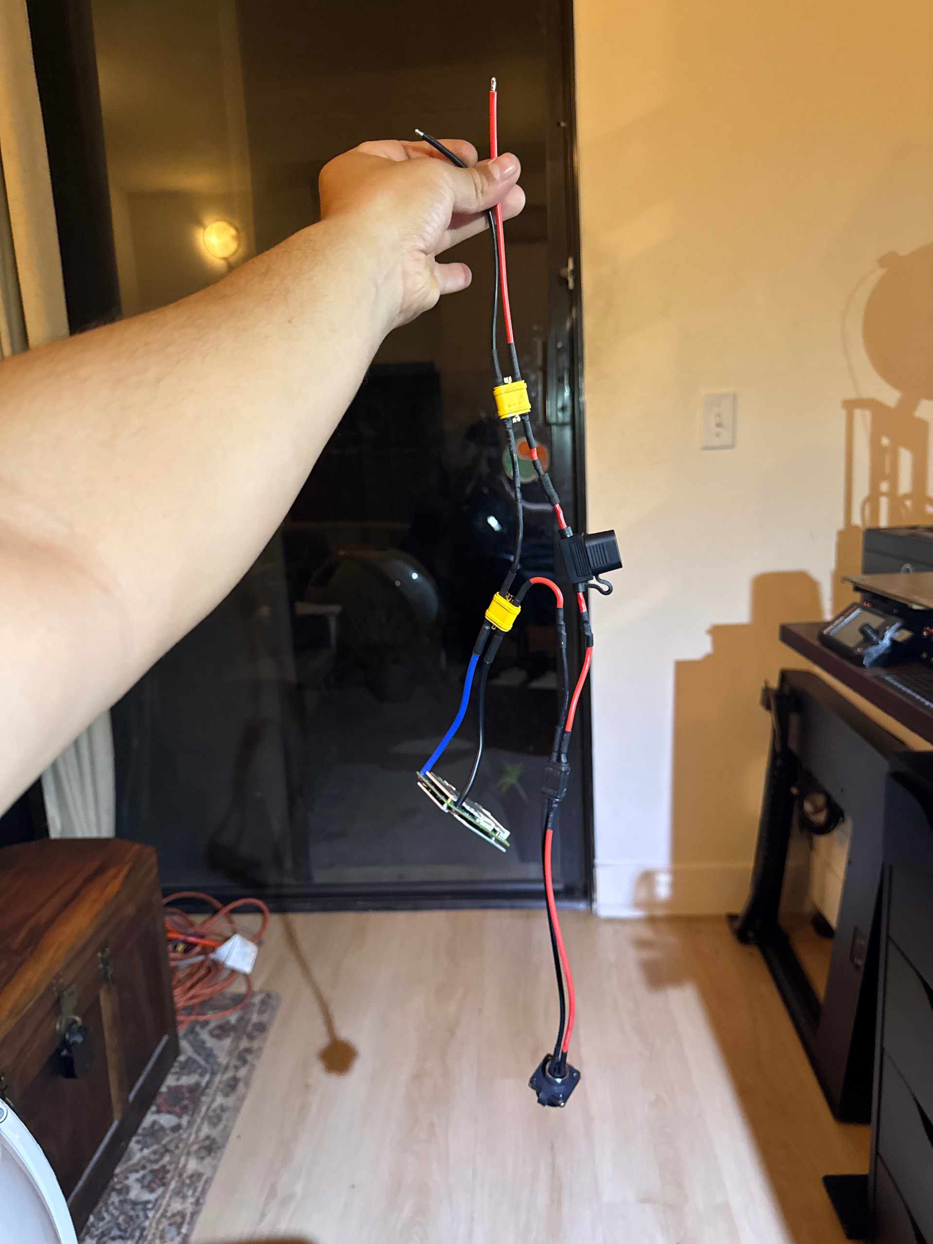

Thanks @SBS For unknowingly helping out on this build via copying your image for fuse layout :grinning_cat:
Wow
Just an fyi that is not the final
Look of battery
But its charging holy fuck
What kinda of battery amps do you think this pack will be happy running?
I was advised 200 amps max which I think I should obey
That’s about 10kw max
Which is sad because the entire pack could theoretically output 490 amps if the nickel bus bars weren’t impeding amps & acting as a resistor

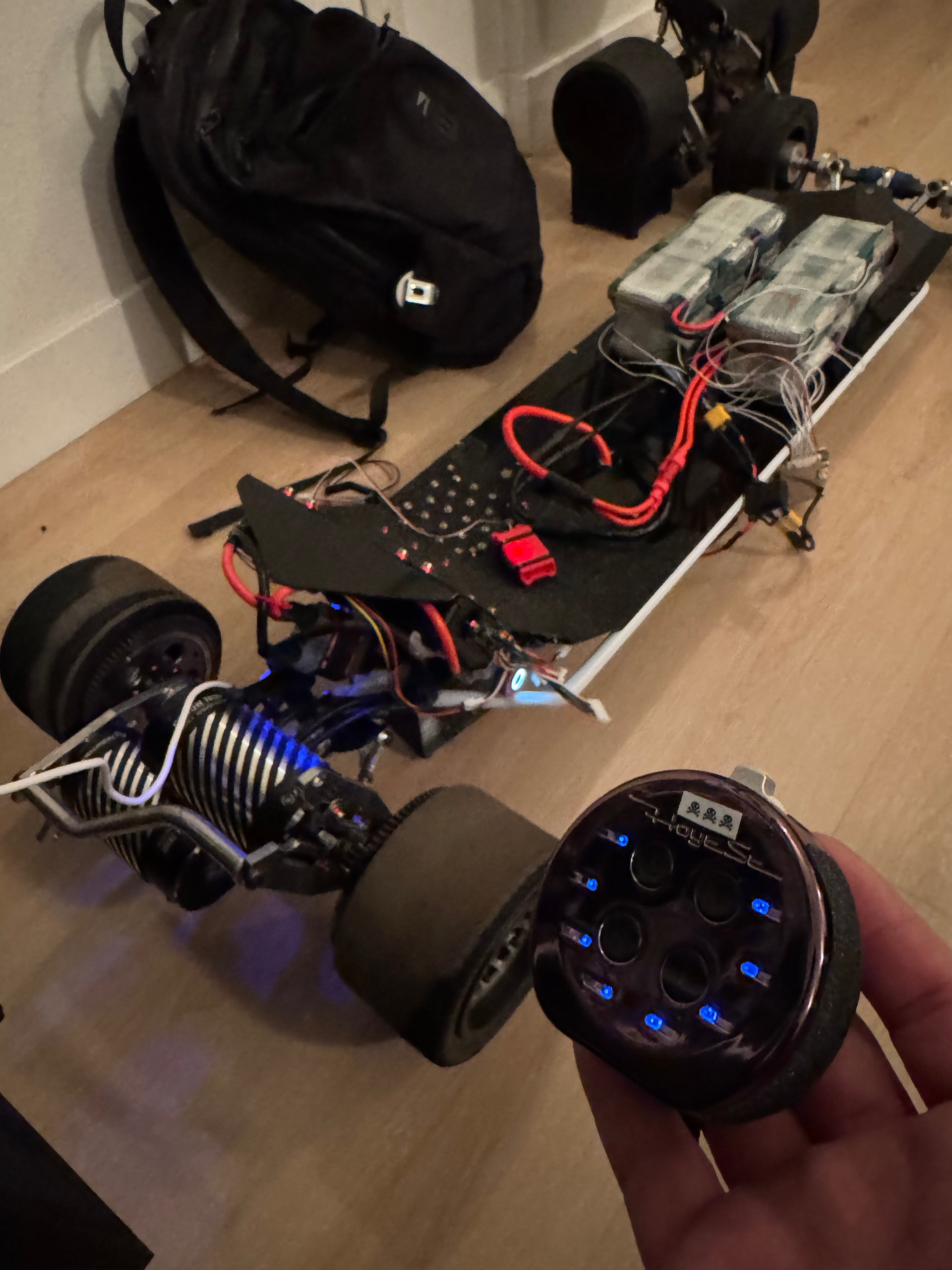

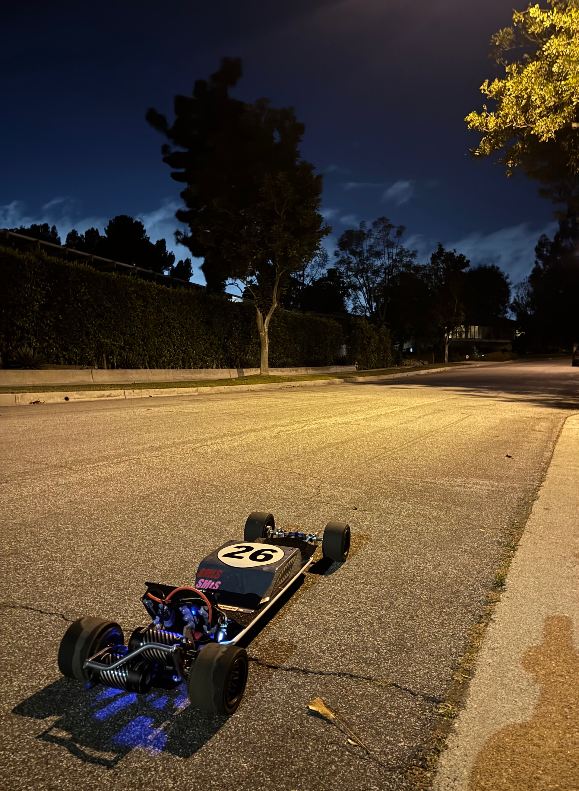

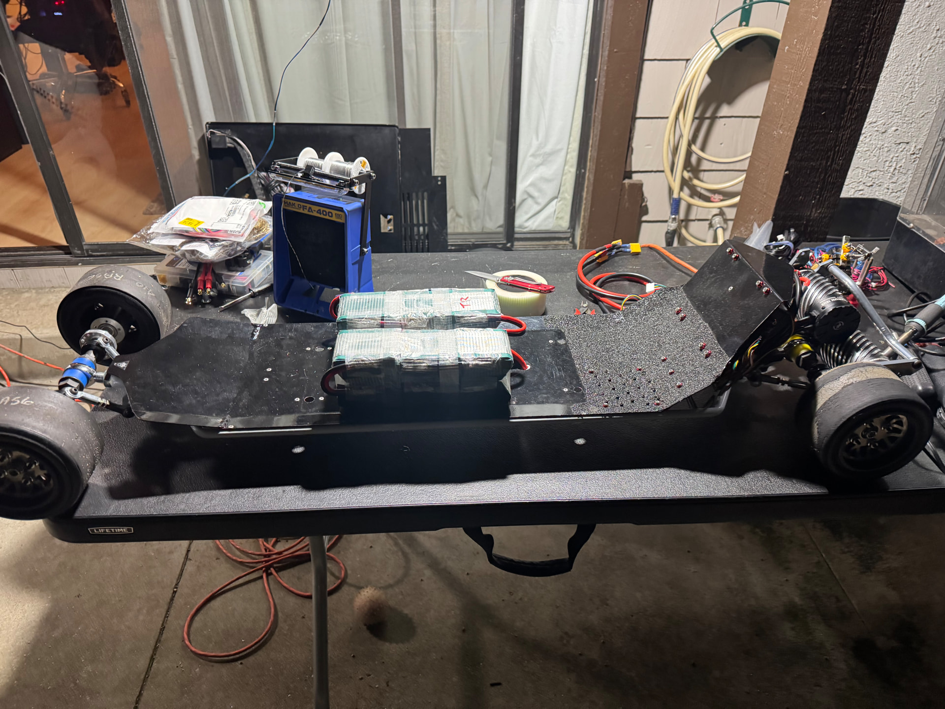

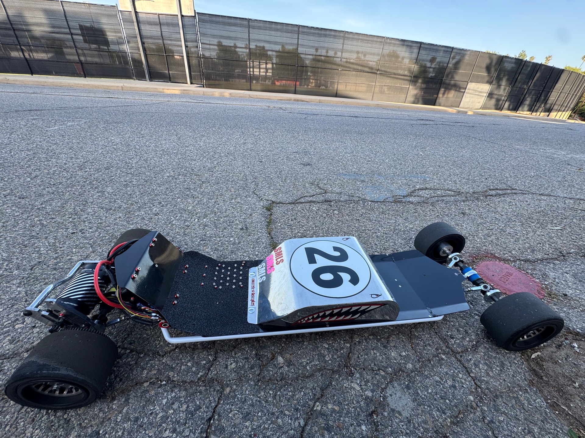

Alright well she runs.

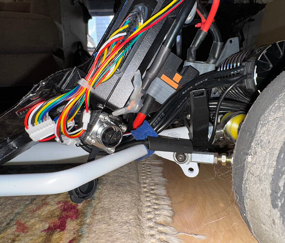

Still have some bits and bobs to secure
BMS wiring needs to be handled
Hoyt receiver mounting
Plus whatever else is loose on the underside

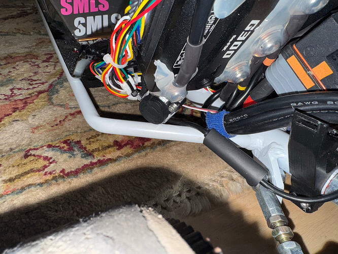

Having a problem where the power switch doesn’t work.
I’ve used both,
I know about that off after 30 min setting on the local or master Vesc but still no luck
Anyone have any ideas?
It doesn’t turn off?
Yeah it doesn’t turn off which is weird @MichaelWA
For the G300 I don’t rl know but for the D100s the side with the switch is Turn off after 30min, 1hr, 5hrs, etc. The non switch side is always on.
That’s only for the D100. I believe in dual G300 the SW and GND are paralleled between the units and shut down mode is mirrored.
I’ll spare you kerfuffle but I’m

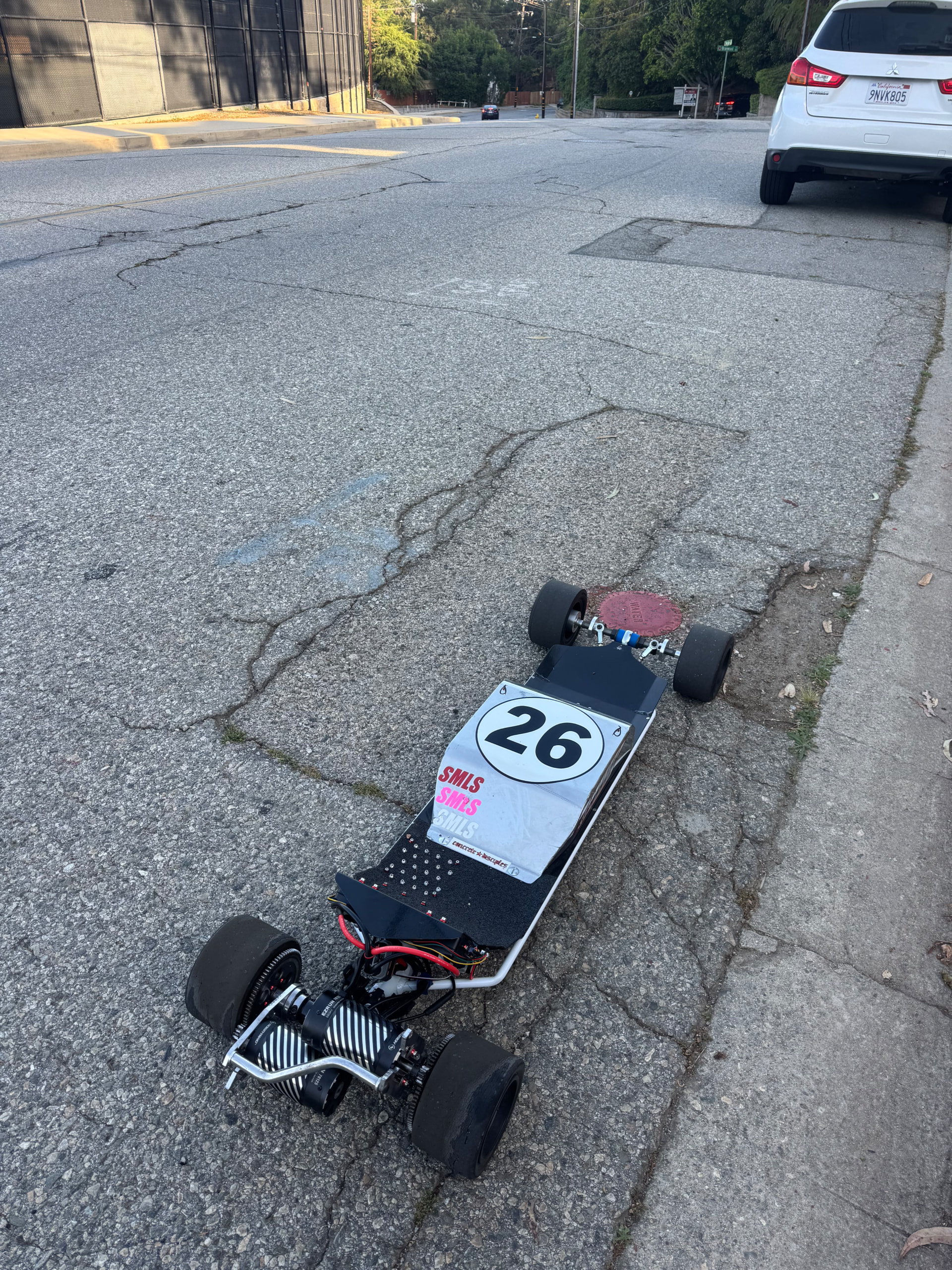

Back in the saddle, ladies and gentlemen
Daytime ride
Insane amount of chatter coming to the rear wheels
Due to the amount of wear (it’s literally down to the foam)
There’s so much chatter going on. It’s almost as if it seems like something may be wrong with the Motors
Started this ride super uneasy

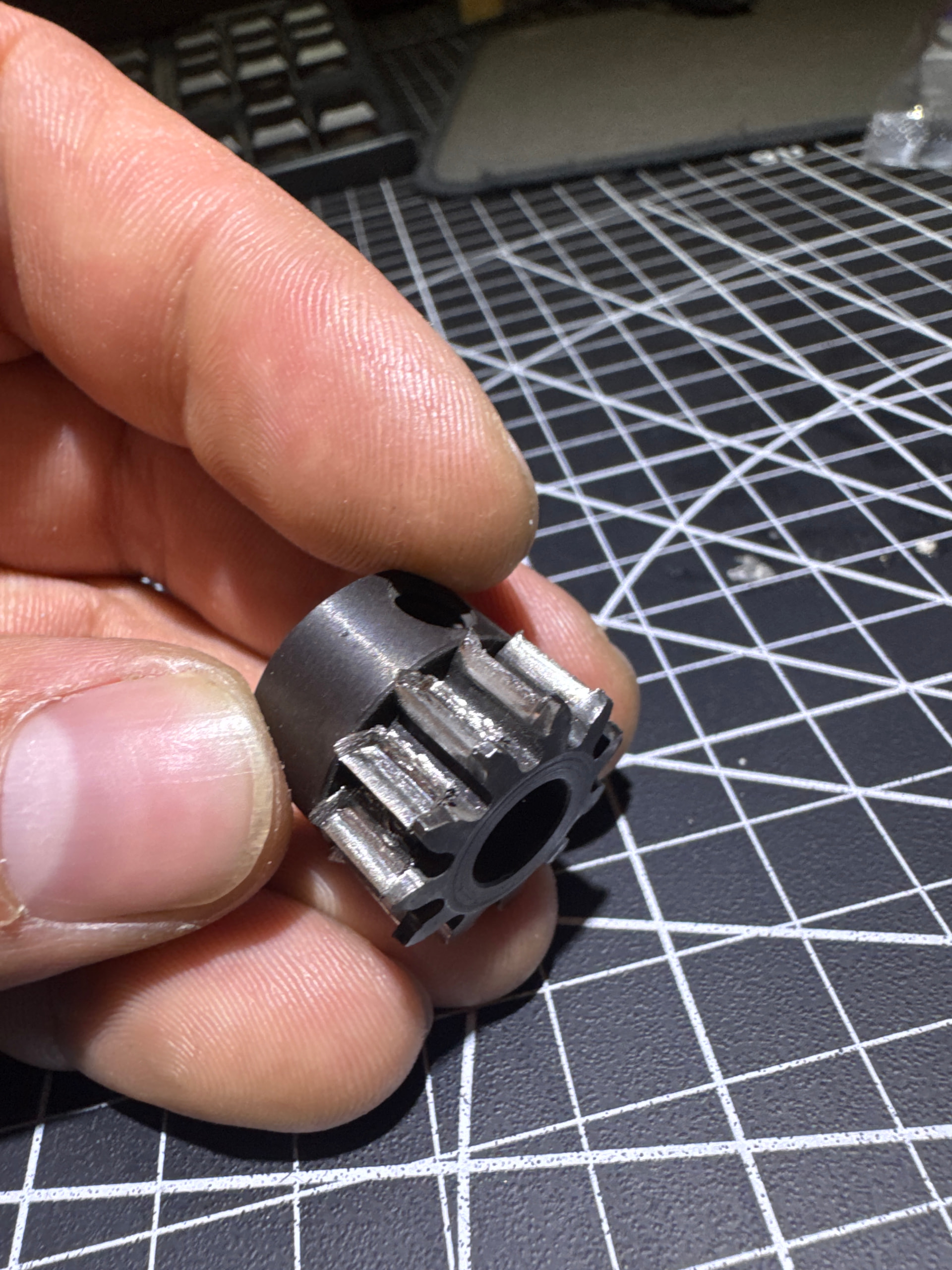

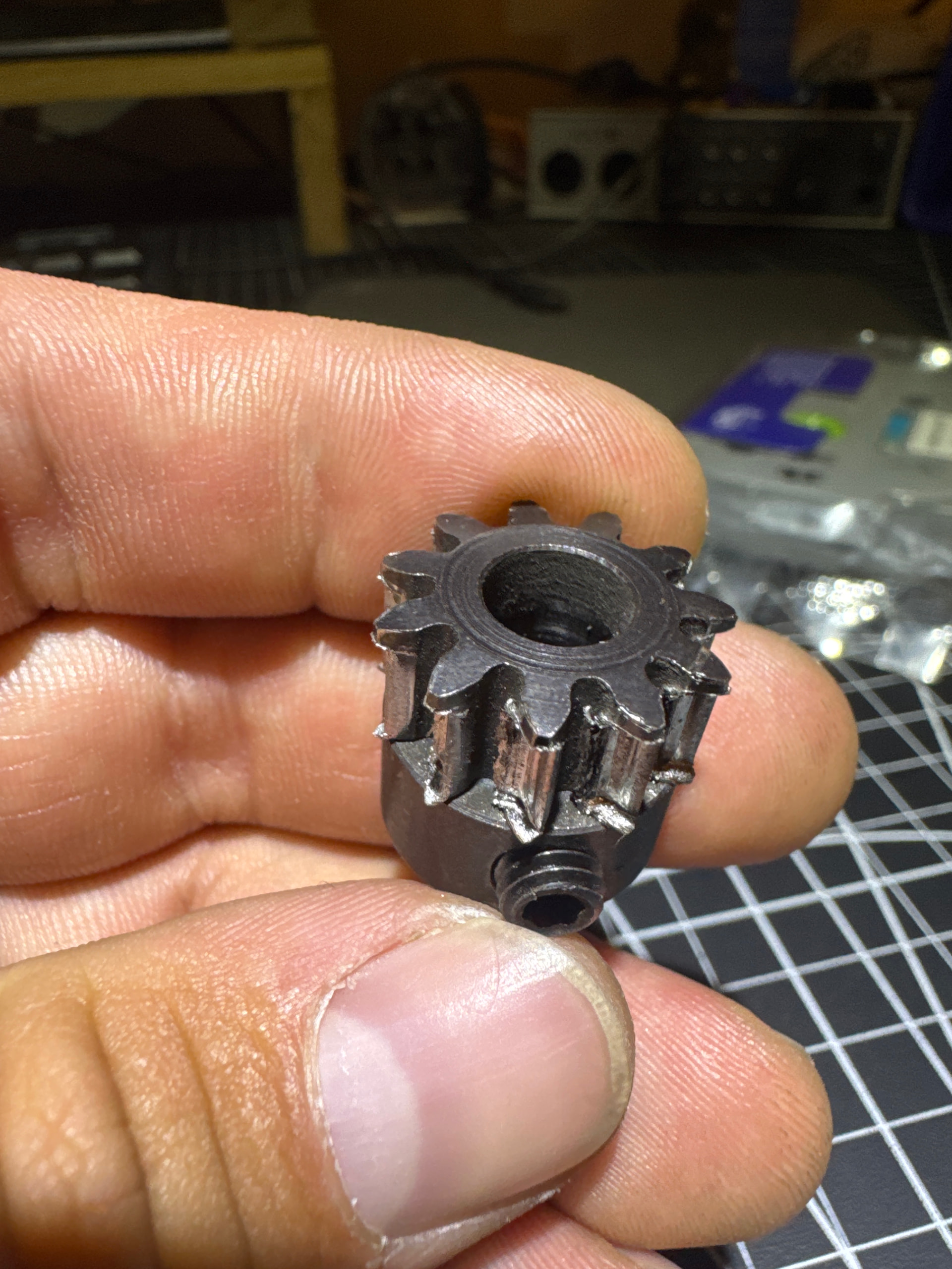

As I had just changed piñons
From 11t to 13t reason being was because I guess I had set my Backlash wrong.
Strange considering I nailed it with my v5 and flux board and had never lubed those up.
I had only done one motor wrong but it completely fucked the pinon. I mean to the point where I was like this is a bit sketch.
Holy fark I am zooominggggg
Shaking with adrenaline from start to finish.
Charging to do more speed runs probably tmr.
I think I’ve raised enough suspicion for tonight zooming about being loud as fuck

Permanent charging line isn’t actually hooked up yet.
Half super busy half I’m concerned about my BMS heating up because it absolutely does
So I run this fan on low to keep it cool
