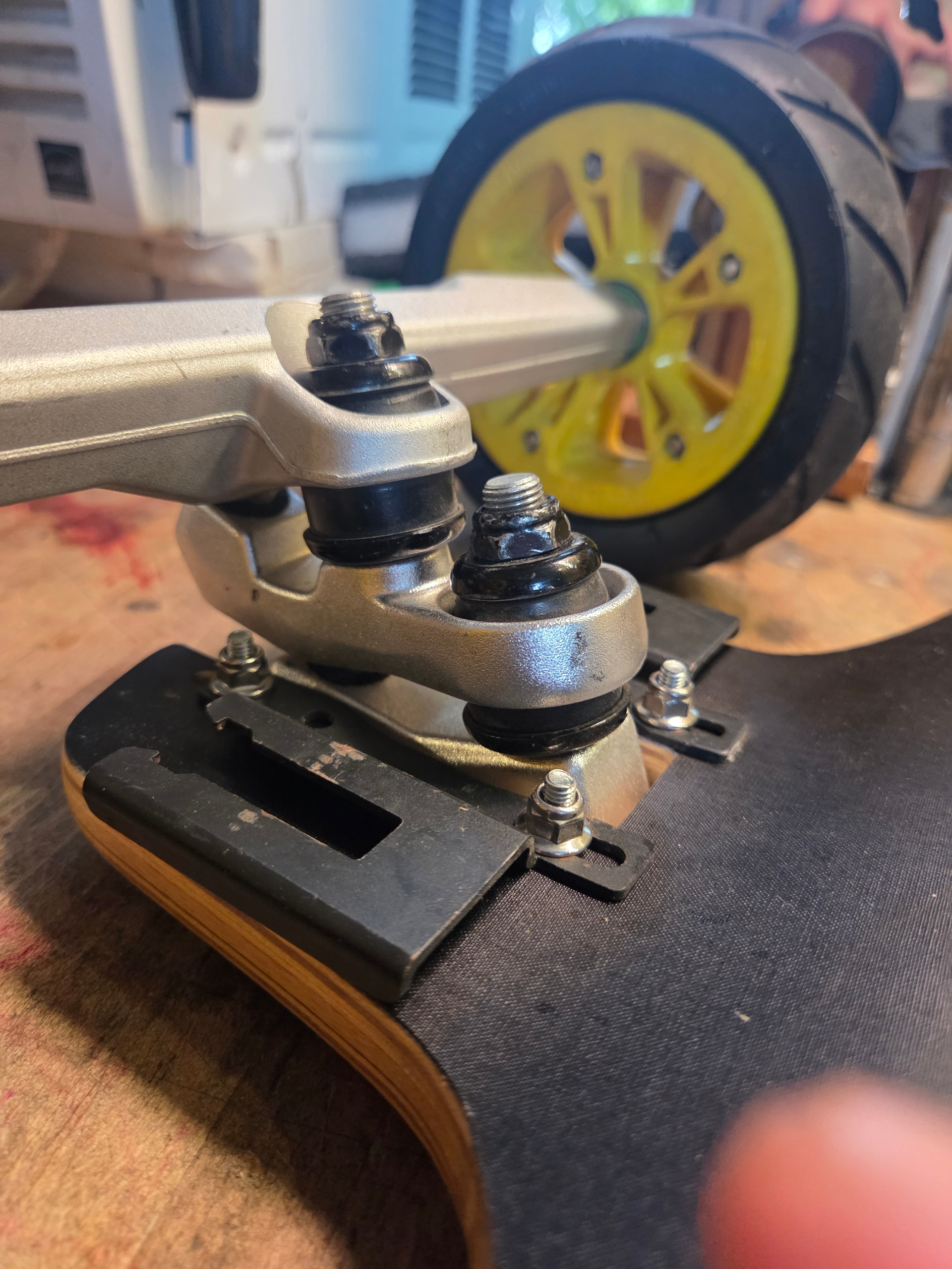

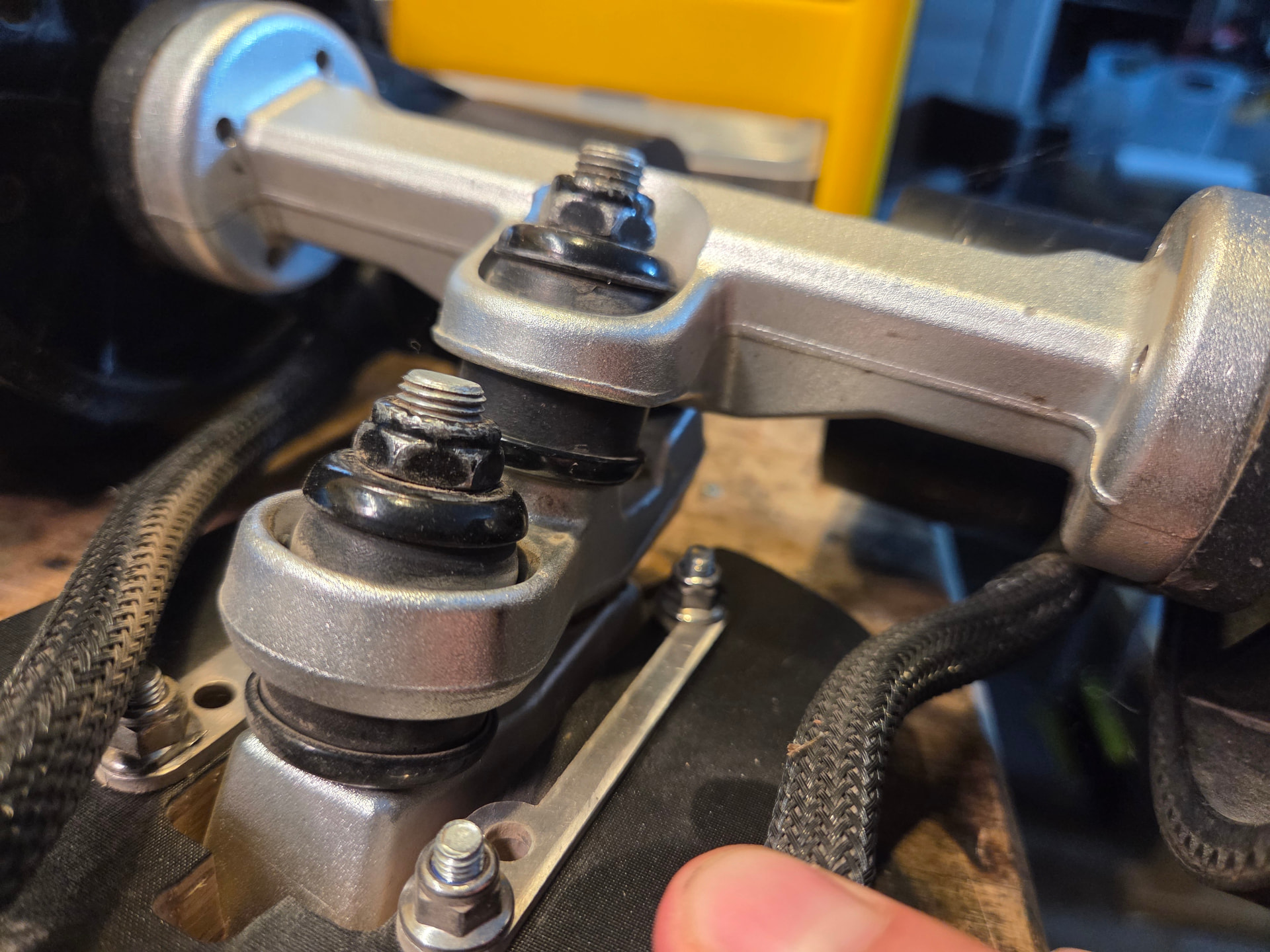

Hey Brad. @RipTideSports
What is the sauce for the little dude.
He is about 50 lbs.
On Evolve Super Carve 2 Trucks.
I have some softer bushings on there. But nothing proper.
It’s really hard for him to turn…
What combo would you Suggest?
Cool, please post some pictures of the the bushing stack front and back so I can see how you have it set up currently
Here are pics.
Looking at these again. I actually think these are still the evolve stock bushings..
Short barrel and street cone?
I also want to pick up some bushings for his caliber trucks.
Those cups will definitely be limiting the turn, swapping those out for flats will help a little bit without swapping bushings
I did just do that.
Flats on the deck side. And softer bushings…
I thought I had done this already…
If i were you i’d go flats everywhere. Cups feel gross IMO and just mangle the bushings. Especially those garbage stock evolve ones
Start with flats on the front roadside pair, if you need more turn use all flats up front. Then if you want more, same progression as the front but on the back truck.
