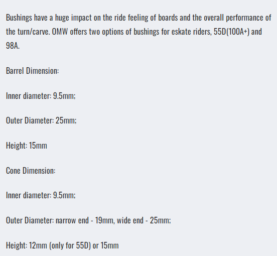

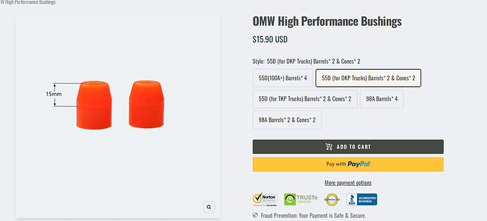

He rides a OMW Hussar with CNC DKP trucks. The stock bushings are oragne :smiley: ( I guess they are 100A)
He is on the heavier side, around 105kg with all the gear.
He gets “speed wobbles” especially when releasing the throttle in speed mode 4. My suggestion to him would be to use chubby or a fat cone at the back truck road side, But im not sure about durommeter ect. Thanks for the help in advance! :slight_smile:

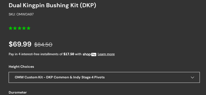

Go to riptidesports.com and go to the kits, we have a special kit for OMW.
I will back to you on duro after I check my notes at the office.
The 96a kit should be the ticket!
Thank you very much. He will order the bushings over Sick boards as they shipp fast and cheep to EU. Do you know which pivot cups he needs for the OMW CCNC Dkp trucks?
Does that mean he needs 4 Indy Stage 4 pivot cups?
Sick will not likely have the OMW kit, it is very different form our others using Canon and Magnum bushings plus 2 different pivot cups. The Stage 4 follows the hanger so in a DKP configuration, the Stage 4 goes into the center carrier unit. When you convert over to a TKP, the Stage 4 goes into the base plate.

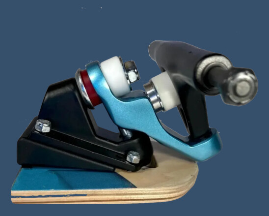

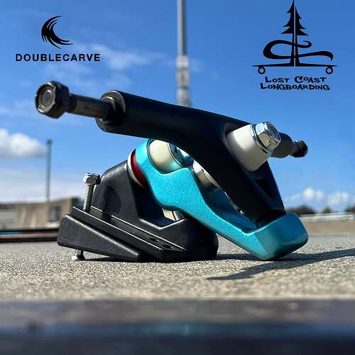

@RipTideSports can you share your thoughts on these? Are they novel compared to the TKP style DKP on the market? I am sure I could find older examples if I dug for them.
Apparently, they are designed by the same man that designed the Gullwing Side Winders. Do you have a set? Lots of unusual comments in their promo video: https://www.youtube.com/watch?v=hAKwucUhvYk
I don’t have a set. I am getting tired of these Evolve DKP trucks having the pivot pop out of the cup when I ride hard, they are just seemingly designed wrong haha.
DKP style trucks I have found allow you to achive proper drifting/countersteering on wet grass with slick rubber tires. Super fun but these old trucks don’t hold up to the abuse.
The combination of so many polymers deflection points and short pivot intrusion can be a risky mix when going deep.
Man.
I could get these going with some BN hangers and just get the middle adapter for 110 bucks.
I am super curious about these now
I got curious from your post & ordered a set just now, ha. I asked the guy about compatibility with Caliber II geometry and they hadn’t tried them on that yet but had done Randal, Paris and Bear so sounds like it should be cool.
I have a set of empty BN adjustable baseplates to fiddle around with the angle on them too which should be interesting.
EDIT: Got more info in another email with the maker - they say the 50 degree kingpin is the most important geometry to make sure the system lines up correct. And then they install baseplates with a 14 degree riser.
I do too. Makes me ponder these on a mountain board even….
